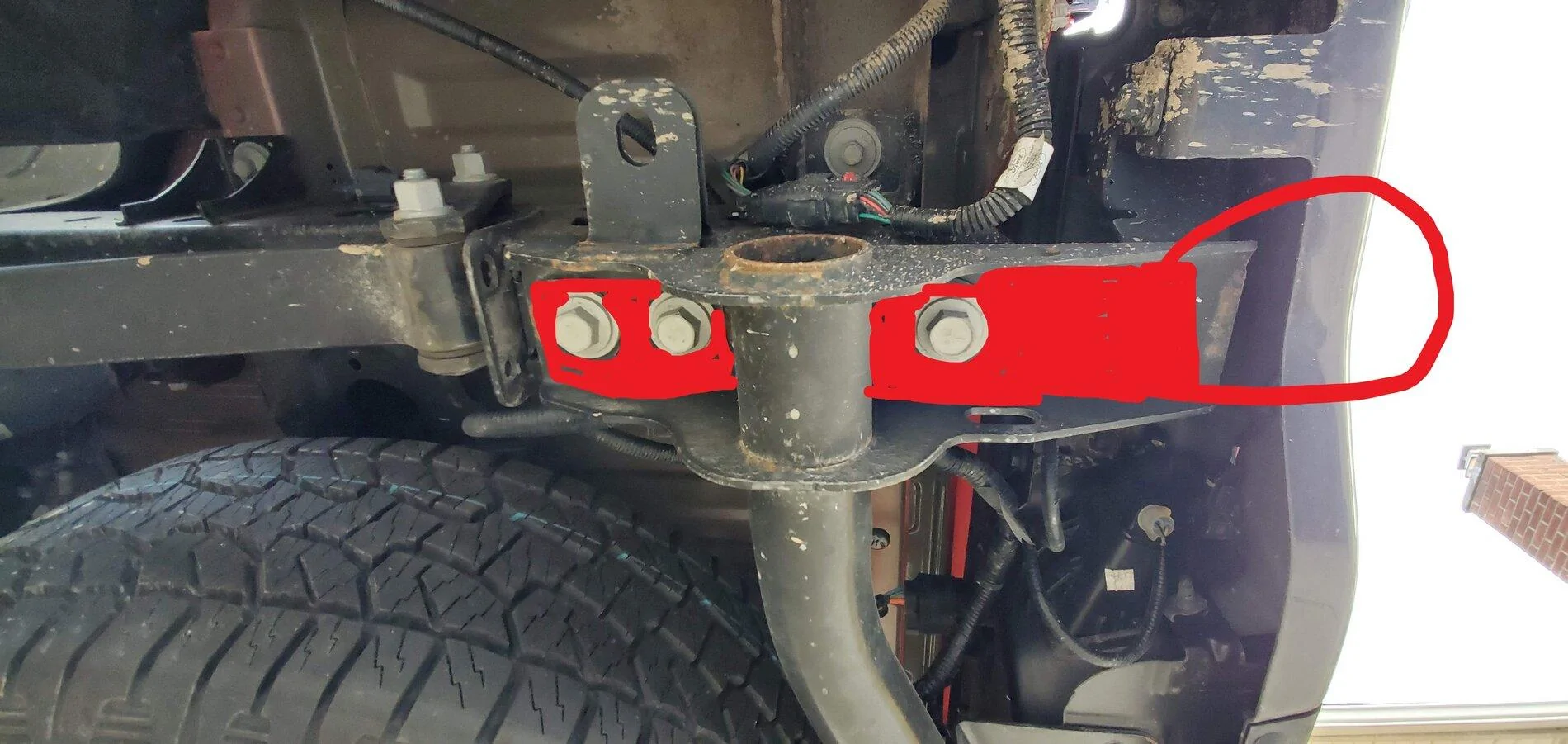

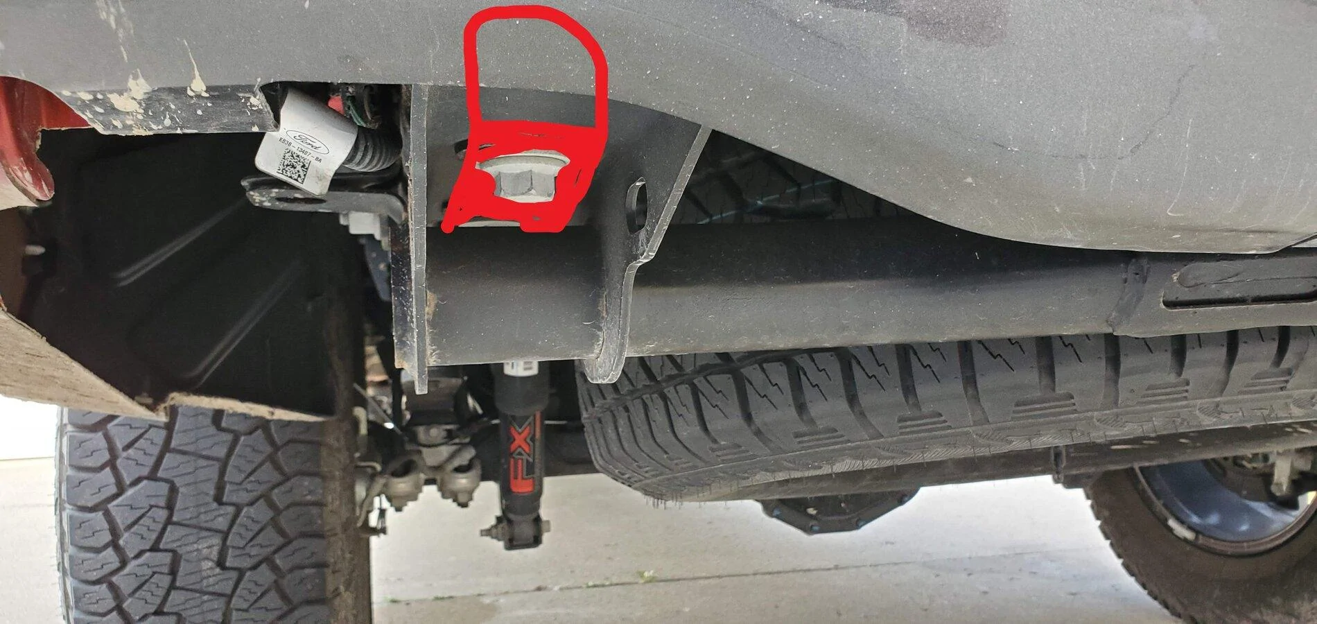

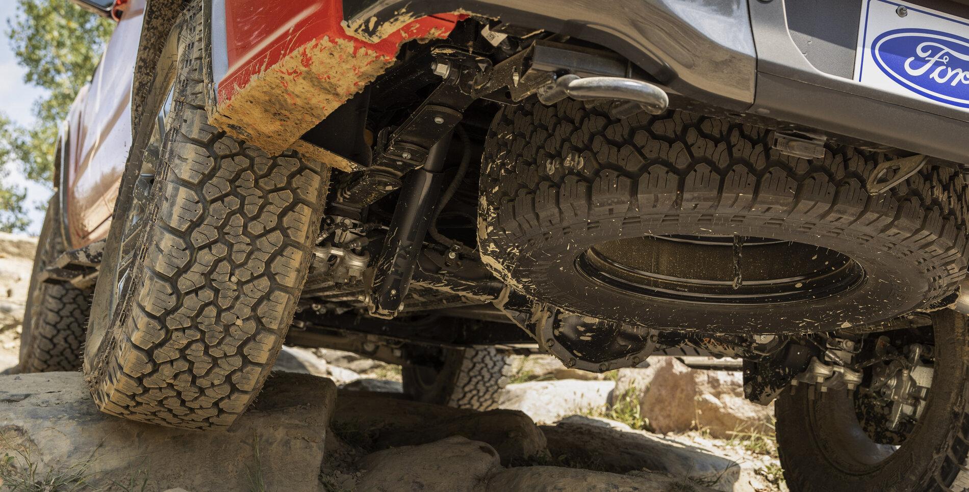

I found one, but trying to understand how they have mounted it. Almost looks like a bar across that would be in the way of the tow package, hence why it seems to not be available with the tow package. But that would really suck. Not quite sure why they would have designed it that way?
Looking at how the hitch is mounted, I don;t see too much reason why a couple of hooks couldn't just slide in along where the hitch is mounted using the same bolts and run them out the side. The hitch is solidly mounted to the frame at the sides. Will have to see more details as it comes out, but it is not looking promising at the moment to retrofit to a Ranger with the Towing Package...fingers crossed though! But might just have to try and custom build a tow hook bracket that slides in the trailer hitch frame mount.
Tremor Rear Tow Hook Pic (Note the bar that seems to run across between the frame rails that the hook is mounted to as well as the lack of 7 and 4 pin plugs next to the license plate and the fact that there is a 4 pin below the bumper):
My Idea of How a Rear Tow Hook could be Added:
Looks like the Tremor tow hooks are welded to a bar that is essentially a tow-bar without the 2in receiver. Agreed, it doesn't make sense why they wouldn't just add hoops to the bar on the existing tow package, but likely something to do with plant complexity and/or crash/safety regs 🙄
If I had to pic between the two tho, would definitely pic the factory tow package - you can add a recovery point to the hitch if you really need it, so would be more useful to me.
