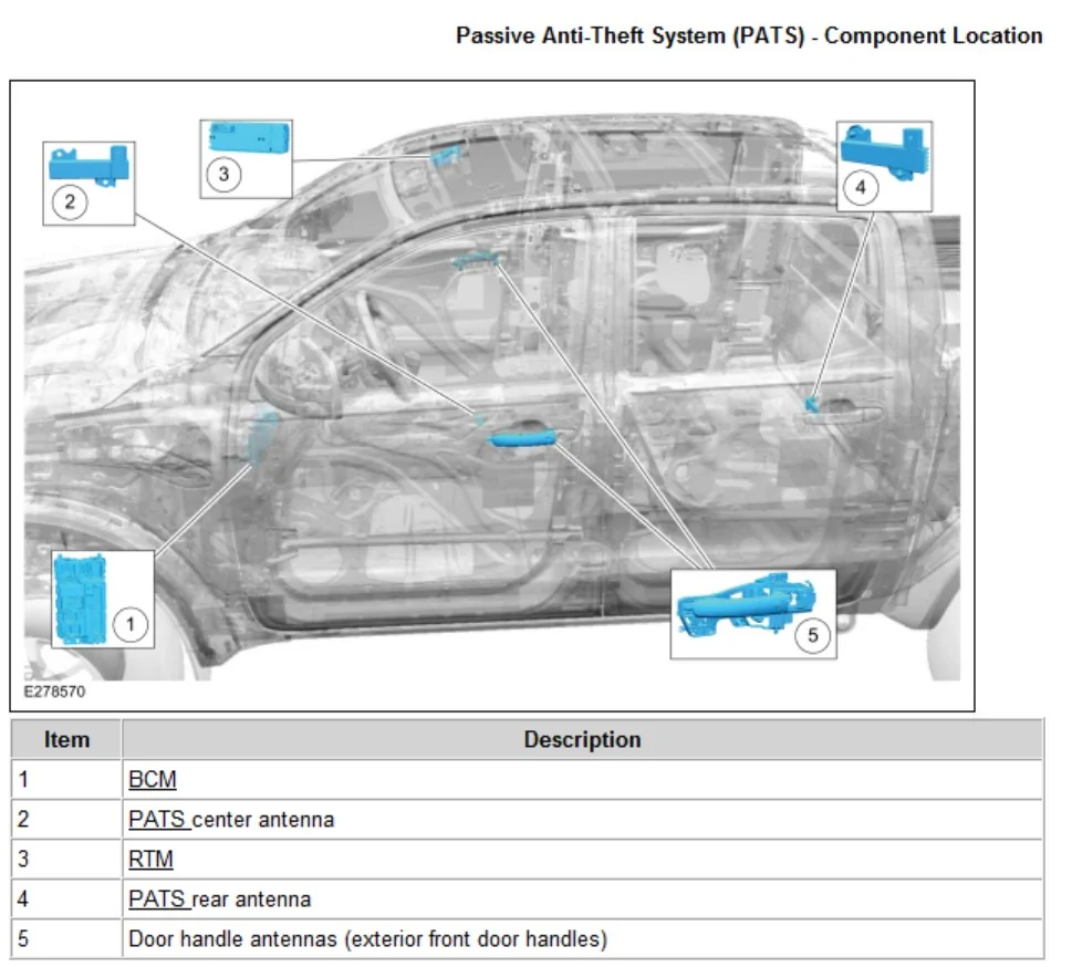

Are you using name brand batteries in your fobs? The antenna for the passive anti-theft system is located in the center console and could be bad or disconnected. There is also an antenna located at the rear of the cab. You could try moving the fob to the rear seat to test for a bad center antenna.

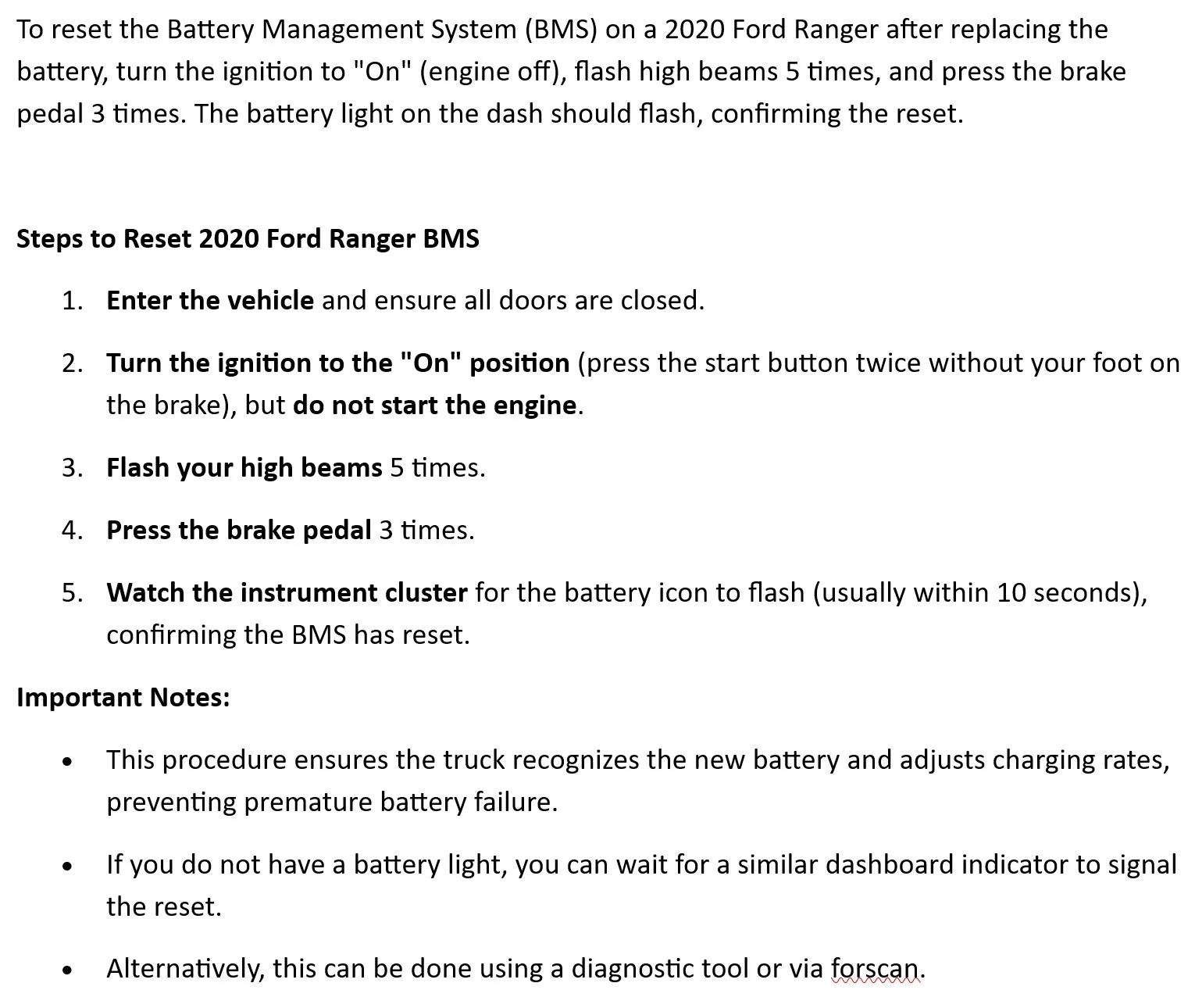

When my battery was replaced, there was no need for a “battery backup process” to save settings.
However, it was necessary to go through a process that lets the truck know the battery is new. Maybe it’s the BMS reset I’ve read about on here. Whatever it was, it had to be performed.
If you haven’t performed that needed step, maybe doing so will solve this issue. If it has been performed, then, I got nuthin’.
At the time, I was trying to avoid extra steps by saving settings during the battery change.
I'm not familiar with BMS reset, but I'll search for it here and see how difficult that is and what other things it might impact. I don't want to cause other issues during that process.

I don’t think it impacts anything negatively. @RangerBill and others will know what needs to be done after the battery change and whether or not that might fix your problem.
I just performed the BMS reset.
I'll advise if I still have issues. So far today the truck has been starting without issue before I posted this thread.

Did you do it with a scanner or the “turn the key, flash the lights, open the door, put your right foot in and you turn yourself around” method? ;)
I did it via the internet quick BMS reset instructions (flash lights & brakes).

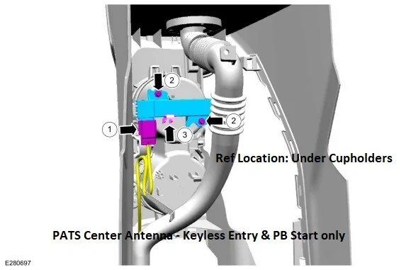

If issue returns - The PATS center antenna is mounted here and there are (2ea) inline connectors between the BCM and the antenna - so 4 total connectors in the circuit.
The issue is getting access, I do not think the cupholders will snap out of the console like the front half does with the (switches)
and not sure without checking if you have enough room to reach under - the parking brake boot
And I am not sure of the EXACT location of the 2 inline connectors that run in that center console as the diagrams do not depict them (nicely)
C312 and C315
I do not think the BMS reset will help - I think due to the intermittent issue - you have a dirty connection at one of the 4 connectors or a weak center antenna frequency

Oh well, at least your truck knows it has a new battery, which will help it charge as it is designed to.
I hope it’s as simple as a loose connection and that mice didn’t get in under your console - it happens.

Thanks for your reply and the great graphics with other potential areas to look if the problem does come back.

Under the center console is a spot where they have room to nest and some have found evidence of it - so it is a possibility
