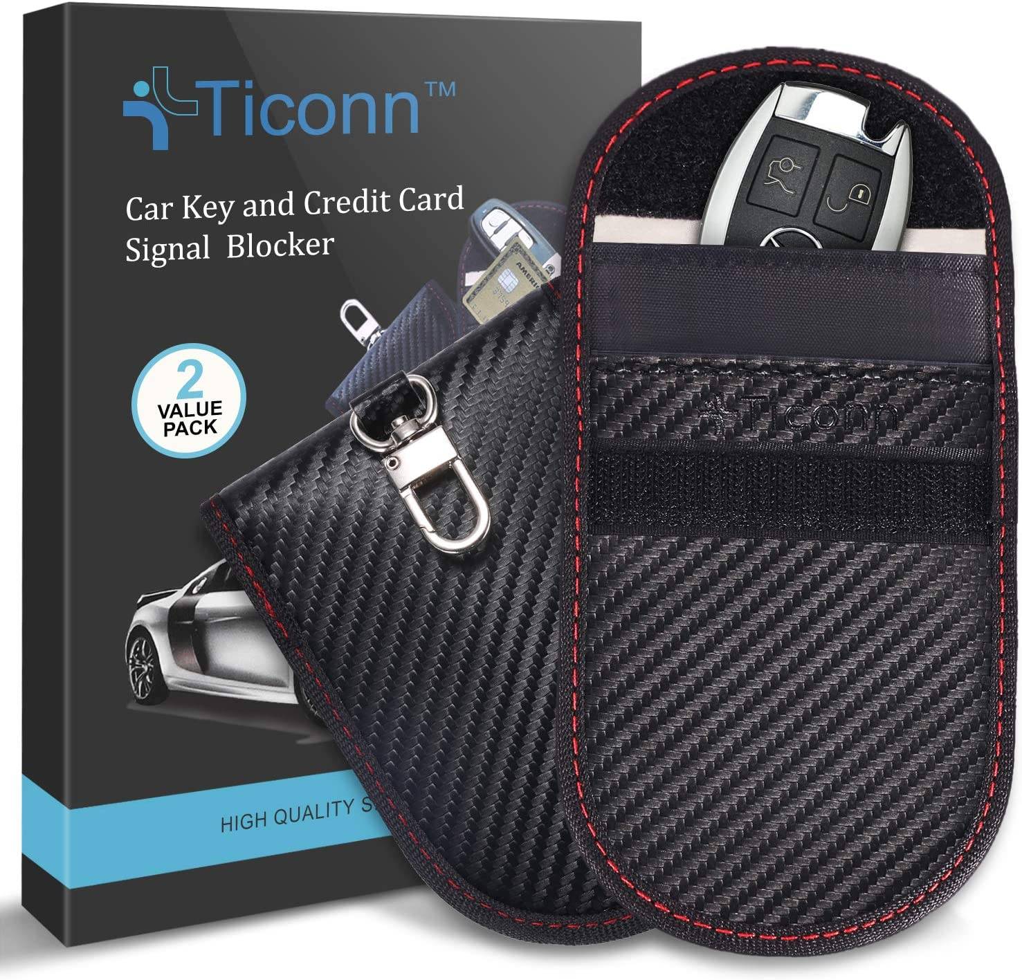

Once it's started you can drive it without having the fob with you. That's why they have the annoying double honk, to remind you your truck it still on but someone could drive off in it. Maybe try getting a faraday bag for it? This way you can start your truck then put the fob inside the bag so it can't communicate with the truck. Doesn't hurt to try until you get this figured out.
