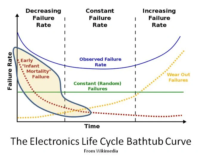

Thanks for posting. Solutions are always good to know. Hopefully this is a case of "infant mortality" in the electronic module. Often times electronics fail early in their lives or they last a long time. ?
