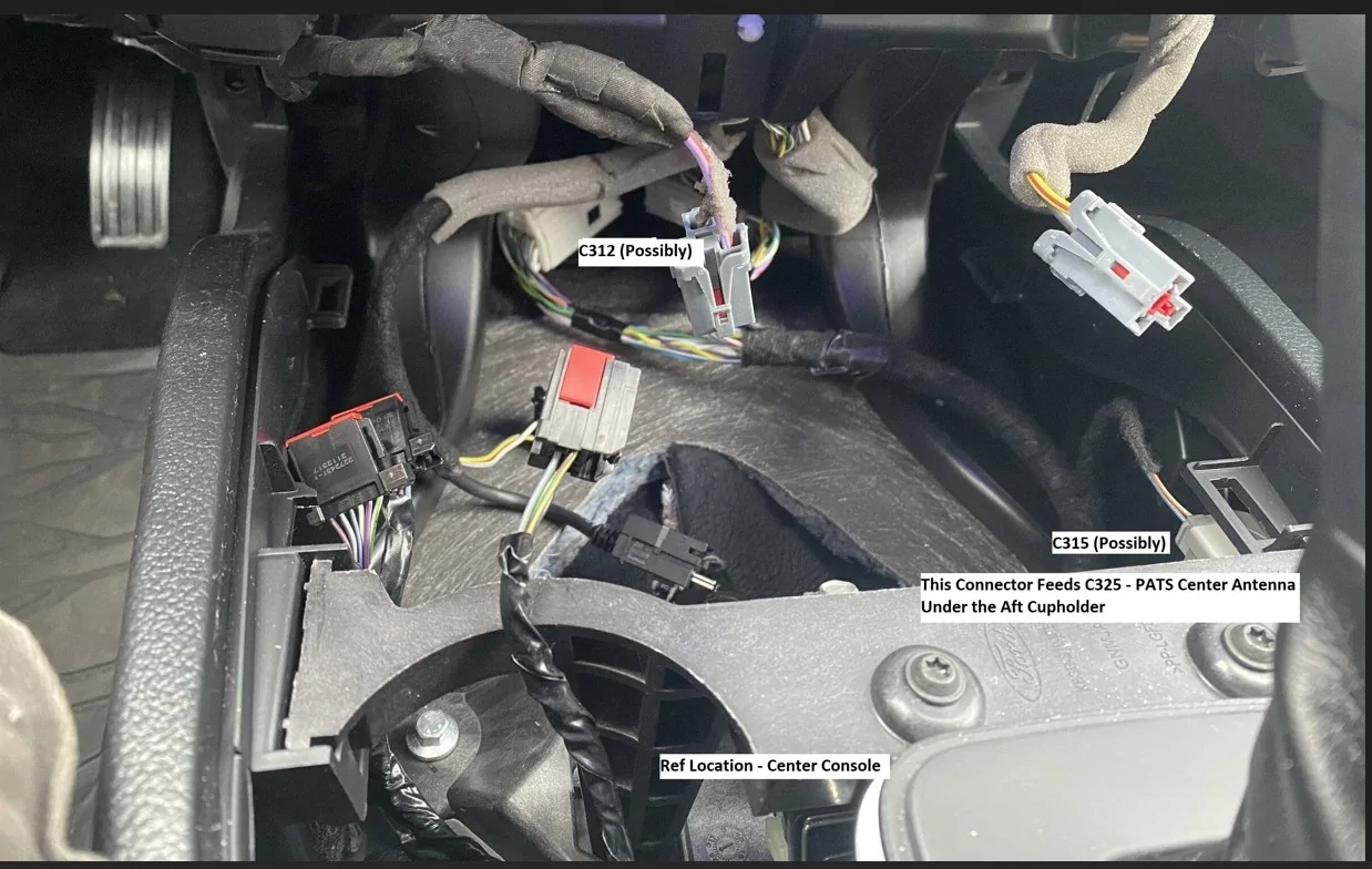

Possible locations of C312 & C315 - C315 feeds back to the C325 Connector for the PATS Center Antenna.
Thanks for the picture... I hope I do not need to disassemble the center console.
