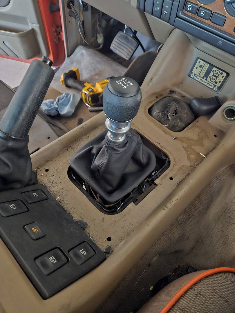

Now back to the Disco. I finally have the electronic throttle pedal and Bronco clutch pedal in. It was no easy task requiring significant fabrication including cutting the clutch pedal in half and re-welding it back together. Ford was not messing around, the pedal is 1/2" thick 4140 steel so that was quite a bit of work to cut through. All of the clutch connections, including the reservoir are all made and completed - it's ready to plug straight into the transmission. Unfortunately due to a miscalculation in my welding, the pedal is a bit crooked, but oh well it's in, connected and solid. Considering how long this portion took, it is what it is. I may revisit it in the future, but for now it's not worth the time considering its functional.

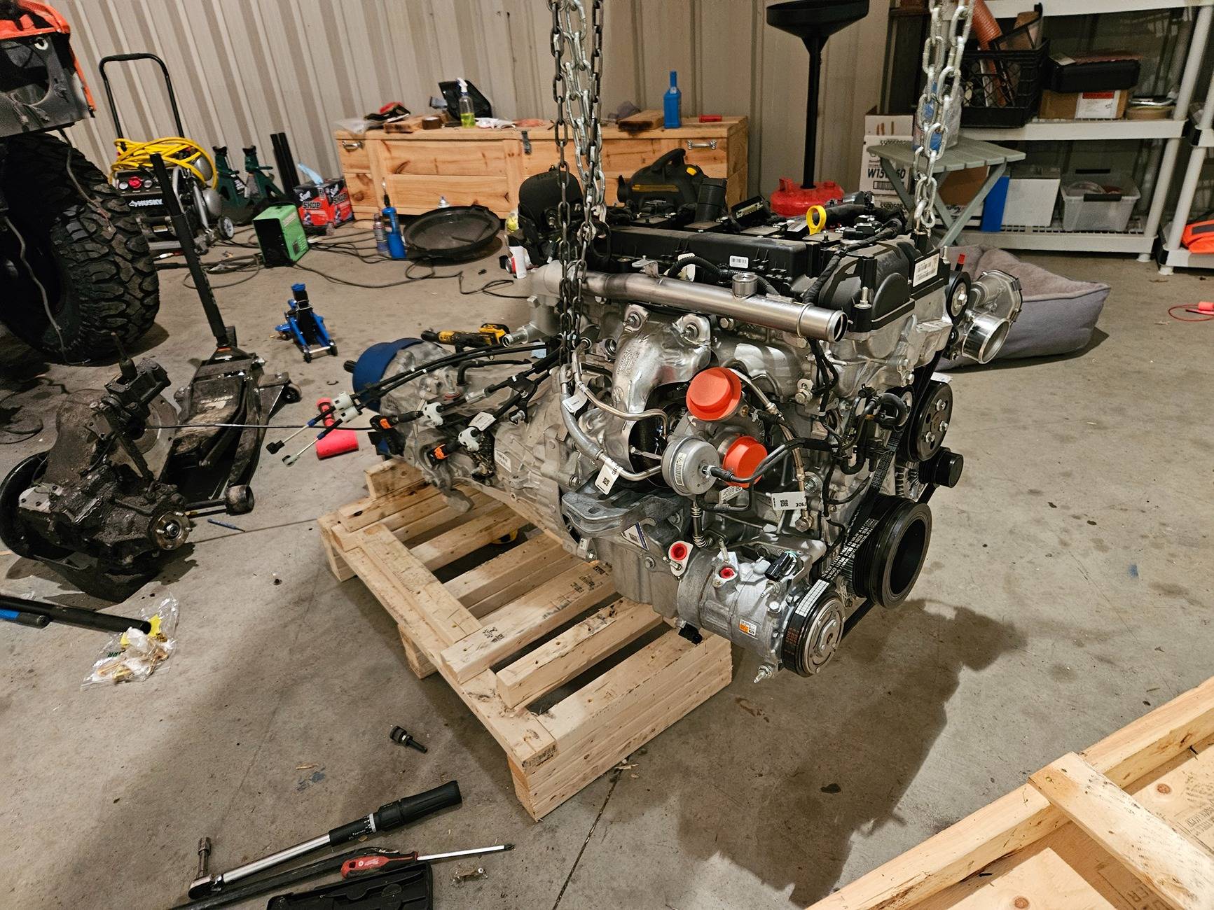

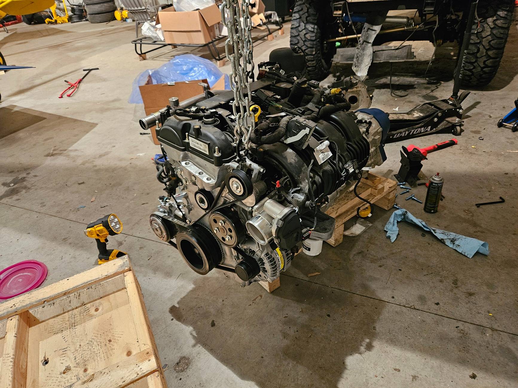

  • The engine is fully dressed to include:
    • 370 Amp alternator! For running lights, air, winch, etc.
    • A/C compressor from a mustang that was totaled with 3k miles on it :giggle:
    • Serpentine belts
    • Flywheel
    • New clutch
    • Coolant outflow pipe
    • belt tensioner
    • throttle
    • engine mounts

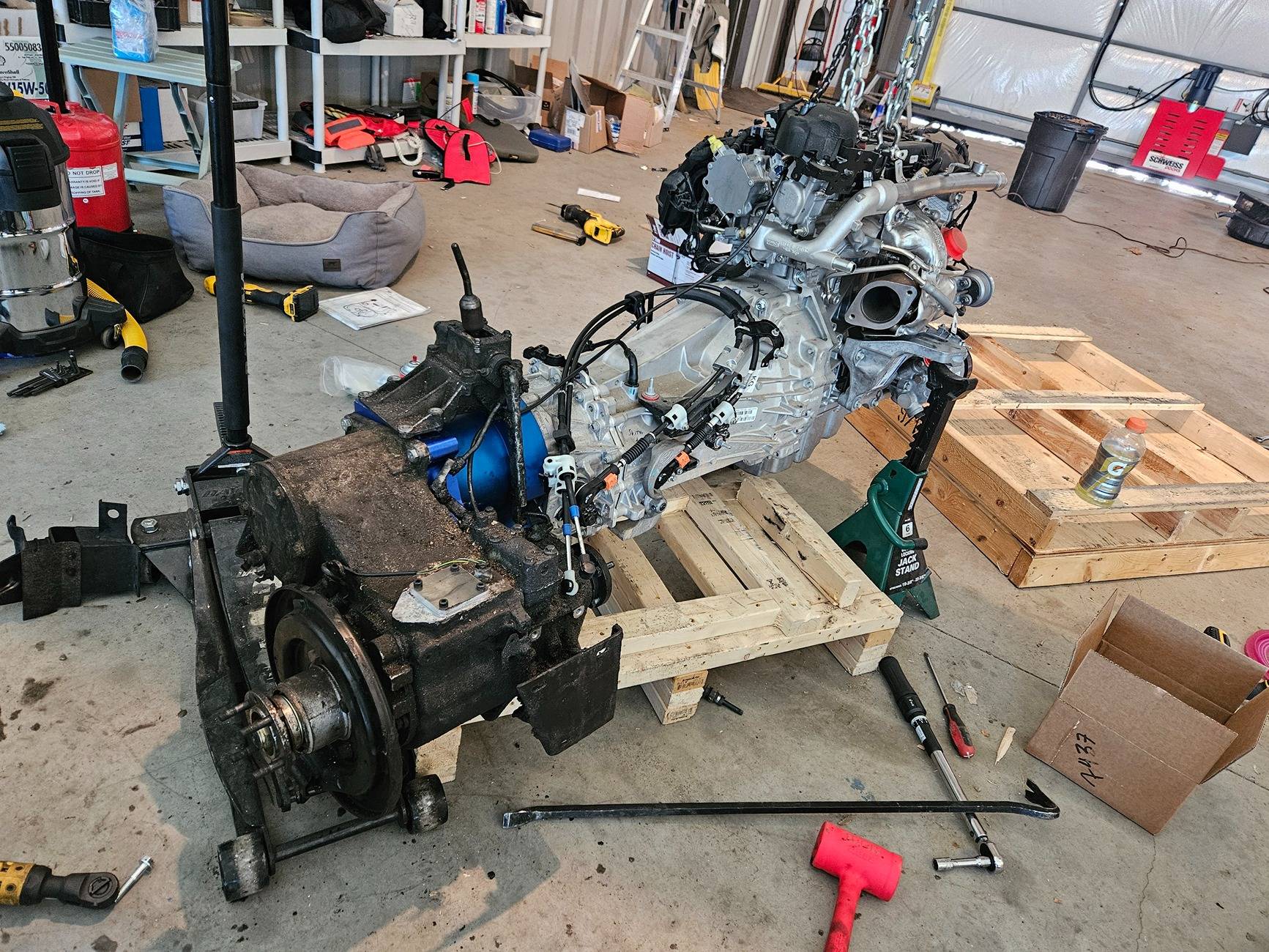

  • Transmission is mounted up

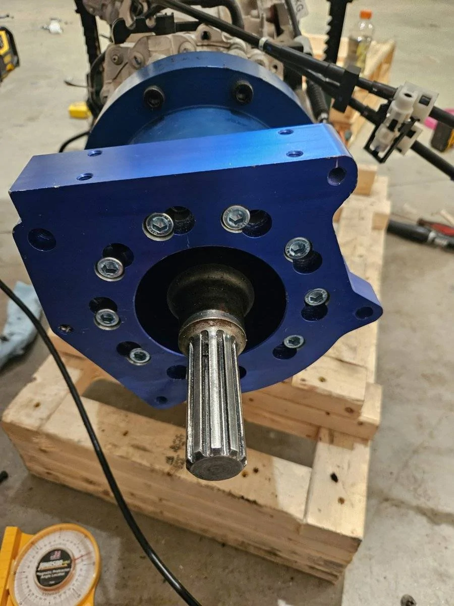

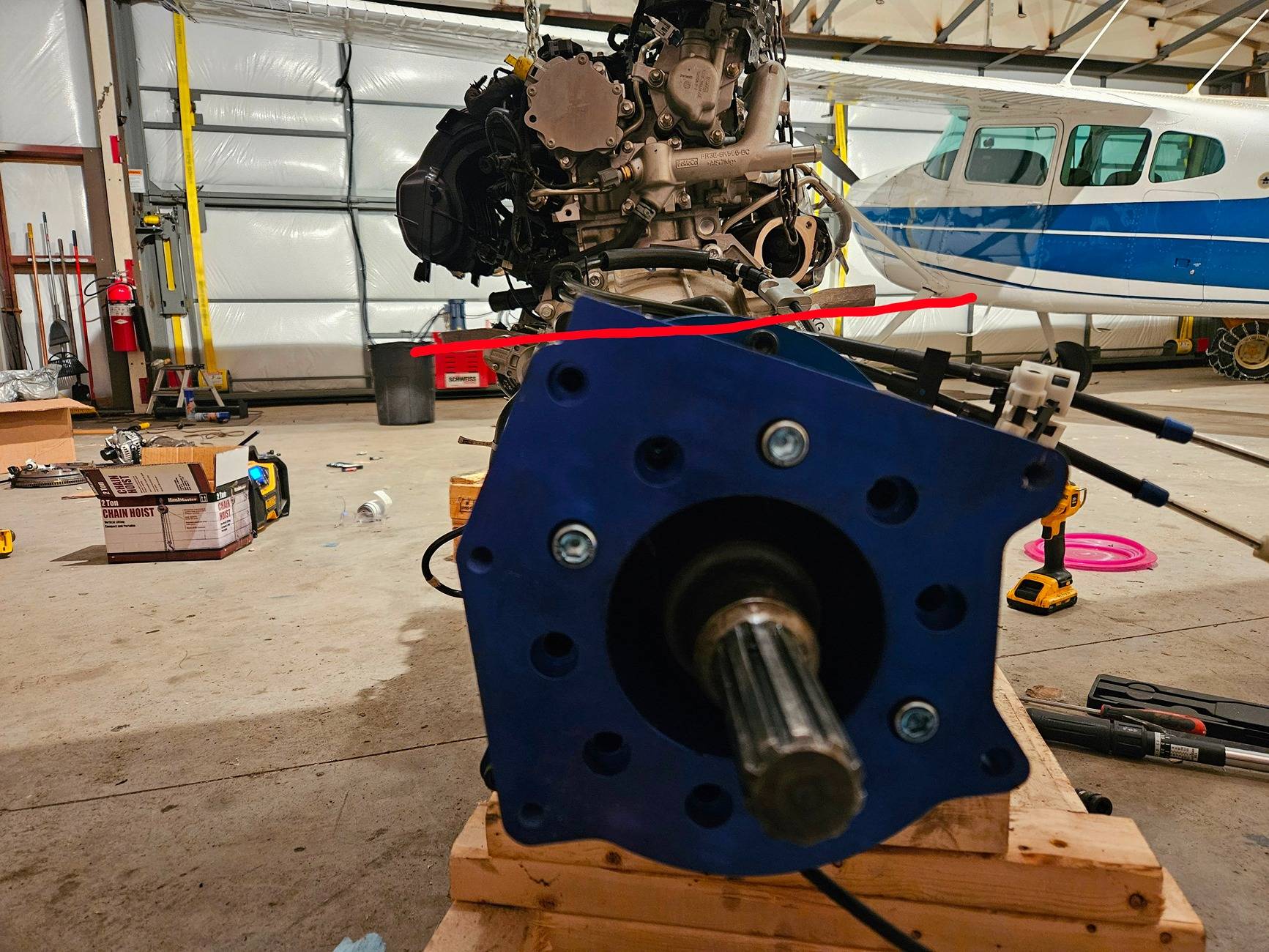

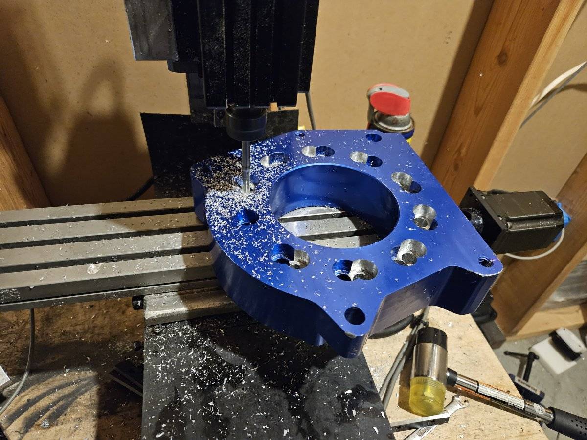

But then I ran into a snag while working on full drivetrain dry-fit. The adapter, at least in the land rover Discovery 1 has the transfer case clocked at the wrong angle. This will make it hang lower, and the frame mounts won't work, and neither will the shift lever. Luckily I do have a mini-CNC Taig Mill, so I will re-drill the bolt pattern at the correct angle, but it continues to be a set-back.

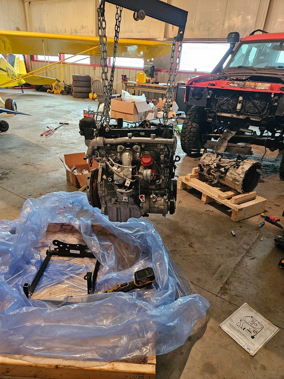

Once this is corrected - I will complete dryfit. Then I'll split the adapter and mount the transfer case in the Rover. Drop the engine in, measure for new engine mounts, send that to Send Cut Send, weld that up, weld it in and then the engine is in. I'm close... but always two steps forward and one step back.

Machining the adapter is done - one step closer. Transfer case is mounted. Though now I need to machine a standoff bracket for the shift linkage.
