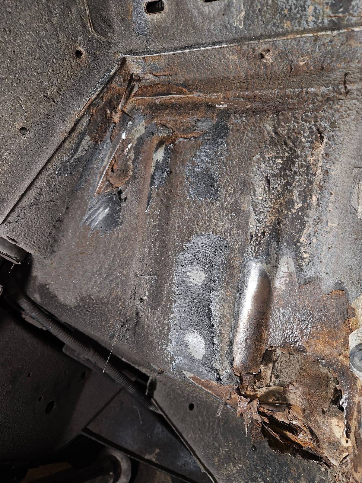

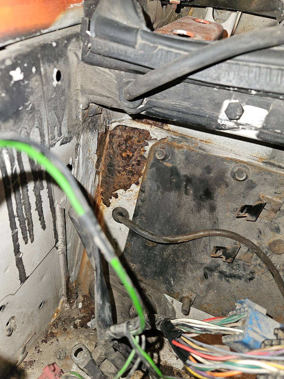

Latest update, I've bought a welder and am working to address several of the rust spots. The driver side fender/body is by far the worst of it. I've also got some body rust penetrations on the passenger side fender well up near where the washer fluid canister was. There is some sort of undercoating on the body, and I'm not sure if it was factory or not, but as I grind through it I end up finding more and more rust hidden underneath. So I get to do more and more welding. Luckily so far I've found clean metal around just about everything.

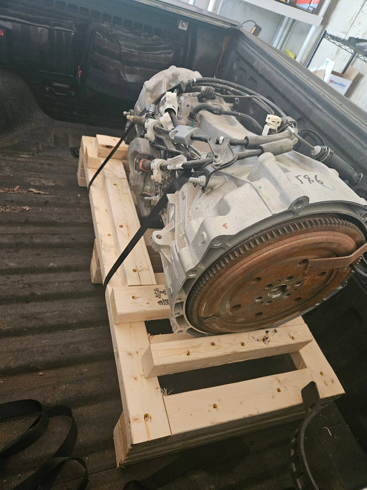

But in the good-news department, my transmission/Tcase adapter shipped, and my MT88 Bronco Transmission arrived (currently sitting in the back of my Ranger). The transmission was on a Bronco that was in a rollover accident with only 240 miles on it - so it's essentially a brand new transmission. I ordered the shifter assembly and clutch pedal from Ford so that should be arriving shortly as well.

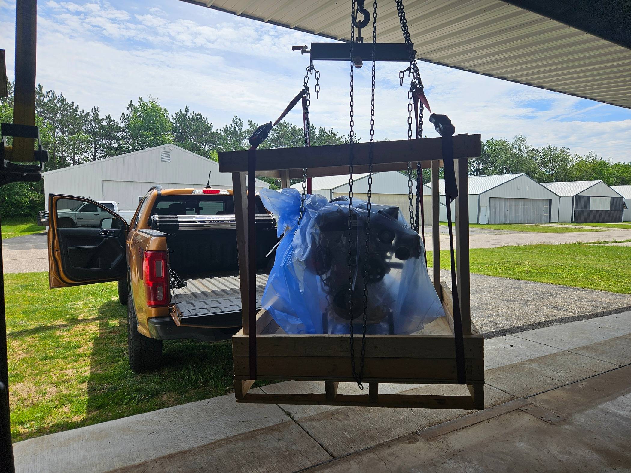

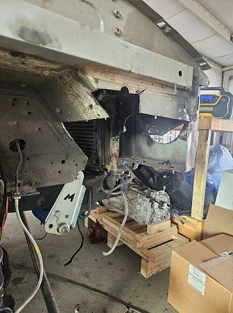

I'm still working through the last of the rust spots, but a week long vacation slowed down progress there. I did receive the Transmission to transfercase adapter from the U.K., and it bolts up flawlessly. So the hardest question of getting the Ford engine/trans to mate up to the Landrover is now complete.

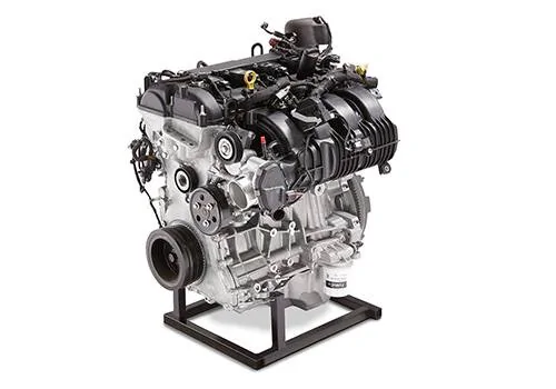

Since that's done I ended up buying the engine which should be here in a couple weeks. The High-output 2.3L Ecoboost was only $200 more, which gets me thicker cylinder walls, an upgraded head and some other design improvements. It also comes with a 63mm turbo which I'm going to rip off and put the much smaller Ranger/Bronco/Explorer turbo on. This is for two reasons, 1) I care a lot more about low-end torque and spool up time, than I care about top-end horsepower like one would on a Mustang. and 2) If I under-boost an overbuilt engine... the thing should last forever.

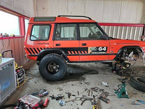

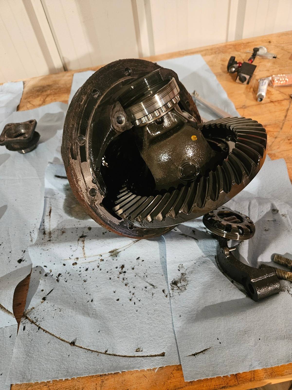

A few small things ended up slowing me down in my axle rebuild. A broken 1/4 BSPP tap for the air locker cost me the better part of a week, and my silly thought that freezing the pinion would allow me to tap on the pinion bearing without a press cost me a bit of time as I had to run to harbor freight and buy and assemble a 20T press. But I did make progress, the axle and diff is completely torn down, and new brake lines have been installed. It's a shame to throw out the old diff... it's in just about factory new condition I can't believe how nice it is. But as soon as my McMaster order arrives I'll be rolling and should have the front end taken care of in a day or two, then copy-paste on the rear end.
In my downtime it's allowed me to do some research and purchasing for the engine. I bought the A/C Compressor, smaller turbo, and 200Amp alternator from junkyards from low mileage vehicles. That being said I have run into a couple issues - I can't find what bolts are used for the bell housing to engine... Ford parts doesn't show it and when I called Ford parts they said they couldn't find it either.

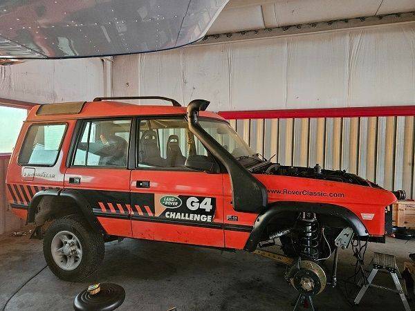

I'm still alive and still working on this project. I went and had a kid so that slows down progress ?.

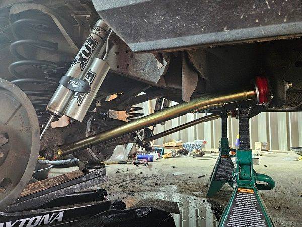

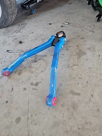

The undercarriage is done. I have front/rear Ashcroft air lockers in with 4.11 gearing. Wheel hubs are rebuilt with new bearings, and new rotors/pads on all 4 corners. Extended brake lines are installed and the brakes are bled. Suspension is fully rebuilt with Terrafirma radius arms front/rear. OME Springs, and Fox reservoir shocks. Chromeoly half shafts and heavy duty CV Axles are in. I also rebuilt the rear A-arm on the rear axle which was a real bugger with how rusted it was. I bought 35's Patagonia M/T tires. I think I purchased the last set of beadlock capable Terrafirma wheels on the planet, and of course the terrafirma beadlock rings are unobtainium so I had a set custom machined for me (still awaiting delivery).

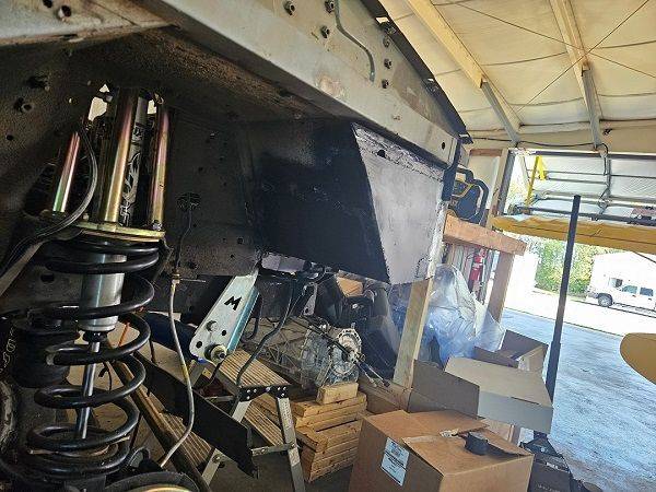

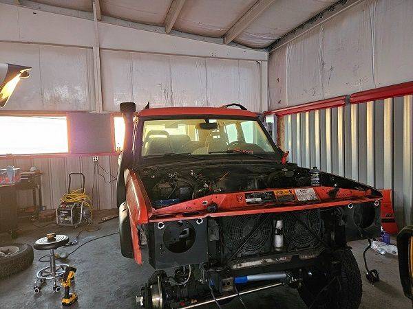

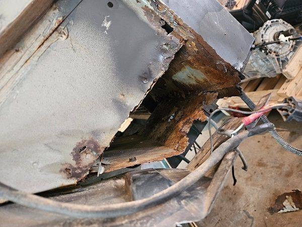

Then I found a BIG ol' pile of rust under the battery box. So I had to cut out the entirety of the battery box and fender and re-engineer and weld in a new battery box. It doesn't look quite factory but it'll do the job. I also got the LR3 snorkel mounted, it looks a little goofy from the front, but overall I'm happy with it. This allows me to have the snorkel on the side of the intake for the 2.3 Ecoboost, rather than having to do a crossover. I also have all of the trail armor purchased, just waiting for it to arrive at this point.
Next steps are (all easier said than done):
  • Mounting Clutch pedal, throttle pedal, and shifter assembly.
  • Test fit transfercase to transmission via the adapter
  • Mount the transfercase & Transmission
    • Connect & Bleed Hydraulic throwout bearing assembly
  • Install accessories onto the crate engine
  • Install engine & Fabricate engine mount brackets.
Sorry all for the picture-heavy post - I'm just excited to share :).
