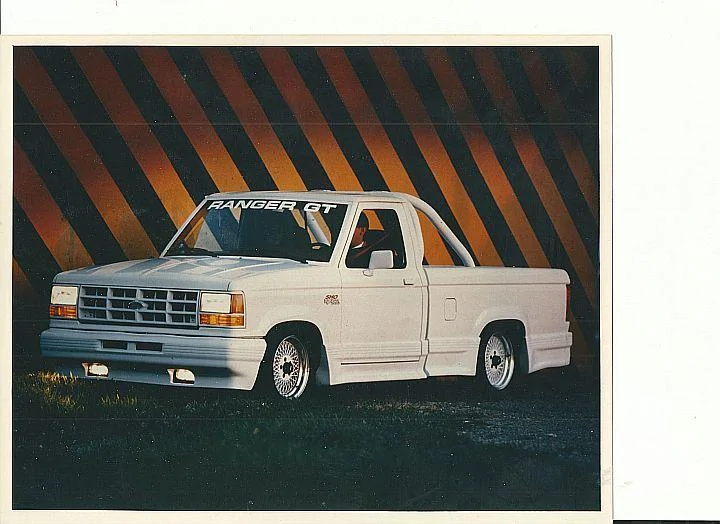

Hi Doc,
First was to modify the suspension for handling using parts from my Racing Ranger support of the SCCA RaceTruck series. Then Engine Engineering tweaked the ECM to raise the rev limit to 10,000 rpm. Fuel and spark table tweaked too. Needed Premium fuel only. Also, we raised the axle ration to 3.45 from 3.73. It was a manual trans and I could dust off anyone on the street without shifting out of 1st gear. The motor just screamed. We had straight pipes on the exhaust. Because the engine was for the TableSaurus, we had to cut the dash plenum to fit the throttle body under the dash panel...(many call it a Firewall, but we do not use the word Fire) I lowered the vehicle by cutting the front springs and we flipped the rear axle over to the top of the rear leaf springs. We had custom take apart shocks to tune the suspension. Automotive press loved it...but it served its purpose and it ended up being crushed at our source for crushing the vehicles, Environ. Loved that truck. I had a relation with Purdue University for advanced projects in the realm of adaptive engine mounts and drove it down to Purdue. I was pulled over twice in Indiana by state police, I was not speeding but the police wanted to see the vehicle and had radioed other state police to pull it over to take a look. Oh yeah...we had to increase the size of the alternator pulley to slow the alternator down. First alternator only lasted a bit over an hour before it threw the stator windings because it was spinning too fast. Original was about 3:1 and we slowed it down to about 1.9:1...

This is very interesting as well as cool!
I’m no mechanic (parts changer)
As you might have noted, I’m interested in lowering the rear for the purpose of drag racing.
I’m 69 now and can no longer drag race my motor cycles ( scared I guess).
When you do an axle flip, how do you address the pinion angle?
Thank you again for your informative posts!

Hi Doc,
We cut the axle to spring brackets off the axle and the fabricated new axle attaching brackets. Then rotated the diff to align with the driveshaft. It was held in place to the spring with longer u bolts. We set the pinion angle with an inclinometer on the pinion flange and tacked the axle tubes to the brackets. Then pulled the axle out and finished welding the fabed brackets to the axle. I think the aftermarket picked up on this and that there brackets out there to do this without all the fabrication. I used Livernoise Engineering for most of this work as the Experimental Garage was always too booked and they were mostly parts changers anyway.
This became a go program and we were going to retool the intake and throttle body for North-South installation but we had one problem. We had no room to mount an A/C compressor thanks to the huge XR50 Steering Gear that Ranger used at that time. Marketing said no way with no A/C...so the program died, but the vehicle was a blast to drive...
I seem to always get involved with these one off skunkworks projects and it made it so much fun to actually have a company, Ford, that provided the sandbox and the toys and I got to come in every day and play...:)
