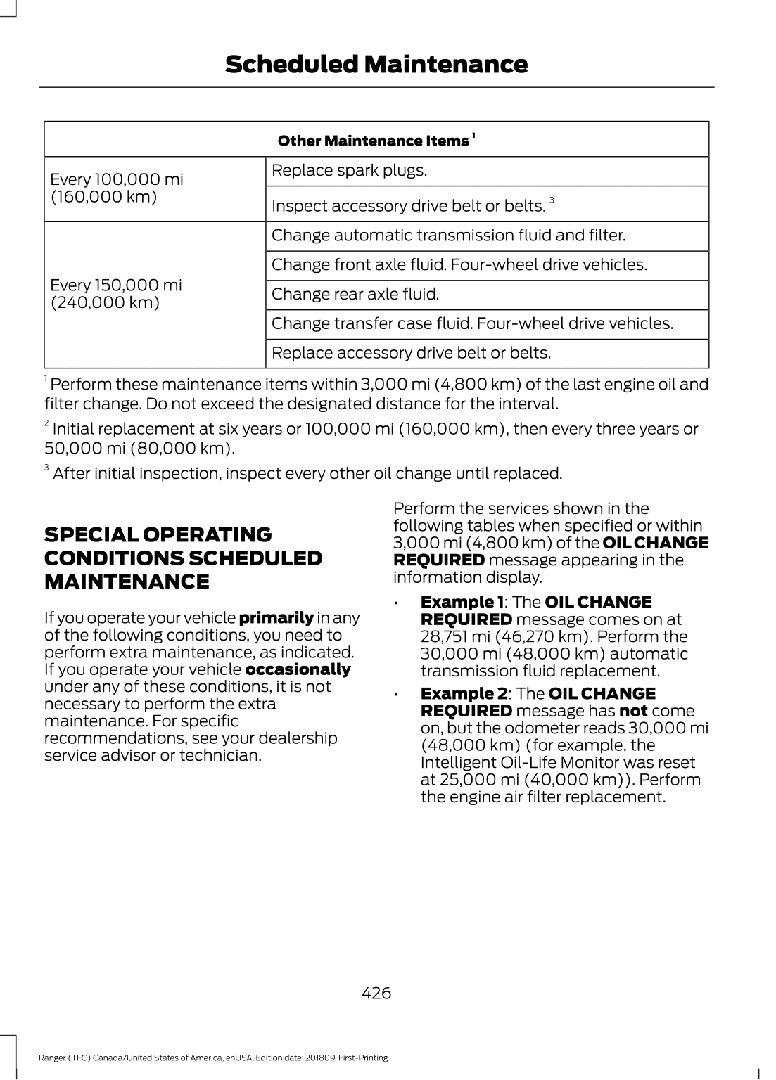

I highly doubt there’s a transmission dipstick. You service the fluid when it hits its maintenance interval, otherwise you leave it alone unless you get a check engine light triggered by a low fluid quantity code.
I’ve noticed them being phased out. My wives Toyota minivan has “lifetime” fluid. But for a truck Towing a heavy load it would be nice to be able to change it. And to know how much to put back in.

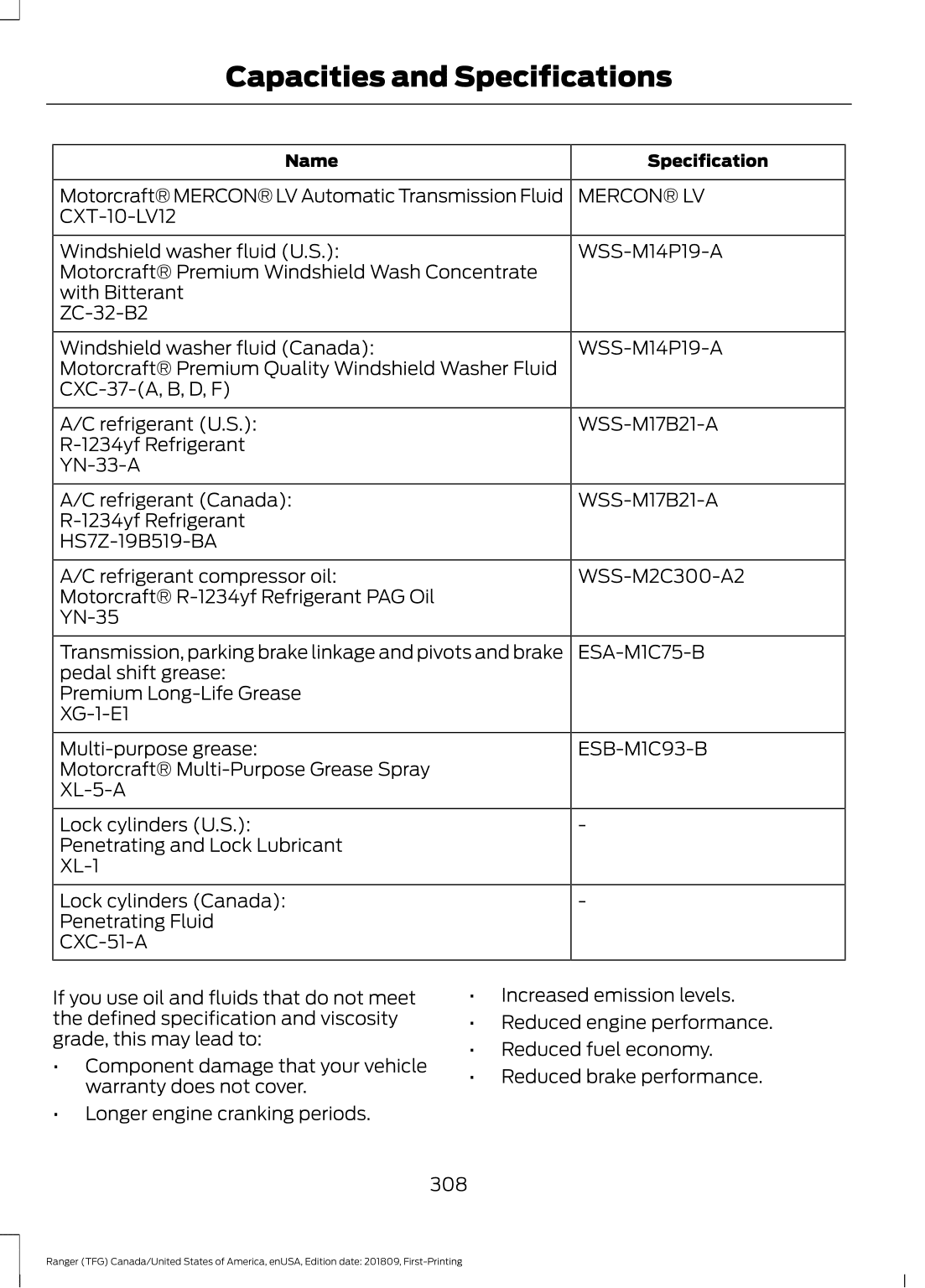

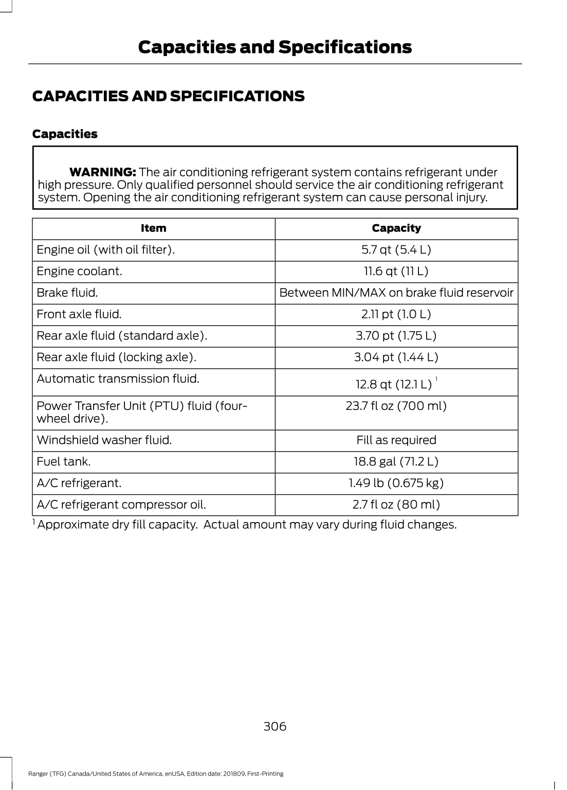

I have attached the relevant pages from the owner's manual. Short answer is 12.8qt (12.1 L) of auto transmission fluid every 150,000 miles.
