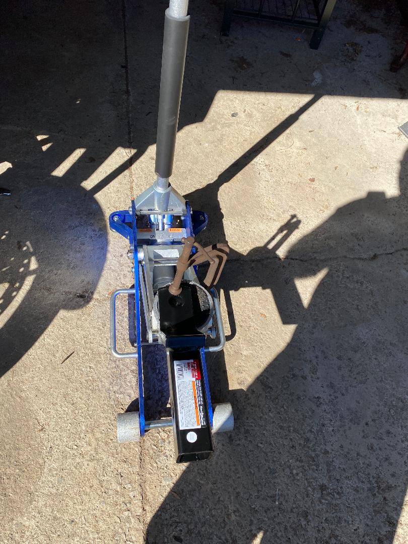

I installed a Curt hitch I bought off eBay by myself. Not normally a big deal but I've had both shoulders operated on an can't lift like I used to. When I was 17 I had a Mustang II with a 4 speed. I had the transmission repaired, I slid under the car with the transmission on the my chest with a bolt in my mouth, lined up the fly wheel an throw out bearing an slid it in an slapped a bolt on. Ah to be young.
I clamped the receiver onto the jack (had to partially jack it up some).
removed the 4 bolts, rolled the hitch under, jacked it up an started the bolts.
Not too bad.

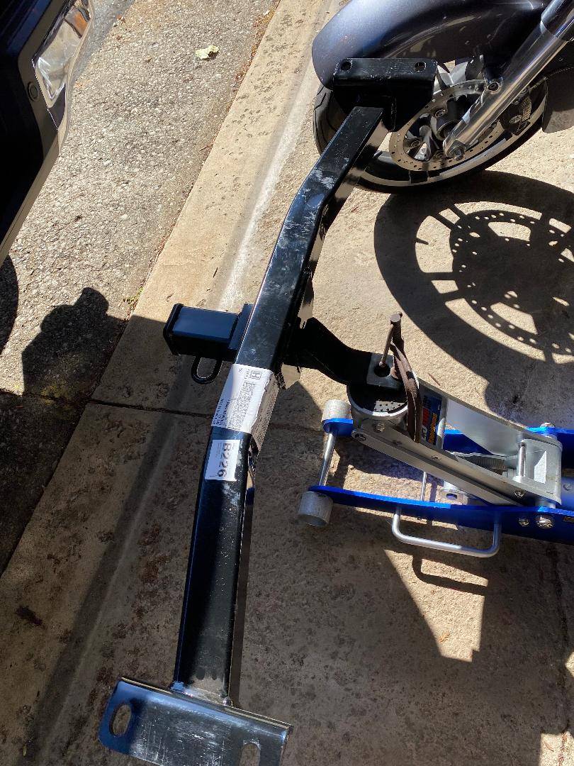

Looks like it will interfere with a larger spare tire. guess I can just have it off center a little.

You do realize if you bolted it in like your showing it, you have it backwards. The end you have the hitch inserted goes under the truck.
yeah....that was a test fit while gathering all the tools an filling the air compressor. Had to make sure it would support the weight before getting the breaking bar an big pipe out to crack those 4 bolts loose. Directions said to torque them to 196 Ft pounds!

I'm in the same boat.....DIY'er 63 year old that has added breaker bar, cheater pipes, , ratchet straps and extra Jack's to my arsenal of tools....I have found ways to wedge my breaker bar or Torque wrench on my floor jack to deal with bolts that have been or require being torqued to over 120 ft lbs..

Cleaver trick, I'll have to remember that next time. I instead man handled it all like an idiot.
