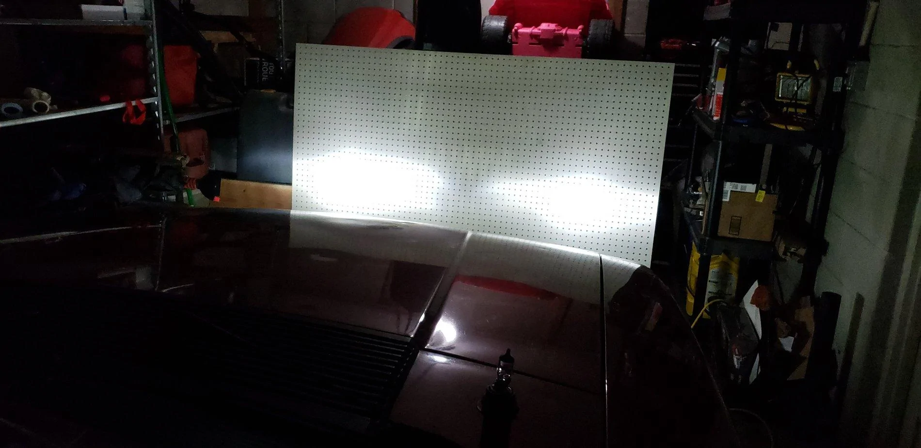

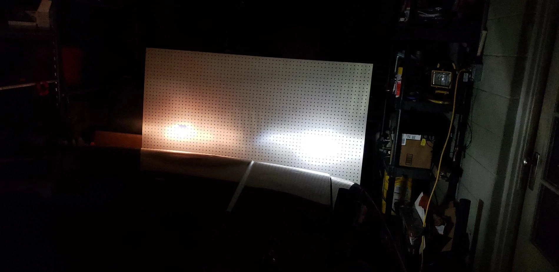

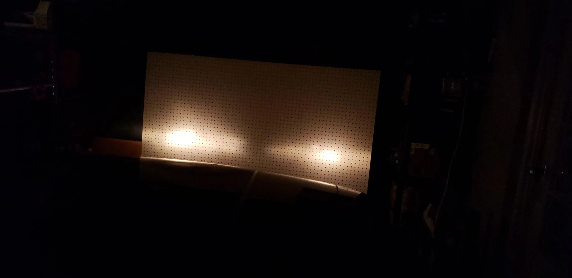

The statement about LEDs having poor beam patterns is not true for all LED bulbs. The ones that have slim arrays and thin boards are designed to mimic the filament of a halogen bulb. Those ones have a much better beam than the old design with chips like the cree xhp series (square array with a clear dome). I recently swapped my fox body headlight bulbs and the led beam pattern is nearly identical to the halogens. It's hard to tell in the pic because the led is so much brighter, but in person it looks fantastic. For one of the cheapest LED kits on the market, these Hikari bulbs rock. Once I get my ranger I plan on opting for a more expensive (still under $200) led such as the Hikari Ultra, DeAutoLED or Lumibright.
I'm not saying not to get the Lariat assembly. Just dont do it solely because you think the drop in LEDs are bad. You just need to do a little research before you buy. There are lots of LEDs with horribad beam patterns, but the technology has advanced to where there are some really good options.
