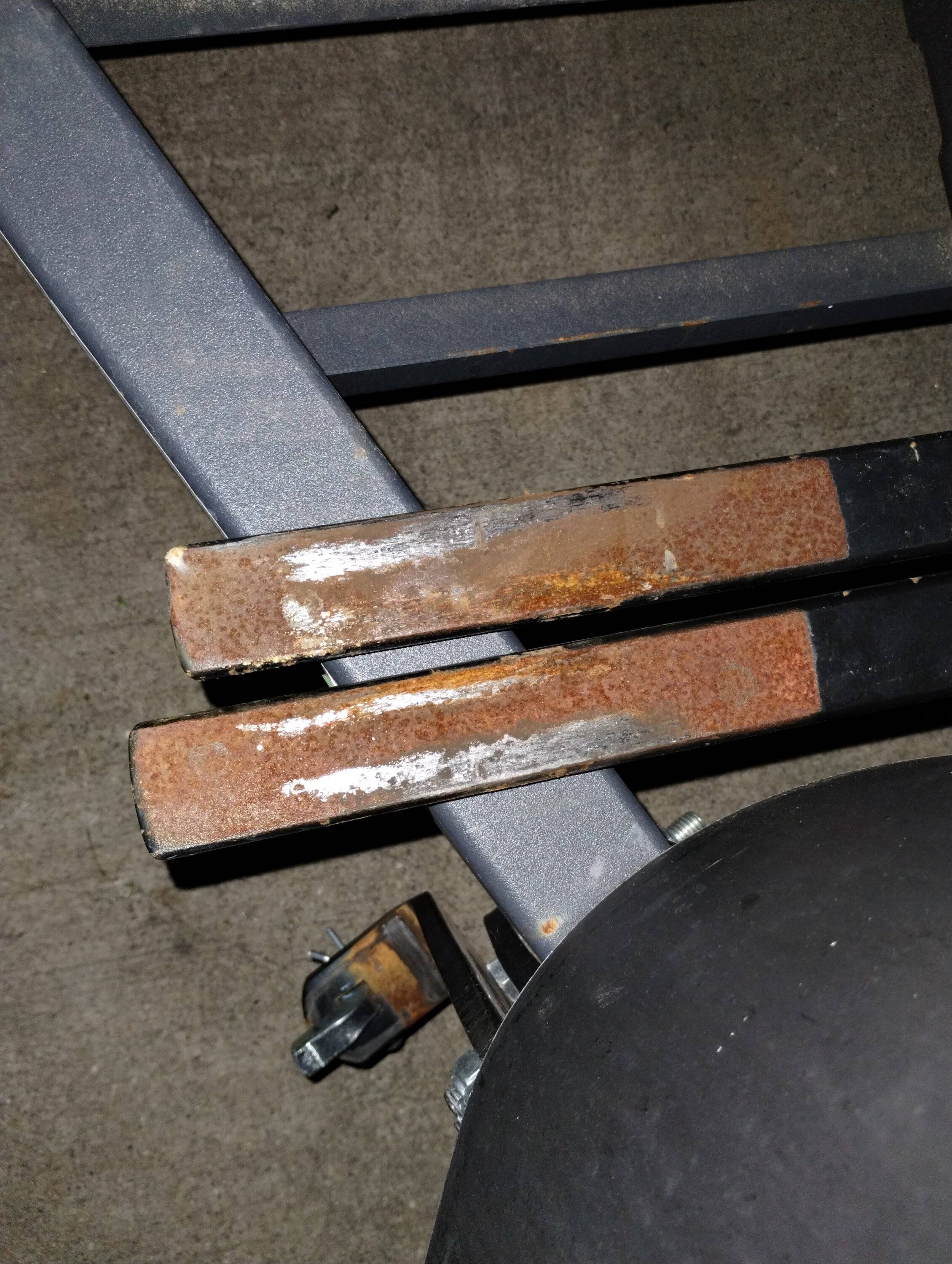

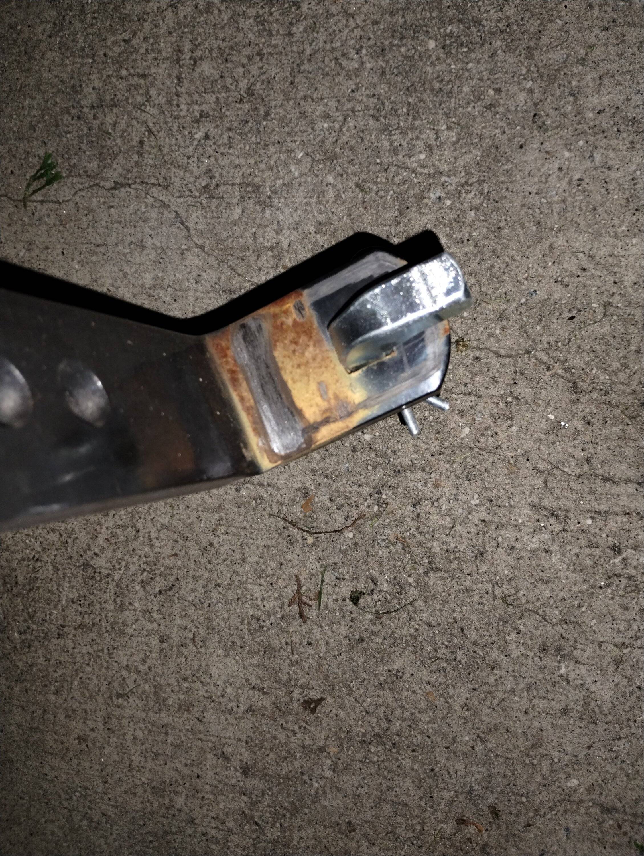

So I am starting to think I have a hitch problem or something .
Added Sumo springs, reset the wdh, and pumped tires to 40.
Tows fine at 60, anything over that and it sways terribly.
Looking at the bars when I got here, I only have about a 1/4" of shiny area on each bar, so am not getting nearly enough friction.
Guess I will try to shim the L brackets for better contact.
Sounds like you've got the truck and hitch pretty well dialed in. Might be a few tweaks left. Since the issue sounds somewhat speed related. One thing that hasn't been mentioned is the trailer and its suspension.
What tire pressures are you running? Soft trailer tires will cause sway to build once it starts. Are they balanced properly? Is the trailer loaded evenly side to side? Not sure of the suspension type, but is it alligned properly so the trailer pulls straight?
Just a few thoughs as it seems you are having trouble dialing it in. Your Ranger should pull that trailer like a dream.

My E2 bars have been living outside on the tongue of the trailer, so they have developed a nice coat of surface rust and I don't have the best contact patch either. They creak, groan, and bump when I'm turning a corner, so there's a decent amount of friction there even with the 'not full contact' (yes the pin is backwards, I store them like that for some reason)
