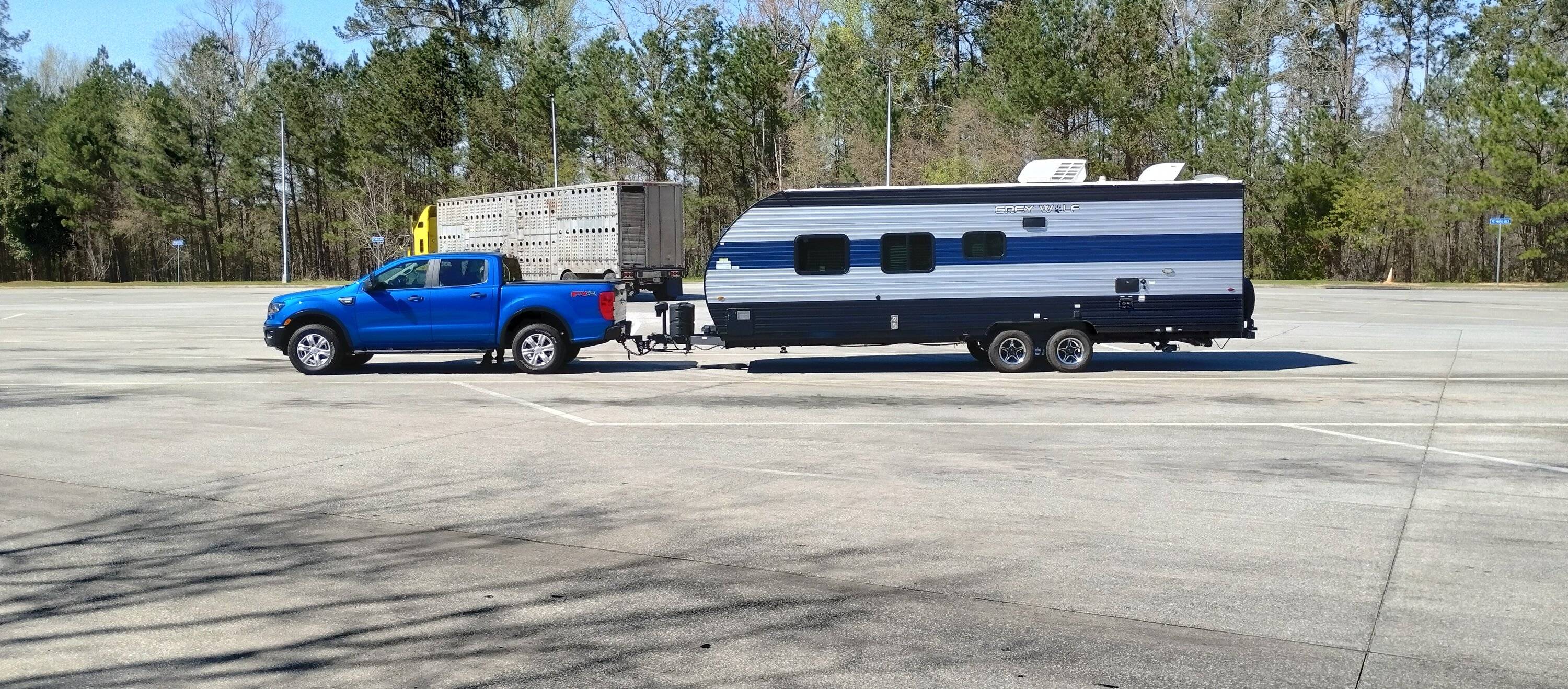

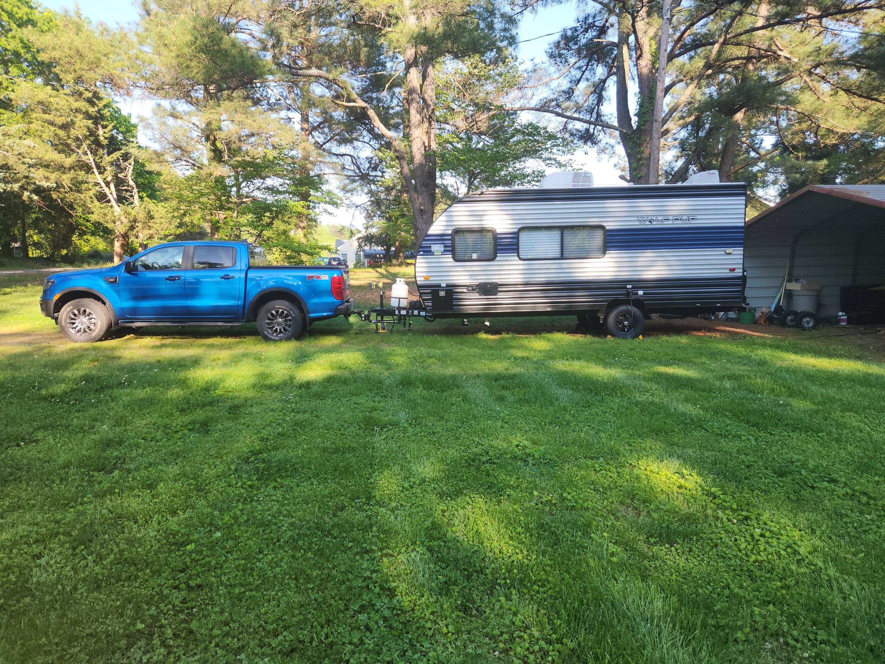

I too had to get an extended shank for my E2.
First pic is the standard shank on the lowest level (The ground isn't exactly level in this pic, but you can see that the trailer is nose up). The second pic is the extended shank. Trailer is ever so slightly nose down.

Re-reading your posts, I'd bet money that you're going to need the drop shank. The Ranger hitches are just flat-out high and require them most of the time. Sucks, but it will be $80 well spent to get the trailer level, especially with a single-wheel unit. Those tend to be a little more wiggly than the tandem axle models. Before you go spending money on the CAT scales and tearing into your setup, sit the truck and trailer on level ground and make sure that you can get it at least level if not slightly nose-down with your shank. If you can't, order the drop shank, there's little sense in going further into the setup until you get that problem corrected.

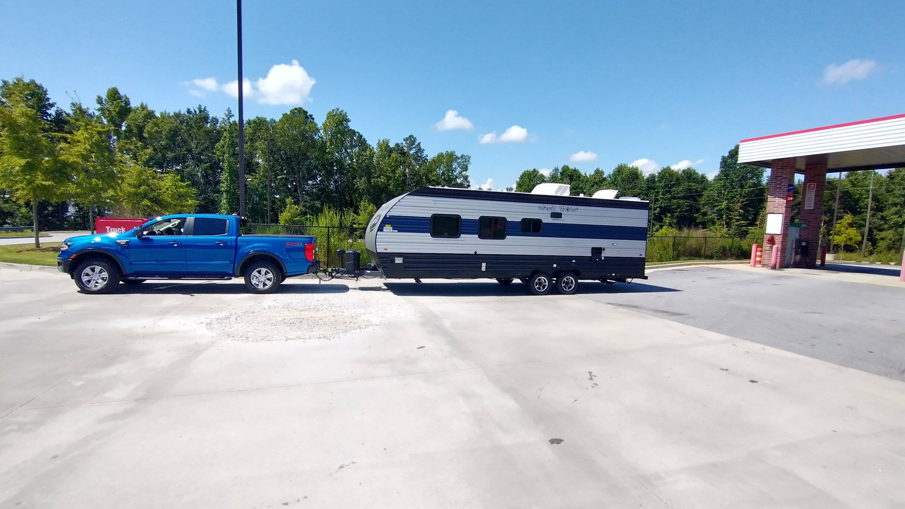

Sorry to be critical but the angle of this shot does not show well the level of the trailer. It may be fine but the picture distortion still makes it look a little nose high if that is what your trying to show. Picture needs to be full on square to the truck trailer similar to what @ctechbob showed above.
Yeah I know but it's the only one I have on my phone,
I drive a tractor trailer and am on the road.

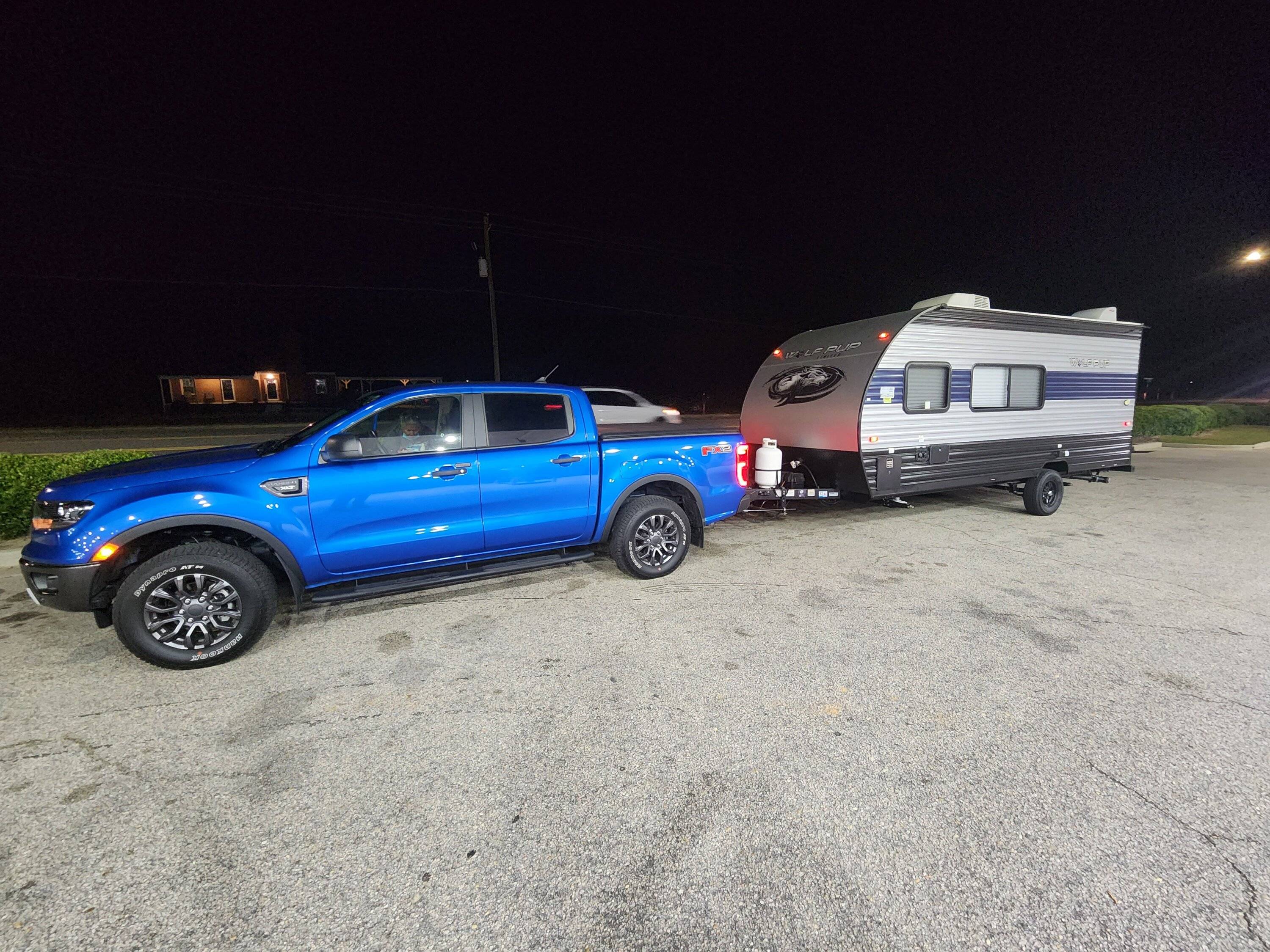

This is dropping the head 1 bolt hole on shank.
My empty measurement on front fender was 35.25.
No bars is 36, with bars 35.5.
That comparable to what the measurements were before.
Do I need to take more weight off the steer?I don't have my solo stove or 39 lb grill in the truck bed.

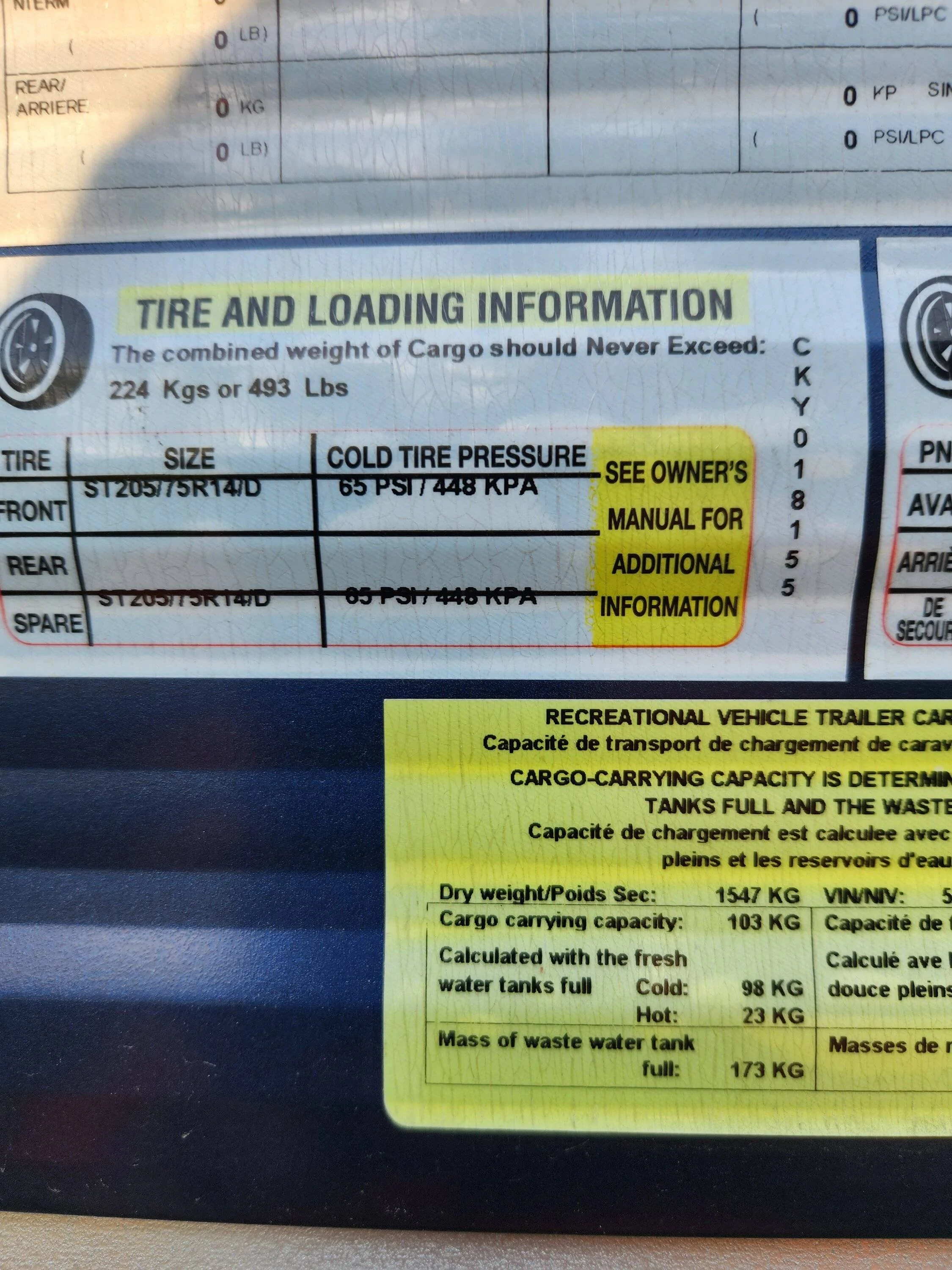

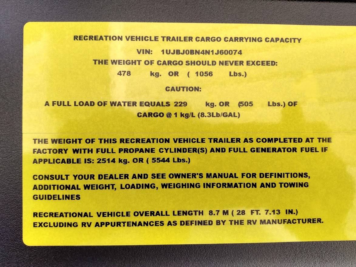

Rick, somewhere on your WolfPup there should be a sticker like I have posted...it will give you the weight of the trailer with any options like ac, awning, ect, and a full propane tank/s, but minus the battery. This weight is taken as the trailer leaves the factory.

I just saw your photo and it looks like the set up is good....just a bit low at the front of the trailer which, if it were mine, wouldn't bother me at all....sometimes level can also be bad as it can still mean more weight is at the rear of the trailer.
Better to be a bit low like you have pictured.

Dry weight sticker says 3410
