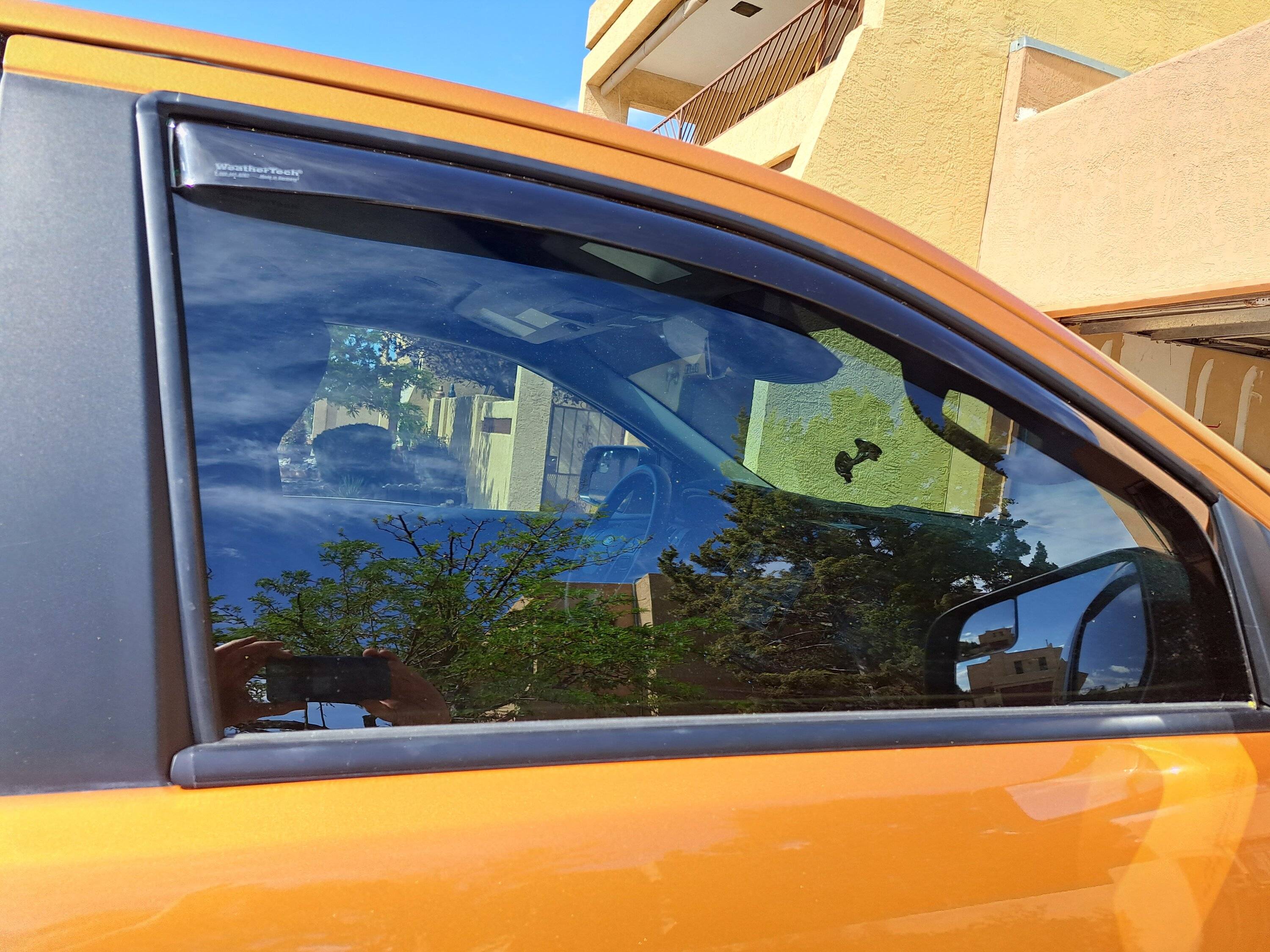

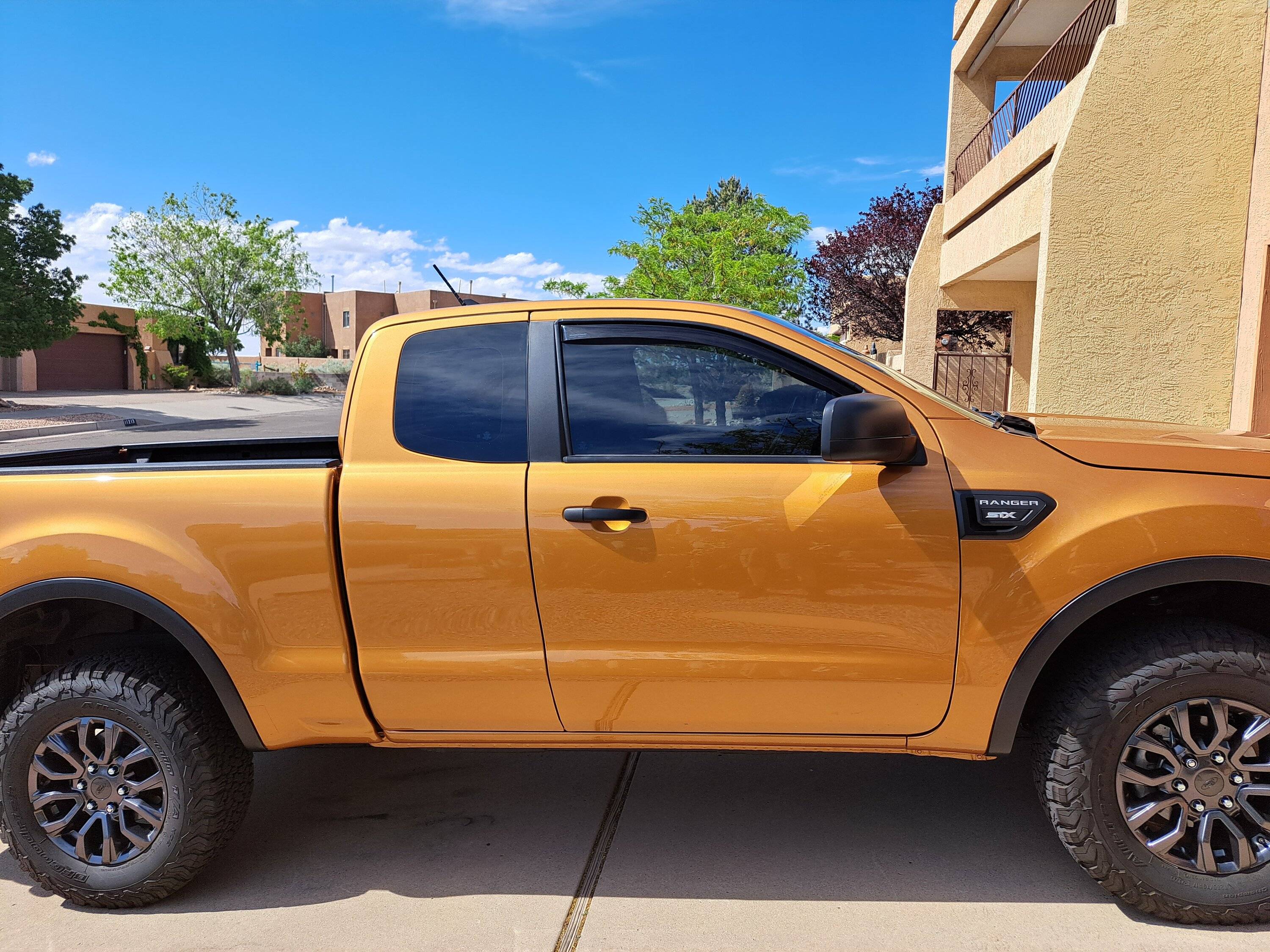

OrangeStreak
Aug 18, 2020
3,195
13,984
New Mexico
That's gotta be frustrating.
You've tried the WeatherTech?
I've had two sets, two different Rangers, both sets work perfectly.
