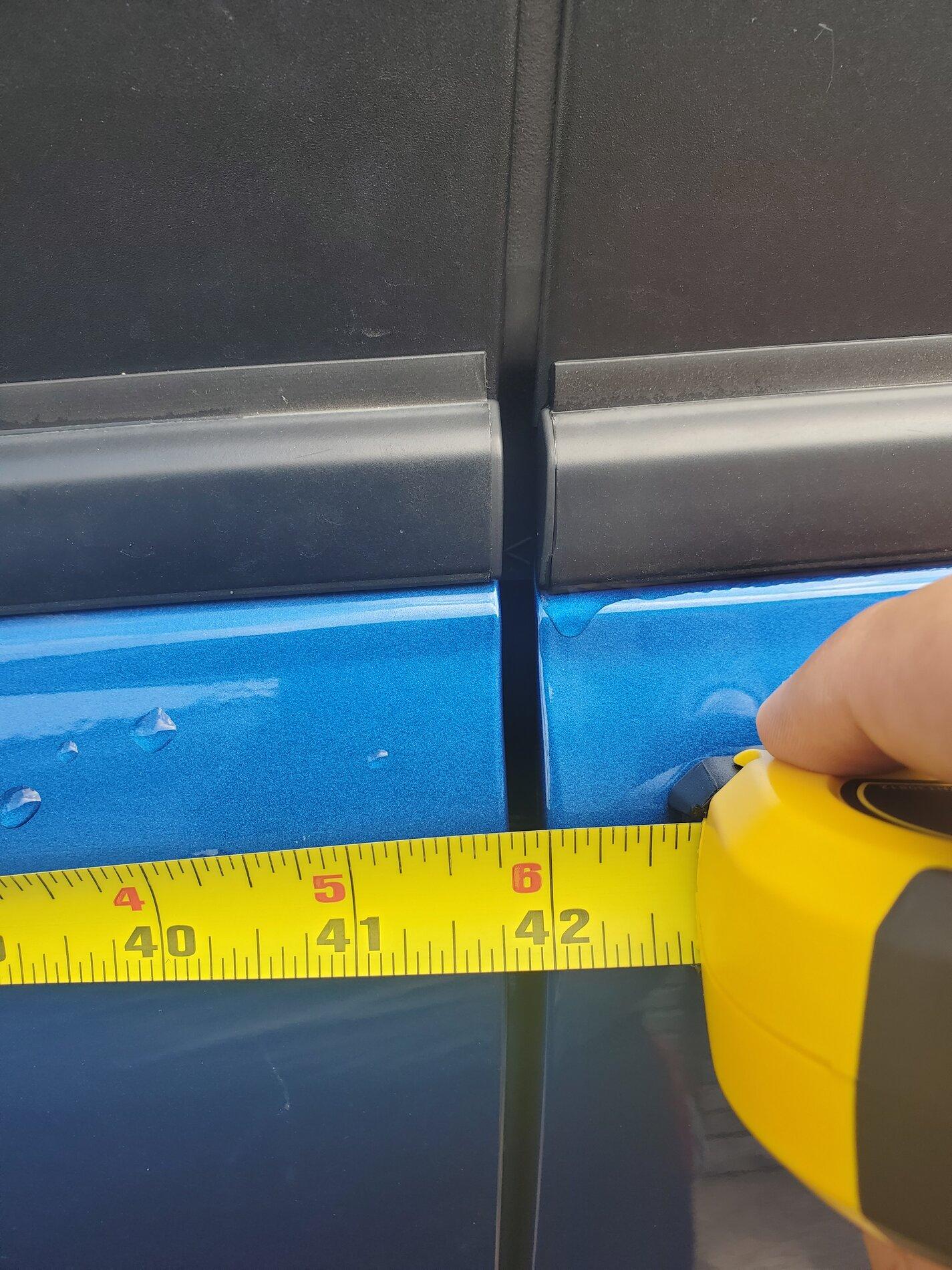

Are SCab and SCrew front windows different ?
Yes. Pretty sure the SuperCab door is a couple inches longer (front to back).
My SuperCab is 46.25" front to back at the crease just below the mirror.
Somebody measure at the same spot on a SuperCrew??
Deltasix109
Apr 30, 2020
59
172
Charlotte, NC
2019 Ford Ranger XLT
Door panel on the supercrew is shorter. Approx 41 5/8"
