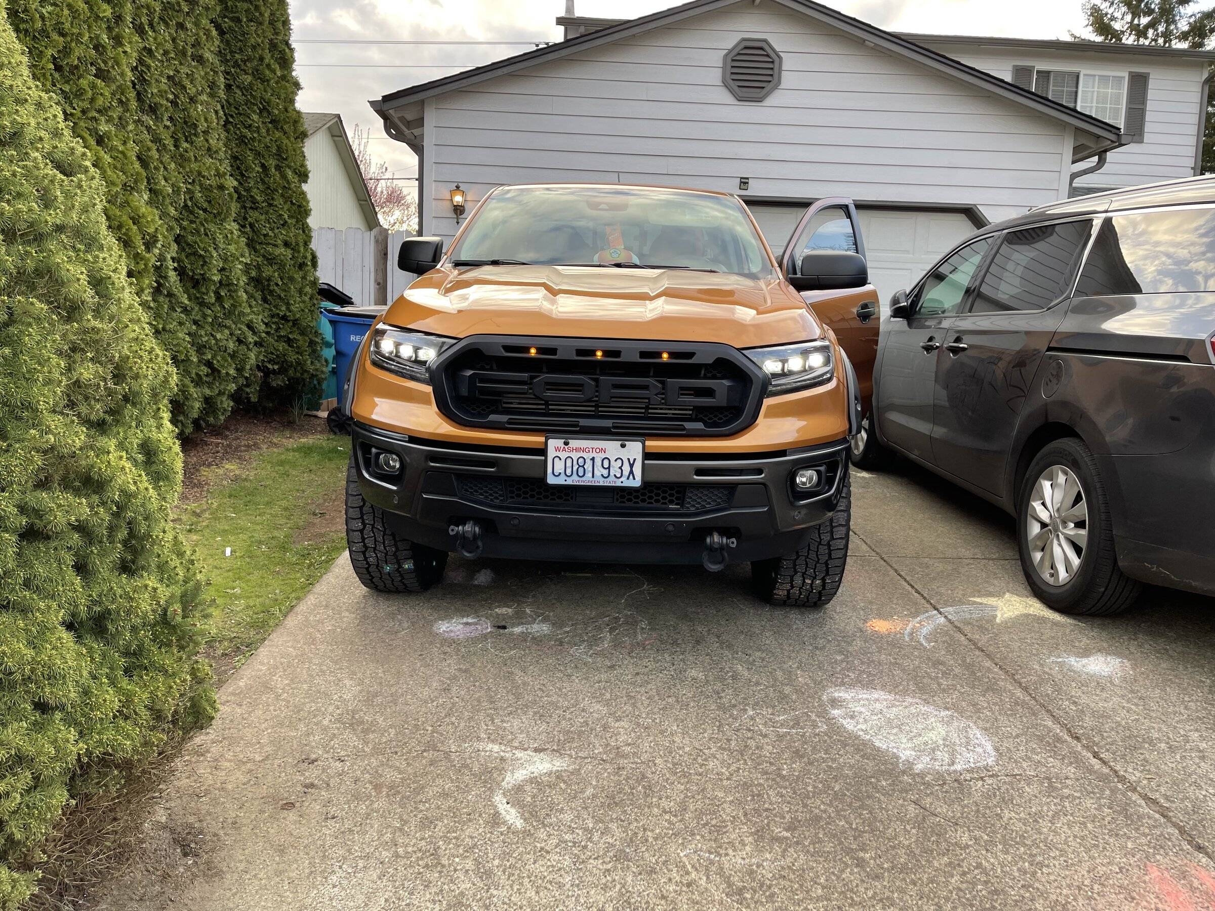

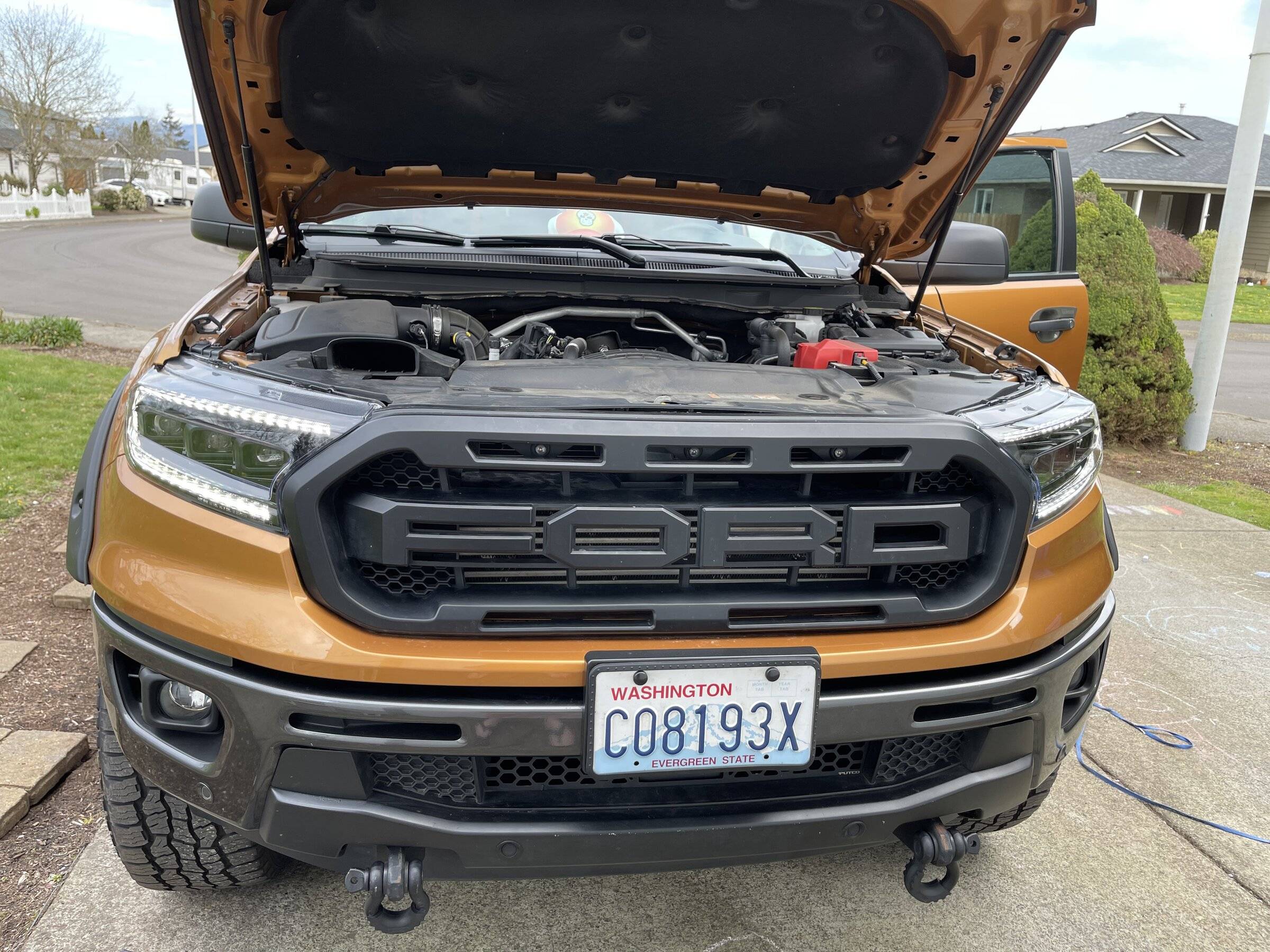

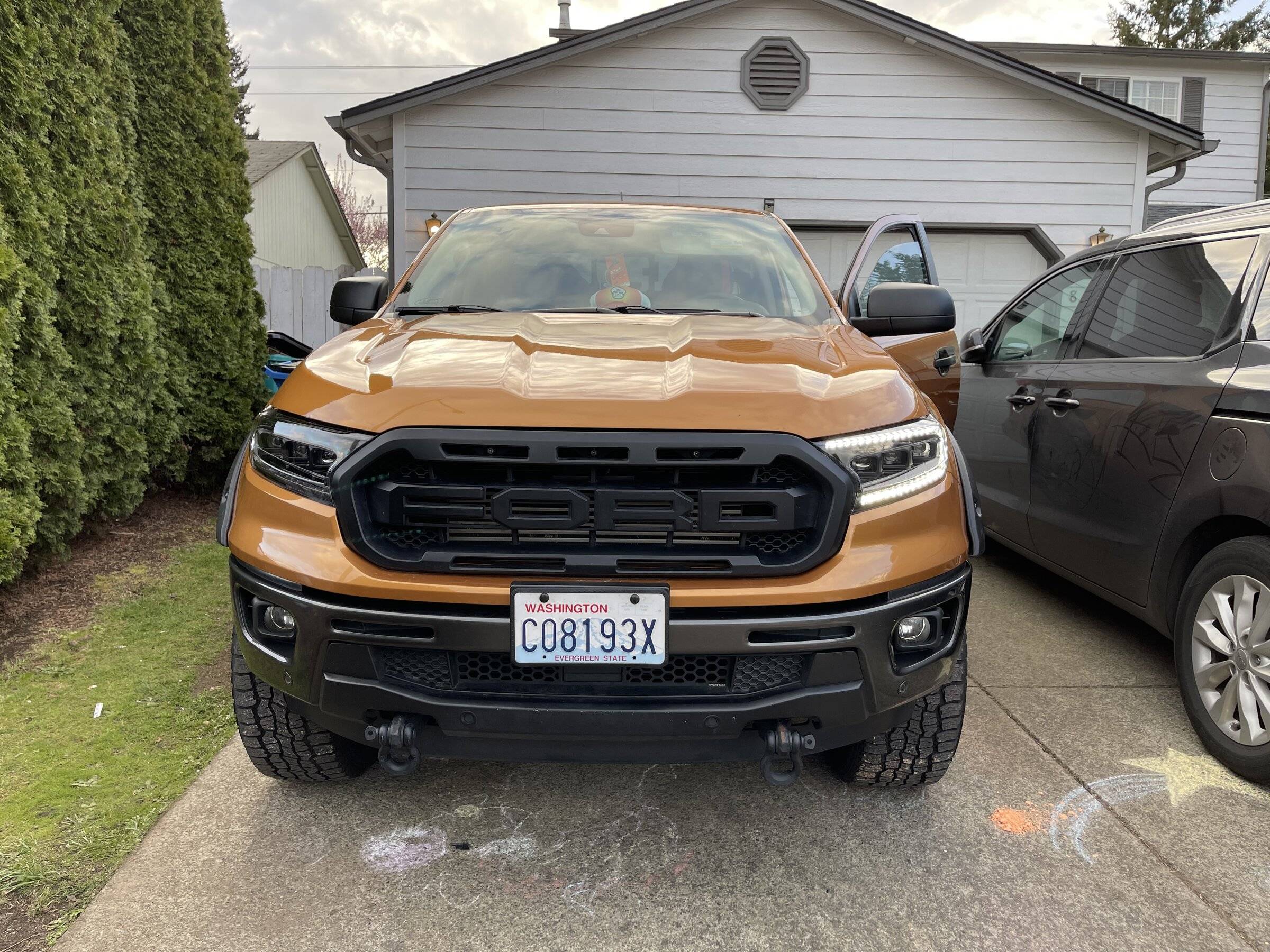

So I installed the Morimoto XB headlights and realize I have a problem with the passenger side. When the headlights are turned on they work fine, but when the day runners are on the passenger side doesn’t come on. Also the passenger side blinker is glitchy. It’s super choppy instead of nice smooth chase effect like the drivers side.
Anyone have any ideas or advice?
thanks!!
thanks!!
Problem fixed!!!! The drl cable had a slight bend in the pin. Straightened it out and voika.
