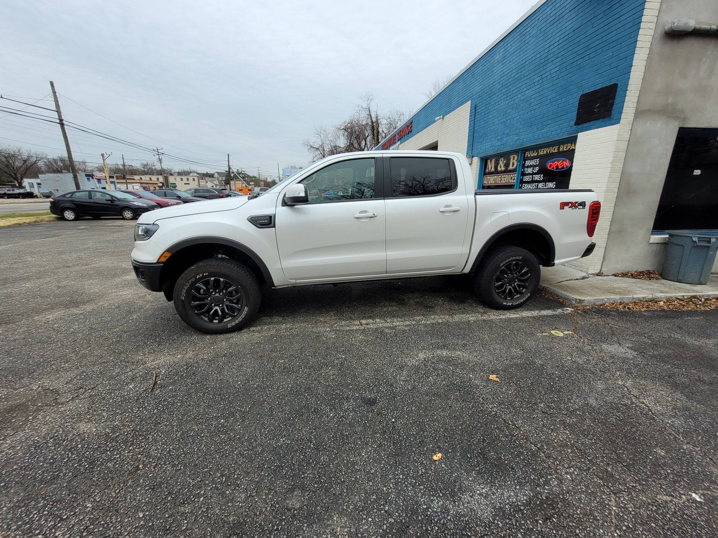

2019 crewcab lariat fx4
Chef
I have Eibach pros with 1" blocks and Icon ucas. Did I absolutely need them? No but they do make a diferenxe in ride quality and articulation
