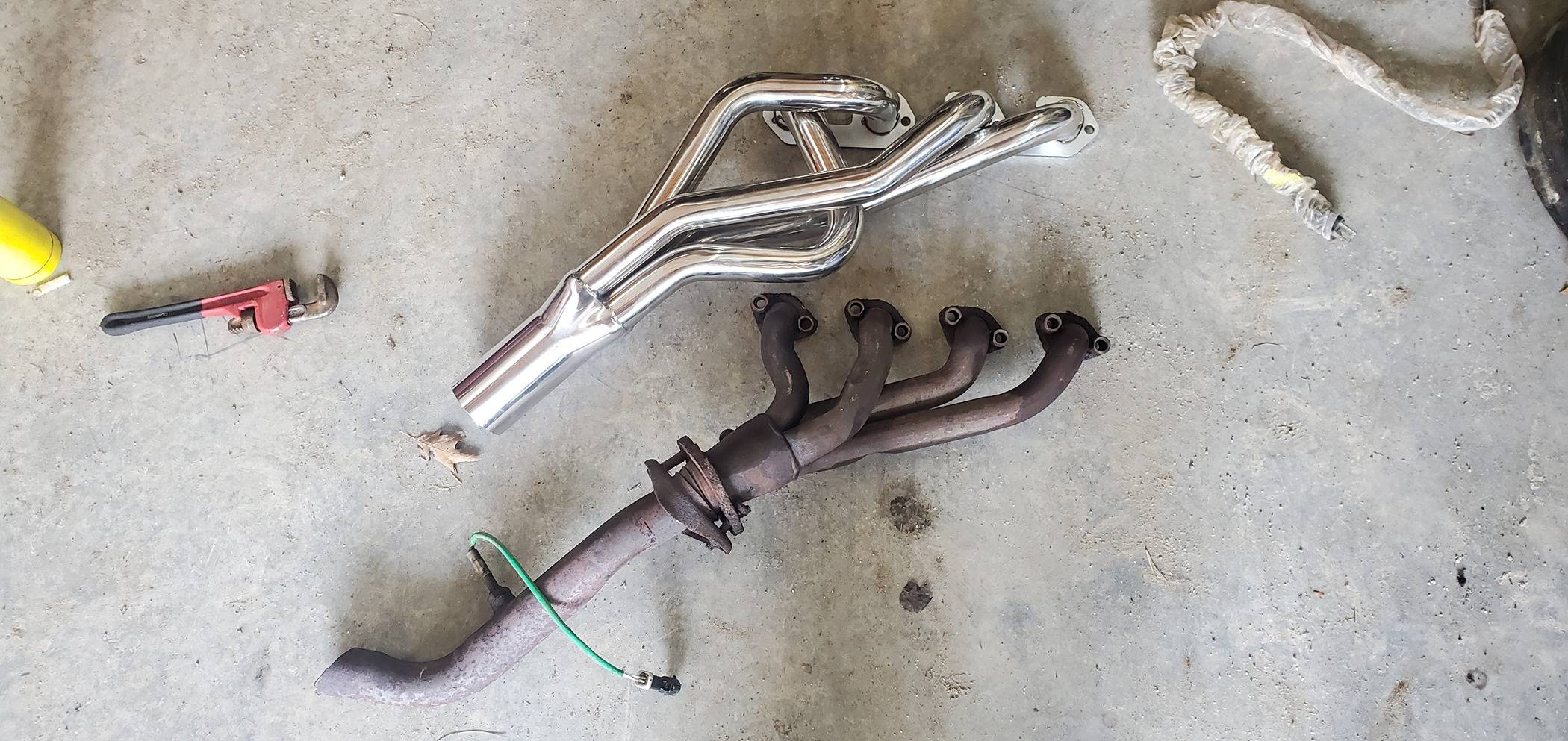

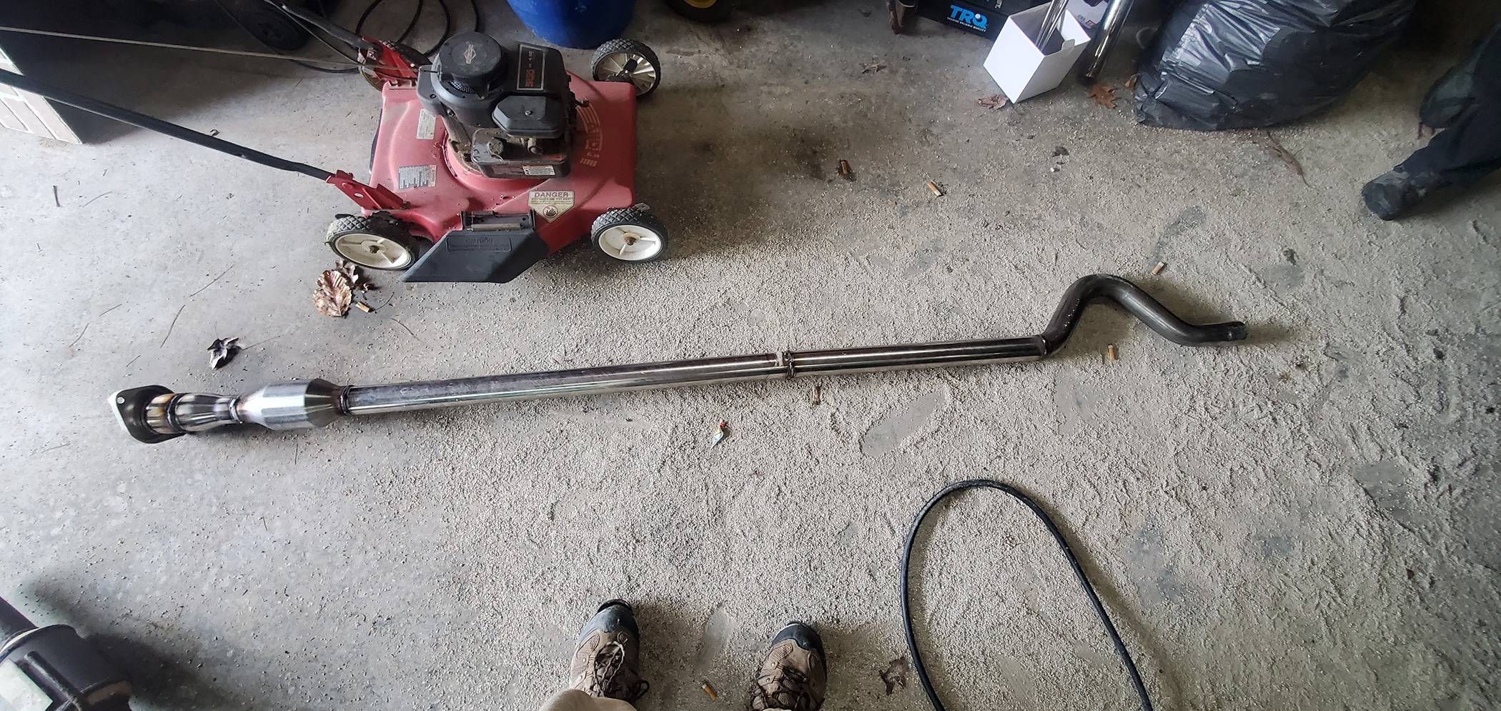

I decided that just building it a new exhaust from its factory header to the rear wasn't going to be enough work... so I decided to go full ham and get some shiny new mid-tubes to compliment what i was already planning ?

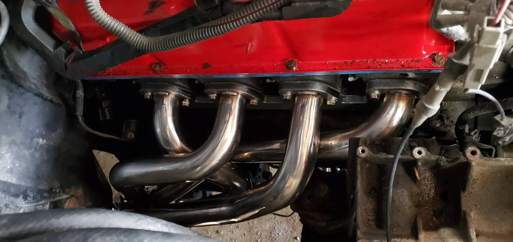

The header is listed as fitting 74-80 pintos and 82-92 rangers.. but fits a 96 most excellently.. with the exception of no EGR provision. Not a big deal.

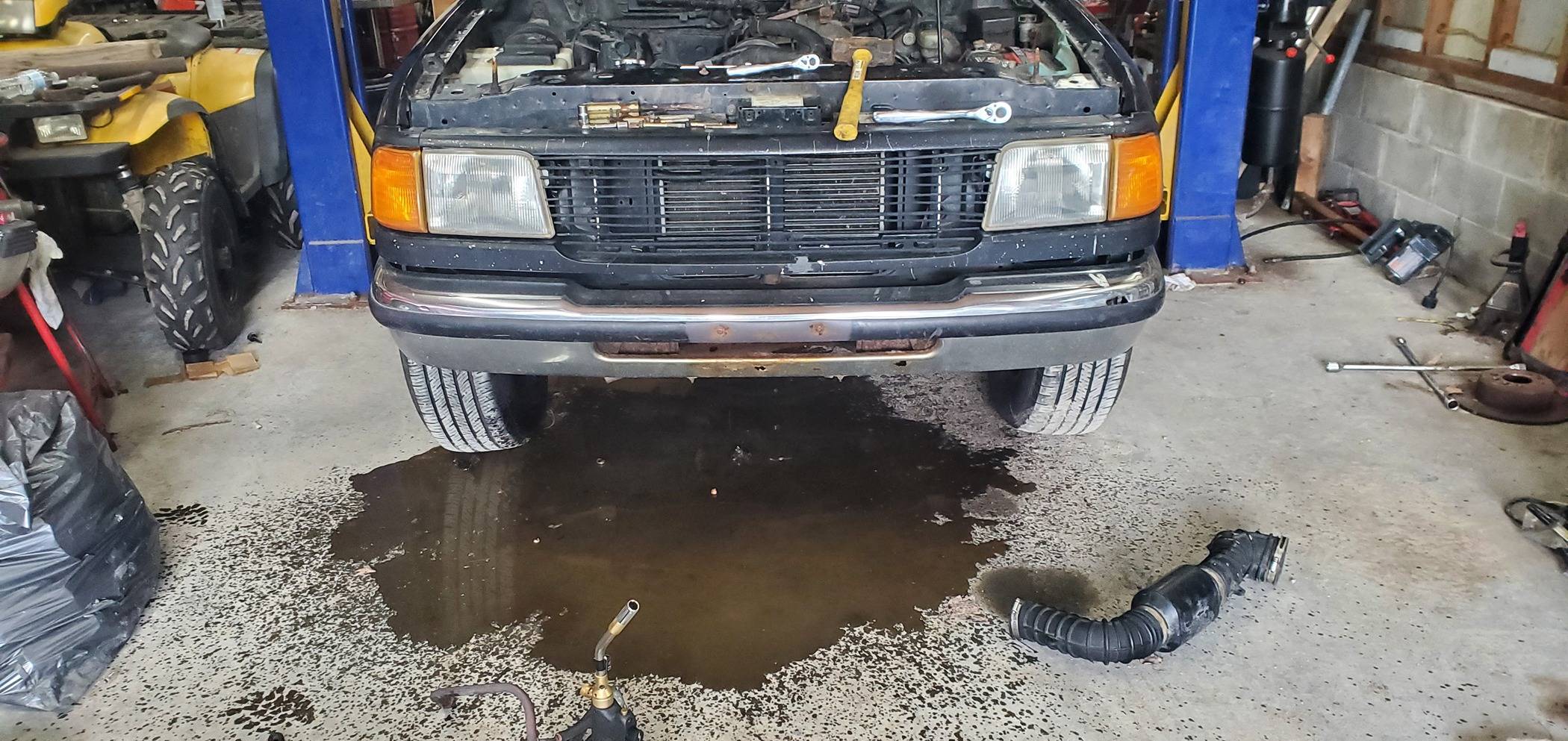

The job wasn't exactly easy.. but also not terrible. Removal of the alternator bracket was necessary to wiggle it in there.. and had the side effect of causing some coolant fitting to lose its fitment and dump my rusty "coolant" all over the floor... oh well. There are worse things to bitch about.

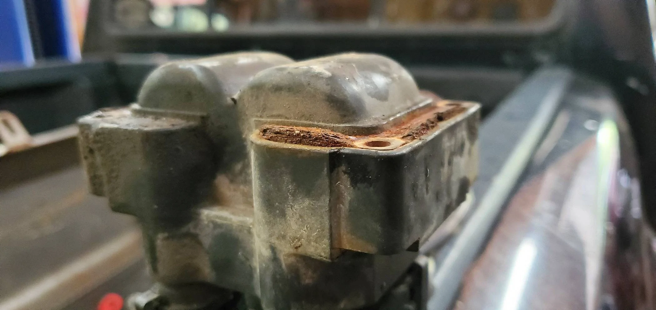

Also found out that the mating surface of my coilpacks have definitely seen better days.. thanks salt-belt! Probably be a good idea to replace them.
With any luck.. I'll be able to build the rest of its exhaust next weekend. I'll be reducing the 3" collector down to 2.25" > universal hi-flow cat > canister muffler > piped out to the stock location.
I would of purchased 2.5" or 3" diameter stuff for the remainder of the exhaust if I knew I was going to be putting an aftermarket header on it... but me being me decided to change course after I had already bought all the 2.25" stuff ?‍♀?‍♀

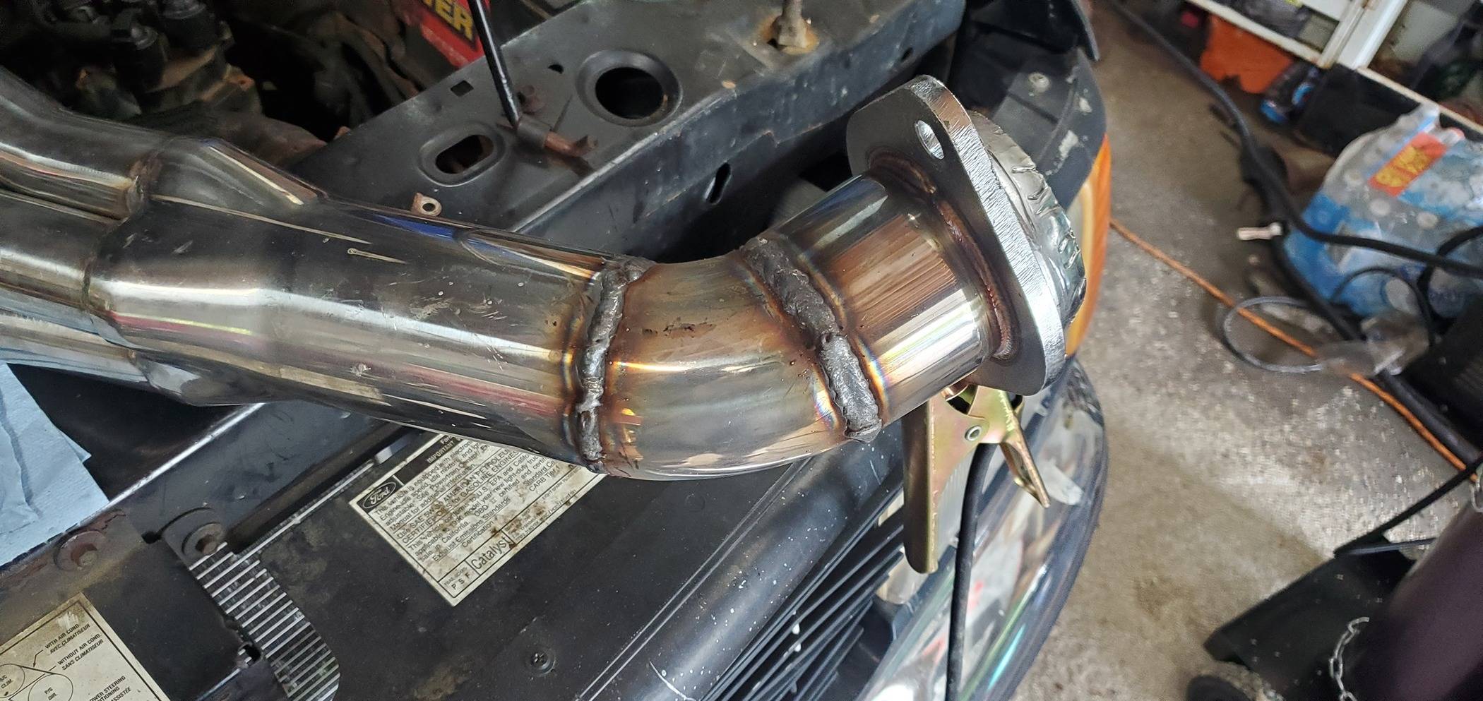

45° and a donut flange kit welded onto the header.. would of preferred a ball&socket setup but they were 3x the price.. and this was SUPPOSED to be a cheap exhaust ? I think I'm up to around 430$ or so..
..And got the collector-back pretty much finished up. All I got left is cutting in for the muffler, adding hangers, making a couple bungholes for sensors, and kicking it out the side like stock.
The 450$ titanium MIG worked pretty damn awesome.. once I remembered to turn the gas on ? this was the first bit of welding I've done in YEARS... and I'm happy enough with the result. Really not a fan of welding tube ?

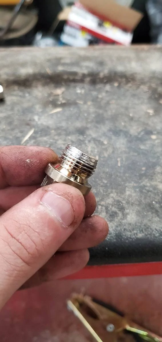

Got my muffler welded in place today, as well as putting an o2 bung in the header.
Went a little too wild burning the bung in.. and managed to get its plug pretty well stuck in it. Needed an impact to remove.. I'm hoping that running a tap through it will fix it well enough.. seems like it should.
Plug after removal..

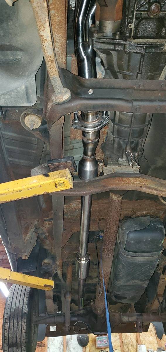

Nice shiny exhaust for a rusty truck lol.
Just about done the exhaust chapter now though.. need to put another o2 bung post-cat, kick It out the side behind the tire, and put hangers on it. So close!

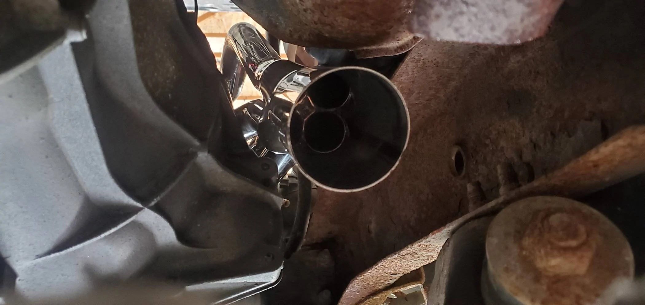

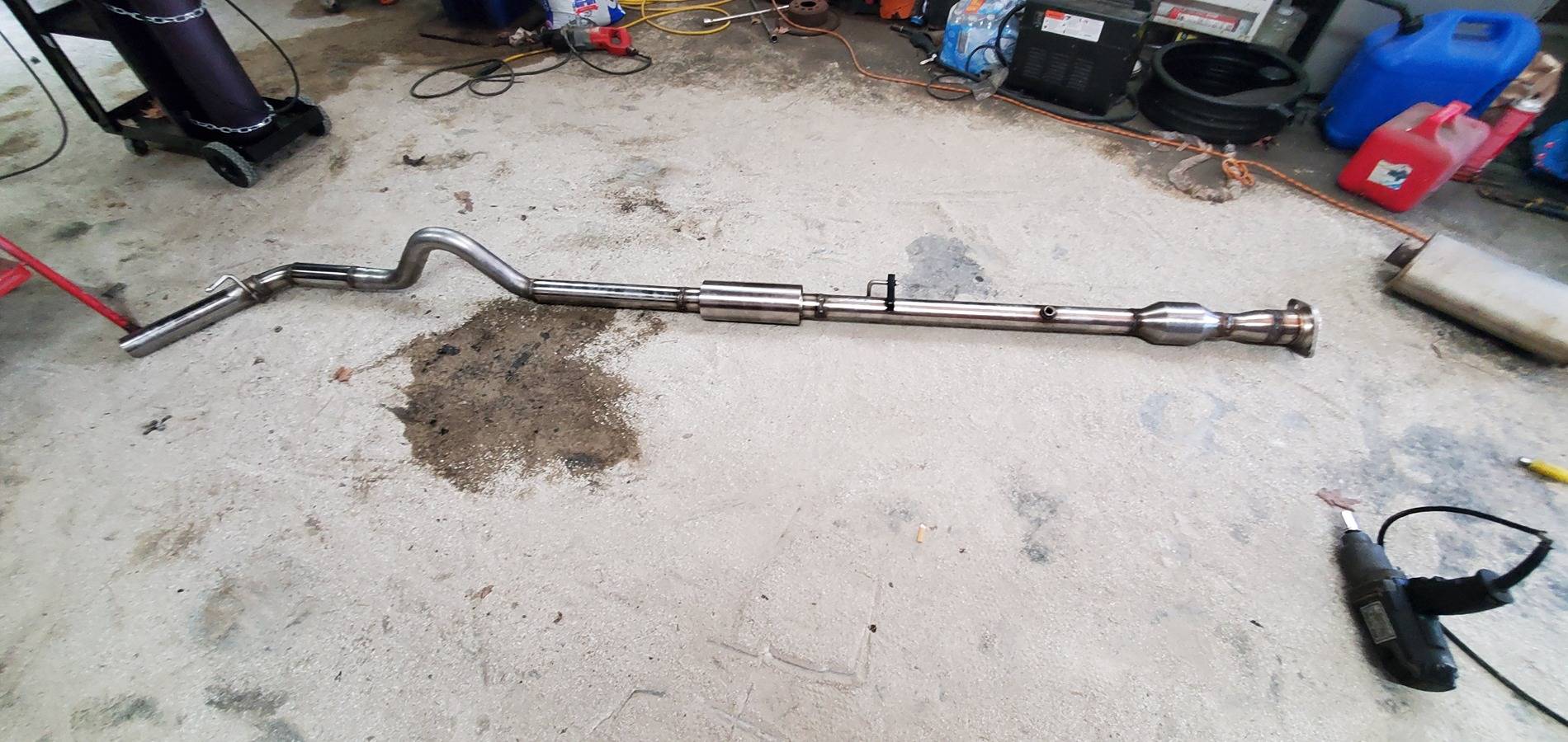

Were finally ALL DONE besides wrenching on an autozone exhaust tip which I've yet to buy.
Hopefully next weekend I can throw the rest of it back together and see what it sounds like bouncing off the limiter.. while I grunt and giggle like a caveman ?

So.. the rangers almost ready to take out on the road again. Exhaust is finally 100% after the installation of new sensors last weekend.. and the ol gals running better than it ever has since I bought it.
The header & my exhaust sounds exceptional while sitting there idling. Get your foot into it though... and it sounds like the angriest civic anyone's ever heard.. doing its best impersonation of an F1 car.
The first 5 minutes of my anxiously awaited test drive are gonna be incredibly amusing.. then I'm definitely gonna have to dip into a parking lot and hop on Amazon to order a more muffle-y muffler ? wanting to keep with the free-flowing chamberless design... I may try out one of those twin-loop fart cannons.. the cheapest one I've found is around 75$.. well see.

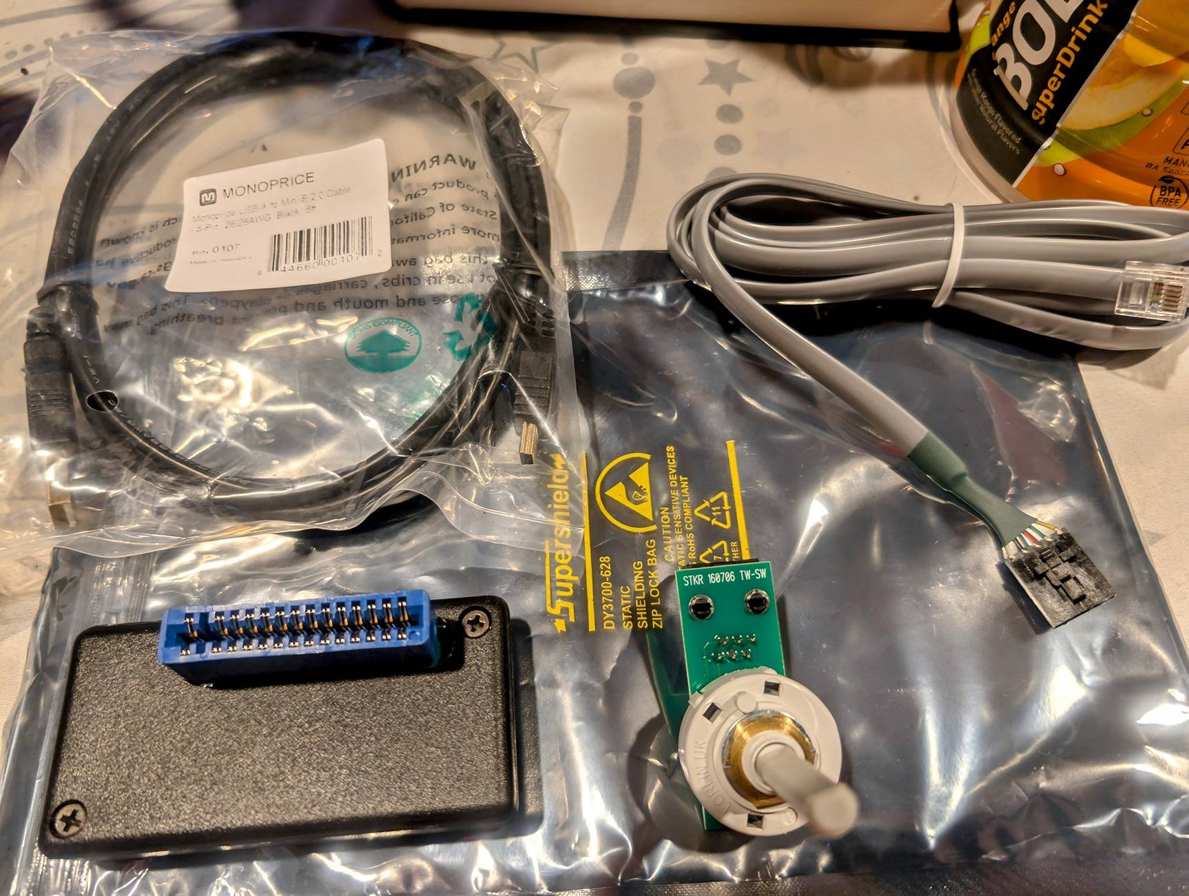

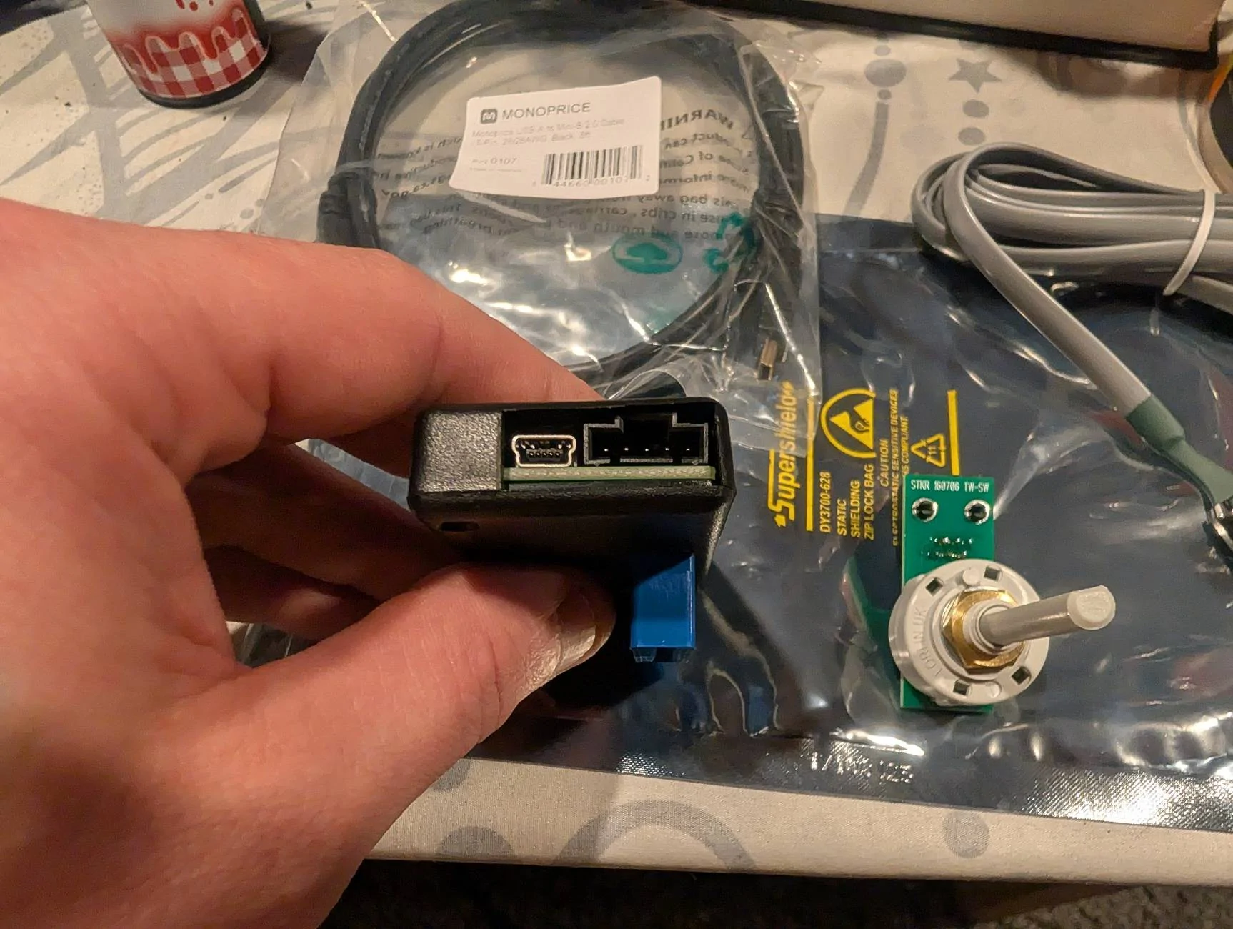

The best Christmas gift of the year was definitely a TwEECer RT piggyback ECU for the ol girl. I'm not gonna mess with the tuning myself.. im gonna let the fine folks at TwEECer handle that remotely once the time comes (spring/summer)

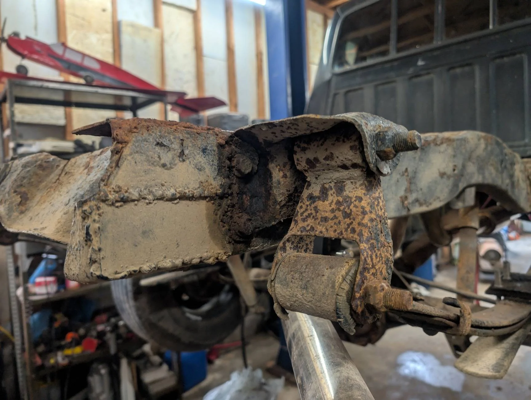

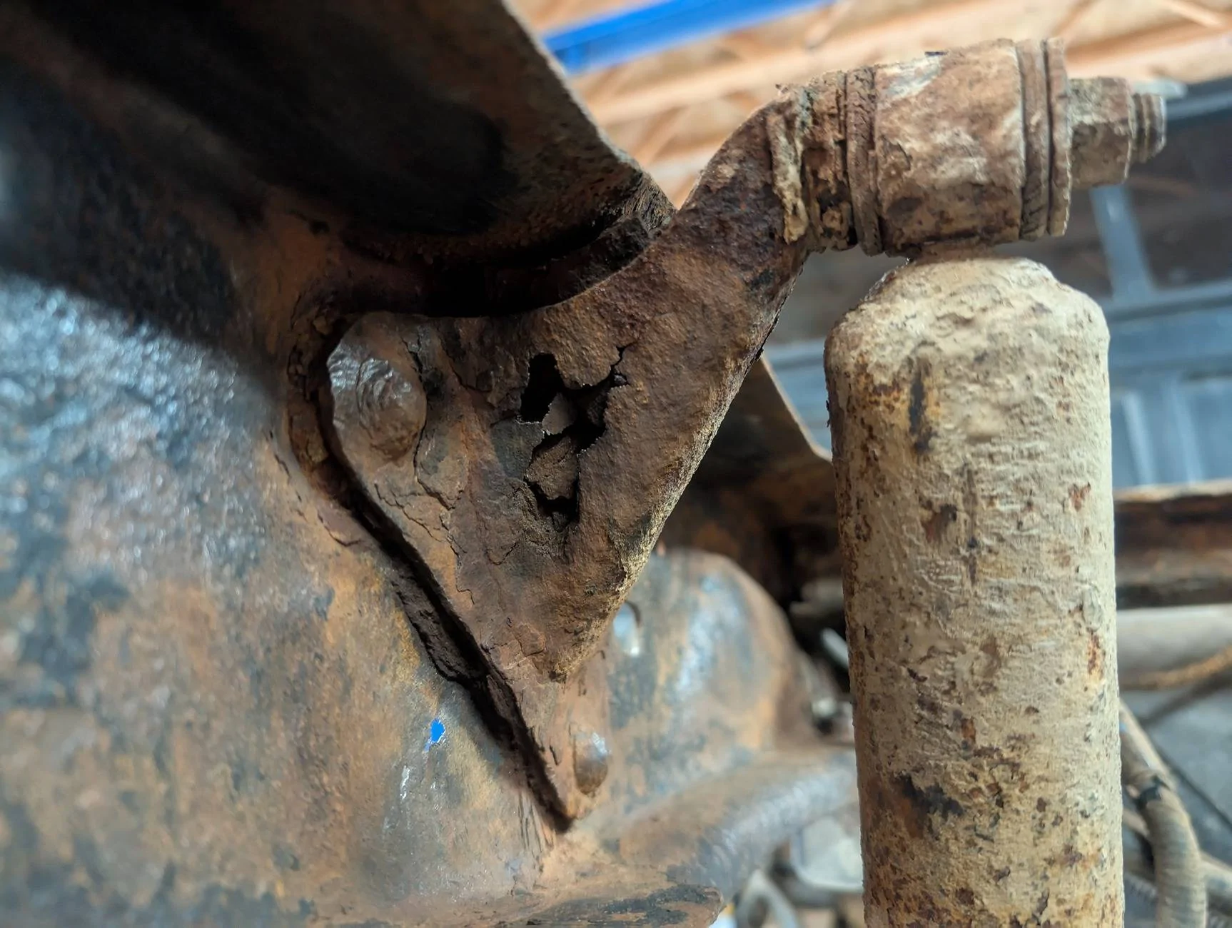

-shackle flip + patch frame behind shackle hanger
-replace drivers side cab mount bracket & cab corner.

INFINITE POWERRRRRRRRR showed up yesterday.. hell yeah.

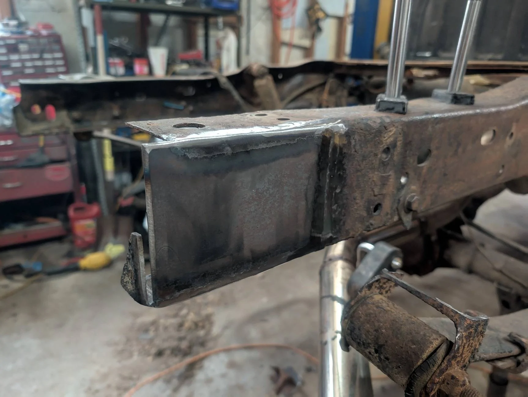

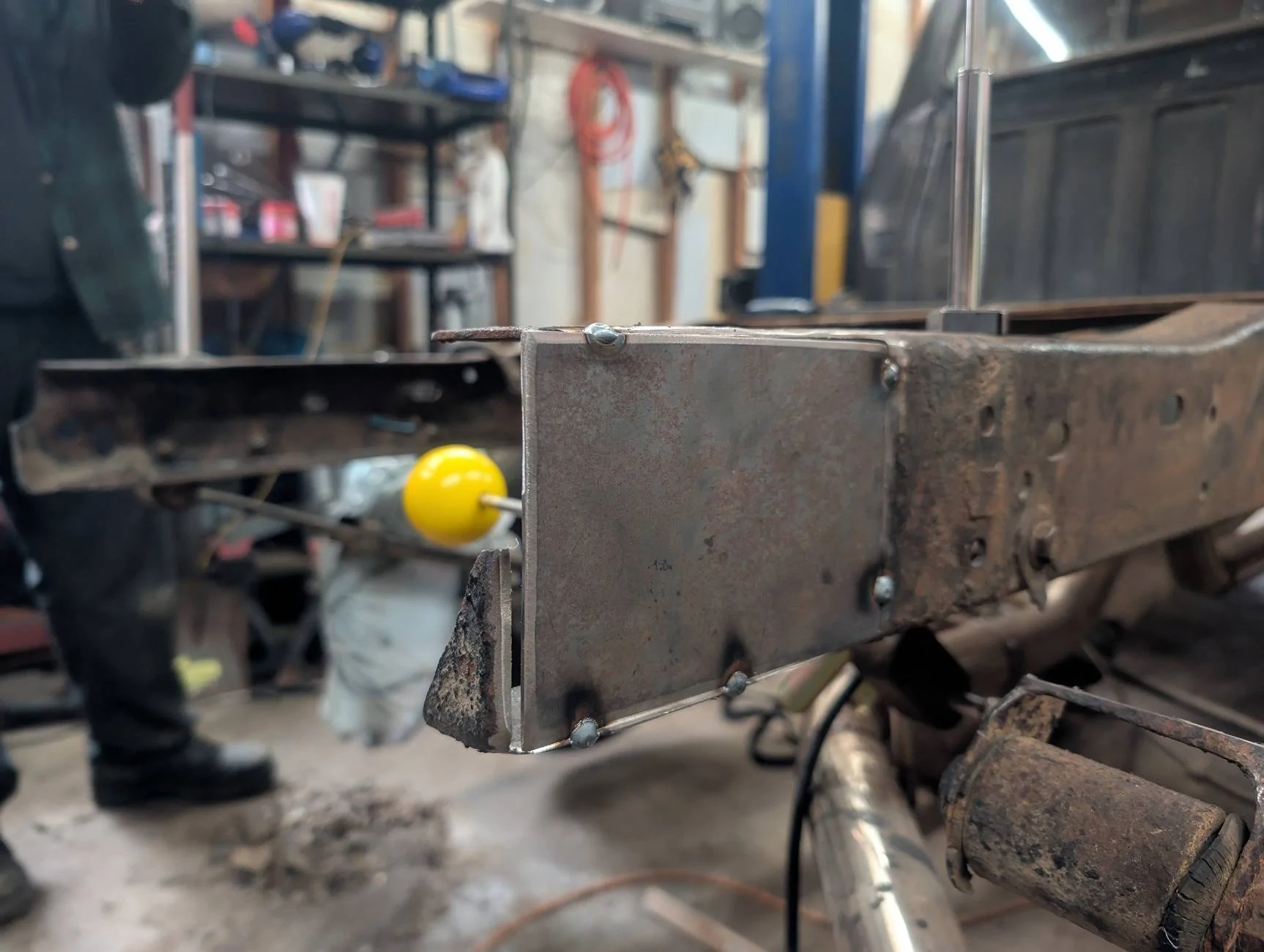

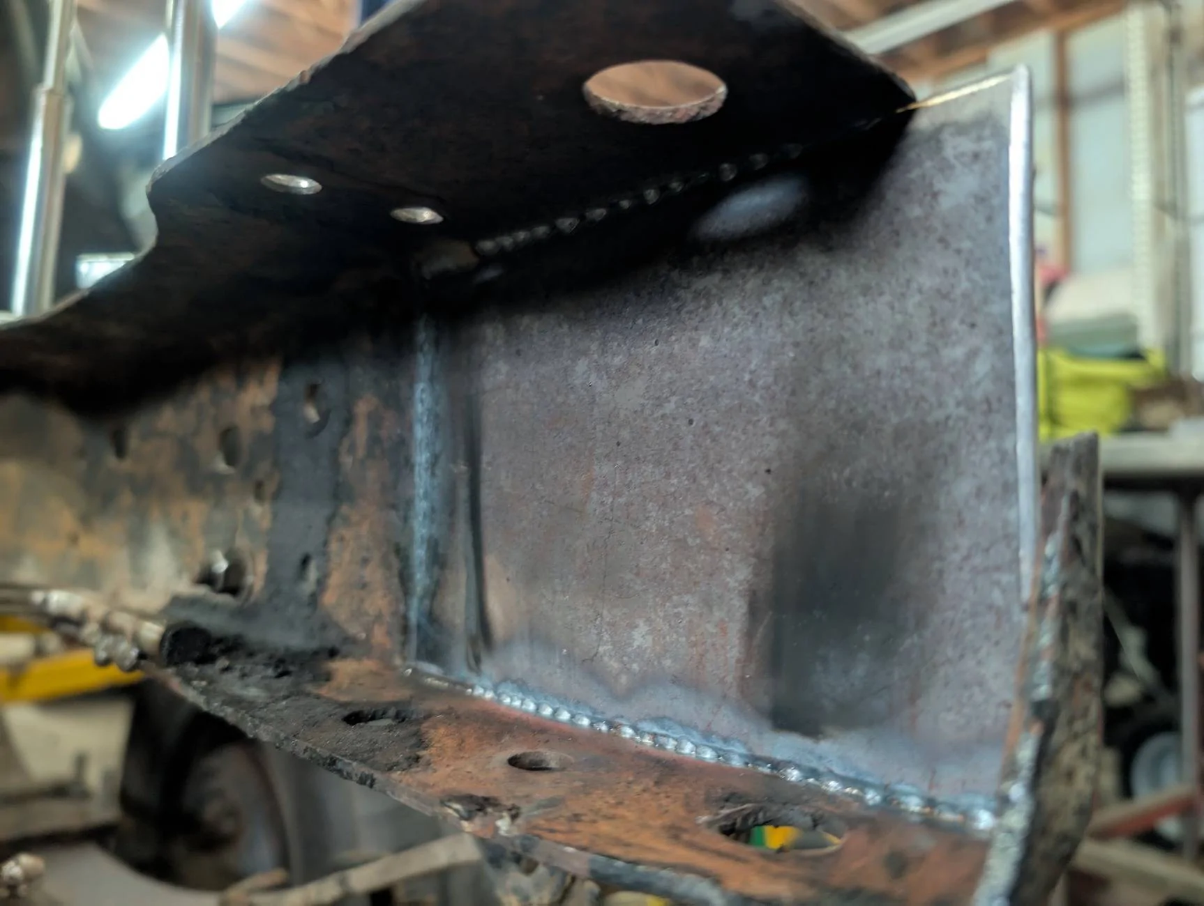

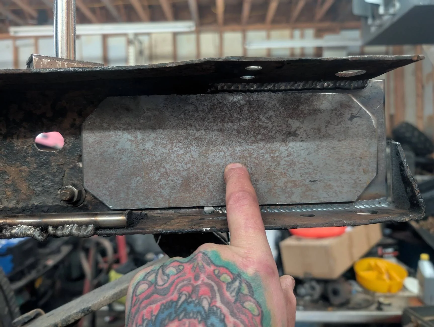

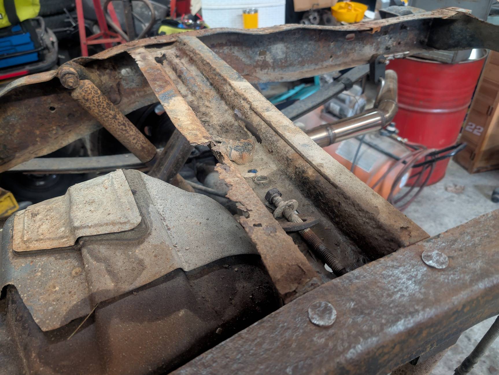

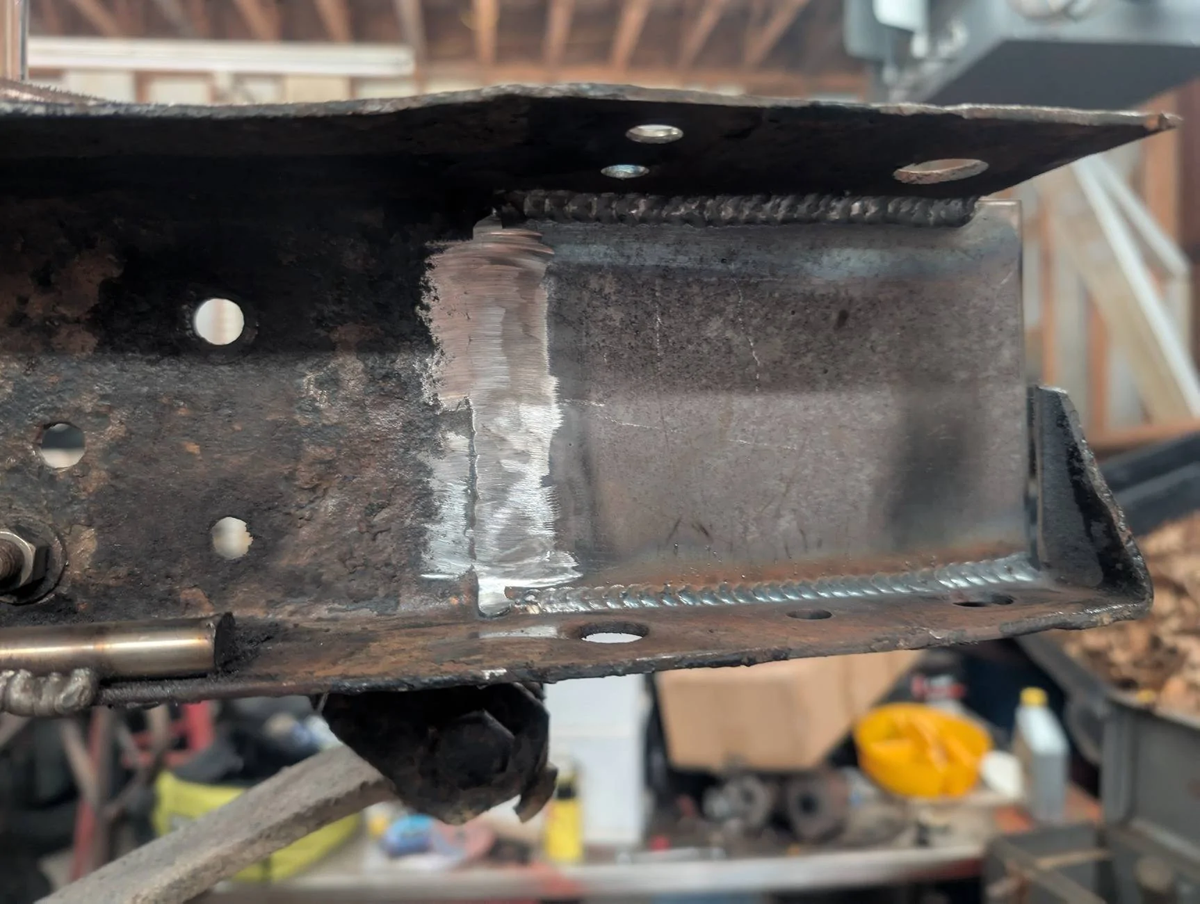

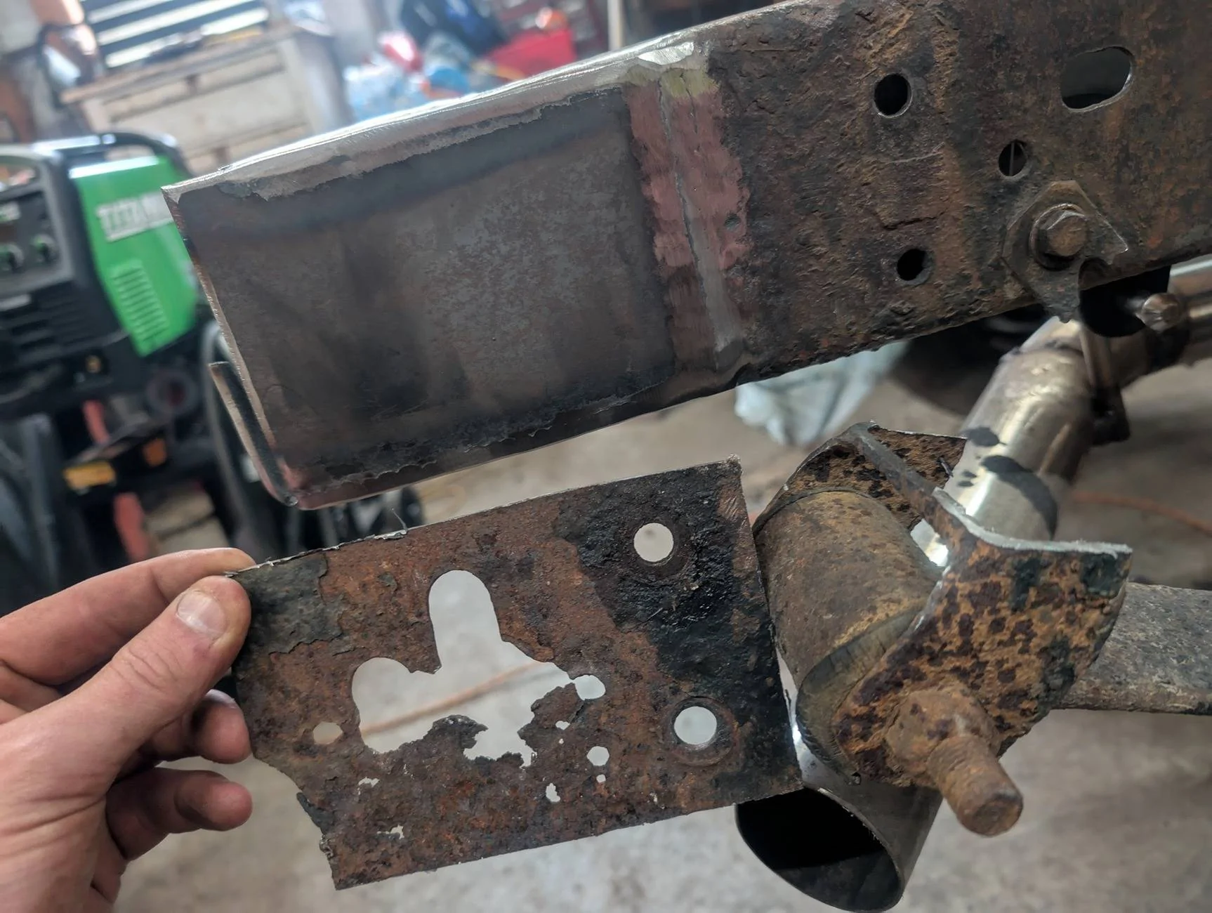

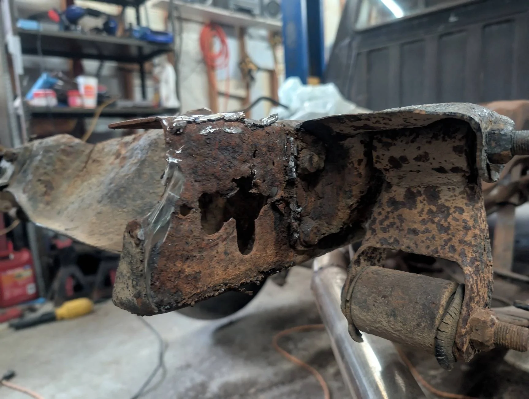

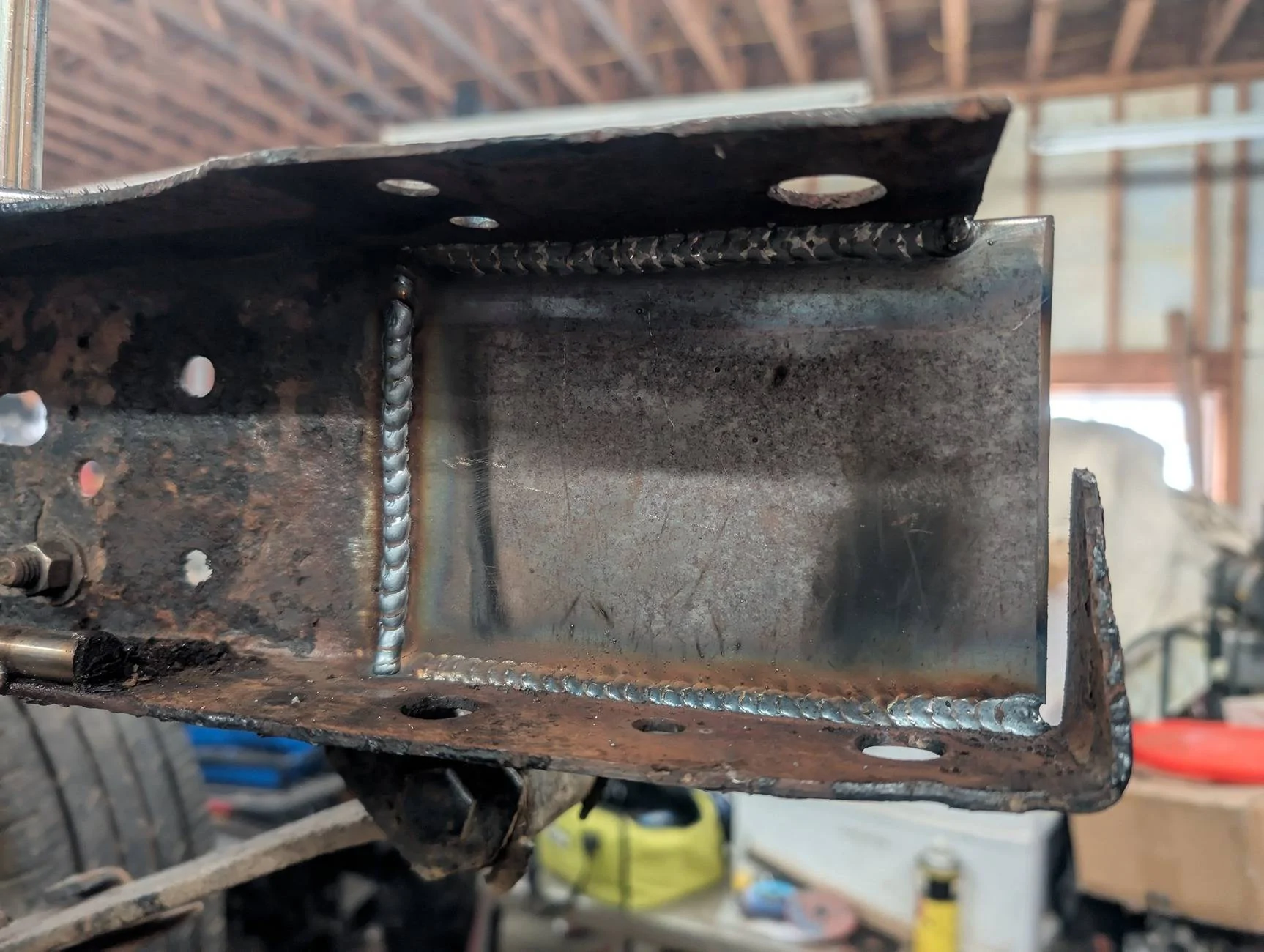

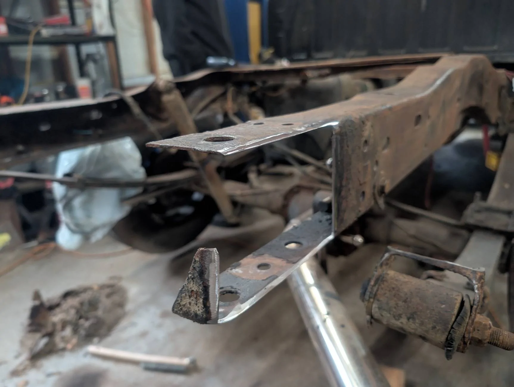

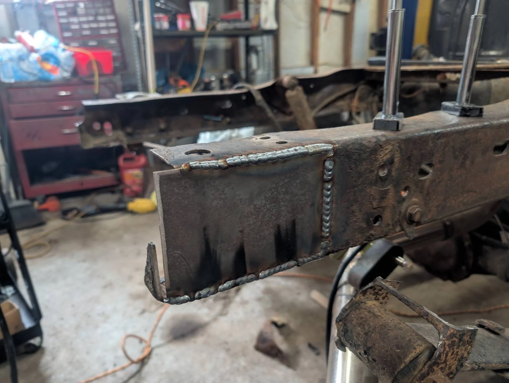

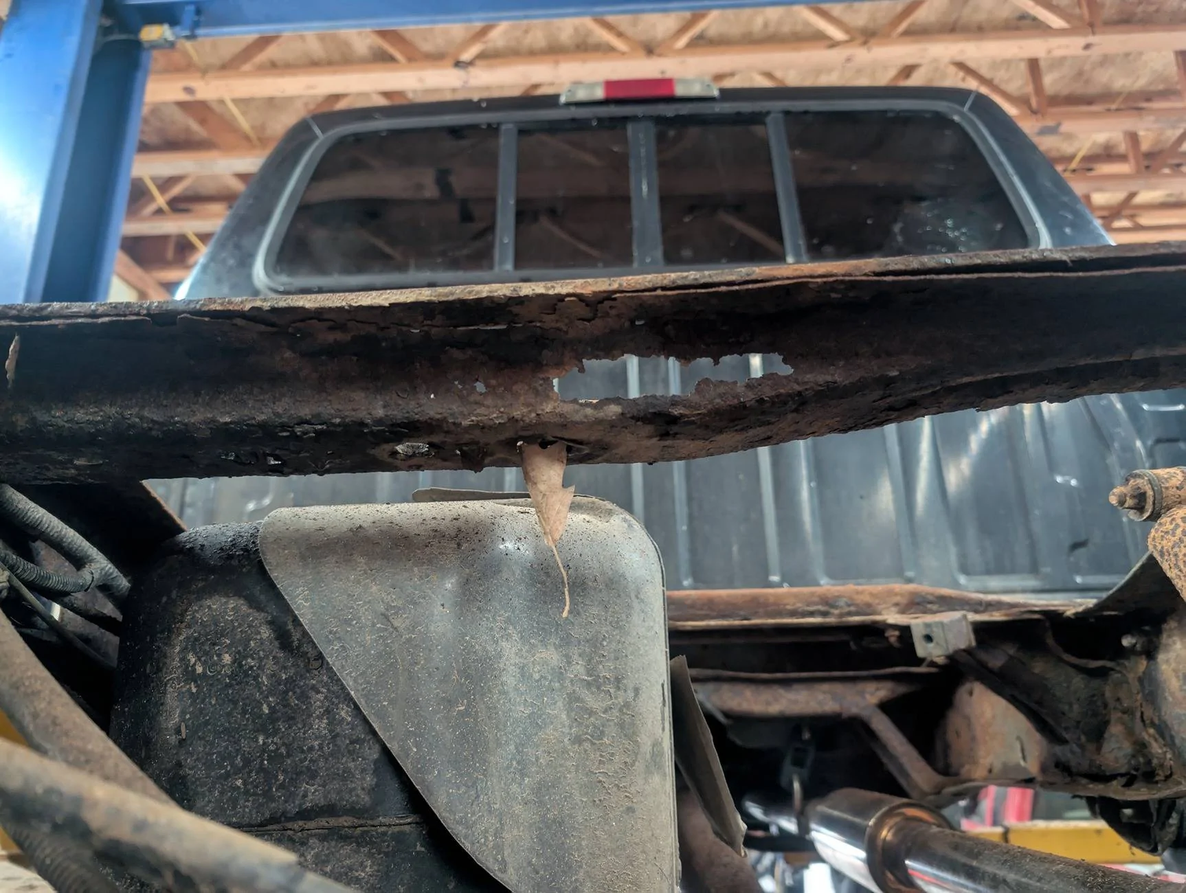

Phase 1 of frame repair mostly done, just gotta weld the overlap plate onto the inside and drill a couple holes for the rear shackle hanger bolts.
Recommended settings on the welder for 1/8" were dead nuts.. that's always appreciated. This was not the case when I was melting the exhaust together lol.. I hate welding thin tube.
More to come next weekend!

nice work. Reminds me of when I had a 95 Jeep YJ that was a rolling rust bucket. Frame patches were the norm.
I'm relatively sure most YJs by this point are made up of more patches than factory metal lol.
Thanks though, I'm super happy with how it's come out considering it was my first go around with frame repair.
I need a decently sized patch at the driver's side shock mount too so.. more practice! Weeeeeee!
