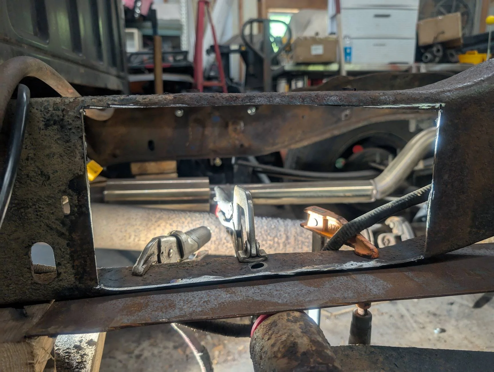

Successful few hours on Saturday.. knocked off the shock mounts, removed another crossmember, drilled some holes.. just gotta patch up by the driver's shock mount and we'll be ready to start making new crossmembers ??

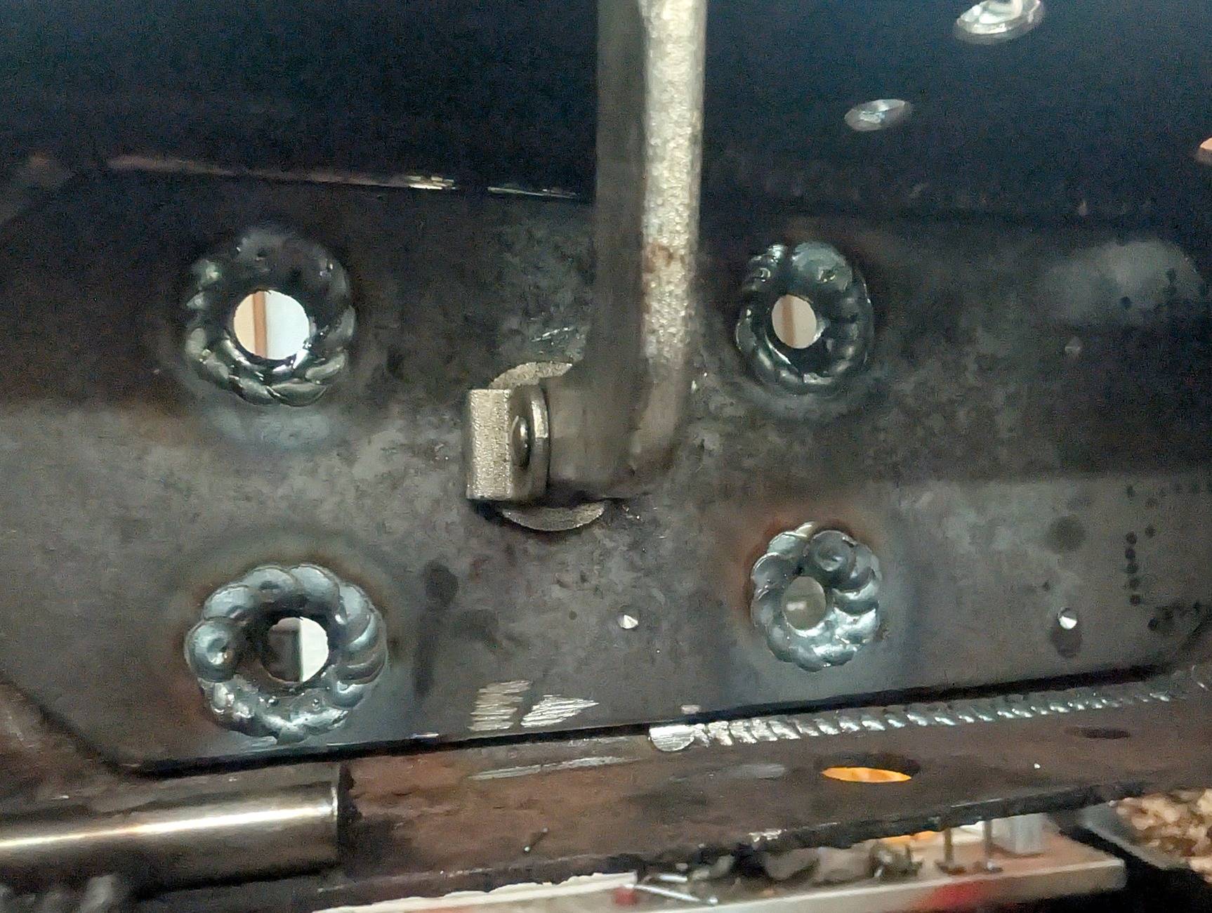

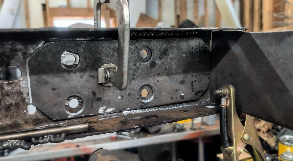

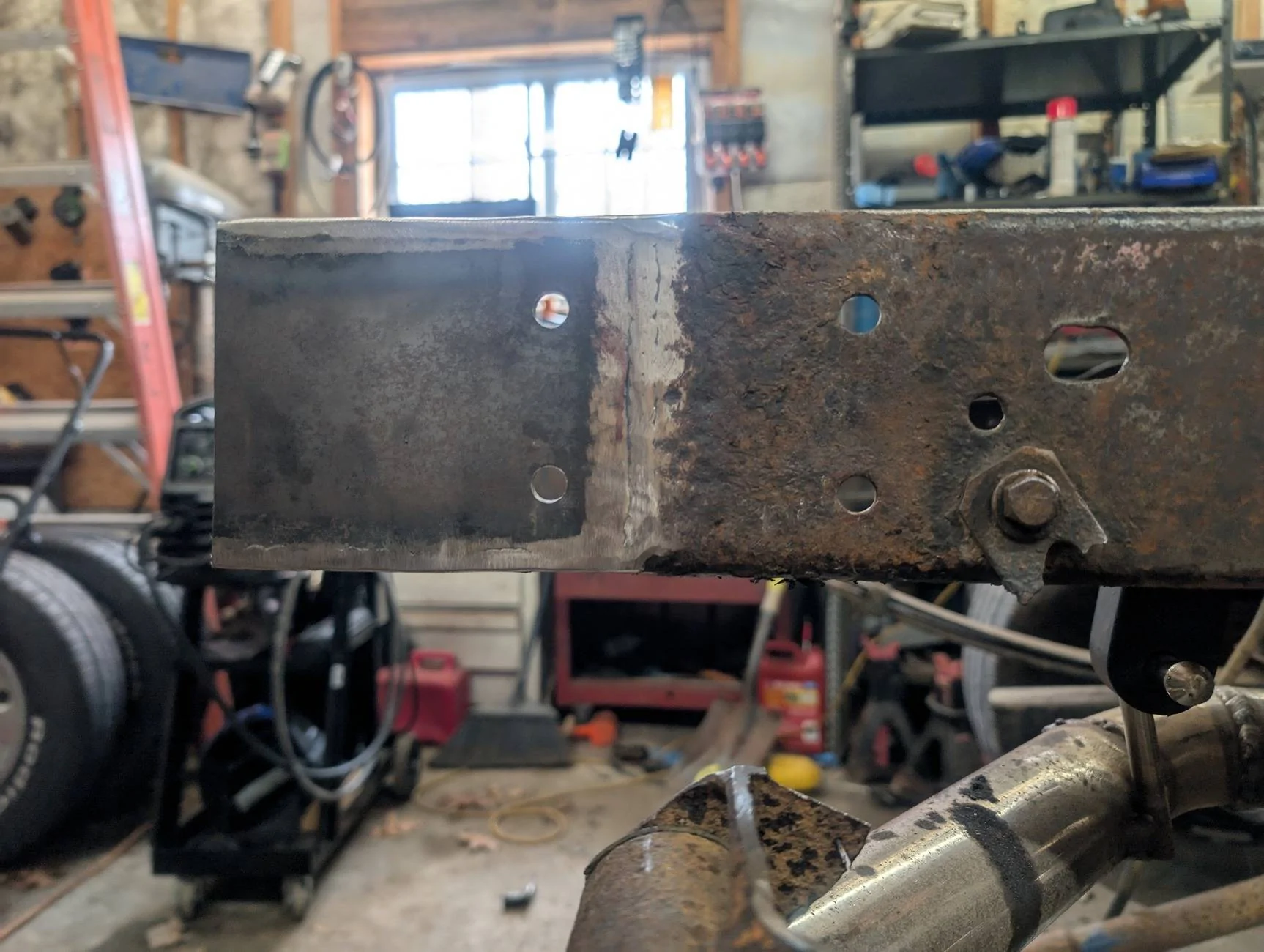

Managed to get a little bit done before I ran out of gas for the welder ?
Wanted to get a full perimeter weld for the fishplate so I'd never need to worry about rust forming in between it and the frame.. hogging the holes in the plate to 2x the size of the holes in the frame and welding around the inside of them seems to be working extremely well...

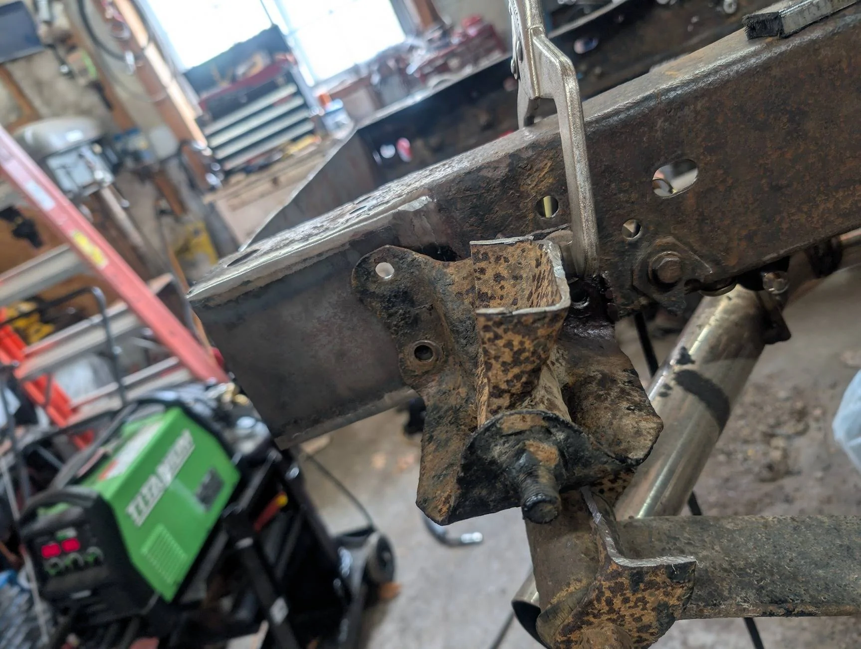

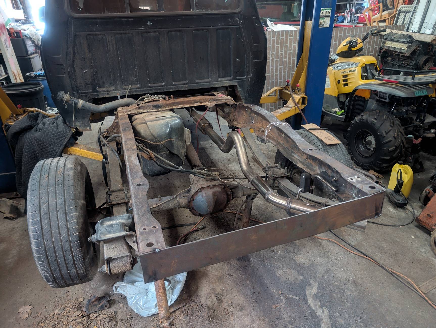

Didn't make the trip to get more gas for the welder thanks to an exceptionally shit week.. ranger Sunday was a success anyways.

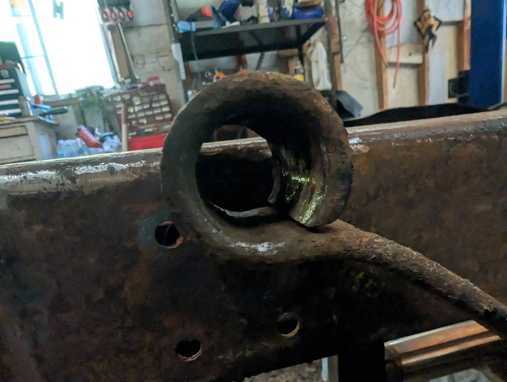

Fuel tank has been removed, the remainder of the leaf spring related brackets have been removed from the frame, and the leaf spring bushings have been exorcized.
Oddly (but thankfully) none of the leaf spring bushings had the annoying outer sleeve. Just rubber and the inner sleeve shoved into the leaf..
The insides of the eyes are kinda lumpy bumpy and need to be hit with a flap wheel to fix em back to round but I'm relatively sure I have a bag of them kicking around somewhere that are close enough to the right diameter to work. Everything is going to be replaced with poly.
More next weekend!

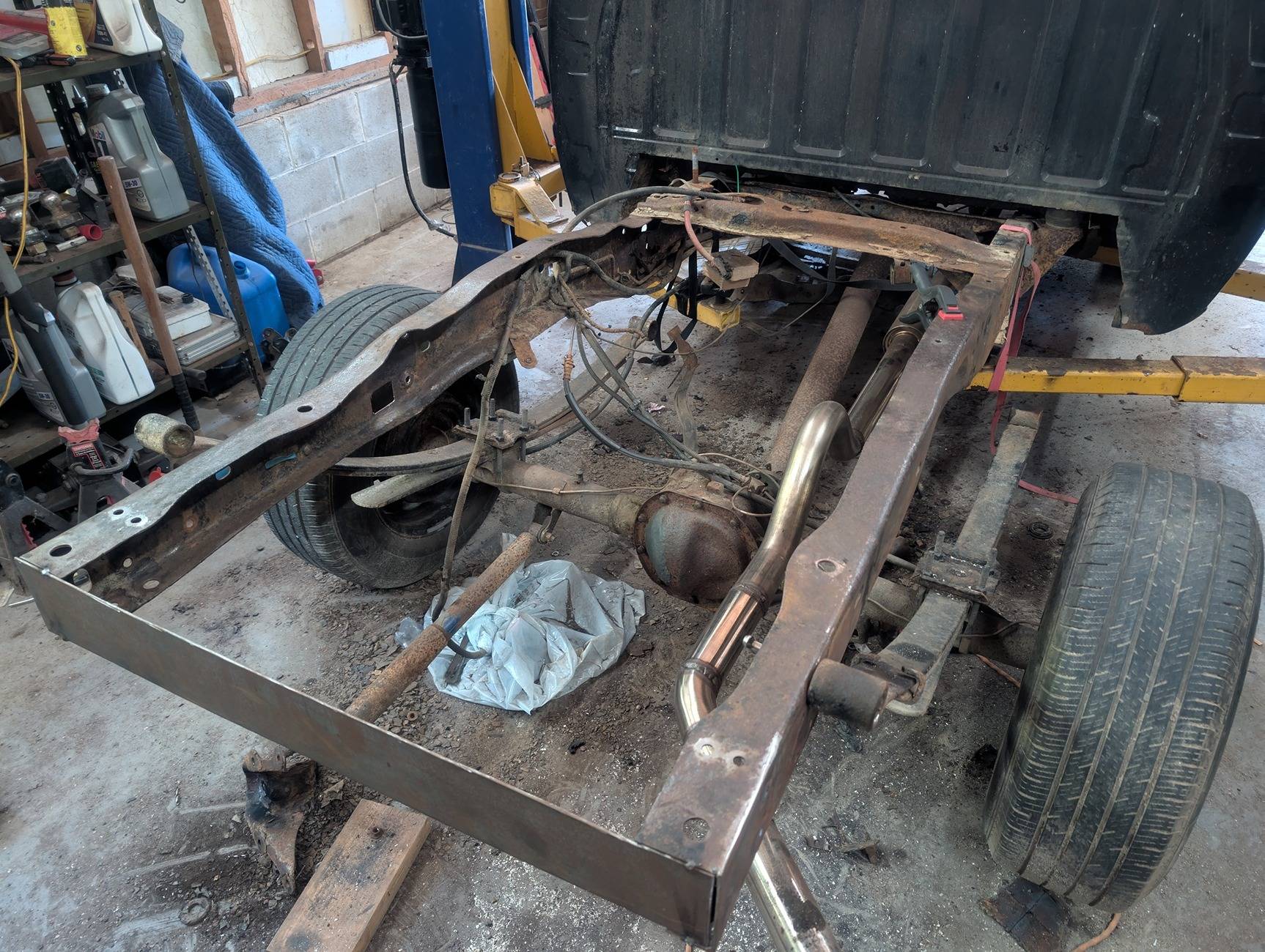

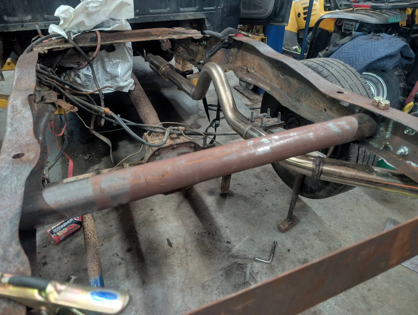

Slowly making progress still.. got the first crossmember built and burnt in last weekend.. super happy about that...
...And was super excited to get the rest of them done yesterday but the truck had other plans ? The area behind the driver's spring hanger was much worse than I thought. Had to hack a foot long section out of the web of the frame.. and didn't even have enough material with me to scab a new section in.. let alone plate over it afterwards.. so I had an early day. I didn't want an early day, dammit.
Oh well, hopefully next Sunday I can get it all scabbed and plated.

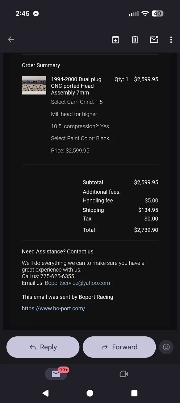

Slightly big update time..
Fancypants race-truck head has been ordered! 👍🏻
Shaved for 10.5:1 compression.. ported.. big valves.. big lumpy cam.. etc etc.. 'fully built' as they say.
Lotta damn money for ONE iron head lol but.. boport knows best when it comes to the Lima. It's money well spent. Real excited for this one..
