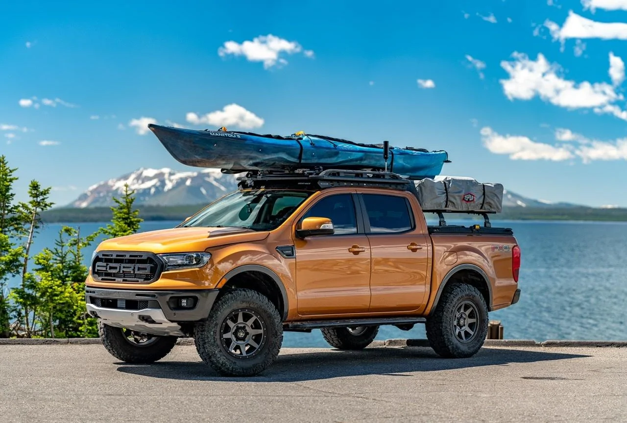

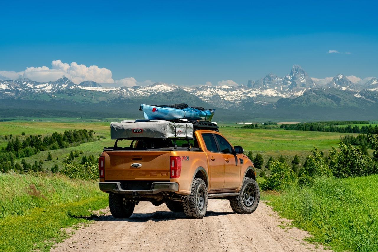

Here is my truck with 3” of lift in the front and 2” in the rear. Icon Stage 5 kit and OME Leafs in the back on 34” tires.
Truck is fully loaded with 900lbs of gear in the bed as well in both these shots.
I don’t think you NEED more than 3” of lift to get the truck just about anywhere in this country. A suspension lift that aids in wheel movement and clearance is the most beneficial. A tack on body lift with stock running parts is for the mall parking lot.

Where were those pics taken? Absolutely gorgeous scenery, and truck.
Thank you! First picture is in front of Yellowstone lake and the second one is in south east Idaho looking towards the Tetons.
