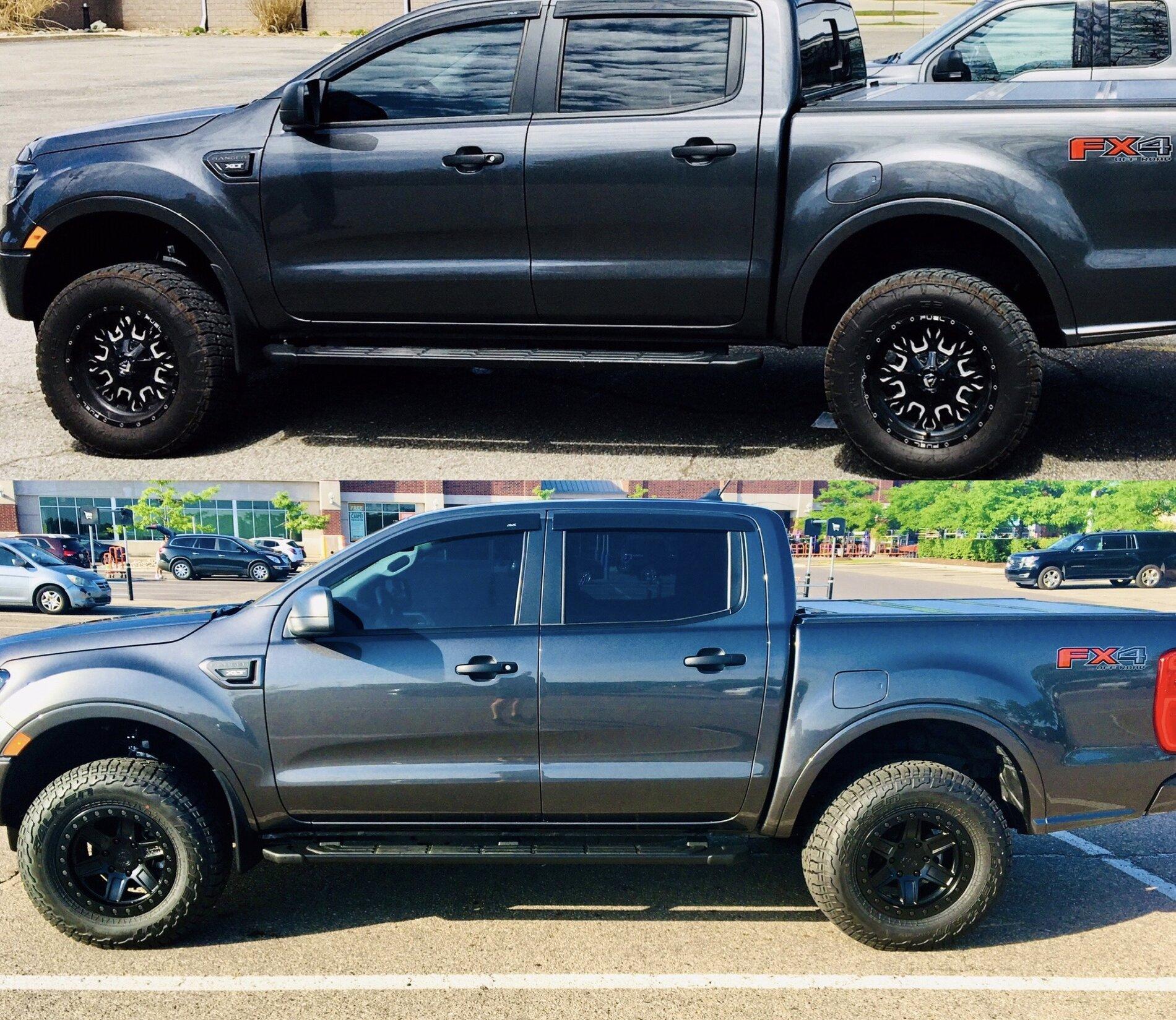

Hi Richie,
I'd second Frenchy Chris' remarks, in particular if you want a true front and rear lift to gain capability and clearance.
I'm not a drive train/suspension specialist, and there are engineering and mechanical oracles on this forum happy to help. That said, I went through the same calculation last month.
I moved from a ca 3" spacer lift with stock FX4 shocks (block in the rear; spacer above the front struts; Rough Country UCAs) to a Ford Performance Fox 2.0 coil over set up (resulting in a 2" level; kept the RC UCAs). I looked at (it seemed) every coil-over/leaf option on the table, and seriously considered the Old Man EMU set up, finally resting on the Ford Performance Fox 2.0 set up for the reasons you highlight as concerns + capability.
We plan to use the truck for moderate trails, modest ORV park visits, and midwest/east coast overloading, as well as a daily driver. It's only been a week, but I've been quite happy with the result. I assess that the truck gained marked capability and it rides better; the ride is much less rigid, yet not soft. I like the appearance. Of course, we lost an inch of clearance, but for me that was well worth it.
As you've done, I found the topic of lift a cornucopia of opinions, options, and costs. In addition to the many helpful streams here, I spoke with two dealerships, Stage3 Motorsports, and a Ford ASE-certified mechanic friend.
A range of opinions (as well as incentives and interest). With the exception of the warranty question (always a contentious and confusing matter, and one driven by profit) - all assessments landed at near the same conclusion: the best intersection of capability, drive train/suspension durability, and warranty-ability was a coil-over lift no higher than 3". Beyond 3" the strains you note become a problem; at 3"+ a diff drop and new UCA were highly recommended.
Because looks matter, I attached a photo of the before (above) and after (below).
Best of luck.
-Chris

Just looked at
Hi Richie,
Best of luck.
-Chris
