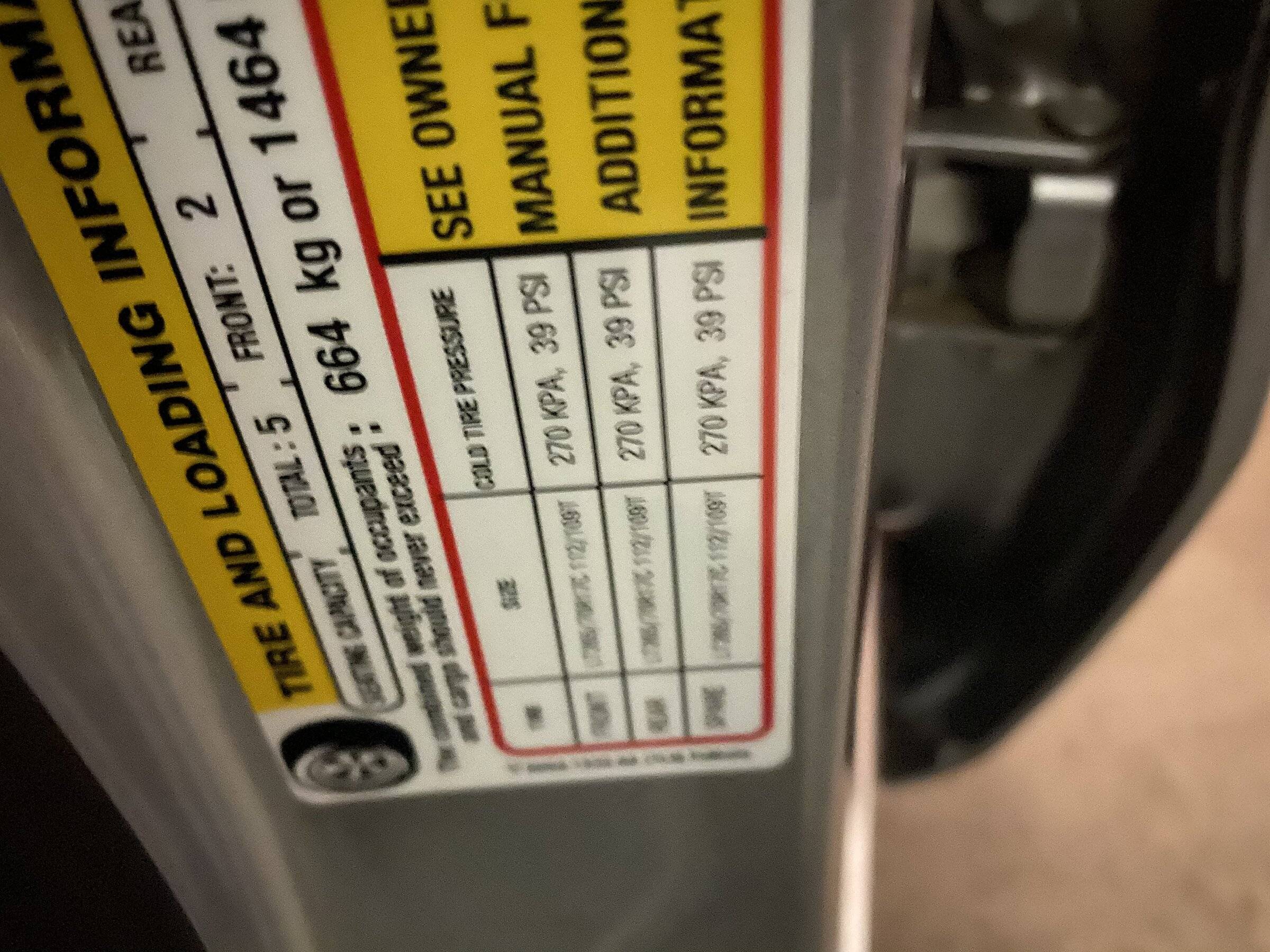

Your pressures are way to high on the street. I run 30-32 on the road with my Patagonia MT’s and 15-20 on trails.
Factory door said 39 PSI for factory tire 270/70/17, my new tires 285/70/17 that why I thought 39-40 PSI should make sense, but I’m not professional, Justin a regular weekend warrior.
