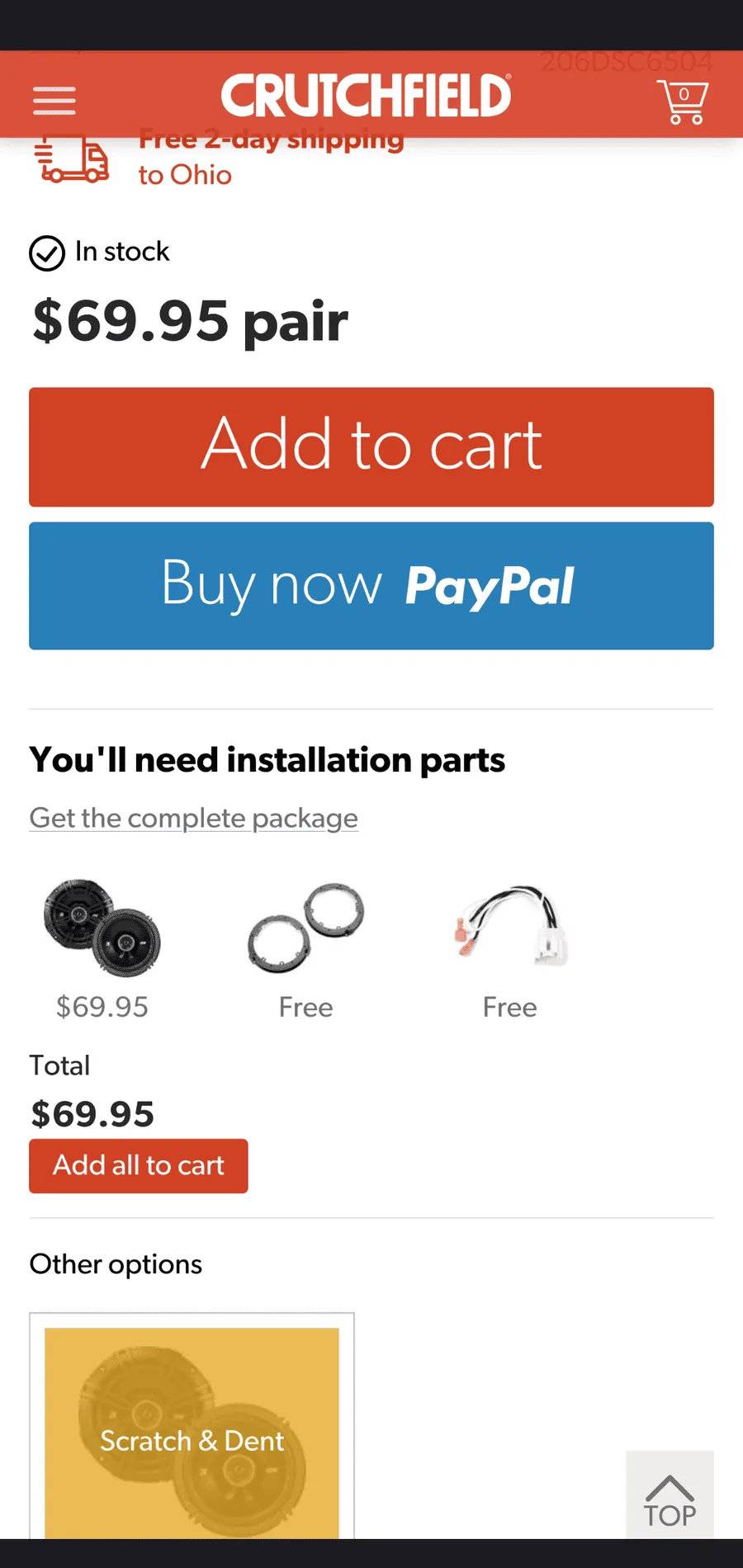

Do you know if we need a mounting bracket? I only ask because stage 3s kit comes with one so you don't have to do any extra drilling! But on crutchfield it says it fits our trucks so does that mean the holes line up? Lol
Im not sure what speakers you're looking at but the ones I was came with the ring. If you chat with them they super knowledgeable.

Ok it looks like I will just chat with them and make sure once I decide because it looks like they make it easy! Thanks for the help!
