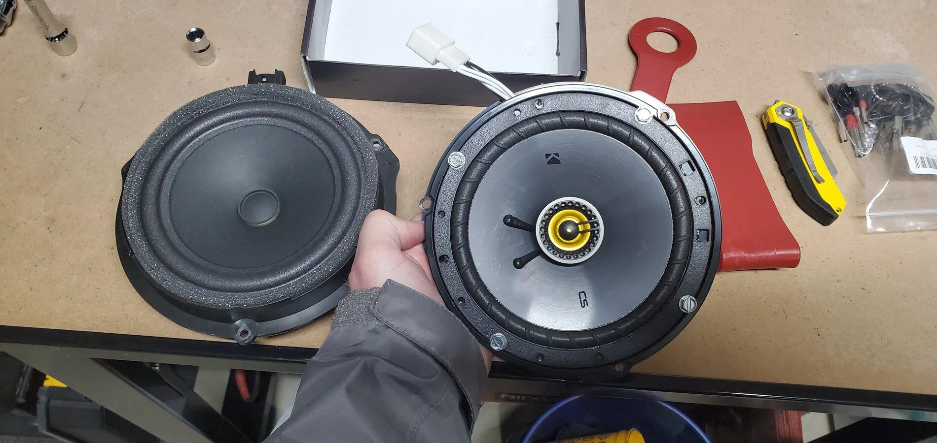

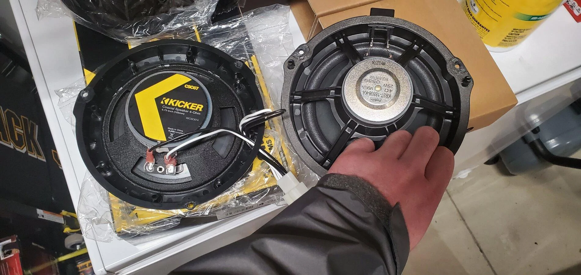

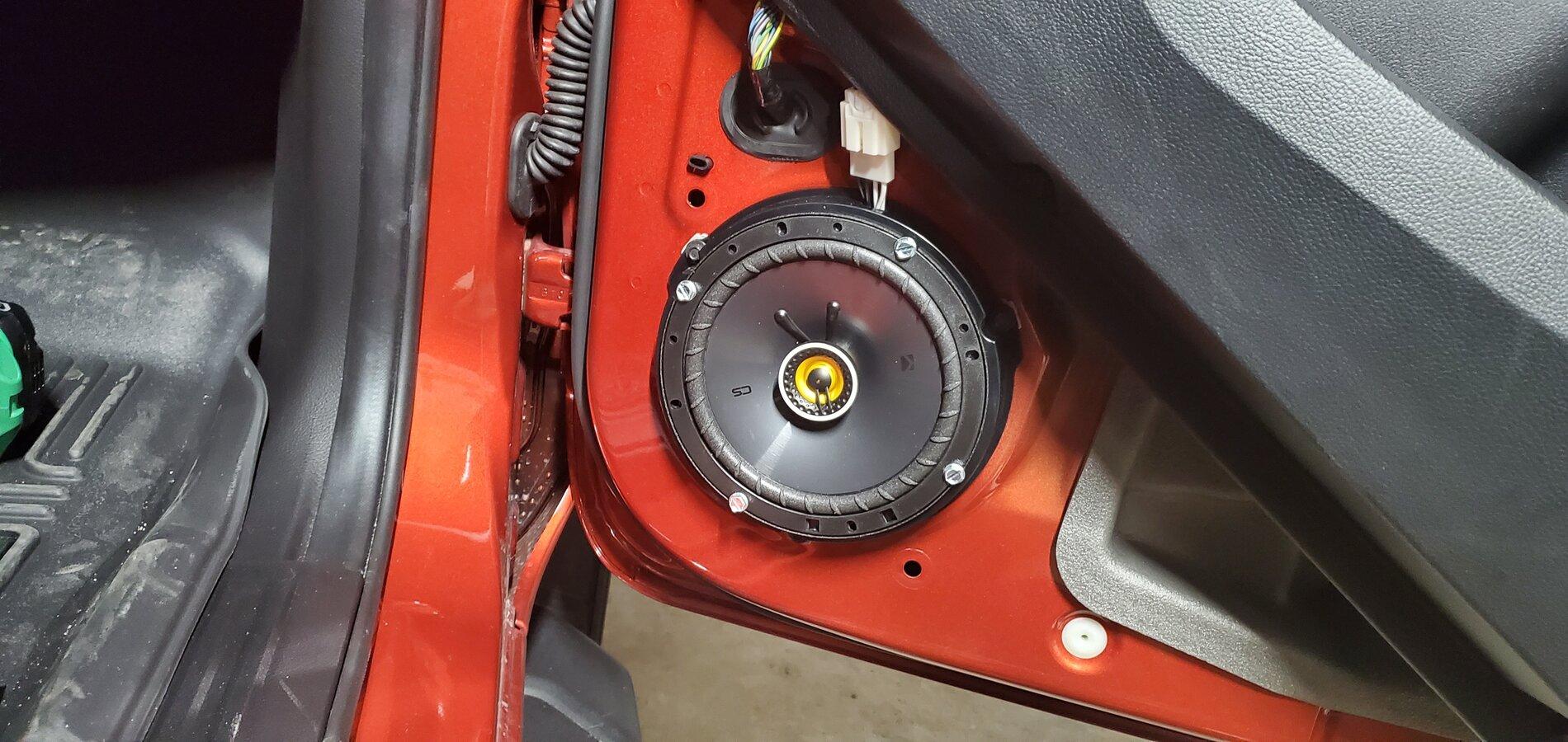

Here's what I did. Obviously a less involved, entry-level upgrade, but works for me ?‍♂ I have an XLT 302A with the standard sound system. I installed these Kicker CSC67 6.75in Coax speakers in the front doors. I originally ordered them for my wife's Edge Sport with the Sony system, but decided to try them in the Ranger instead.
Ironically, they fit perfectly in the Ranger (despite ordering a kit for a 2015 Edge). Sound improvement is noticeable, and the stock system doesn't seem to have any issues pushing these. Obviously replacing the rear doors and the tweeters, along with adding an amp and sub would further improve things, but I've been very happy with the improvement for $70 and about 2 hours of my time.
I purchase all my audio stuff through Crutchfield, can't beat the customer service, along with the almost guaranteed fit and installation components.
https://www.crutchfield.com/p_20646CC674/Kicker-46CSC674.html?tp=105
Here's a compare with the stock speaker.
sounds pretty easy and those stock speaker are pretty weak looking .... what did you do about the factory tweeters? disconnect or leave in? it looks like those have tweeters built in.
I have a similar truck - 302A pkg sound is ok.
I just left them plugged in, doesn't seem to affect anything or make the sound any worse. Definitely not too treble-y for me.
