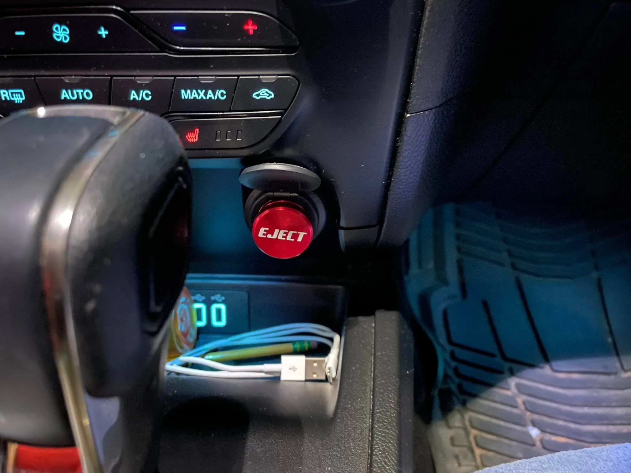

You could always get the 3 pack. The eject one comes in really handy for unruly passengers. ? Funny how all mine have been very quiet since adding this.

I saw these the other day on Amazon. I was thinking of getting some. Now i see it - damn they are good.
I remember back in the 80’s they had sold stick on toggle switches with eject, missiles labels etc and had them in my car. These would bring back a little nostalgia from my high school days! Just add a few pounds, a little less hair and wrinkle lines from the kids - that’s the only difference?
