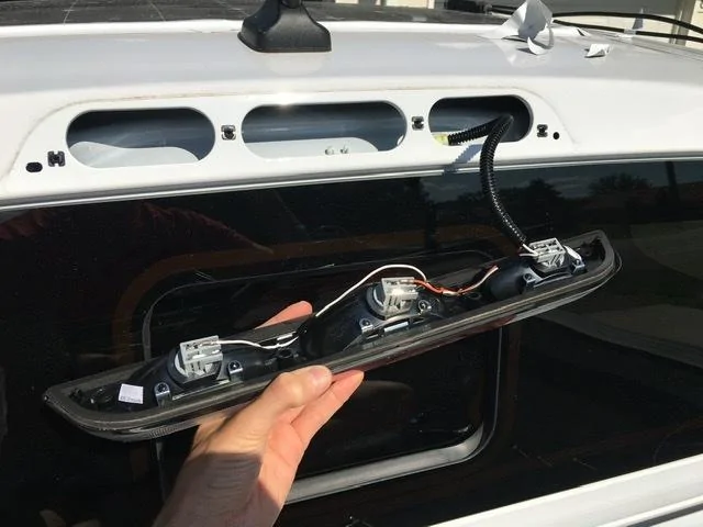

update:
topper off. i removed all three bulbs (middle bulb is brake, side bulbs are the cargo lights). as far as i can tell no alarms and the car didn’t spontaneously burst into flames.
great!
(on ranger 2019 XL needs a torx or hex driver and looks like this with assembly open)

update:
great!
I still would prefer the silent car mod since it kills the headlights, horn, all interior lights as well as the cargo lights when you lock, unlock, or open any door.
cool that you got something that worked for you.
agree that sounds better but haven’t broke into the forscan universe yet

Update, now that I have forscan. With the third brake/cargo bulbs removed there is a code that gets picked up by forscan that seems to suggest the car knows the bulbs are missing, but no dash codes or anything that would tip you off otherwise. Note this is with the topper and new third brake light working, not sure if that matters. We never tried with the bulbs out and no topper/third brake.
