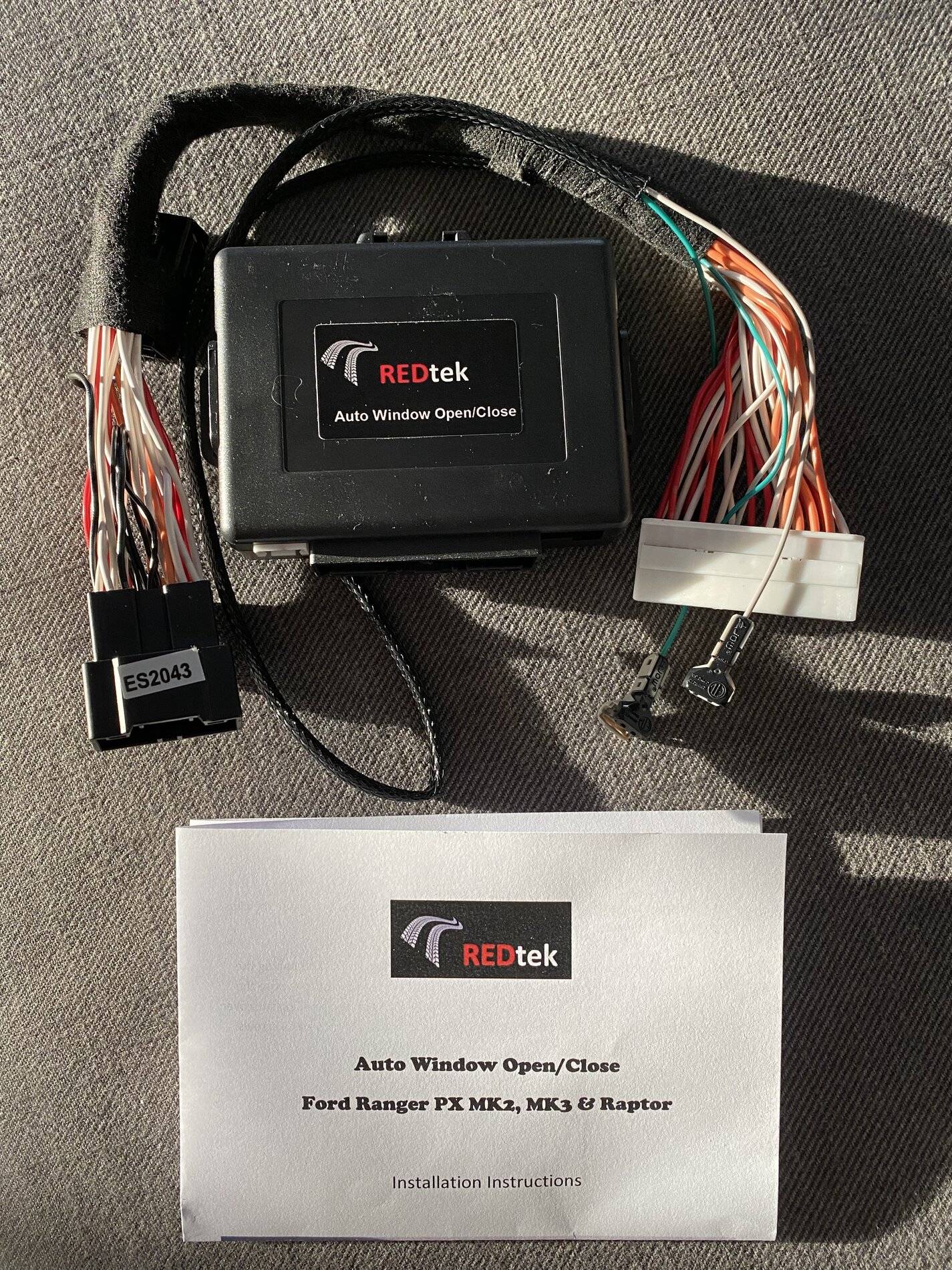

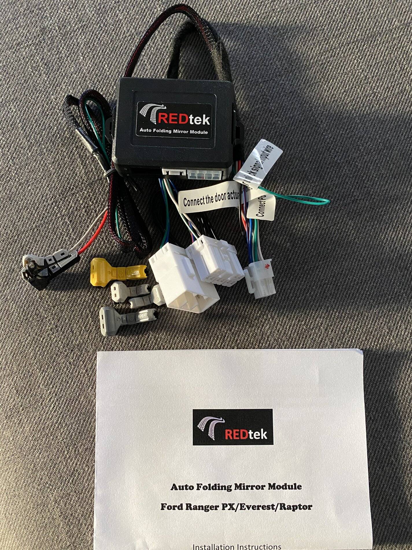

REDtek boxes arrived today. Auto mirror module and window module. These look nice and solid. The harnesses are very nice. I have to maybe reconsider some of what I said and thought about t-taps after seeing these JOW connectors.
I got those same 2 boxes yesterday as well.

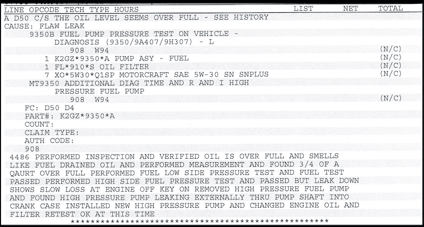

What was the fix and the issue?
Several on here including myself had an issue where fuel would leak into the crankcase and dilute the oil.
BIG thread on the issue HERE
You don't hear as much about it anymore so Ford apparently got their vendor to resolve whatever was going on.
Oil level would rise on the dipstick and the oil had a distinct fuel smell.
On my truck, the problem was the HPFP leaking down into the pan.
Dealer replace the HPFP and my oil level has been steady for the full length of my oil change.
Before it would creep up 1/2 a quart over 1000 miles.
Others had to have fuel injectors replaced.
Here is the service ticket from mine

I just ordered them yesterday! Curious how the install goes.
Install was pretty easy. The window module was really easy. Getting into the door was easy. 5 torx screws, and a few clips. Be careful if you have the ambient lighting. The plug is really in there and the light pipe is fragile.

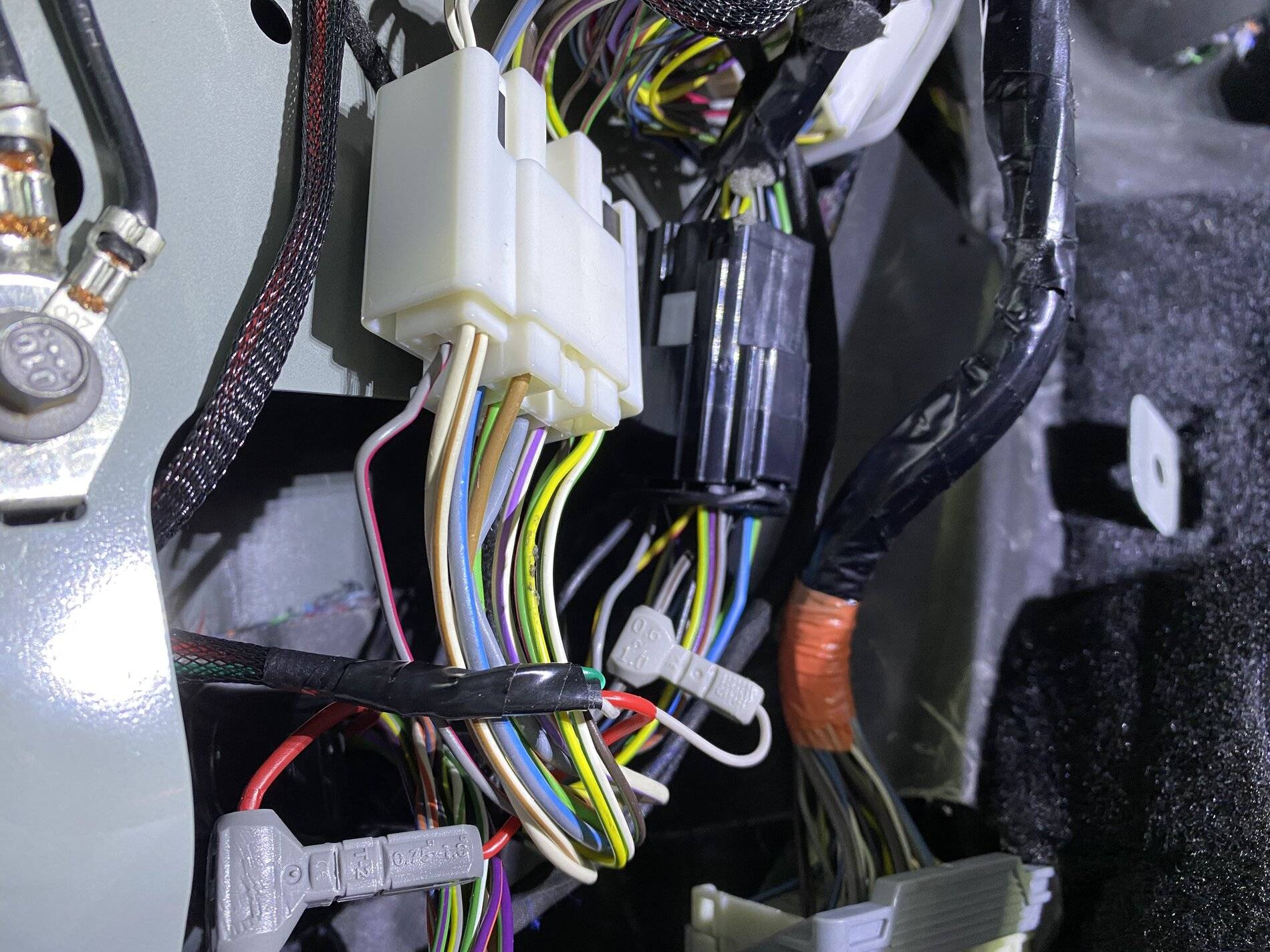

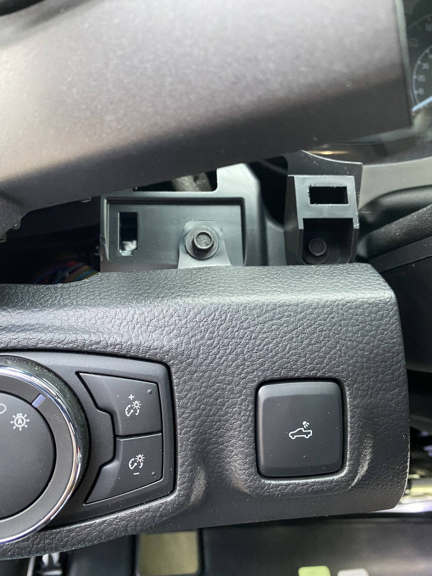

The mirror module was still easy and only slightly more involved. There is a 7mm screw on a tab at the top of the headlight control panel. The extra wiring required in the kick-panel took a few minutes. The wire colour is correct. It doesn’t help that I am colour blind. I would like to know the function of those loose wires, so I could test to verify before connecting to them.
It’s all done. I took lots of pics if anybody would find them helpful.
I'm back at work for a few weeks, so not sure when they'll get installed. I watched the video for the windows, and it's fairly easy, just a door panel. Danager was kind enough to post his mirror install, and also looks pretty straight forward.
I will post if I have problem though.

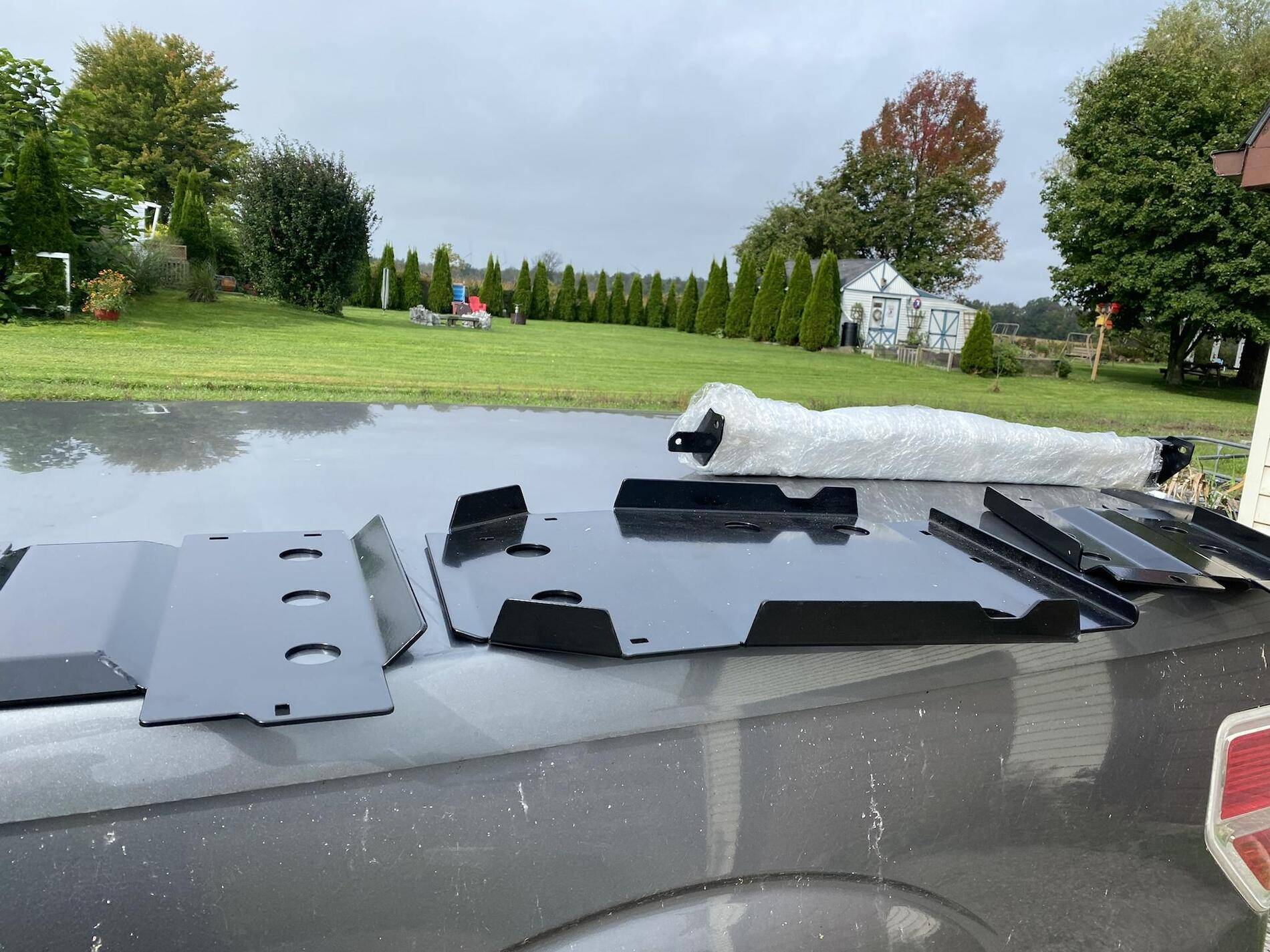

Shrockworks steel skid plates #2, 3 & 4.
Ford installed a Westin front skid plate when I had the Warn bumper installed, and it is also heavy steel. I'm generally not a Westin fan, but the plate is more than adequate and looks great, so I didn't bother with the front Shrockworks plate.
Forcast says rain, rain, rain for the next number of days, so not sure if I'll get them mounted on the weekend or not.
