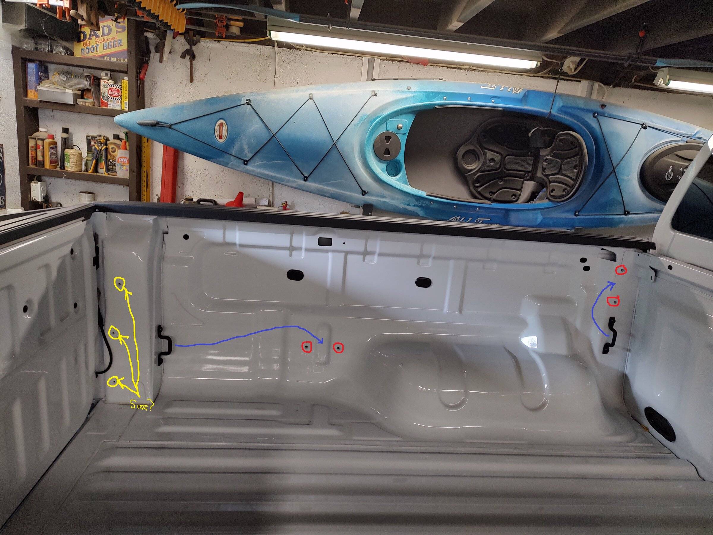

Waiting for the Ford bed mat I ordered - but looking in the bed today - I just want more tie down hooks.
Just put my order in with Benny's help.
More is better :sunglasses: I am a bungee cord madman.
Probably fill the 3 vertical holes next to tail gate on both sides
with correct size M6 bolts too while I'm at it.
Tap ready to clear threads and anti seize to do the job right.

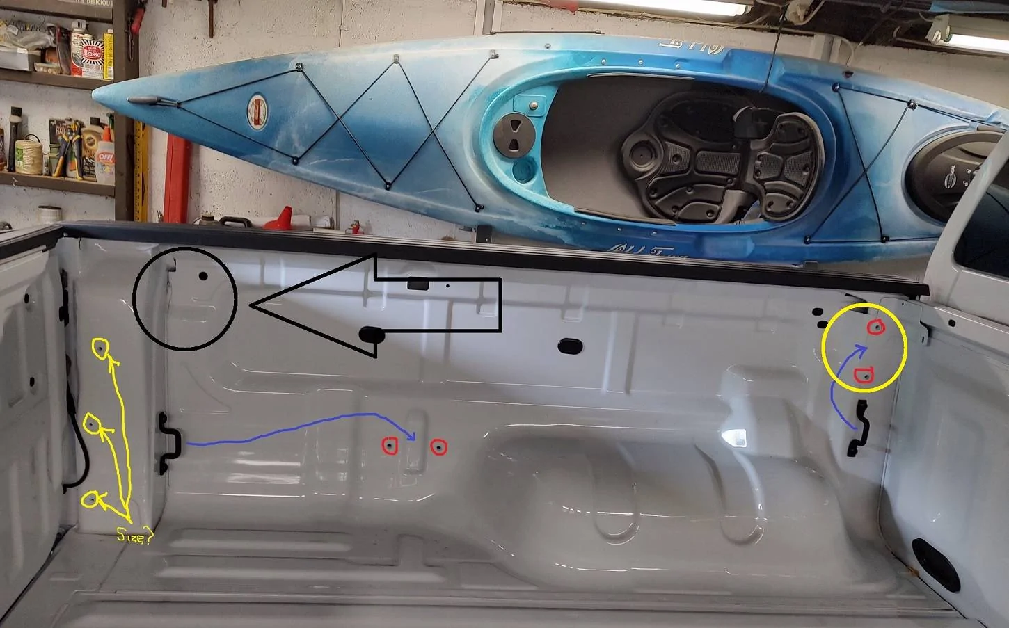

I've been curious about the two front holes at the top, since I noticed them a few days ago. They appear to be similar size as the lower tie-down point, but haven't had time to clean the bed liner out of the threads to test fit. I'd really like something at the top near the back as well. Please post your results :)
My F150 I added rail tie downs to the holes near the tailgate. Pop the taillights out and the full back plate went in, to support the tie-downs. They didn't look great, but so much more useful to tie the kayak in the box without having to stretch through to the factory tie-downs. I haven't decided what I'm going to do on the same location of the Ranger, but something will be there this summer.

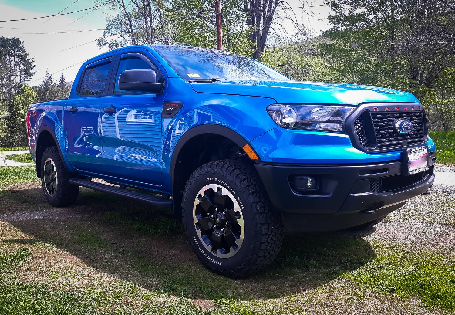

Welp, fell for another of AzScorpion's shameless sales pitches. Washed the truck and gave 303 Graphene sealer a try. Here's my take: 1) unlike most waxes, polishes etc. this does not have any cleaning affect. I had a few places that had some water spotting and the spray didn't touch them. Went over it after with Griot's detailer and they came right off (not to mention inhanced the shine!).
2) It was a little more work than expected. Polishing of the residue after it hazed was akin to using a carnuba wax. A little rubbing involved. Course it was sunny and in the 80's so that might have something to do with it.
3) This stuff really brings out the gloss! Especially if you hit it afterwords with a detailer spray. Truck hasn't looked this good since it was new. Gotta admit, if it holds up as well as reported, I'm sold!

Beautiful truck.
You did good!

Thanks Chris. I have to admit, I love this thing. 16,000 trouble free miles, getting 23-24 mpg, goes when you step on it and draws looks everywhere. What more could you ask for!

I have a Decked system in the back of my Ranger and used the two closest to the cab to relocate my lower tie-down upward. It fits, almost. I had to oval out both holes in the tie-down (maybe 1/16" each) to get the holes lined up. Re-installed and sprayed with some bed liner, you can't even tell I moved them.

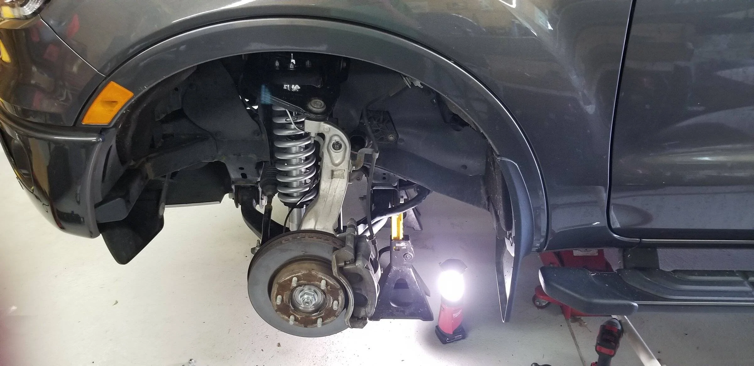

Finally had time to put the FP Fox 2.0 fronts on. Broke a stabilizer bar link in the process ?. OE ends on the links are plastic. Lucky a local shop had aftermarket ones available that were full metal. Now I need to get an alignment.​
