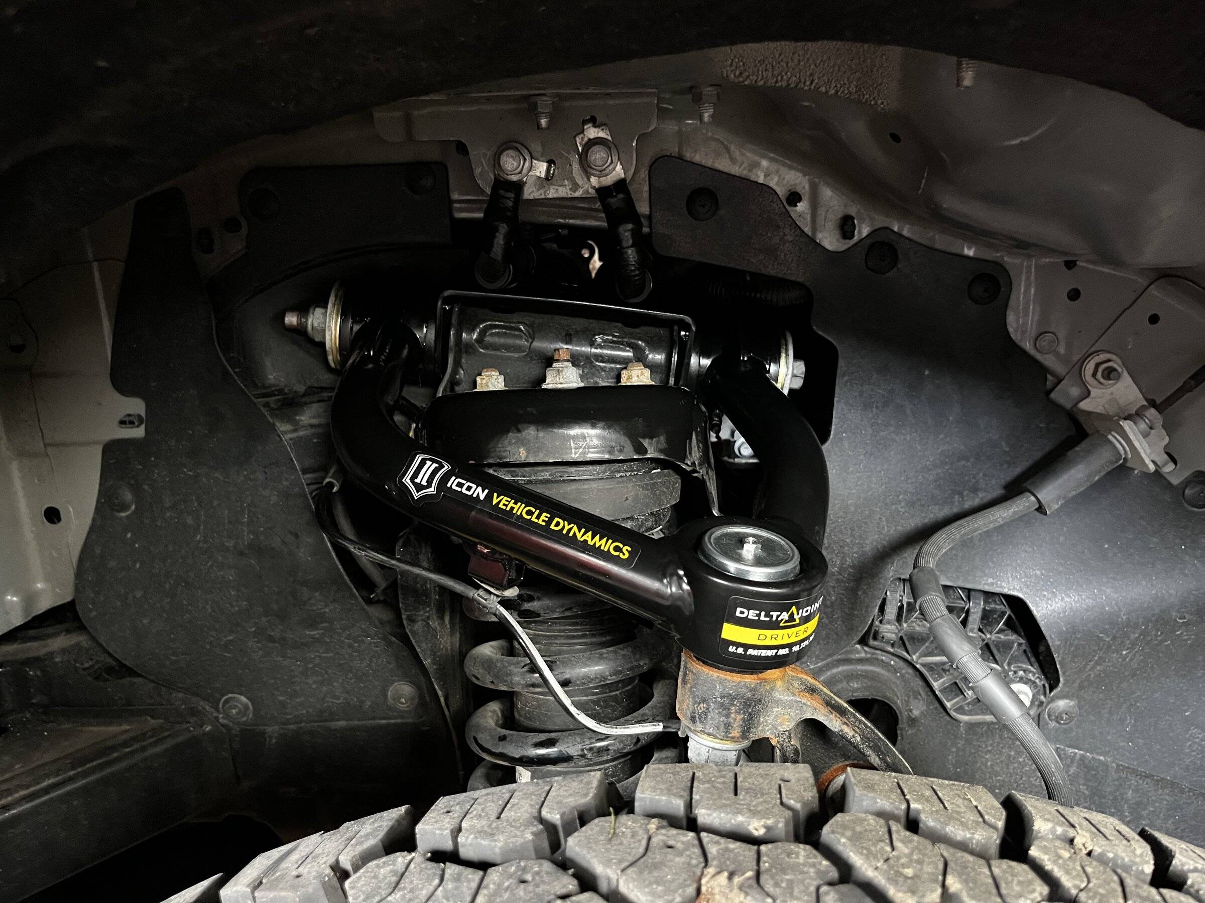

Installed my Icon UCA’s today. Install went smooth and they look great. Only hiccup was one of the small washers was standard and not metric so I had to drill it out all little bit.
I have yet to do this as I waiting on new coilovers, but where did you use the small washers. I have them in the box, but did not see them referenced in the instructions. Thanks! Jason
btw... those look great!
(EDIT: I think I figured it out, two washers per side, go on with the nut after it goes through the top of the spindle)

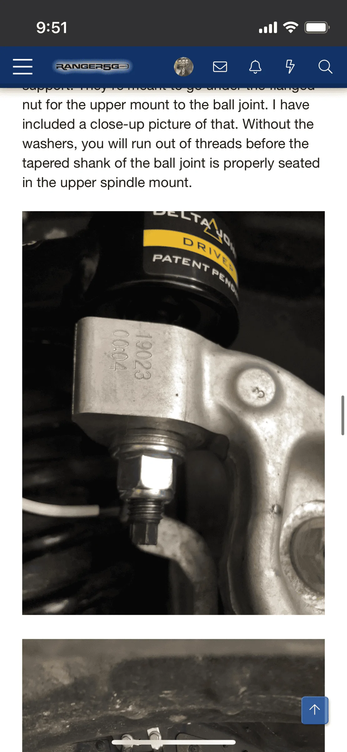

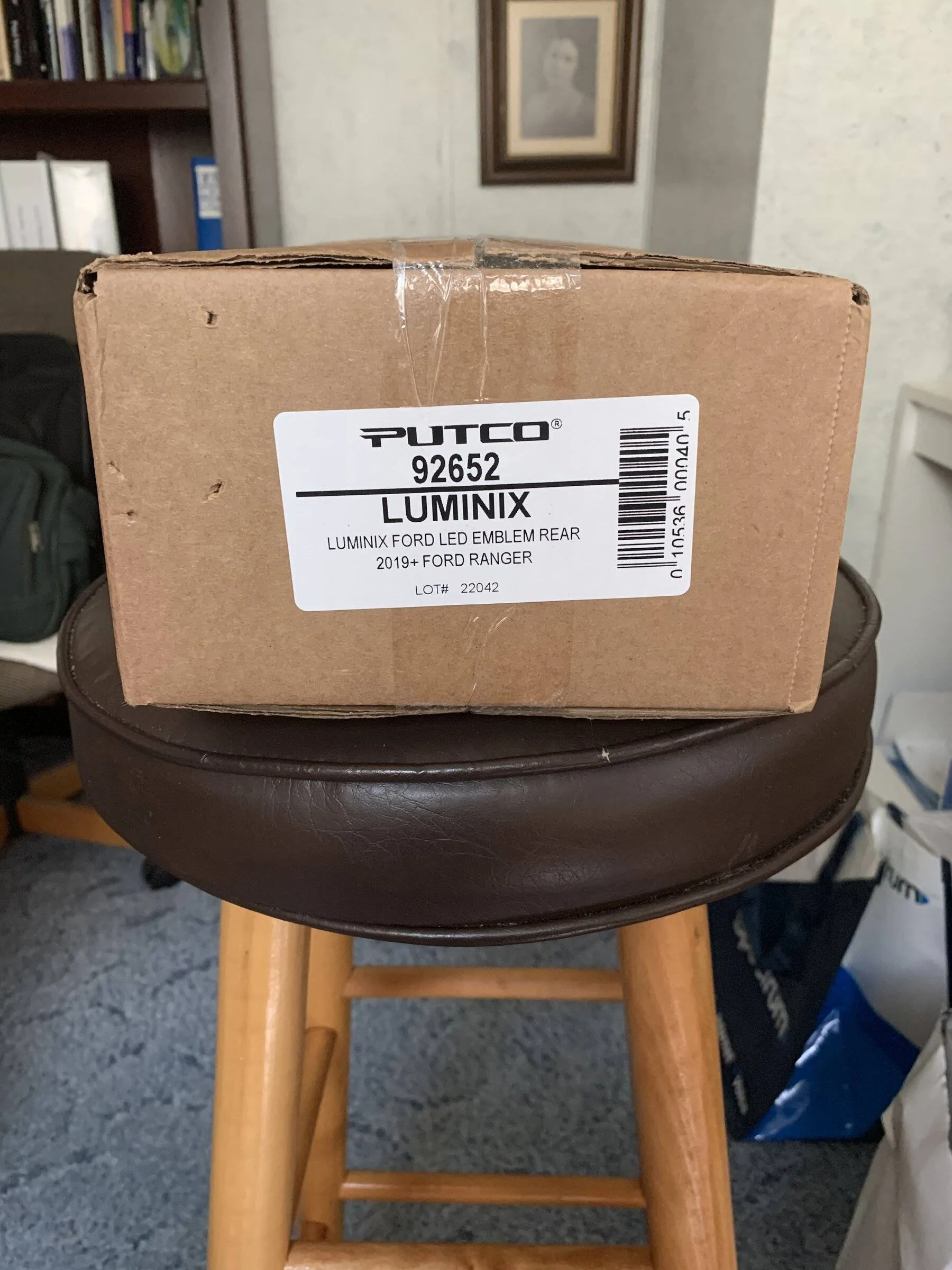

Nice find! I am very interested in the rear with red brake light. I am just waiting for your install and confirmation that it works without errors, as other add-on rear lights tend to cause.
Arrived today (order processed on the 11th). Install one day next week....

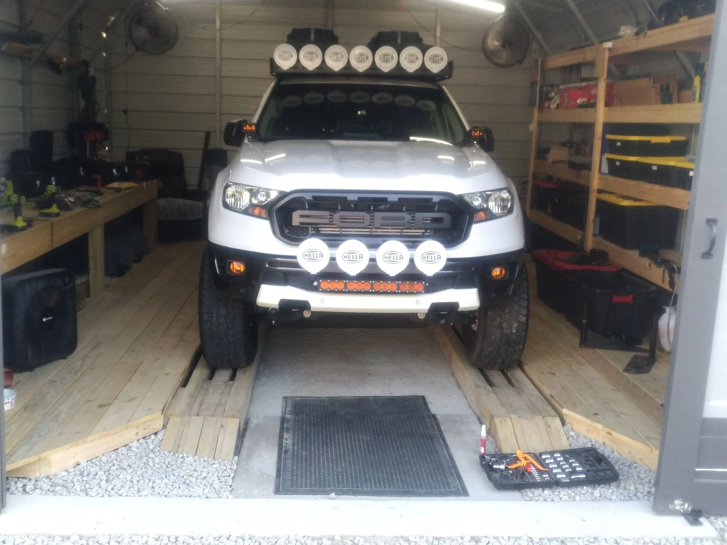

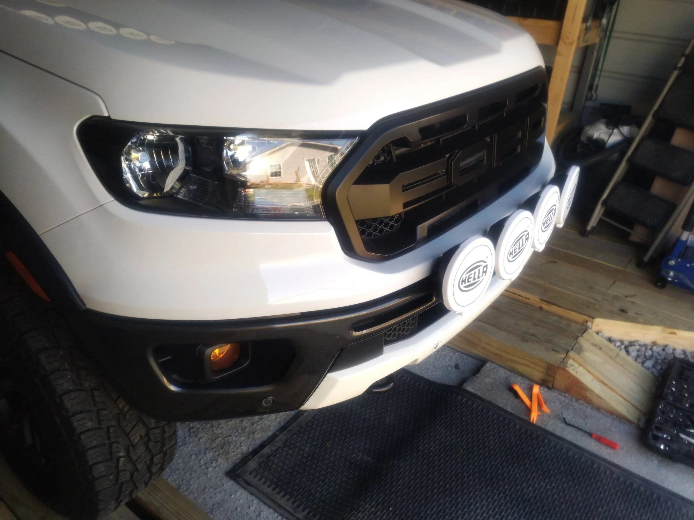

Not a perfect match but I decided to do the lower valence in white satin. Wants it fully cures I'll polish it and it'll probably bring it up closer to a shine like the regular paint but I kind of wanted it more dull anyhow.
Also changed a few lenses around on my old light bar so instead of dual function I have a full function fog bar.

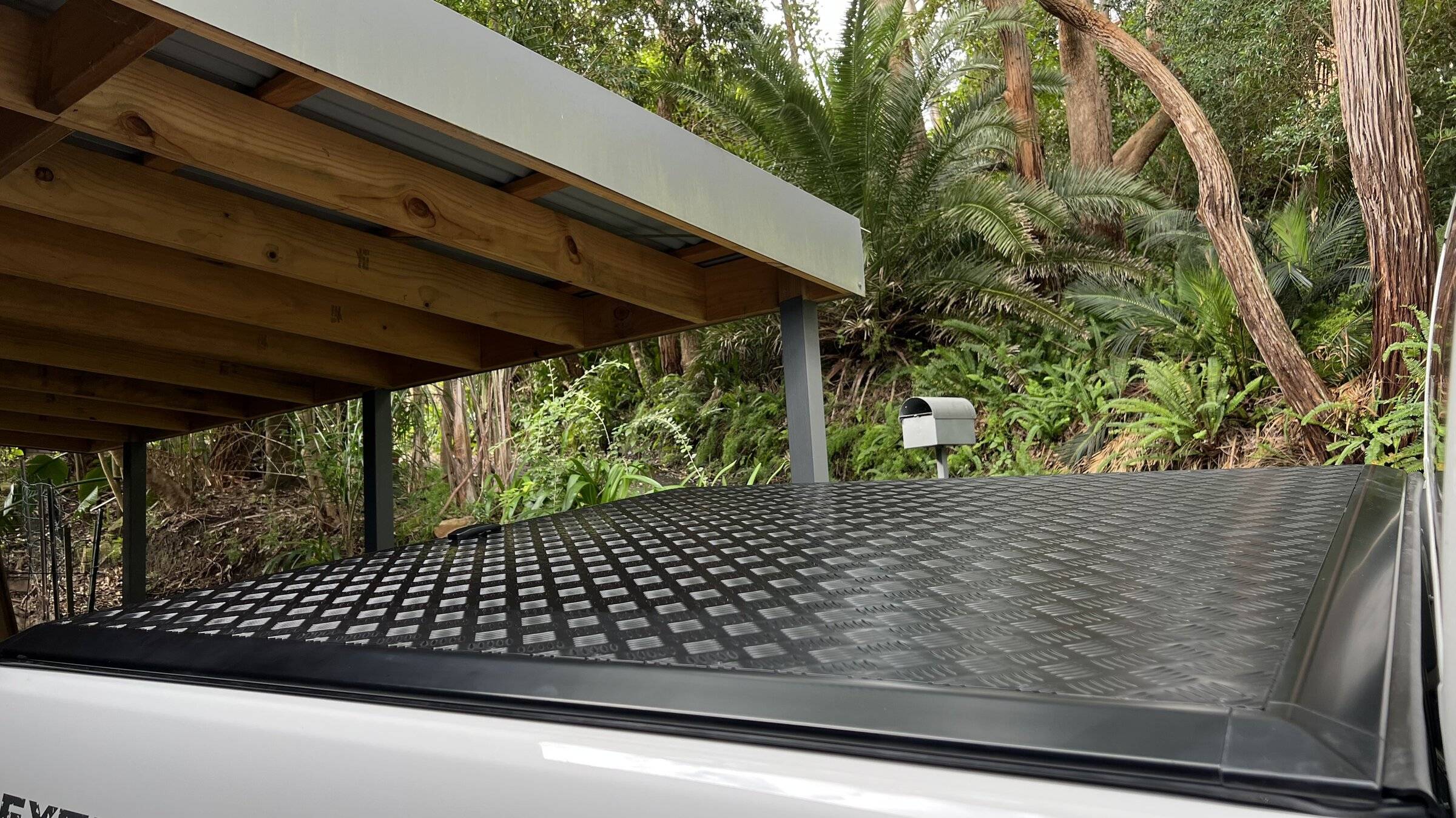

Alloy hard cover came a week or two ago and I refused to pay $400 for fitting.
Then I decided not to have the guys in our workshop fit it, as I was worried about scratches and stuff.
So I thought, me and my 5 y/o could knock this out in an hour or two (instructions said an hour). Six hours later, it’s on, with a few small things needed to make it perfect.
Nice fit, once I seal a couple of holes at front of tray (and tailgate) it’ll be water tight. Heaps more security than a soft cover (remote tailgate kit incoming), sturdier than a fibreglass one, and can remove in two mins to use full tray if required.
Looks decent on truck and it was cheap as compared to OEM, not that I paid, but still. Overall, happy with a decision that took me months to make.
Big few days for the Ranger this weekend, with more to come.
