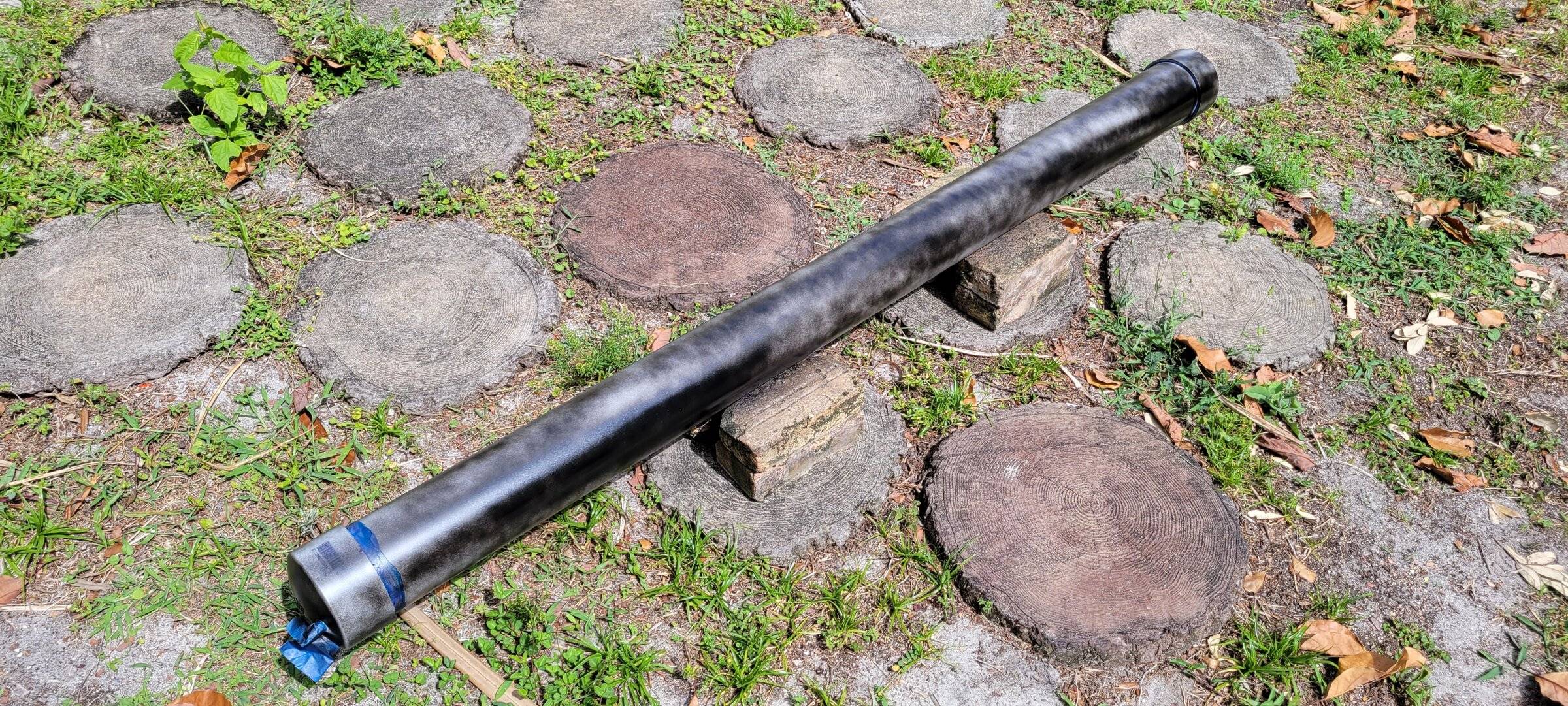

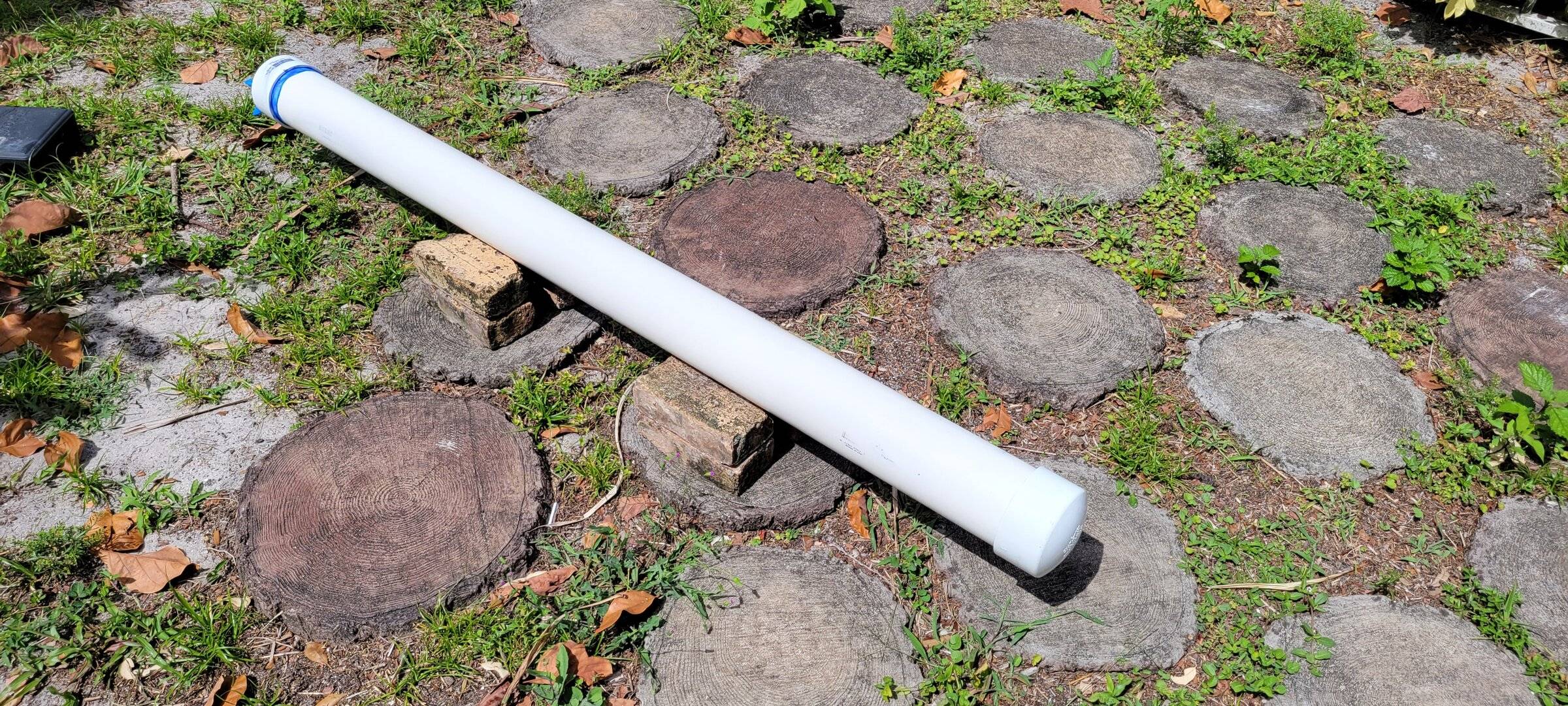

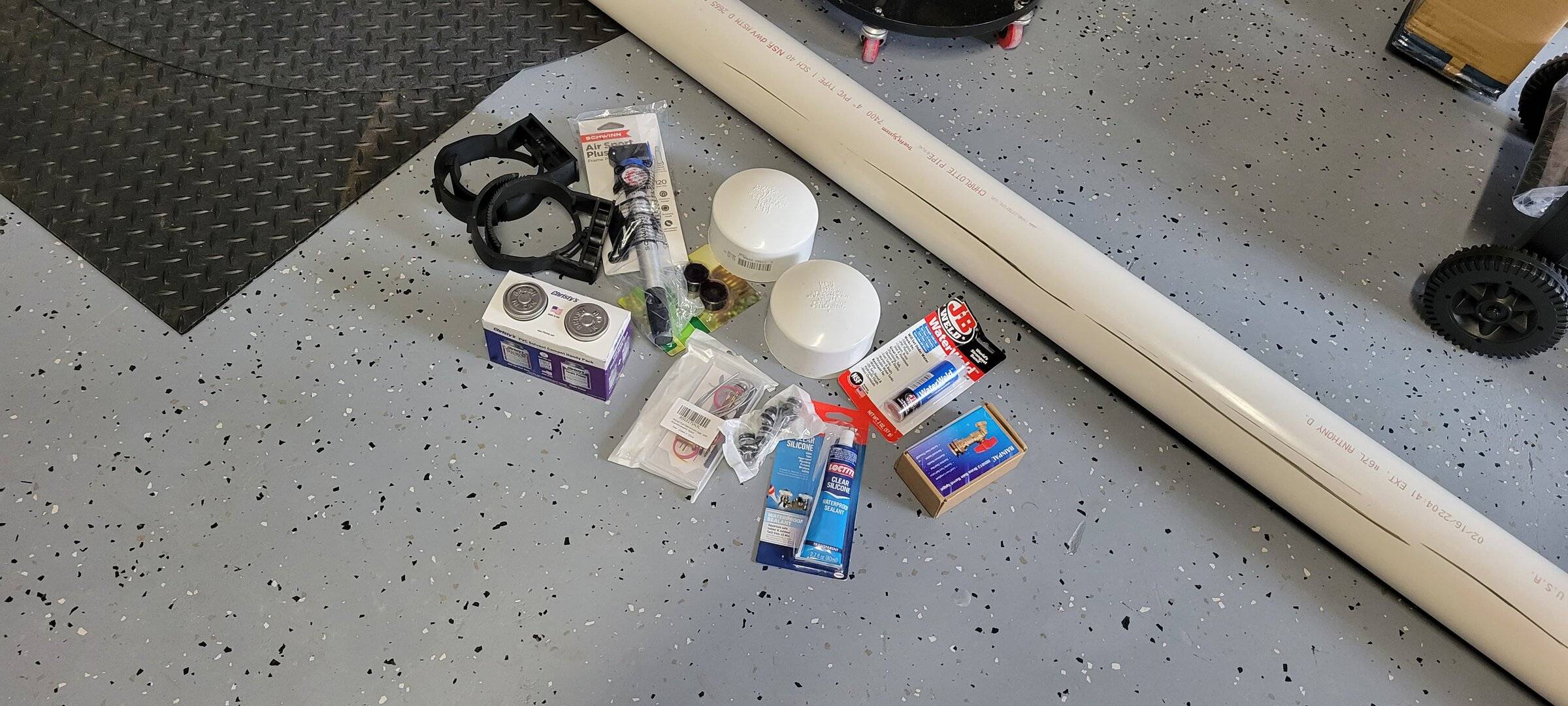

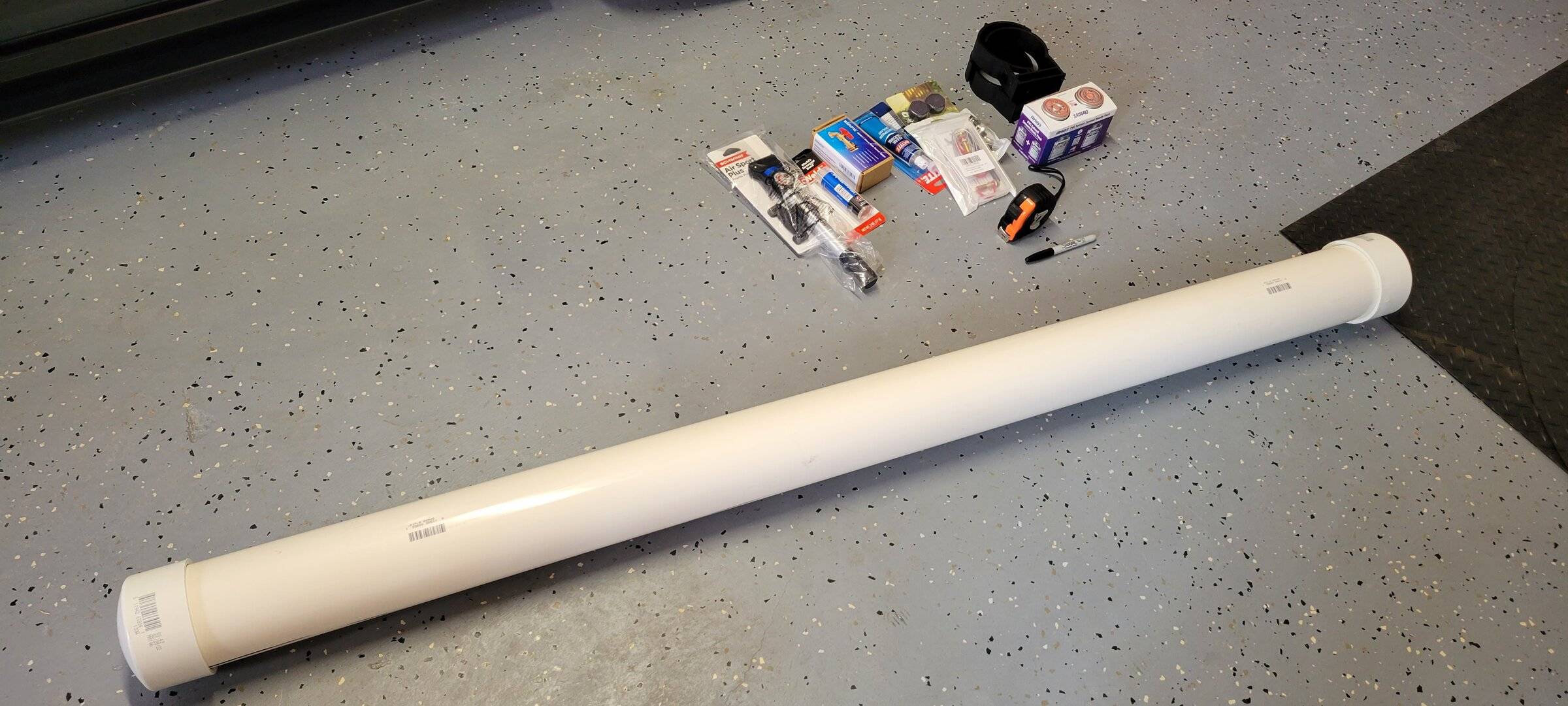

Started with a pile of parts...

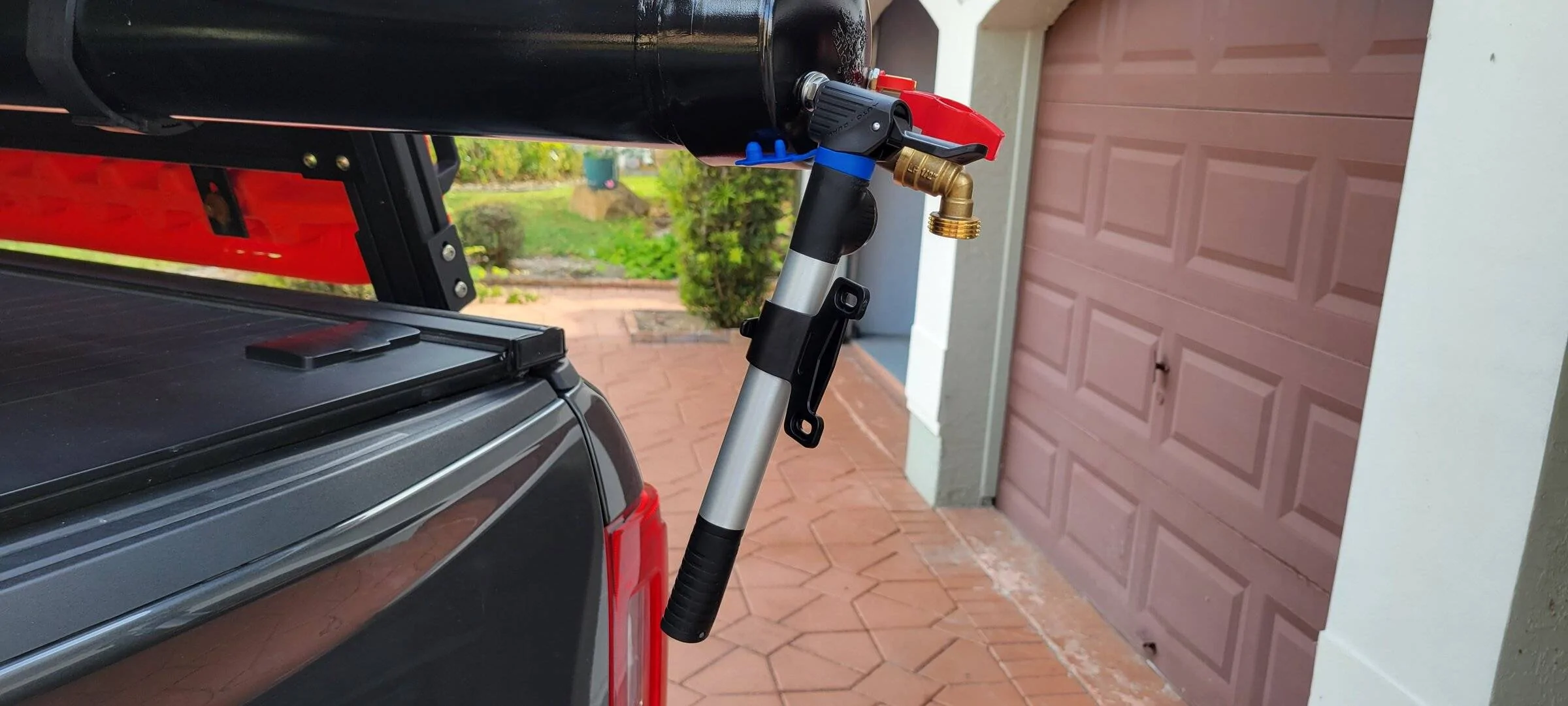

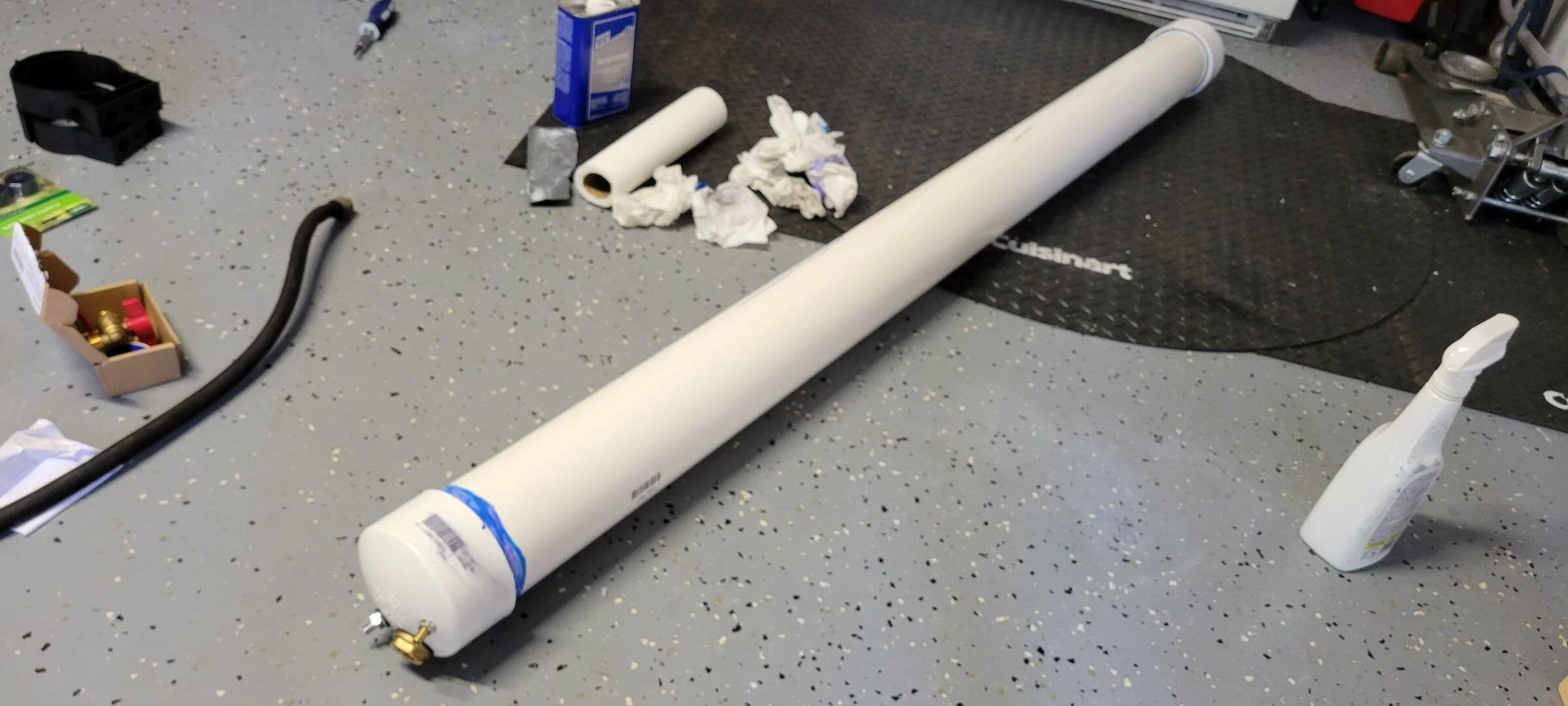

I cut the 10' PVC pipe down to 5.5'.

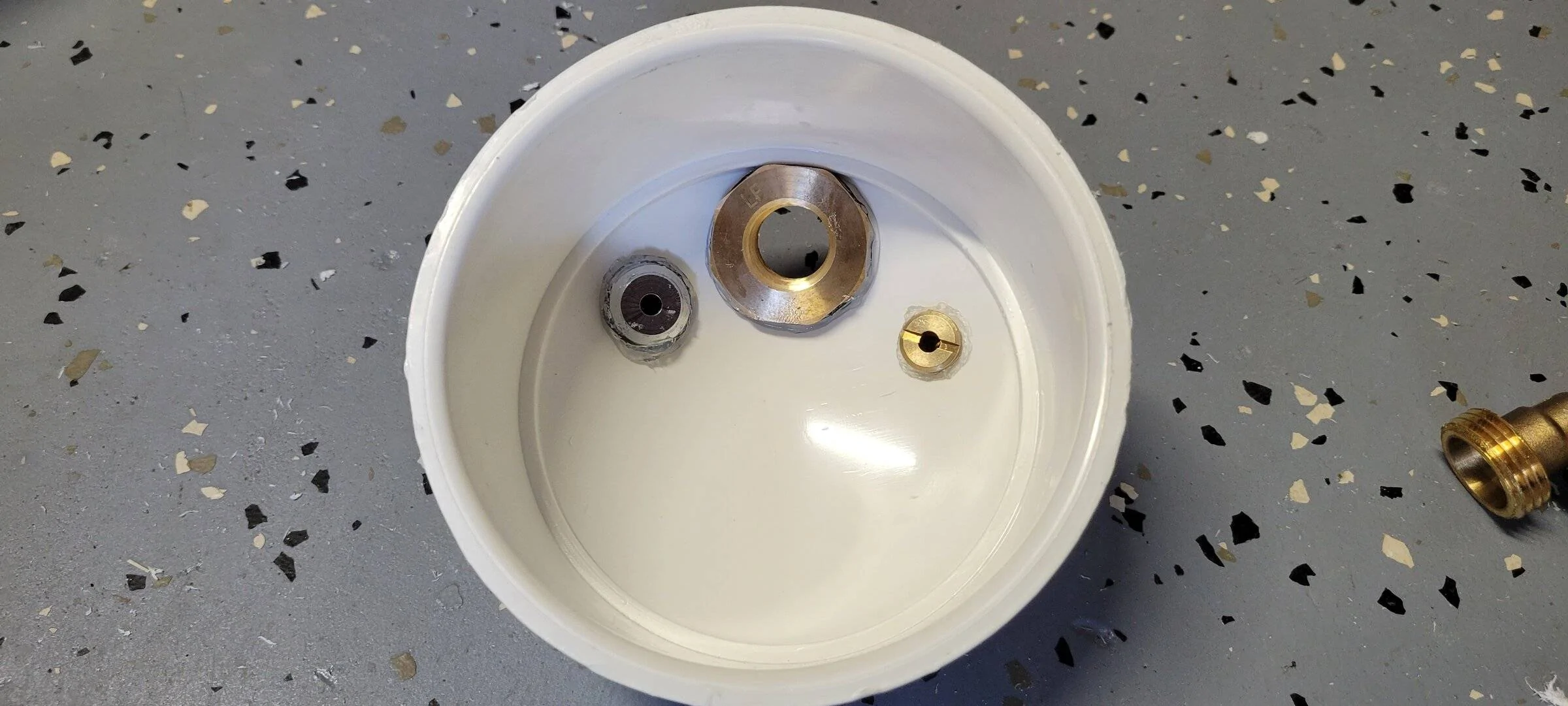

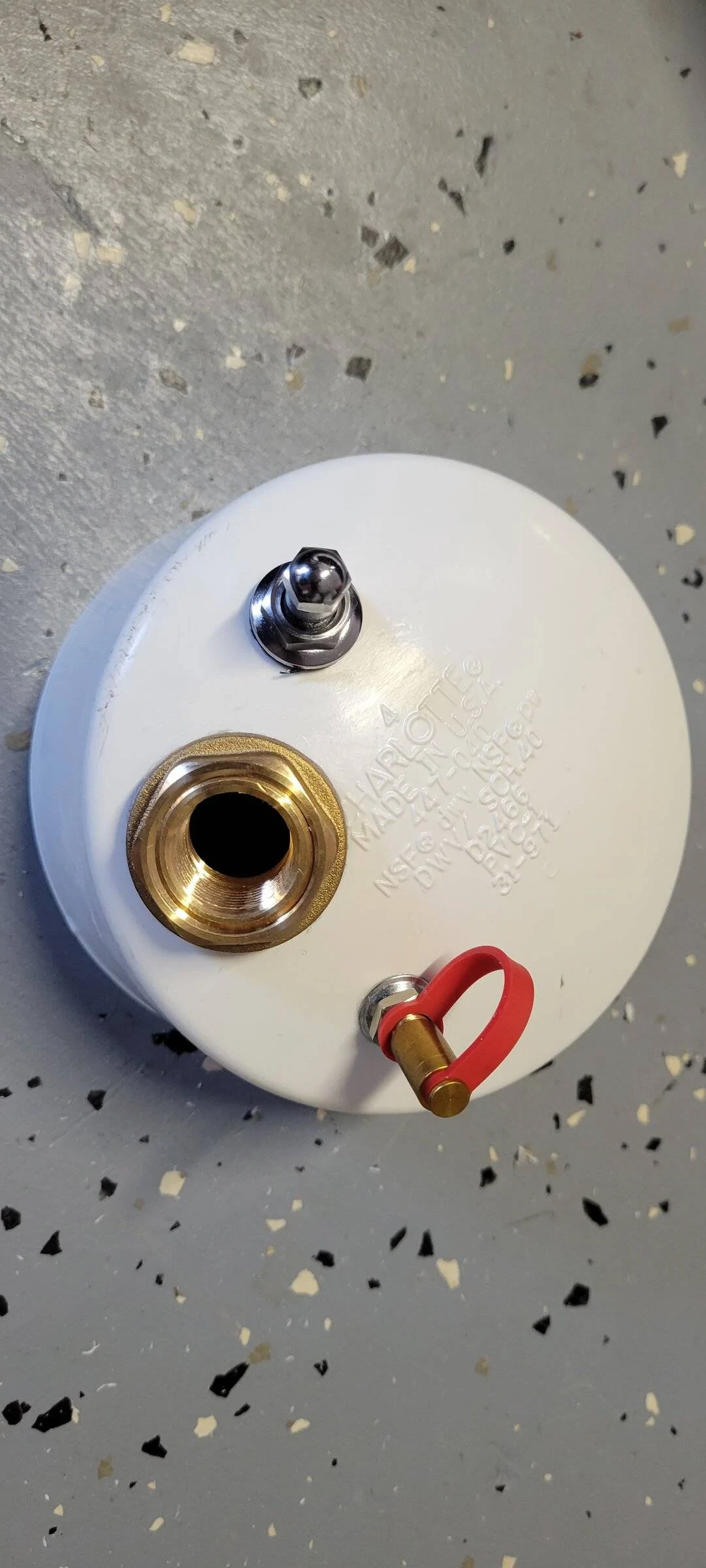

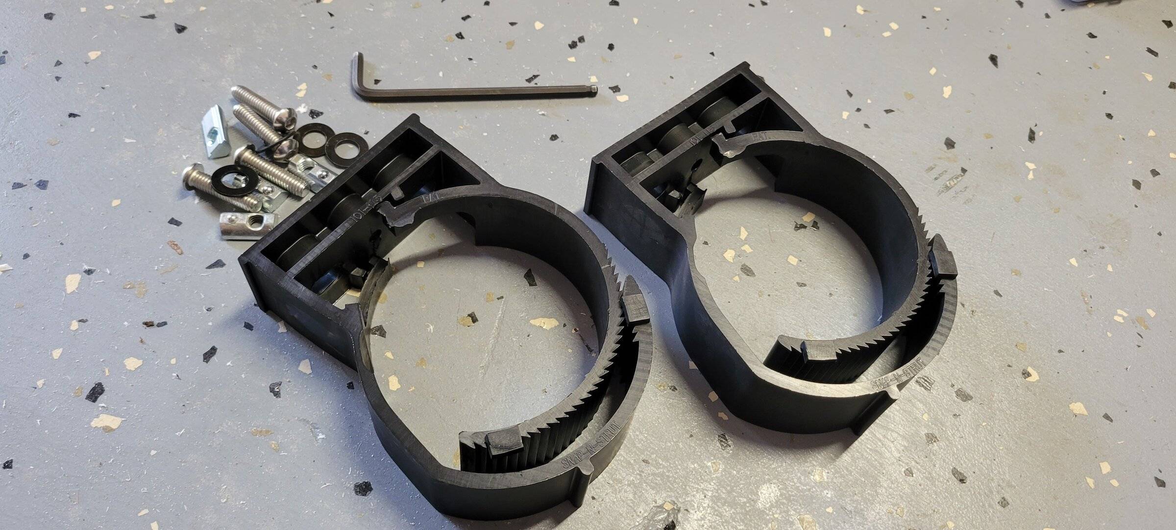

I then drilled holes into the end-caps and installed a ball valve spigot, a shrader valve, and a pressure relief bleeder.

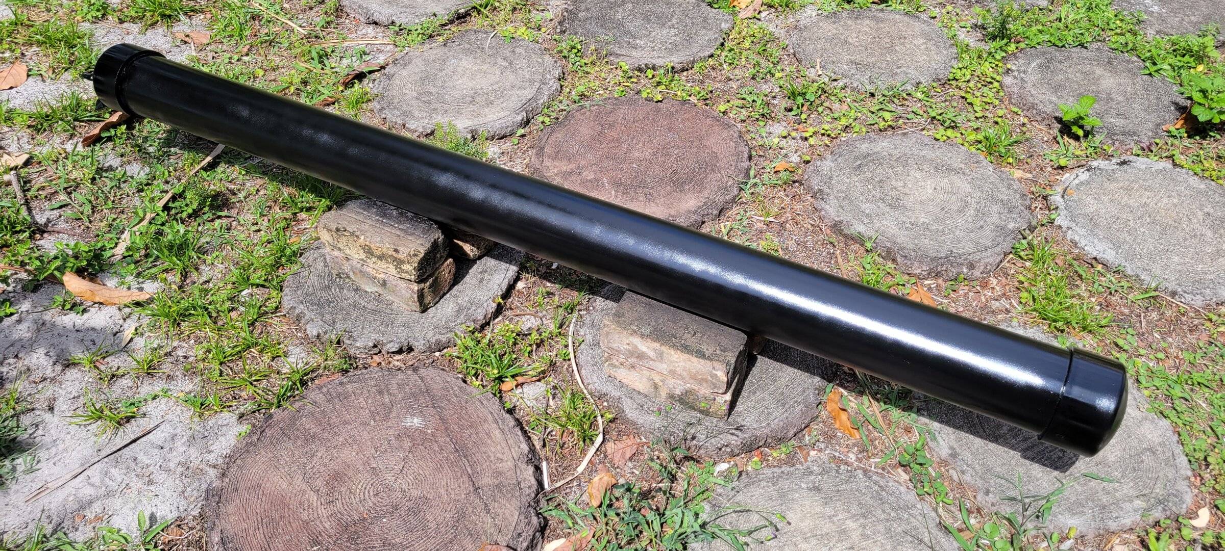

The caps got sealed on and I painted the whole thing black.

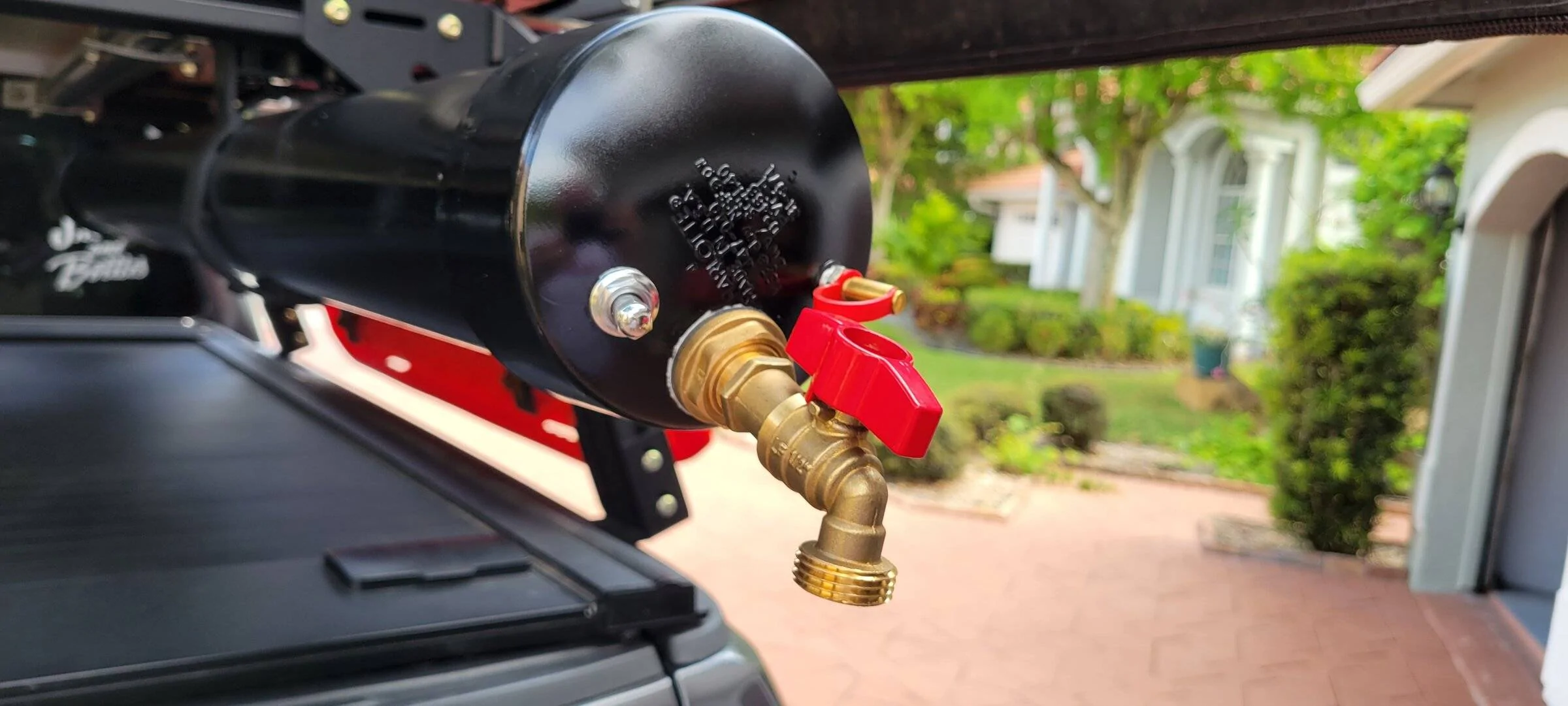

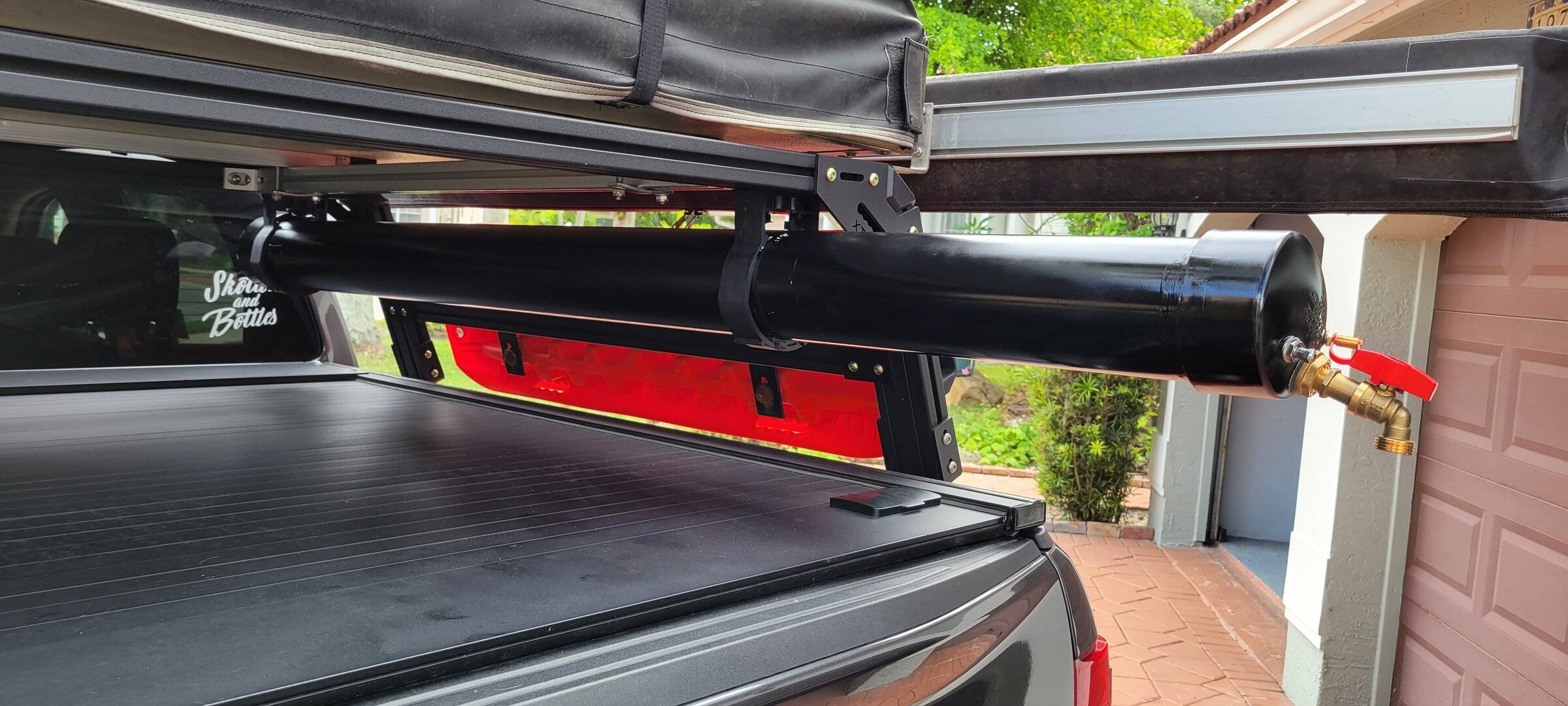

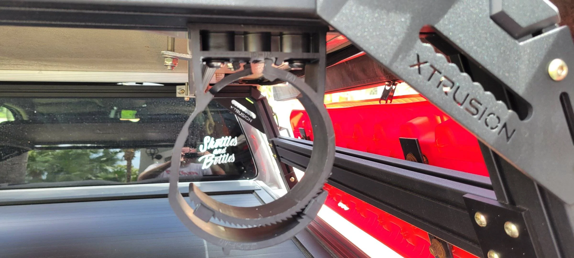

Then it was time to mount it onto my Ranger.

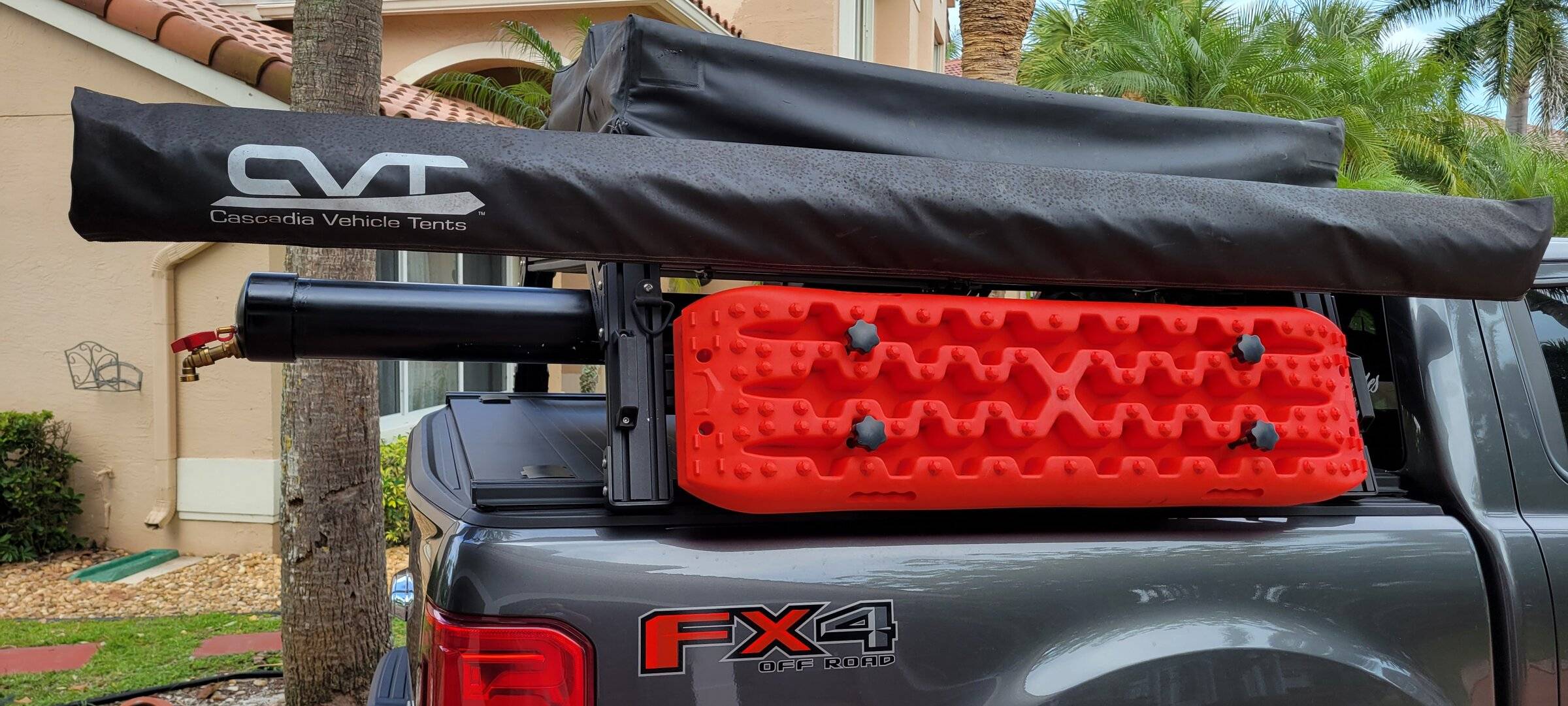

So now, when I go out to the beach, I can hose off the sand before I drive home! It has a 6.5 gallon capacity, and is partially charged by the water pressure of the hose filling it. I also have a small bicycle air pump to further charge it with air pressure.

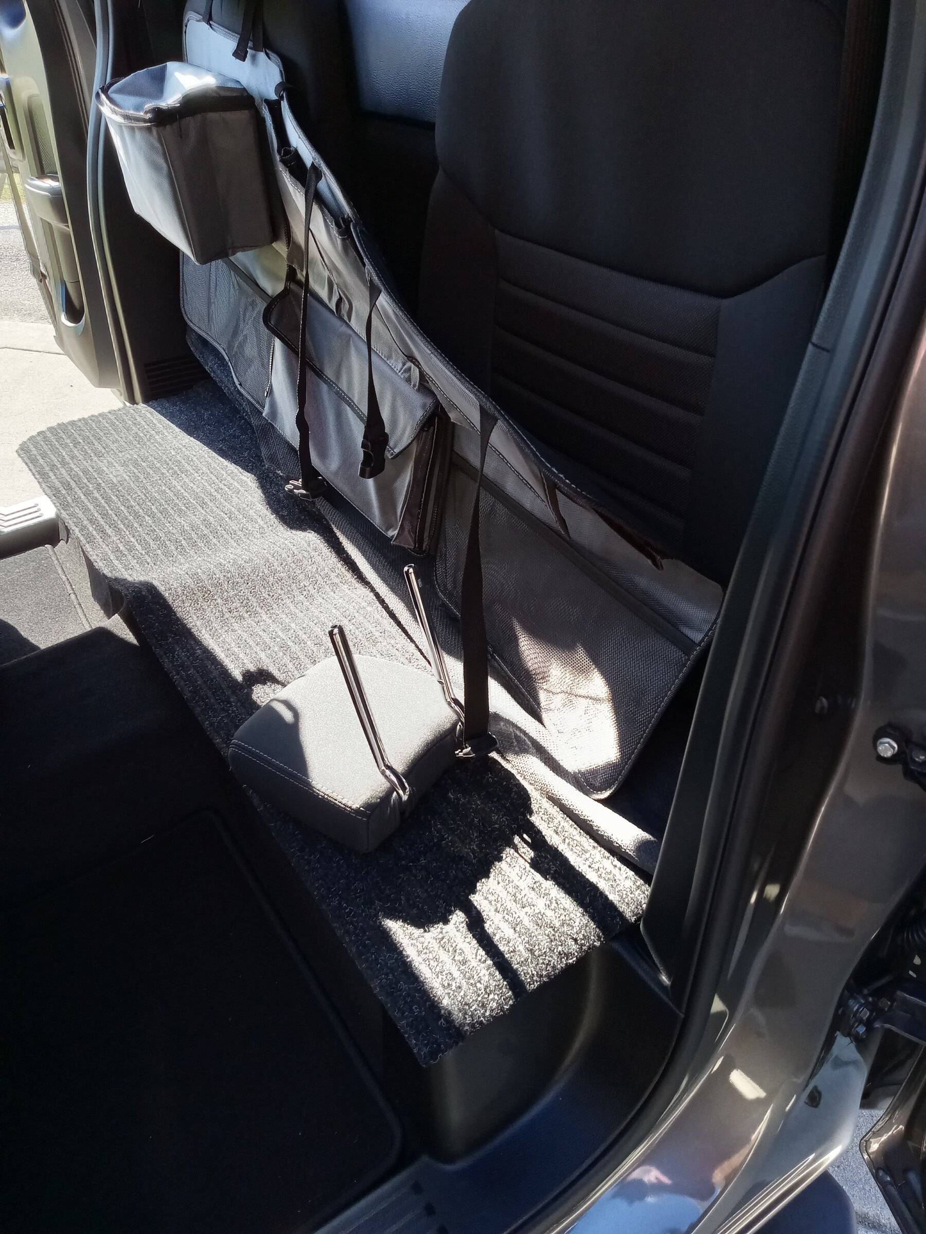

This looked way beefier in the pics and was supposed to be black... cheapo deal of the day , damn Amazon, gona have to stretch it tight somehow to be decent, and without those headrests...
Time to up your rear seat storage game broskie.

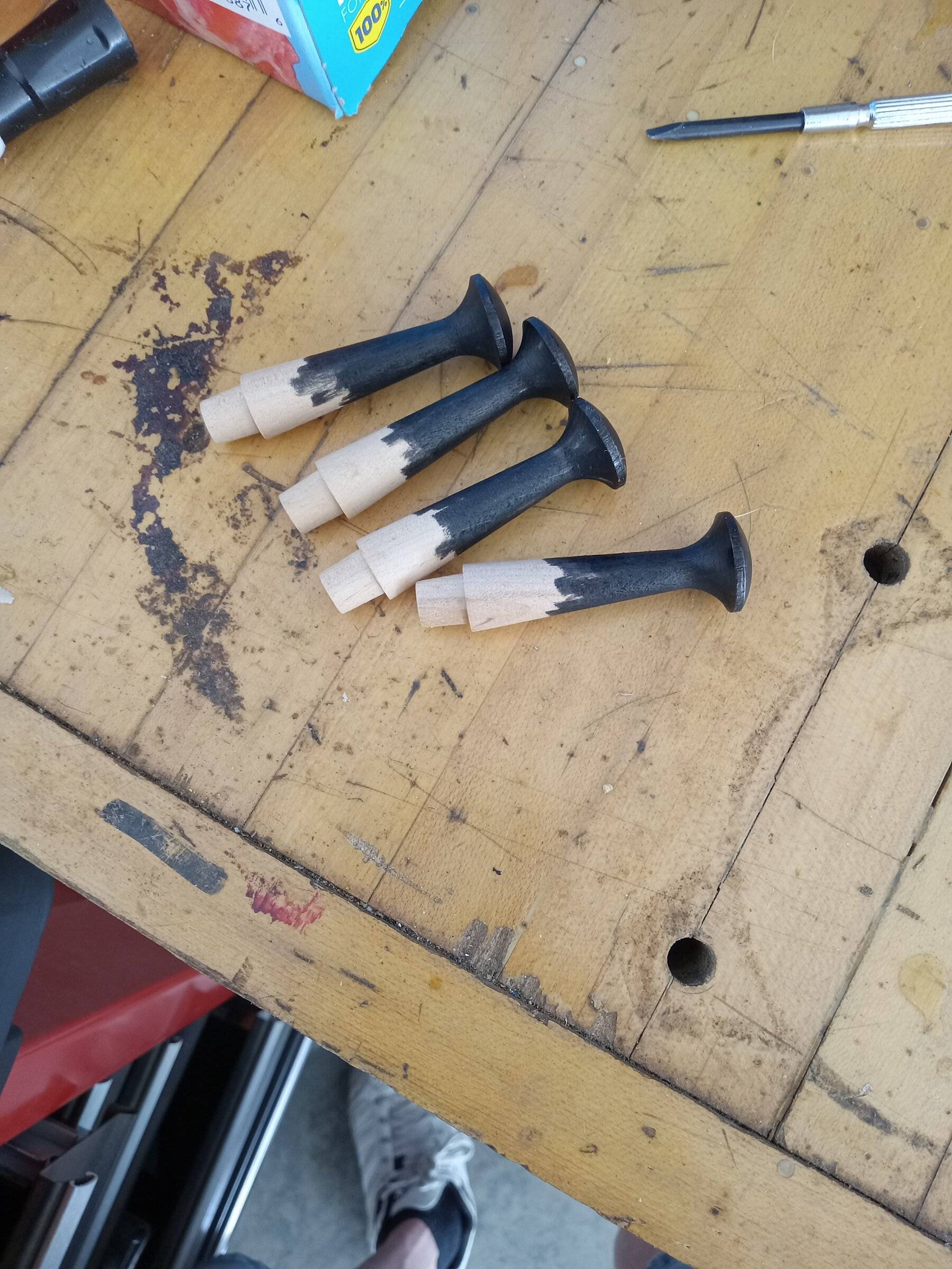

This was made to fit headrests that are further apart , and hung like crap, so I made do with some little wooden thingys and some tarp clamps ... gona make them send me a black one though...
That looks great and that's so clever with those wood coat hanger peg things, really good!

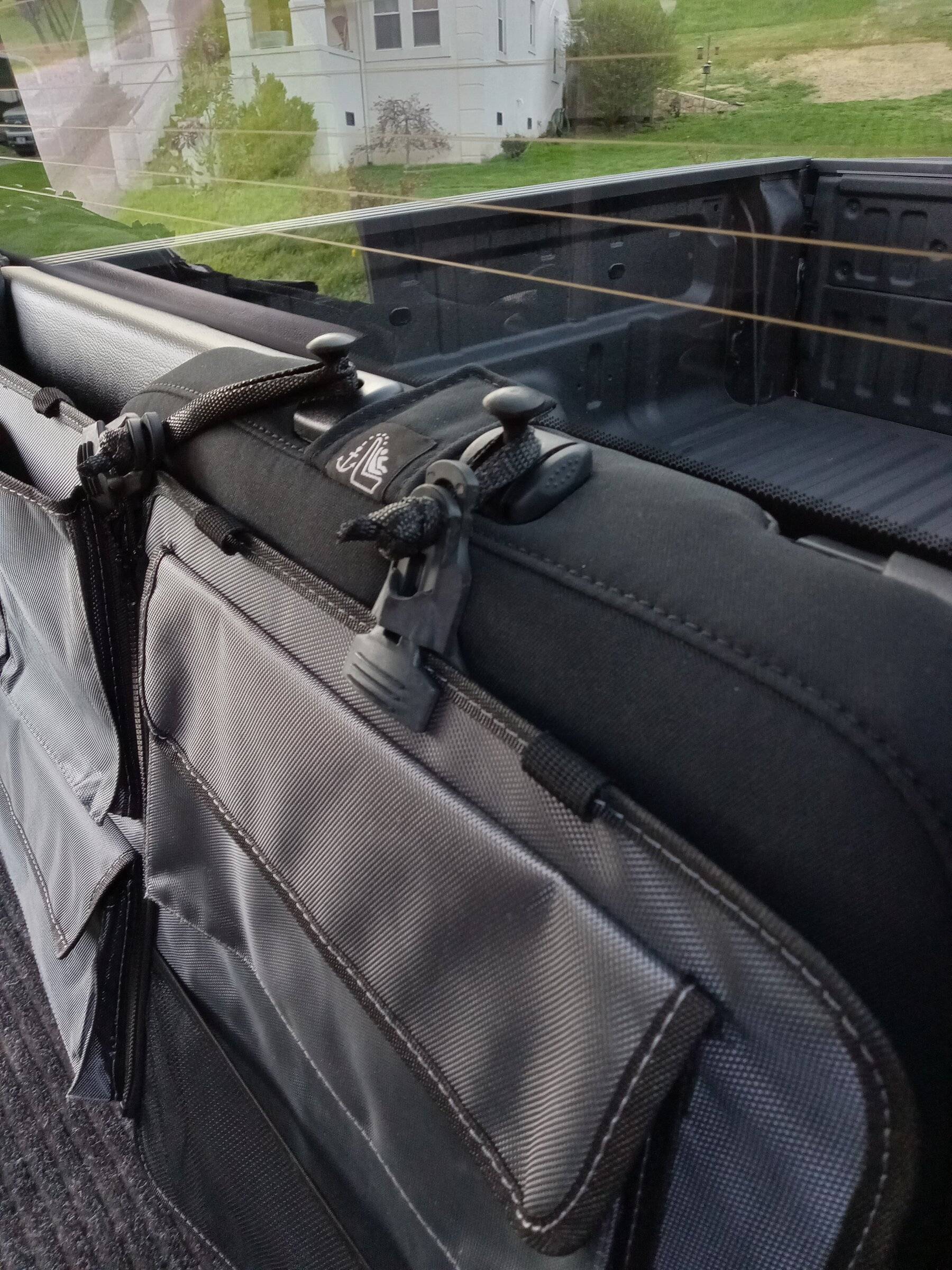

Great job on making the holders! :like: But if you're ever looking for a quick easy way they have these seat hangers available.
https://www.amazon.com/dp/B08HQYT9M...olid=1UKFKU4Y25LPI&psc=1&ref_=lv_ov_lig_dp_it
4,544
23,071
Thanks Dave! Yet another thing going into my Amazon cart for later purchase! That list is getting long!
