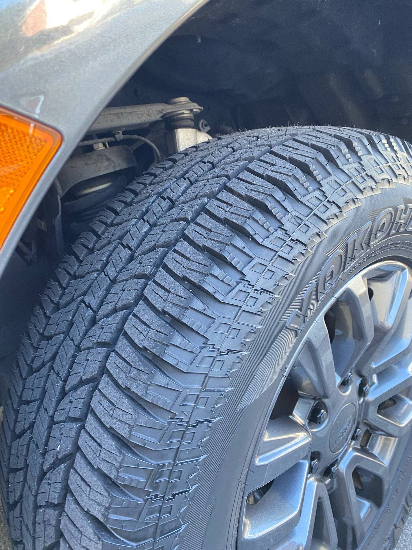

New Tires and lugs, i busted my torque wrench halfway thru so i went to HD and upgraded the torque wrench too lol
Never pass up a chance for new tools. Let us know how you like the tires. I've read good things about them.

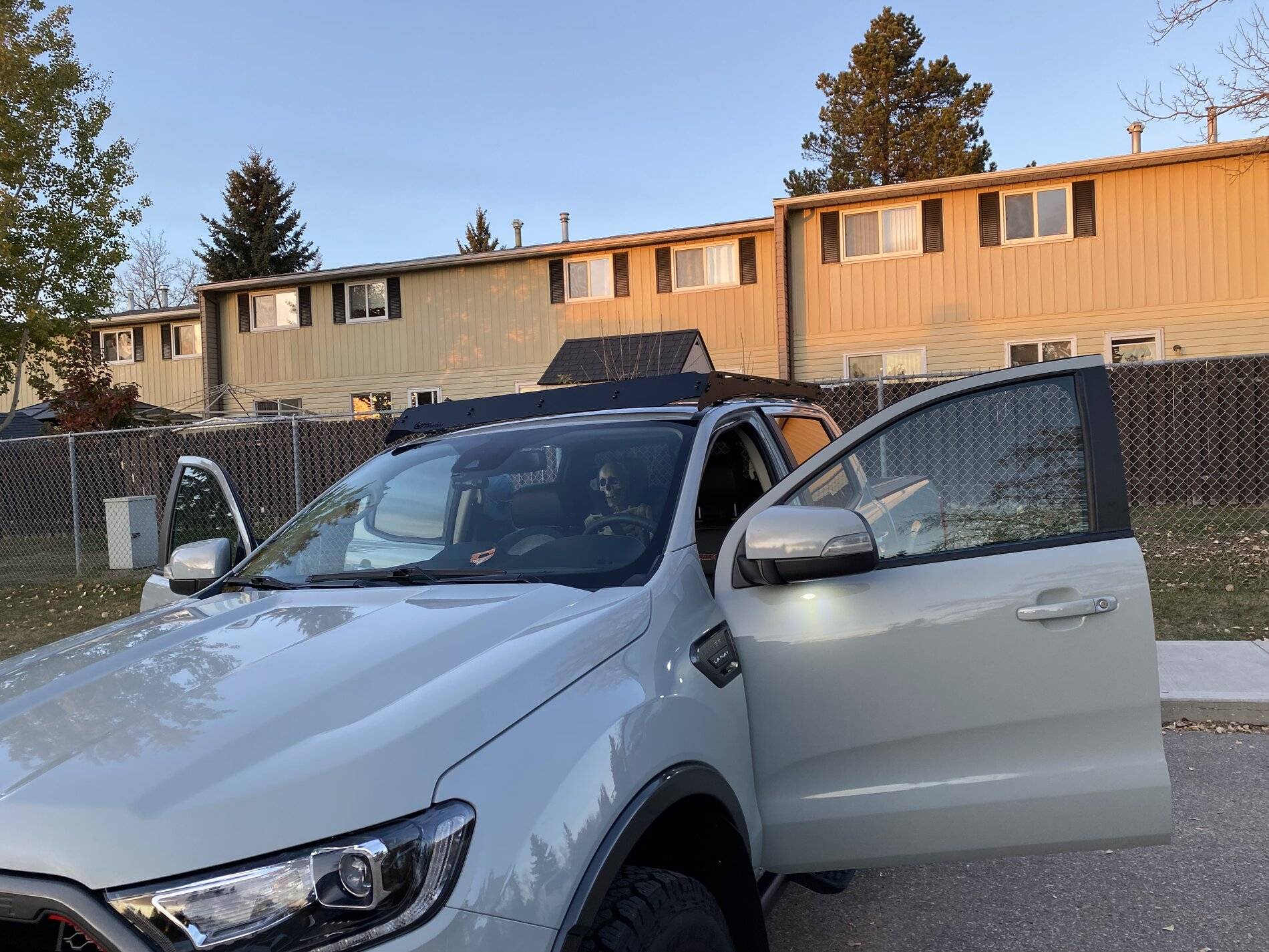

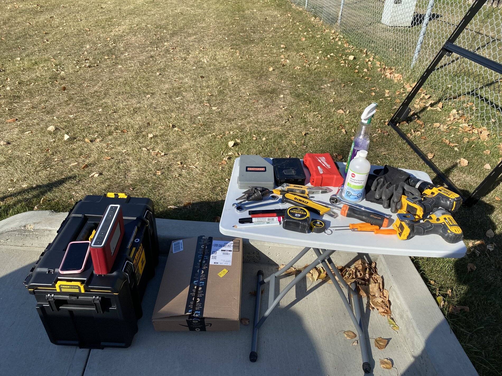

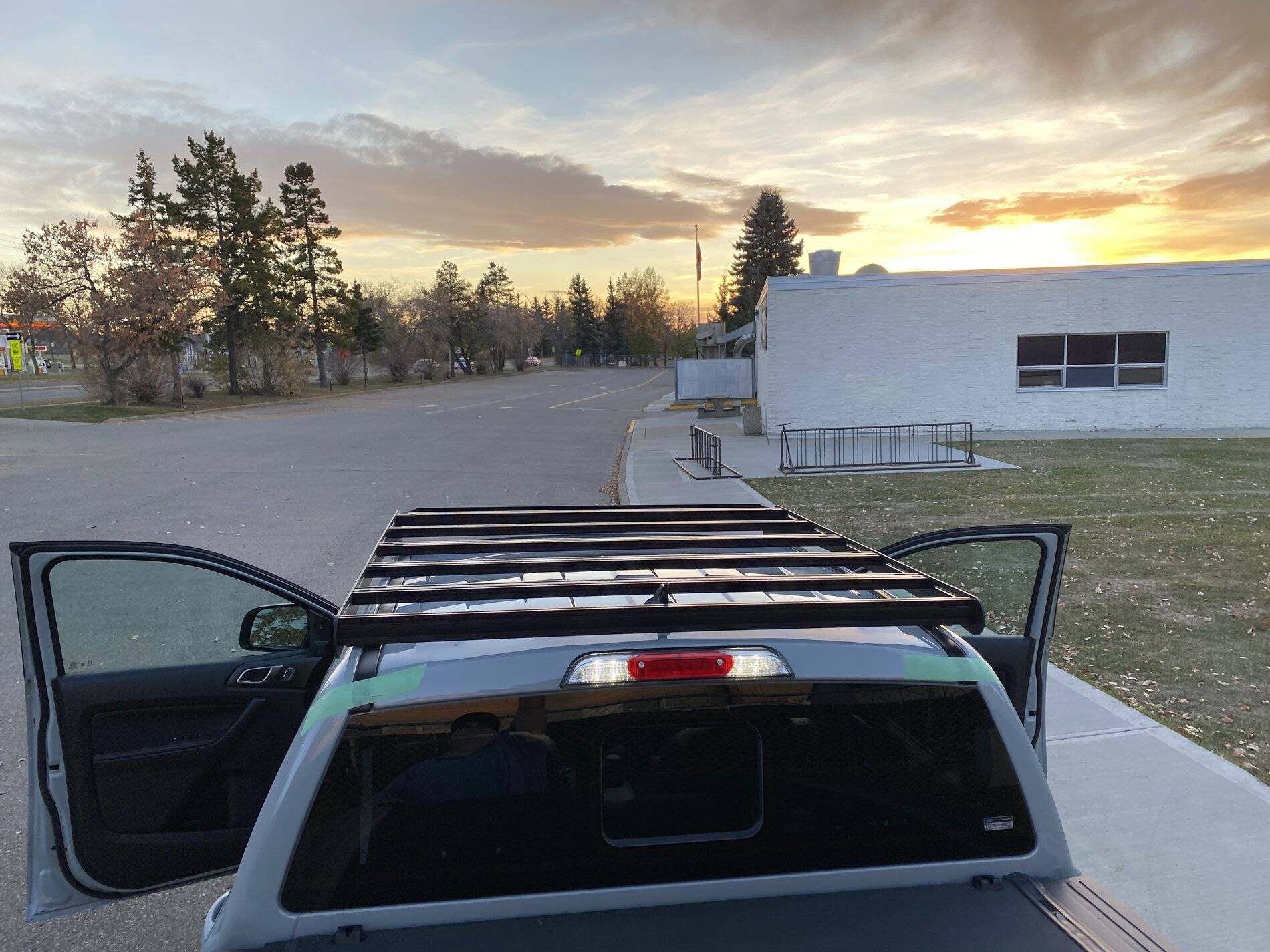

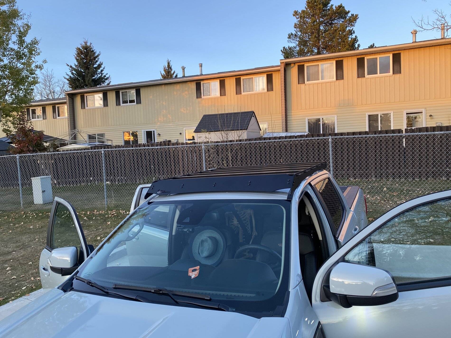

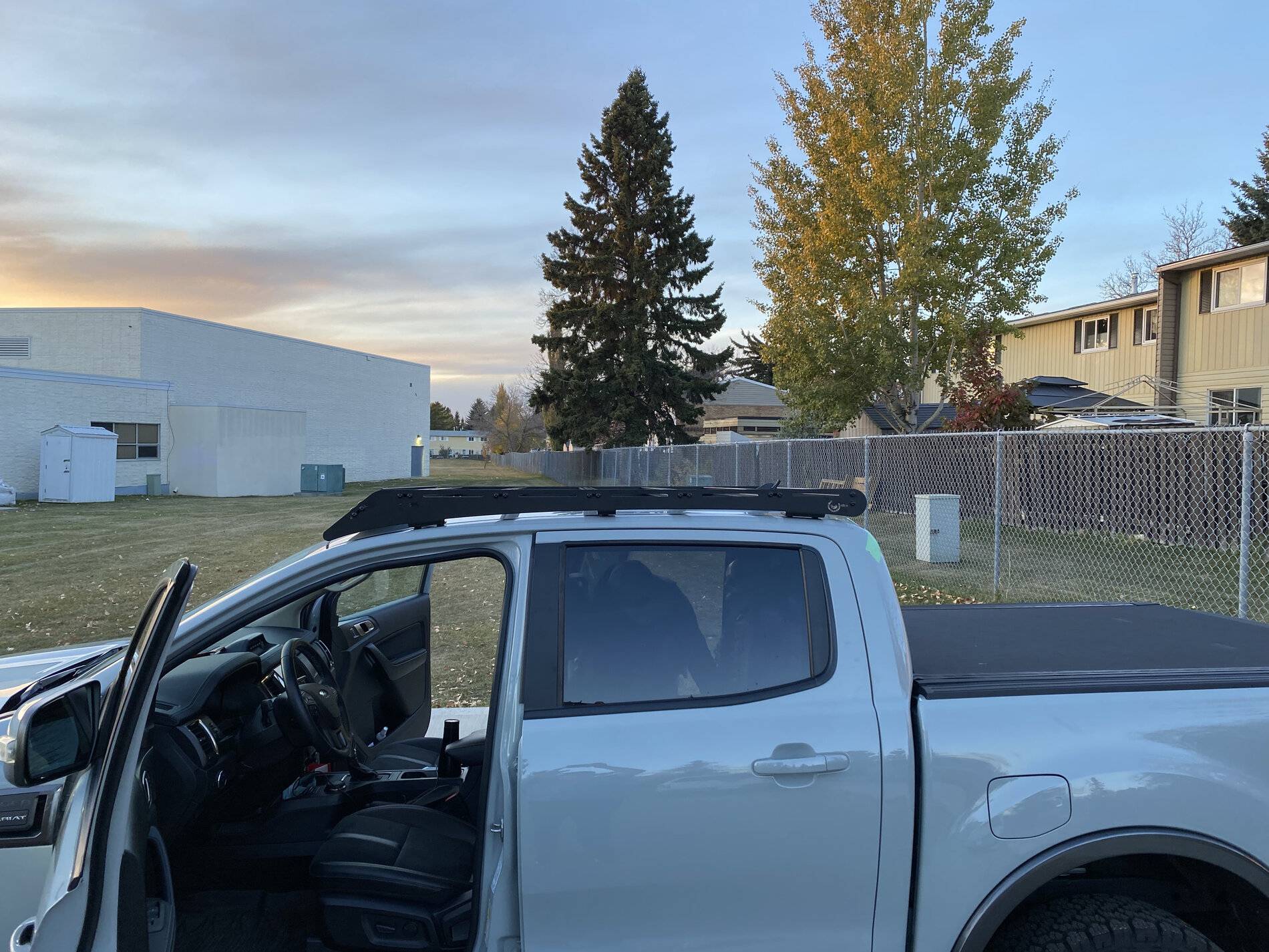

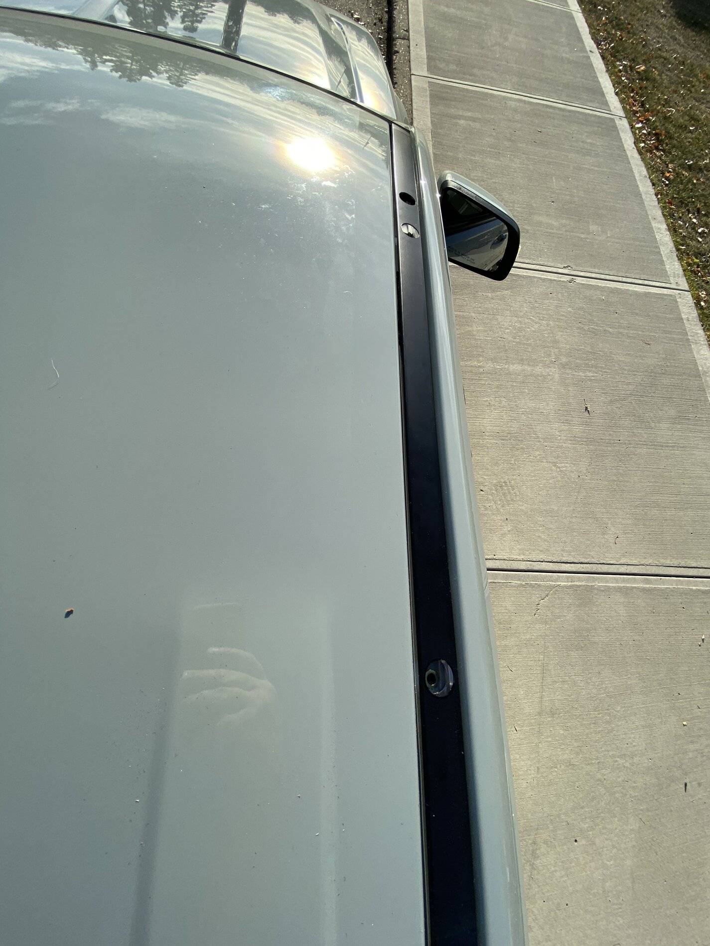

I knew it would be a loooooooong install. 6 hours from the moment I walked out the door to the moment I walked back in. Condo life presents some challenges. Had to do this in a school parking lot.
The girlfriend was there for moral support, and provided the snacks. She did help me lift it on/off twice and then with the final lift. Also made two trips back home for additional tools and supplies.
So, as I read - the aluminum rivnuts sucked. I replaced both with steel ones from a kit purchased on Amazon. Then, one of those broke. Had to use a nut and bolt on one of the centre brackets.
I also took the time to measure several times, transfer, drill, chamfer, touch of paint, new 2-sided tape - so I could get the rain gutters back on. Really glad I did. I think that part came out really good.
Here are some pics. I’m going to have a drink!

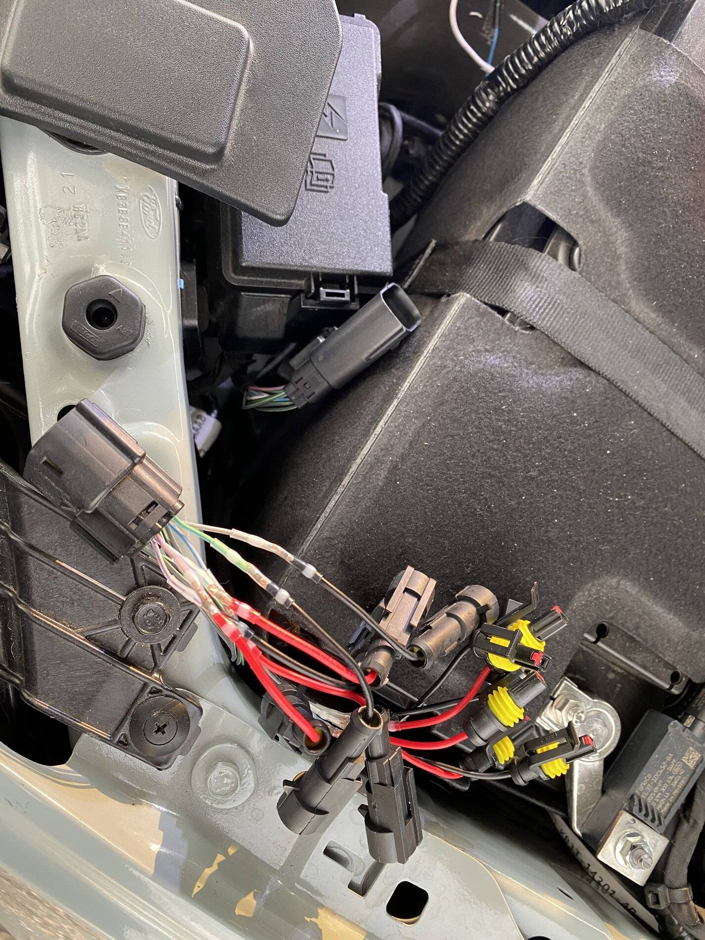

I finished the install of the Lux rock lights. Left some wire in case I want to move them.
I also mapped out the Tremor aux switch inputs. I installed the deutsch connectors so I can pair the switch to whatever output I want. For example, my rock lights are on a 5 amp output (output #4), but they will be triggered by switch #2. This allows me to select the switch order I need while still being able to optimize/match up to the output amperage needed.

That's pretty cool. So the Tremor's switches aren't matched to predetermined relays / circuits? As in you can swap which switch is powering a given rated circuit, or you slightly modified it with deutsch connectors to allow swapping them around? I'm just curious how Ford set up that wiring.
Danager
Dan
Apr 3, 2021
1,067
3,876
Alberta
2019 Edge
Manager
Ford has it pre-determined. Switch 1 @ 25amps, switch 2 @ 15amps, switch 3 @ 10amps, switch 4,5,6 @ 5amps.
I want switch 1 to be my yellow fog lights, which only draw 5.4amps. The deutsch connector I added allow me to connect (input) switch 1 to output 3 (10amps).
I can then run the rock lights on (input) switch 2, connected to output 4 (5amps).

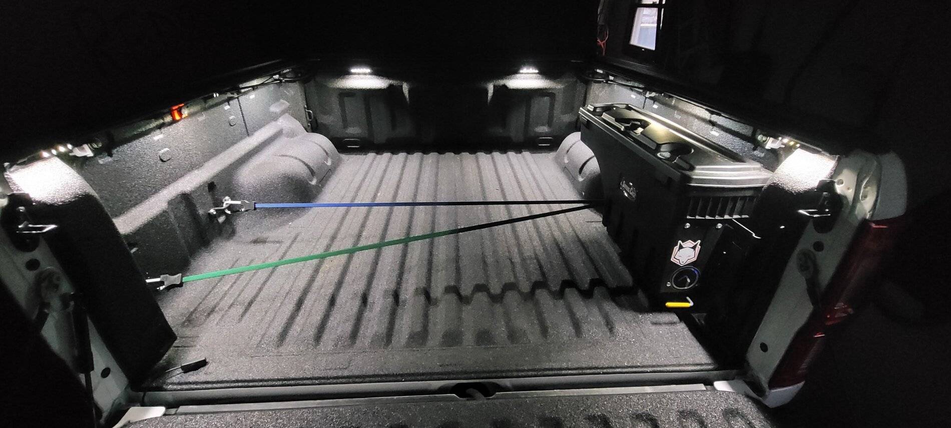

I finally got my grill lights, light bar, and bed lights installed. The bed lights are a huge improvement, especially with the bed cover closed. As you can see, the garage was very dark.
Edit: Grill lights came with a connector to tap into the side marker light, I wired the light bar up to the 10A upfitter switch, and the bed lights are wired into the Wolfhaus pigtail
