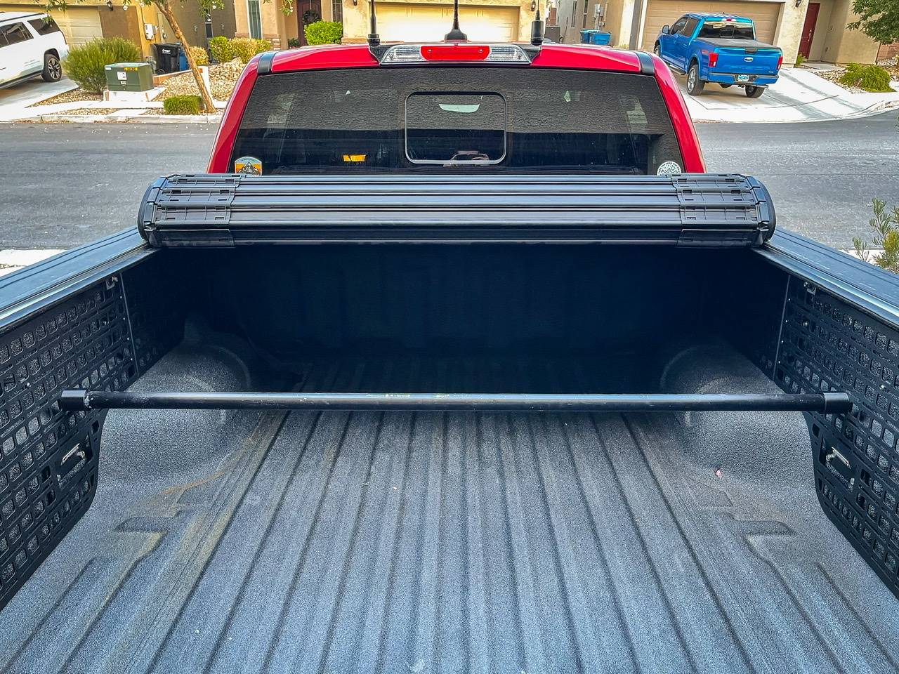

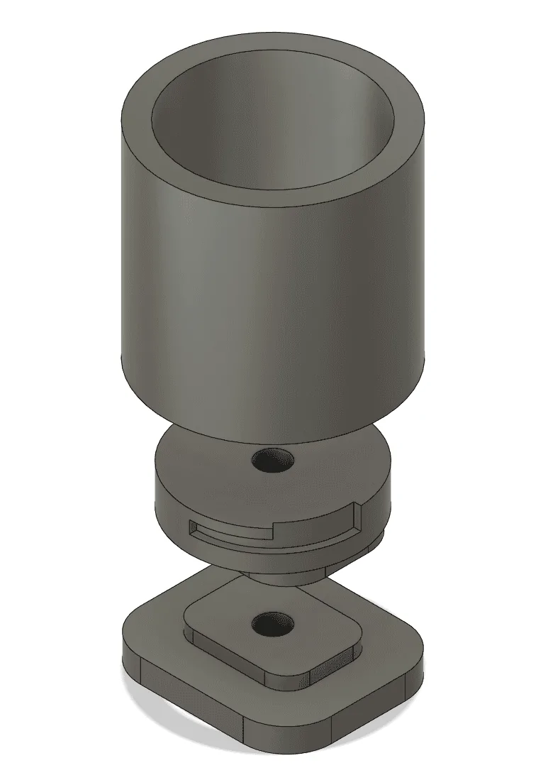

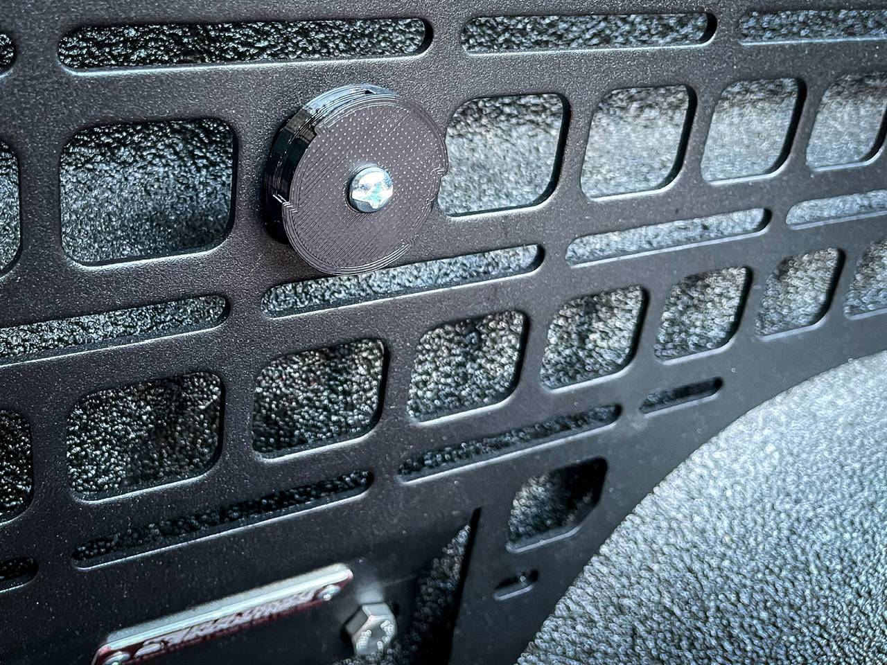

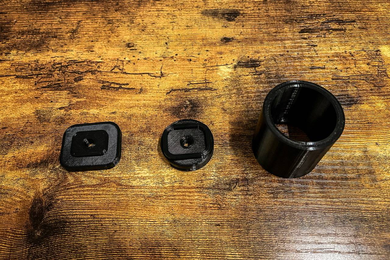

Alright, I had a nice custom bed divider but then I bought the Builtright bed panels, and there’s lots of reasons as to why they don’t work together. But bed dividers are still useful, especially with a bed cover. So, what to do?
Well, I designed another one!
This is a 3 piece design that clamps into any of the holes in the panel, which means you can put it anywhere! All you need is a 10-24 screw, no shorter than 3/4” and a hex nut to hold the two base pieces together, and then the ring will just rotate-lock in place. Low profile and quick release!
Time will tell how well it works. I’d like another on the bottom, but it’s pretty tight, and I think I’d have to remove the panel to get it to fit.

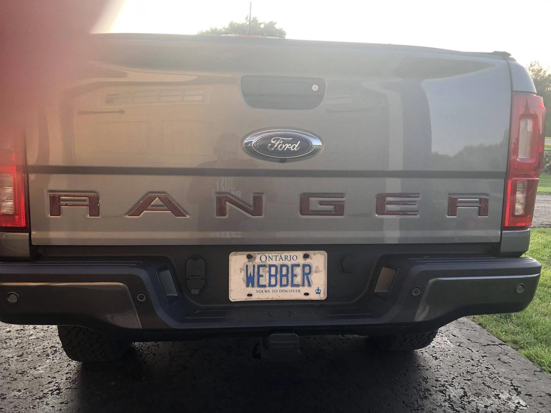

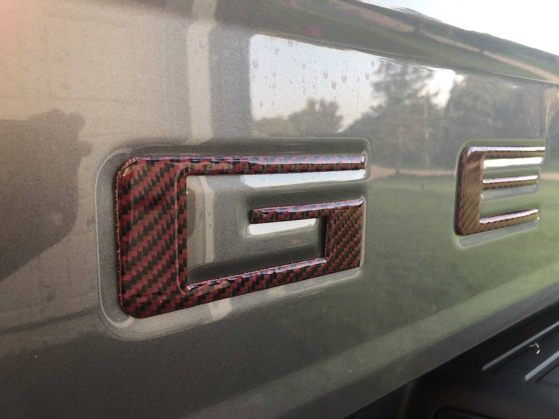

I ordered my tailgate letters in carbon, but they sent me the wrong ones, they sent red carbon by accident, I put them on with tape to see what they look like and I quite like them I think they are staying on

Looks great!
