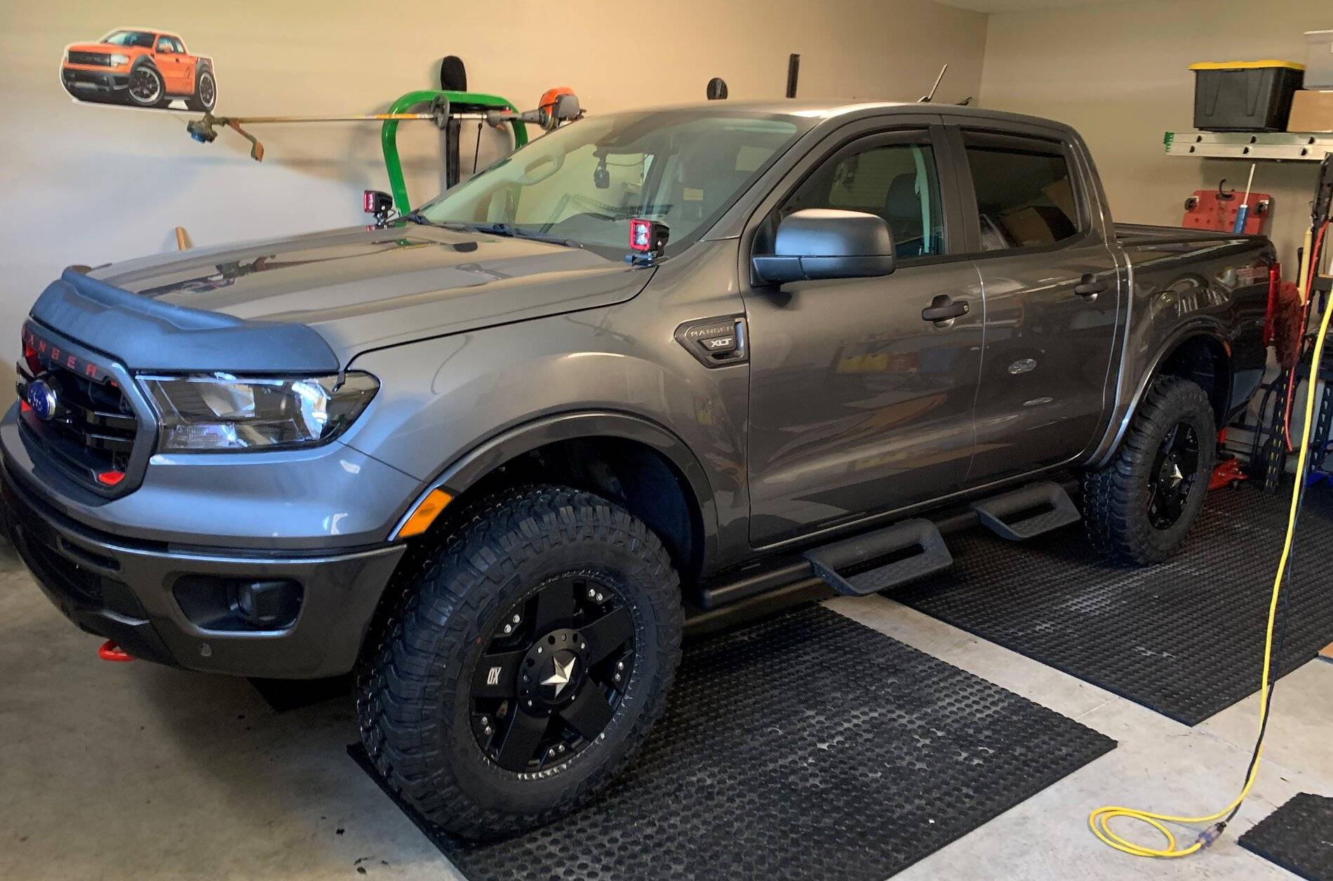

I put some ditch lights on. Wiring them is a job for another day.
These come with 6 different color trims. I may switch to black. They are cheap ($70) Tractor Supply lights but a guy I know has 6 on his Tractor/Mower and gave them good recommendations for his rough use.
They have connectors out of the lights about 5 inches long and another two that connect to the lights. I have to use my own wire for the rest.

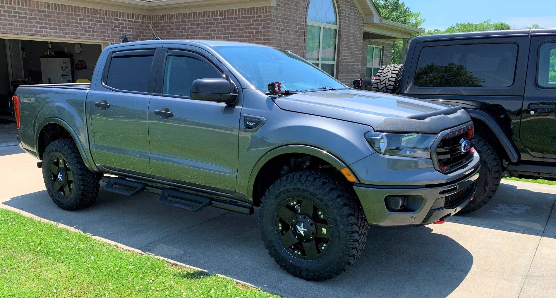

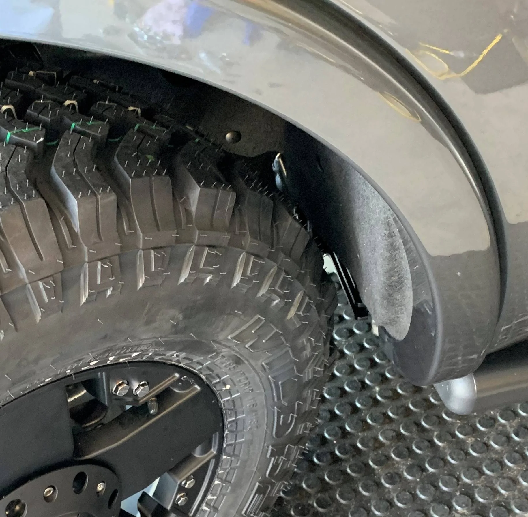

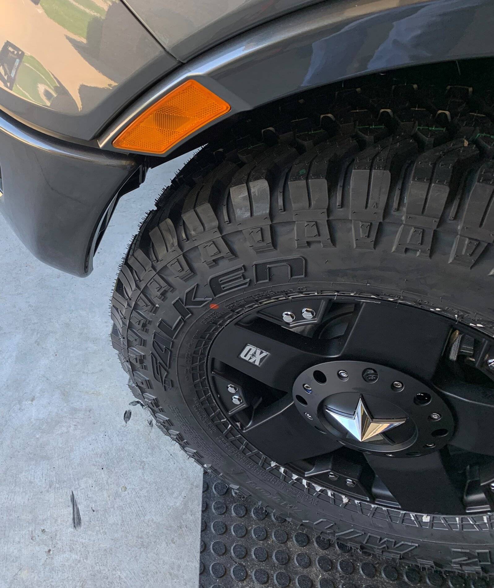

I installed my 17x8 Rockstar wheels (35mm offset) and my 285/70/17 Wildpeak MT tires today. No rubbing with 1/2 inch lift and Ready Lift intrusion bars. They are about an inch from the knuckle.
The only thing I was disappointed in is the fact the wheels are drilled to fit two bolt patterns.

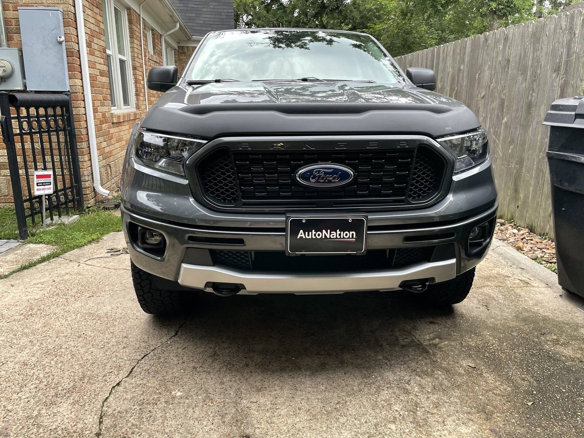

Were you able to get your bug deflector 1/16th of an inch above the hood line? I just installed mine and it is 1/16th” at the front but hangs over 1/16th on the side. I still like how it looks but just curious if you were able to since the instructions stated 1/16th above the hood line.

I’ll have to check tomorrow but I think it is close to that and does not hang over on the side.

@Ranger2021 thanks for the close ups. Mine definitely hangs down lower on the edges. However the 3m tape isn’t showing so I’m not going to worry about it. I bet it would be a headache to pull it off and retape it.
