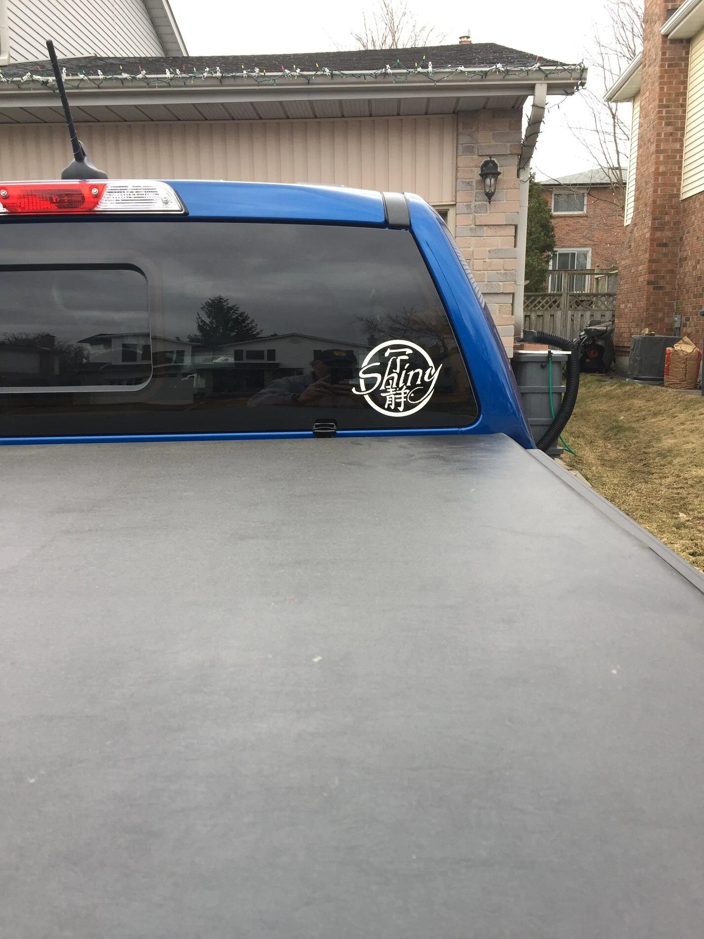

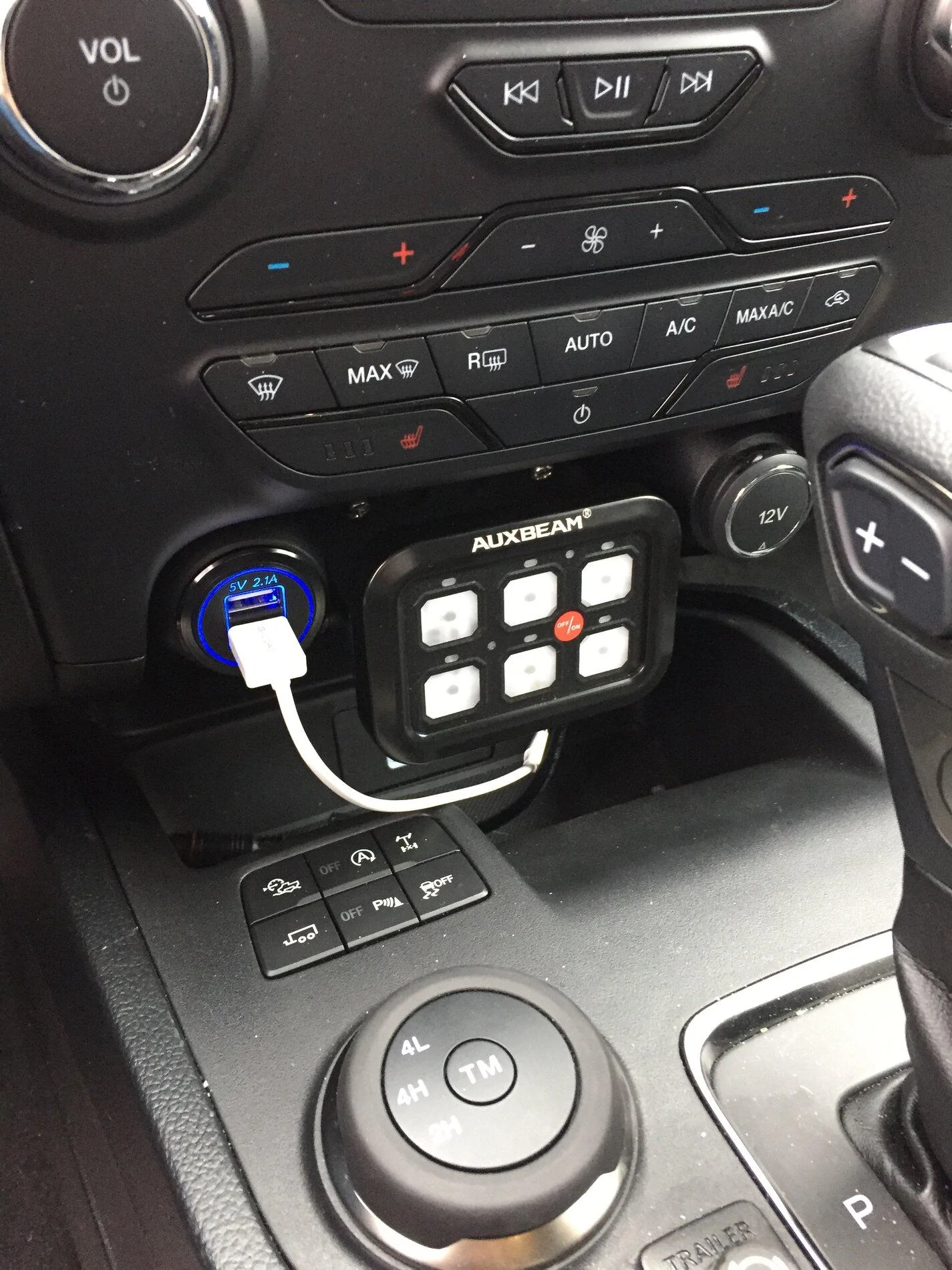

Hardwired in the Yi Dashcam and added my first window decal...those who know know.
Replaced the 12 v outlet to USB outlet and install the Auxbeam 6 Gang. I still am waiting for my grommet tool before I can install the rest of the Auxbeam. I tried for over an hour to thread it through and then decided my mental health was worth $20. This Auxbeam panel is blue lite to blend with all the rest of this stuff.

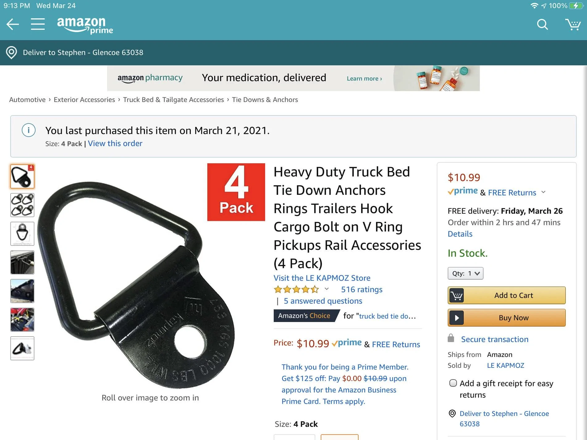

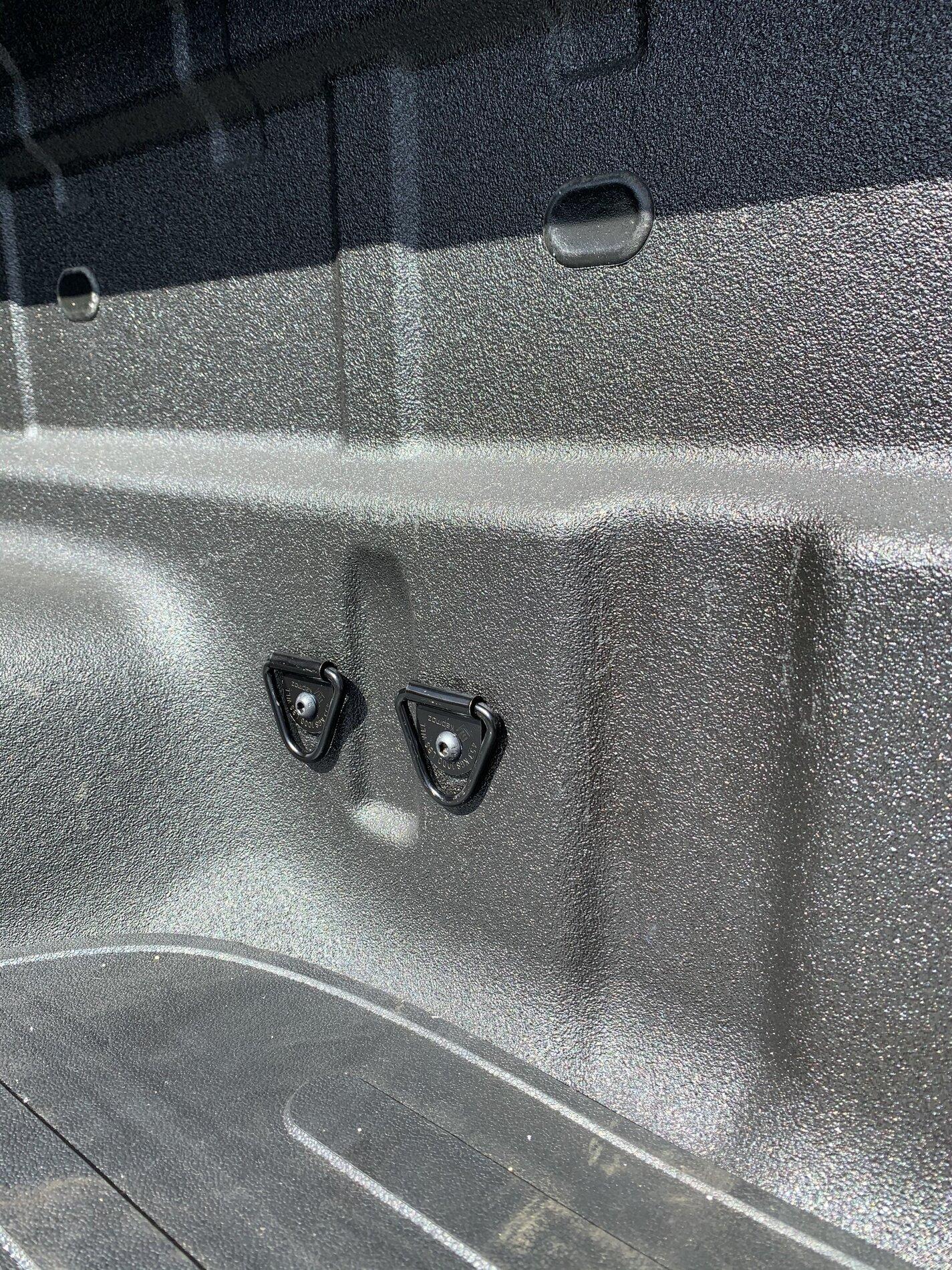

Installed four bed tie-downs. Bought tie-downs from Amazon ($10.99), a DeWalt M8x1.25 tap from Home Depot ($8.97), and four M8x1.25 20mm hex cap screws from Ace Hardware ($3.71). Much less $ than Ford parts.
Was the tap just to clean out the liner?
Yes, I held the tap with an adjustable end wrench. Turn 1/4 quarter turn, back out, repeat several times until tap turns easily. Removed the tap, put screw through the tie-down, put Loctite on the screw, and attach. Good way to kill 30 minutes on a sunny afternoon.
I'm sure I can find something similar, but happen to have an Amazon link for the tie downs?

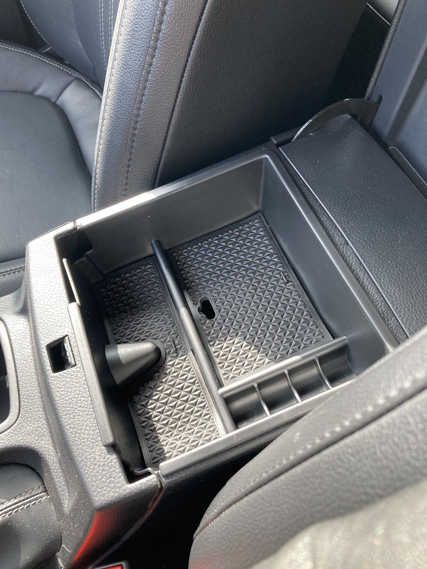

And the console organizer
not sure why something like this isn’t a stock piece to be honest ..
Nice!!! Where did you pick that beauty up? The console organizer? I could really use one!!!
