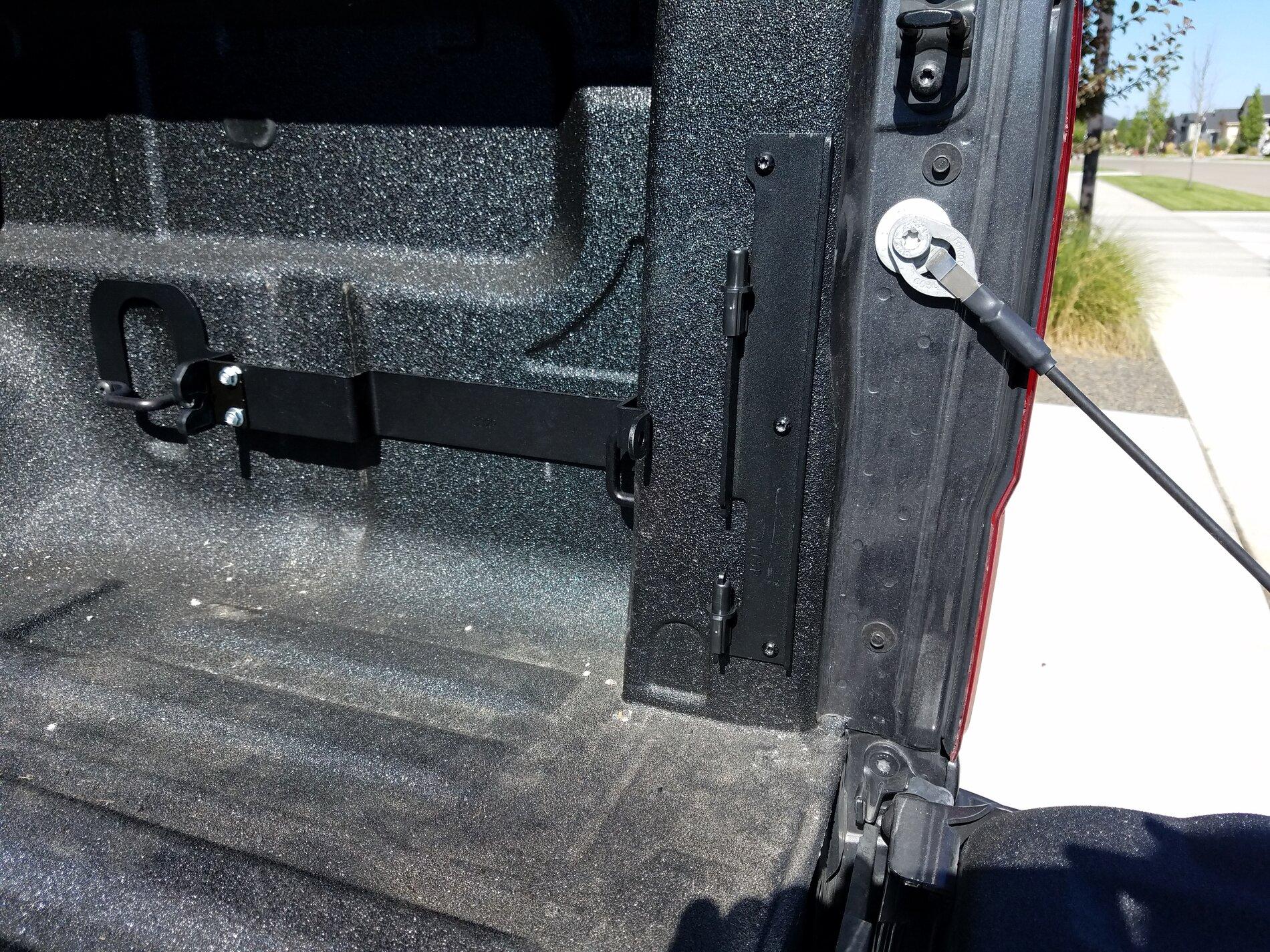

Is that box easily removable?
Do you need to remove the tie downs near the tailgate and in the middle?
Less than 5 minutes to install all the brackets then the box just slides onto the bracket. You can lock it on, just lift off to remove. You unscrew the side and rear tie downs and one bracket screws into the holes with tie downs back in place.

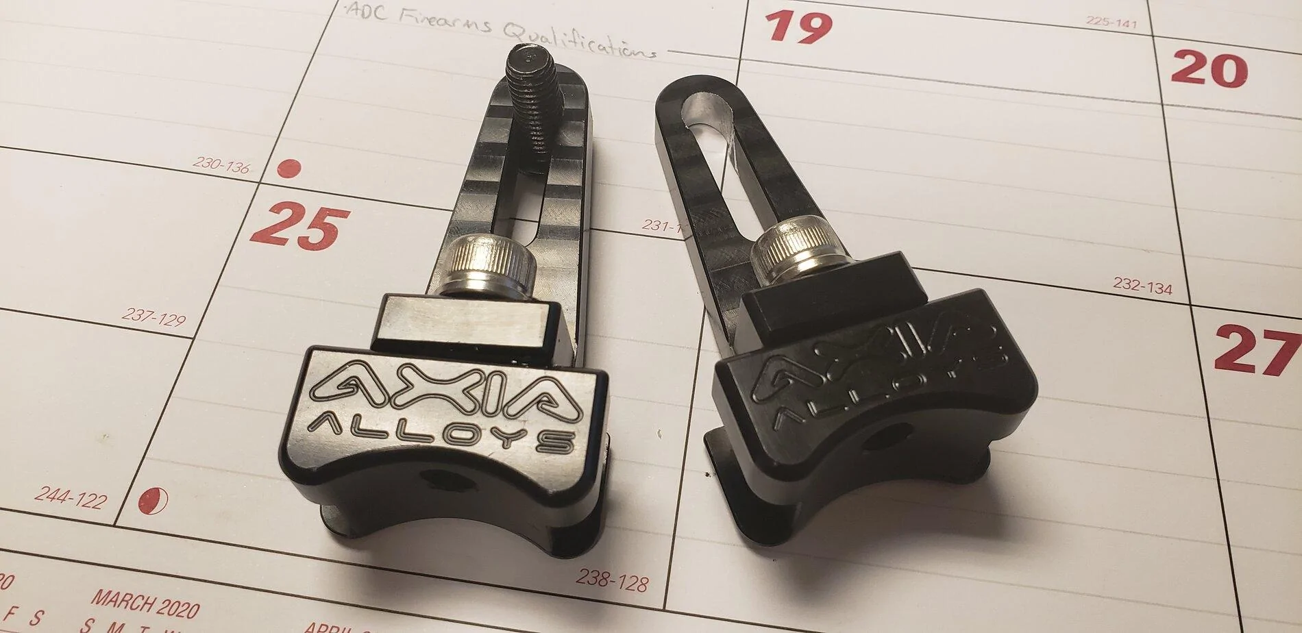

I went to install my 12", 10800 lumen light bar on my ARB bumper last night and I found the bull-bar brackets I got had too small of an opening to run the bolt through to secure to the side of the light bar! This morning I stopped by our Fleet Services building and the guys helped me out by opening up the end of the hole so I can bolt the light to the bracket.

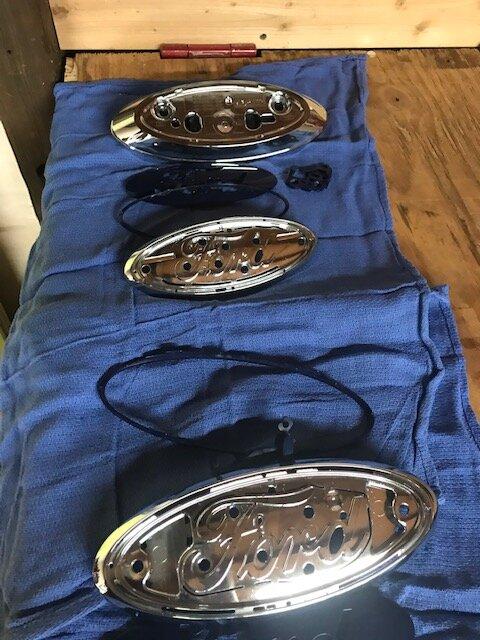

Pulled apart my emblems last night for paint. Last of the chrome and shiny stuff for me (no offense, chrome guys). Going to replace the chrome with a matte black I think. Considered leaving the stock blue alone, but I might go brighter to match body color and tow hook color better. Not too bad of a process all in all. I was able to work my arm into the intercooler hole on the front to get that badge off. Luckily, my arms aren't that big. Thanks deezee tailgate dampener for keeping my arms small!! :muscle::wink:

I've been procrastinating the rear emblem for some time. The front was not bad because I replaced my XLT grill with a Lariat and painted it at the same time, plus I had a built-in spare. You are shaming me into pulling the rear off now. I'll be without that emblem for at least a couple days I guess, and hope not to break off any tabs! Thanks a lot Jake 2.3 :(

Just get a small screwdriver in the slot on the bottom. I used plastic trim tools to pull it straight out. One of the clips did come off the post, but I easily pushed it back on. I was going to just spray the whole thing black, but I decided to drill it apart and paint it differently for more contrast. Not a bad process so far. Although, I don't have it back together yet either ha.

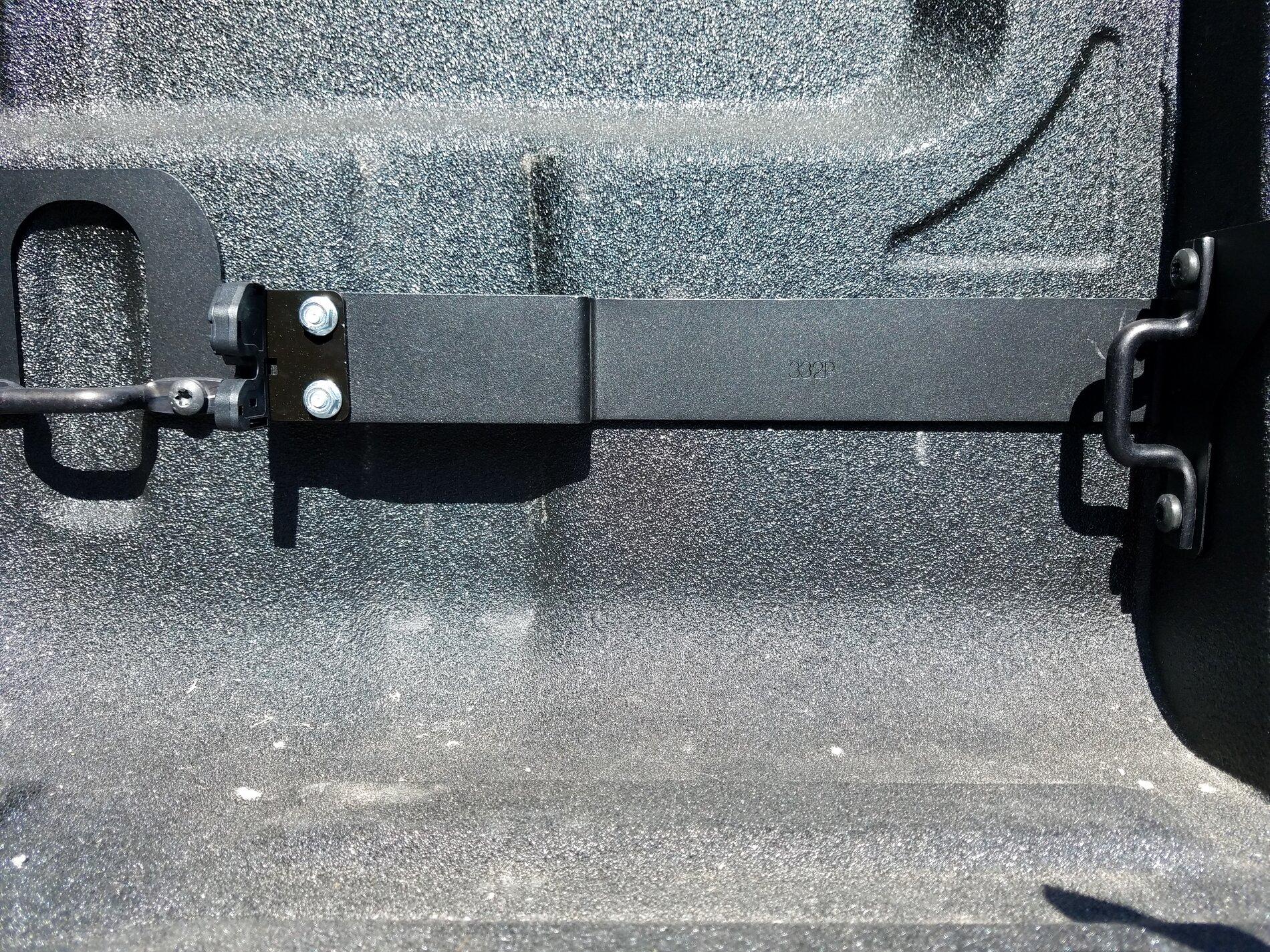

Sorry, been pre-occupied. Here are the bracket pictures. Tie down brackets use T40 torx and the bracket near tailgate uses T27

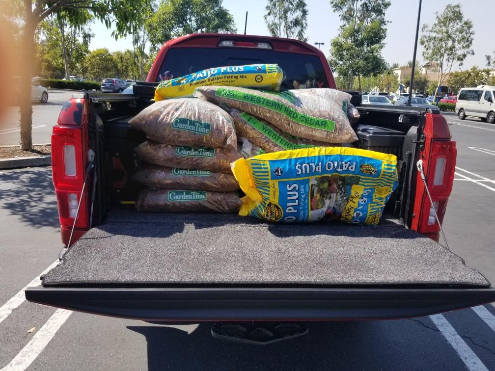

A light LOWES haul...it only filled about 2/3 of bed, and the tailgate did close:
11 bags of mulch
2 bags dirt
1 bag of lava rocks
1 15 gallon terracotta pot
