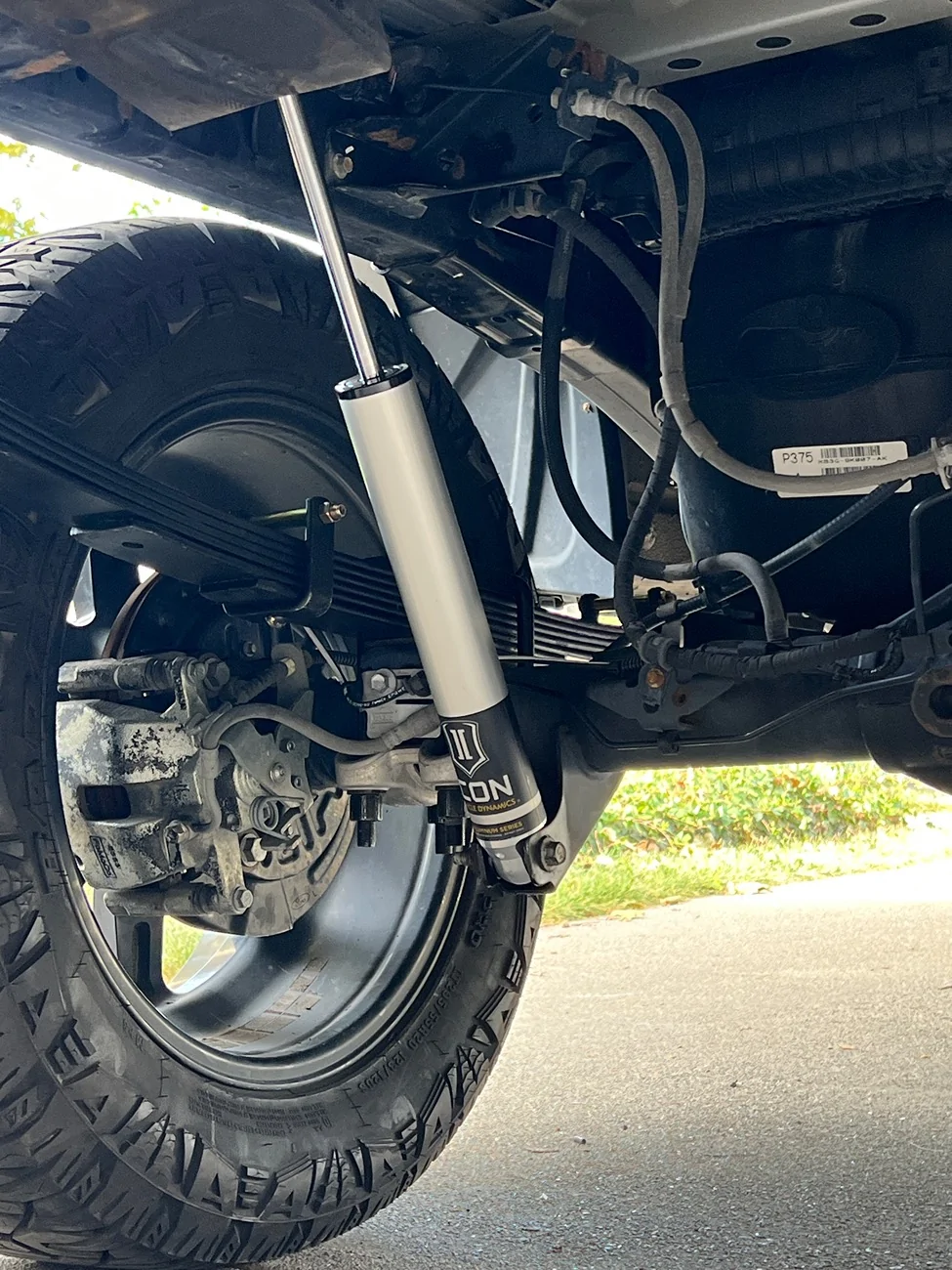

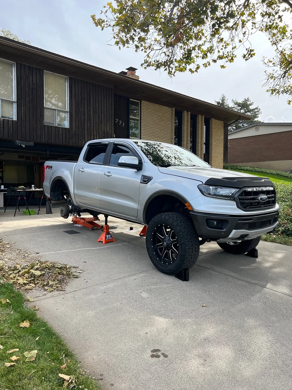

Driver's side front eye bushing on the rear leaf spring was beginning to fail, so decided to upgrade both leaf springs, and replace the rear shock assemblies and bump stops while I was down there. Went with ICON's multi-rate leaf pack, 2.0 VS shocks and bump stop kit. The OE mono leafs had a 1.5" block underneath it (not my choice, I bought this '19 model used 5 years ago) and since I drive on LT295 55R20's where my tires are already ~33 inch diameter, I wanted to maintain my rear lift and so went with Option 1 for the leaf configuration

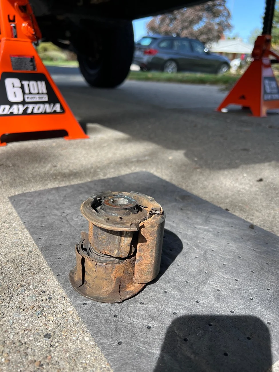

This is how the driver's side front eye looked before the install -- the eye was ovaled and rubber visible and flaking off. I think it's obvious that the 1.5" block under the mono-leaf gives it more lateral pressure than it can safely handle over a long period of time, and so I went with the ICON multi-rate leaf pack so that I could maintain my current lift, but also get rid of the block and prevent this type of failure again:
Once I took the weight off the rear axle, the bushing and eye just essentially crumbled. Yes -- not safe at all. I had new tires put on just a few weeks ago, so that whole assembly must have hit its breaking point since then. I'm very glad to catch this and fix it before experiencing failure while driving. I also replaced the bolt and nut securing it in case it was compromised
By far the most difficult part of the install was the removal of the old hardware. I thought I could get this entire job done in 3 hours, but actually ended up taking 12 hours non stop. The old bolts in the shock assemblies and U-Bolts were extremely difficult to loosen and remove. That and just the general caution of working on a vehicle with jack stands leads you to take your time and not go to town on stuck hardware.

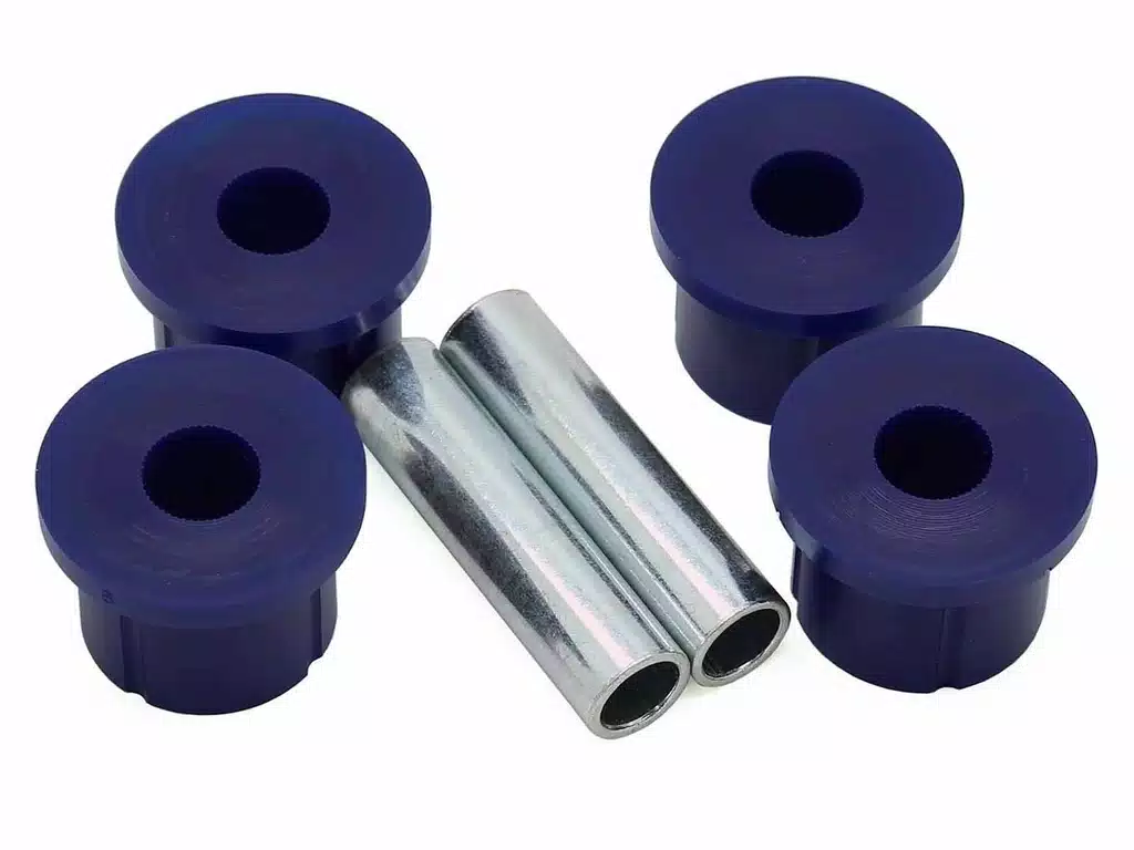

Since the ICON leaf springs come with a new forward eye bushing but not the rear (they assume you'll reuse the OE rubber bushings) and since the rubber in the forward eye on my old spring was crumbling, I thought I'd take the opportunity to put new polyurethane rear bushings from SuperPro in to have a safer, longer-lasting ride
I'm really happy with how the install eventually turned out -- it looks great and it feels great. Such a massive improvement in handling these bumpy Utah roads. Pictured below before I installed the bump stops.
