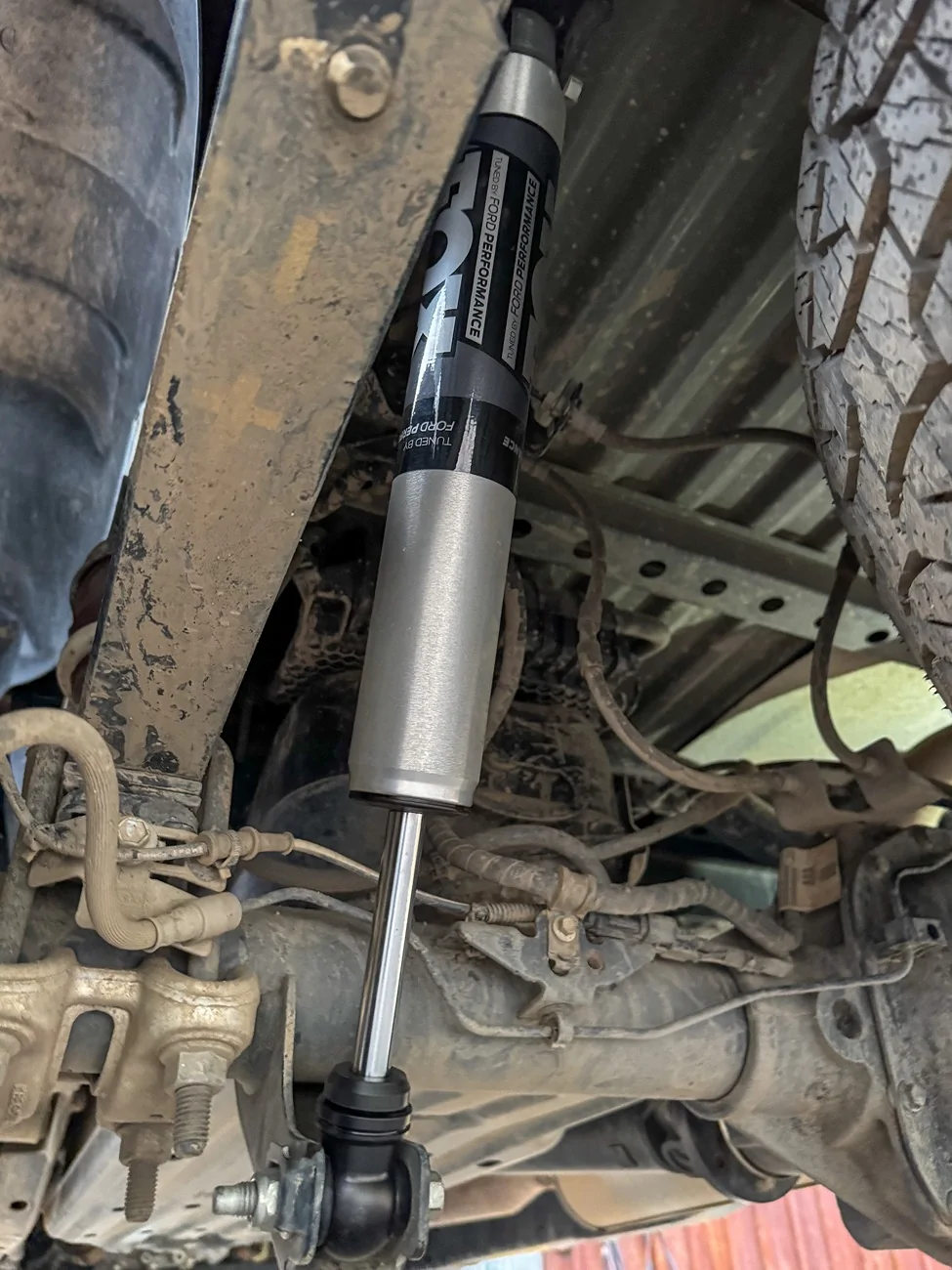

Driver's side front eye bushing on the rear leaf spring was beginning to fail, so decided to upgrade both leaf springs, and replace the rear shock assemblies and bump stops while I was down there. Went with ICON's multi-rate leaf pack, 2.0 VS shocks and bump stop kit. The OE mono leafs had a 1.5" block underneath it (not my choice, I bought this '19 model used 5 years ago) and since I drive on LT295 55R20's where my tires are already ~33 inch diameter, I wanted to maintain my rear lift and so went with Option 1 for the leaf configuration

By far the most difficult part of the install was the removal of the old hardware. I thought I could get this entire job done in 3 hours, but actually ended up taking 12 hours non stop. The old bolts in the shock assemblies and U-Bolts were extremely difficult to loosen and remove. That and just the general caution of working on a vehicle with jack stands leads you to take your time and not go to town on stuck hardware.

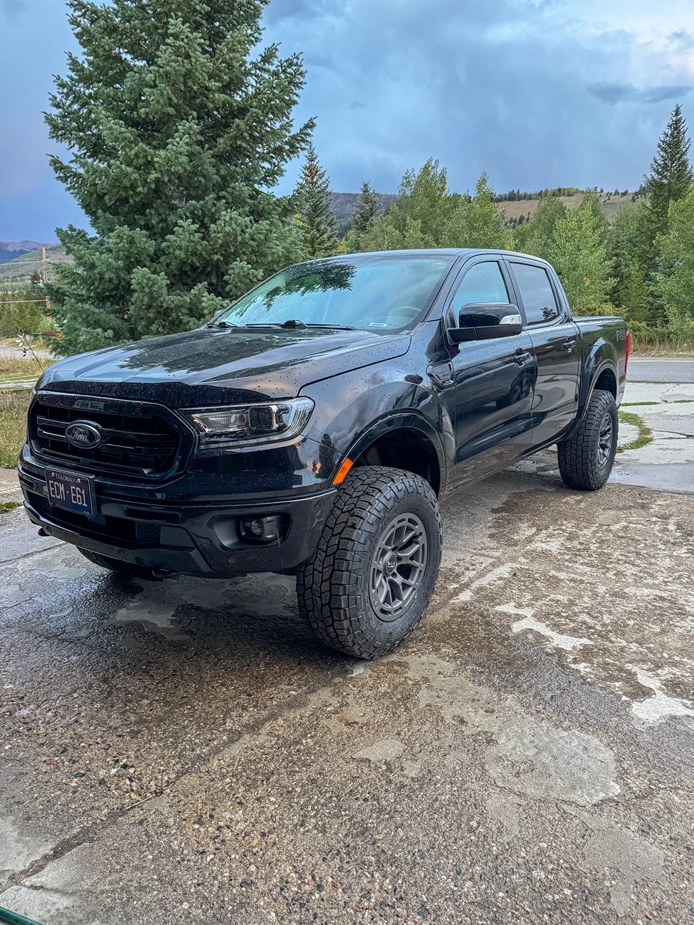

I'm really happy with how the install eventually turned out -- it looks great and it feels great. Such a massive improvement in handling these bumpy Utah roads. Pictured below before I installed the bump stops.
