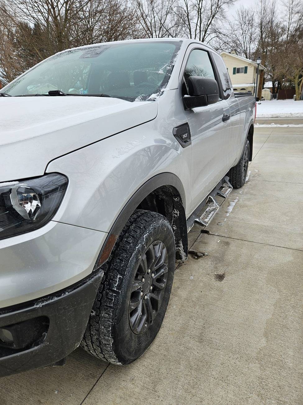

Finally got the tires/wheels installed. Those crash bars are no joke, very hard steel. Took lots of time and about 4 cutoff wheels for the whole job. Ended up leaving 1/2 the rear bar and tire clear without issue. The 33x10.50 tire has just enough poke with the -12 wheel to not look obnoxious.

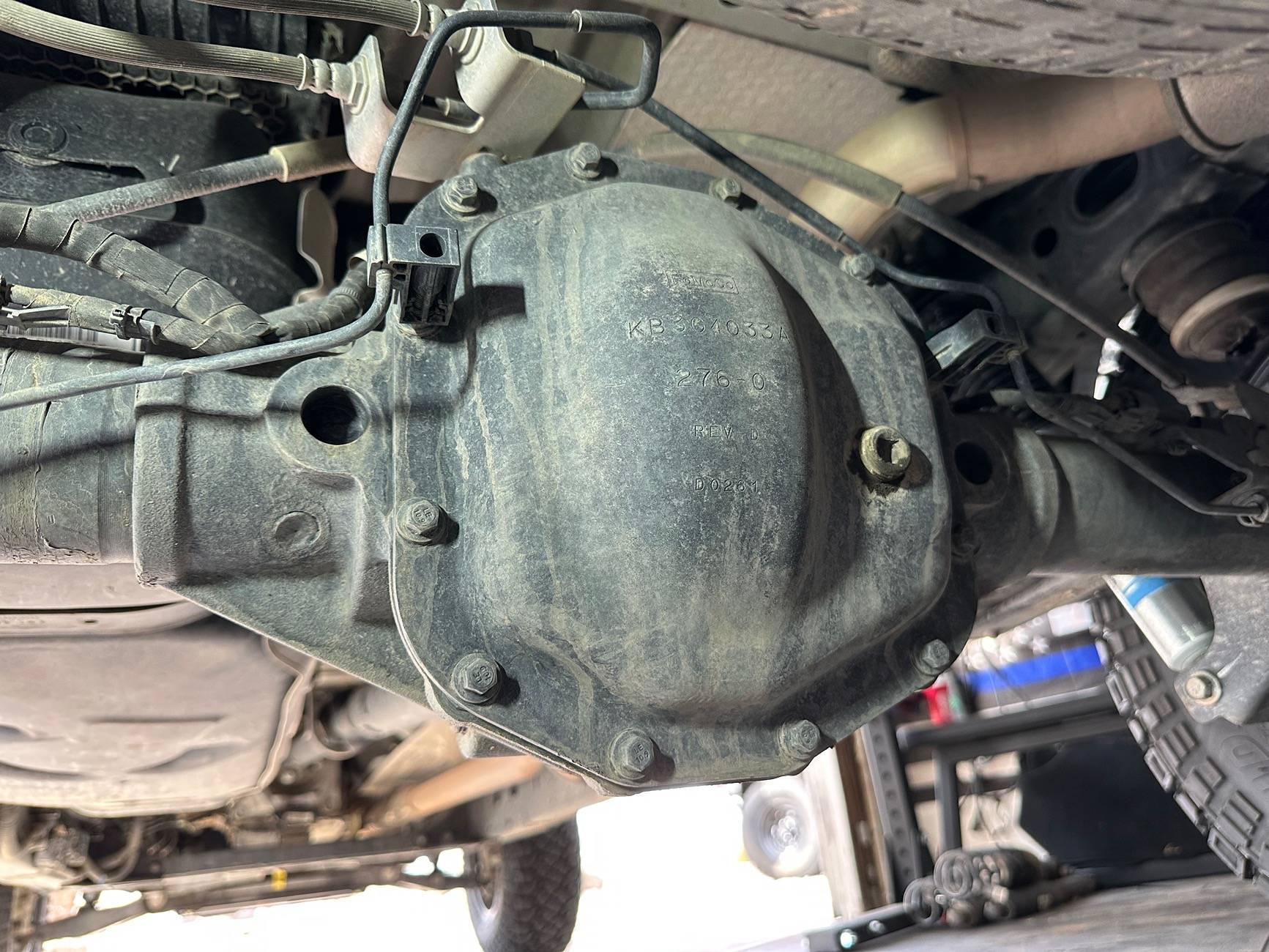

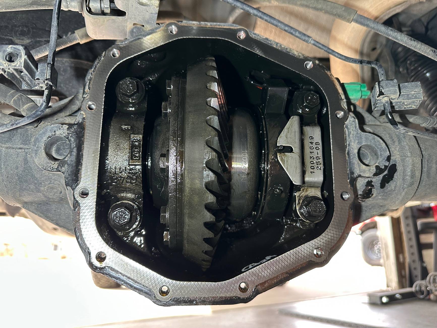

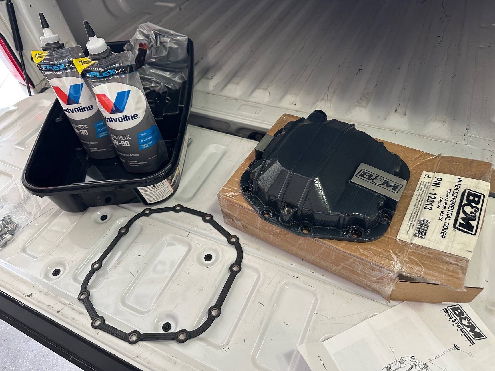

Installed a B&M diff cover today. Got a killer deal on it since the power coat was grey instead of black. Installed a new gasket and 1.5 quarts of valvoline 75w-90. The cover is made for Jeeps but fits our Dana 44 perfectly. Only issue is when using the top fill area, you need to use a 10mm socket to move the hard brake line mounting bracket. Zero drips and zero noise. Rear diff lock engages and works as should. Probably a useless upgrade, but looks cool. ??
