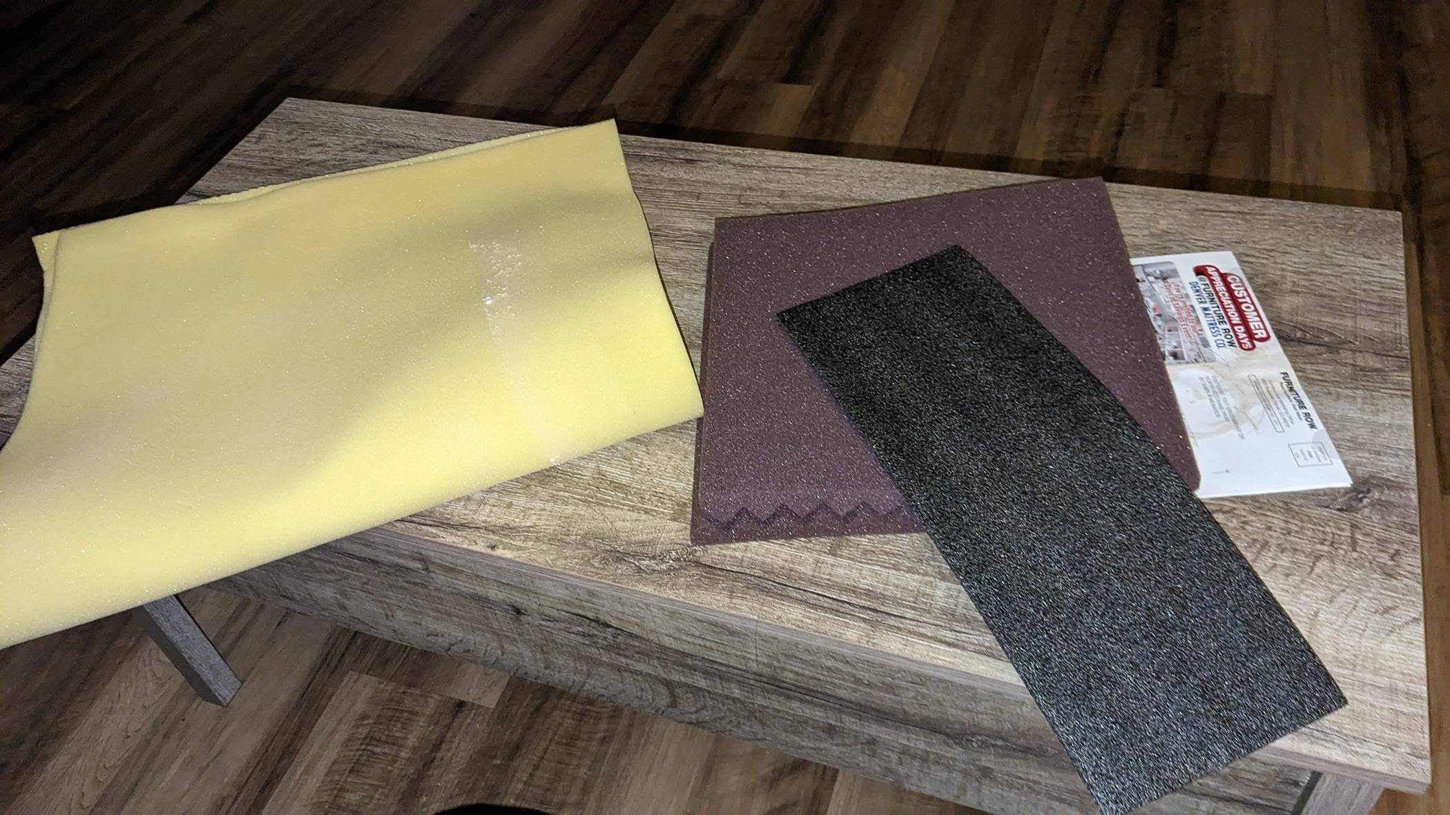

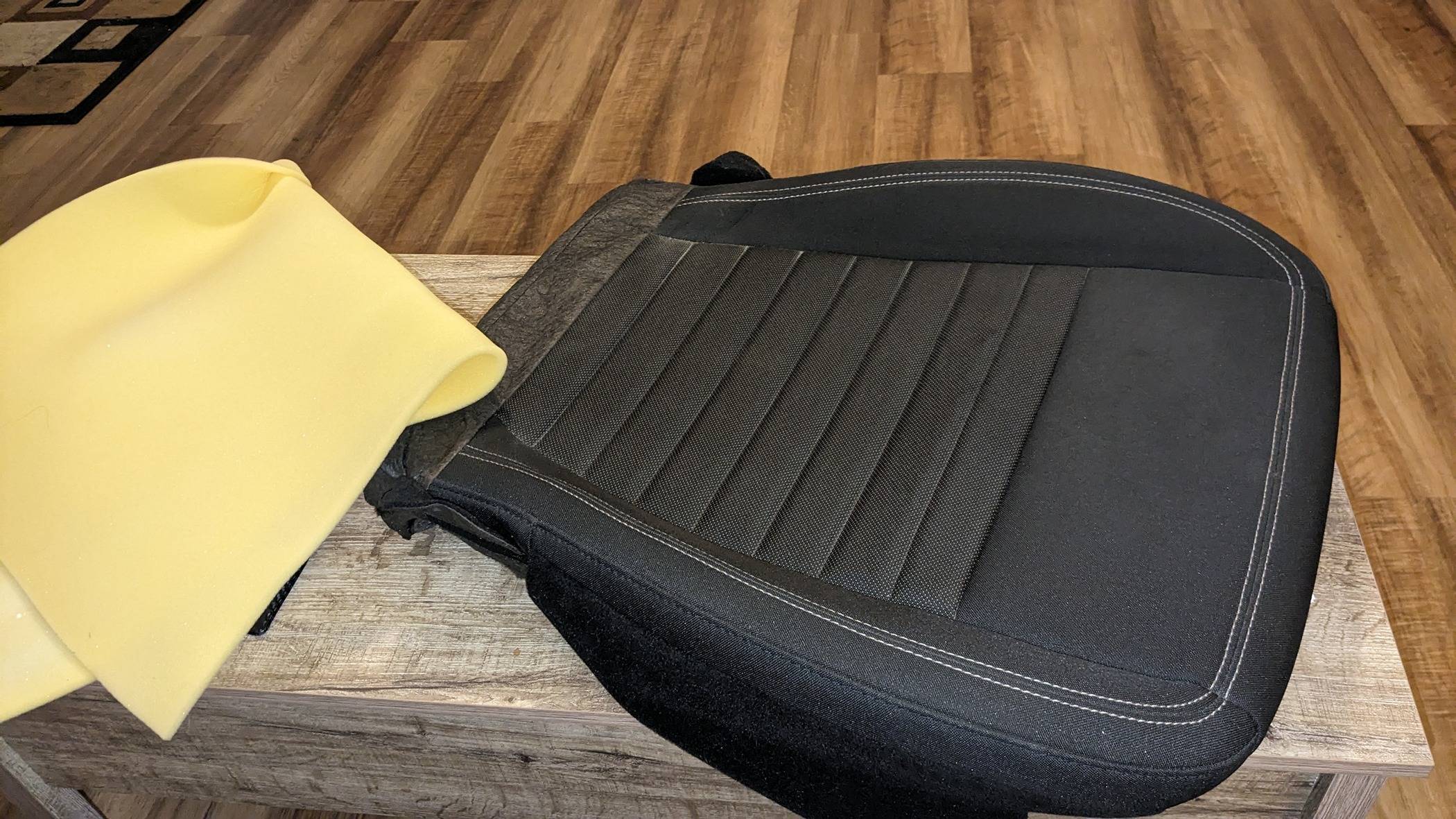

Trying to resolve back pain cause of poor seat construction...
I am still working on mine, to get the (perfect) comfort spot.
Trying various foam thicknesses.
I will note that I have found that if you only focus (cut) the width to cover the rear part of the seat bottom (spring) area it does help in comfort.
Removes (somewhat) that lower back sinking feeling in the seat.
So slowly playing with different options - drive it for a while to see if I can leave it and call it good or do some minor adjustments and try again.
So, I still at (WIP) Work in Progress status

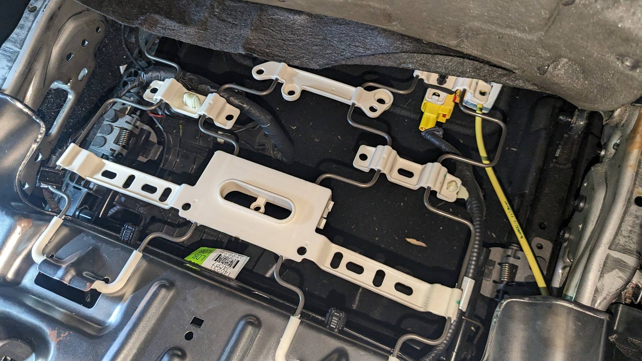

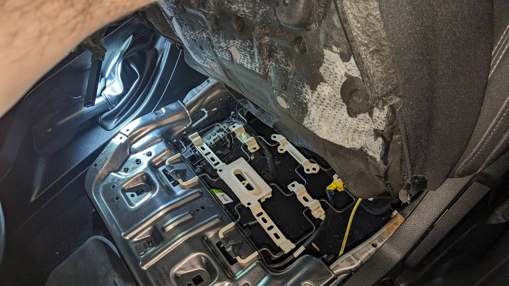

True, but unfortunately for me - the driver's seat is uncomfortable and find it to have a sinking feel in the (butt) part of the seat, I have tried multiple position adjustments to the OEM as well as the Seat Jackers - No Help
So, I resorted to make an attempt to add some cushion (padding) under the seat cushion itself to resolve the issue.
As you cannot go between the Cover & Cushion - Heated Seats, and the cover is secured to the cushion.
The Note pertained to the placement of the added padding, for me anyways I am sensitive enough to feel the difference if the padding is placed all the way back (under the tailbone) or slightly forward under the butt cheeks.
The width of the padding matters as if too wide, you increase the thickness in the section that has the (Seat Pan) - this raises the legs some and increases the tilt of your lower body.
The thickness and density of the padding also factors in, as it creates a sitting on a wooden bench feeling and cuts off circulation in the legs.
Any change made also requires a seat adjustment to get the Gas / Brake pedal foot placement to a comfortable position.
I LOVE the truck and have ZERO complaints except for this issue.
I WILL SUCCEED in getting it dialed in to the OMG feeling - it's just trial and error. I will not let the truck win. :LOL:
