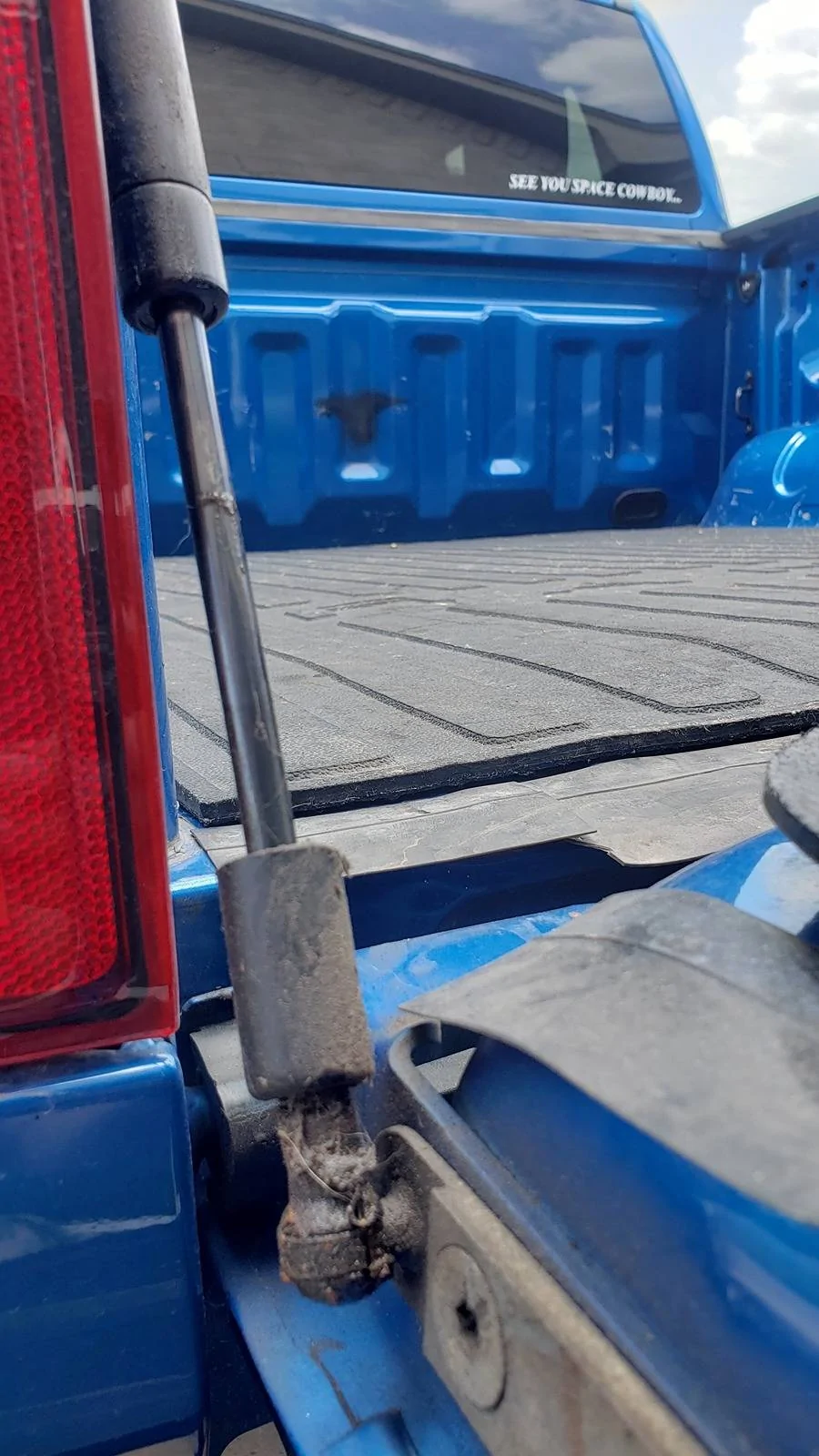

Is it time for a new tailgate strut assist?? Lots of oil collecting on the bottom, it still works. I may be very sad if it just gives out. ? its about 3 years old
I bet if it fails you couldn't open or close your tailgate, weakling.
but your tranny will appreciate it and not fail on you.
