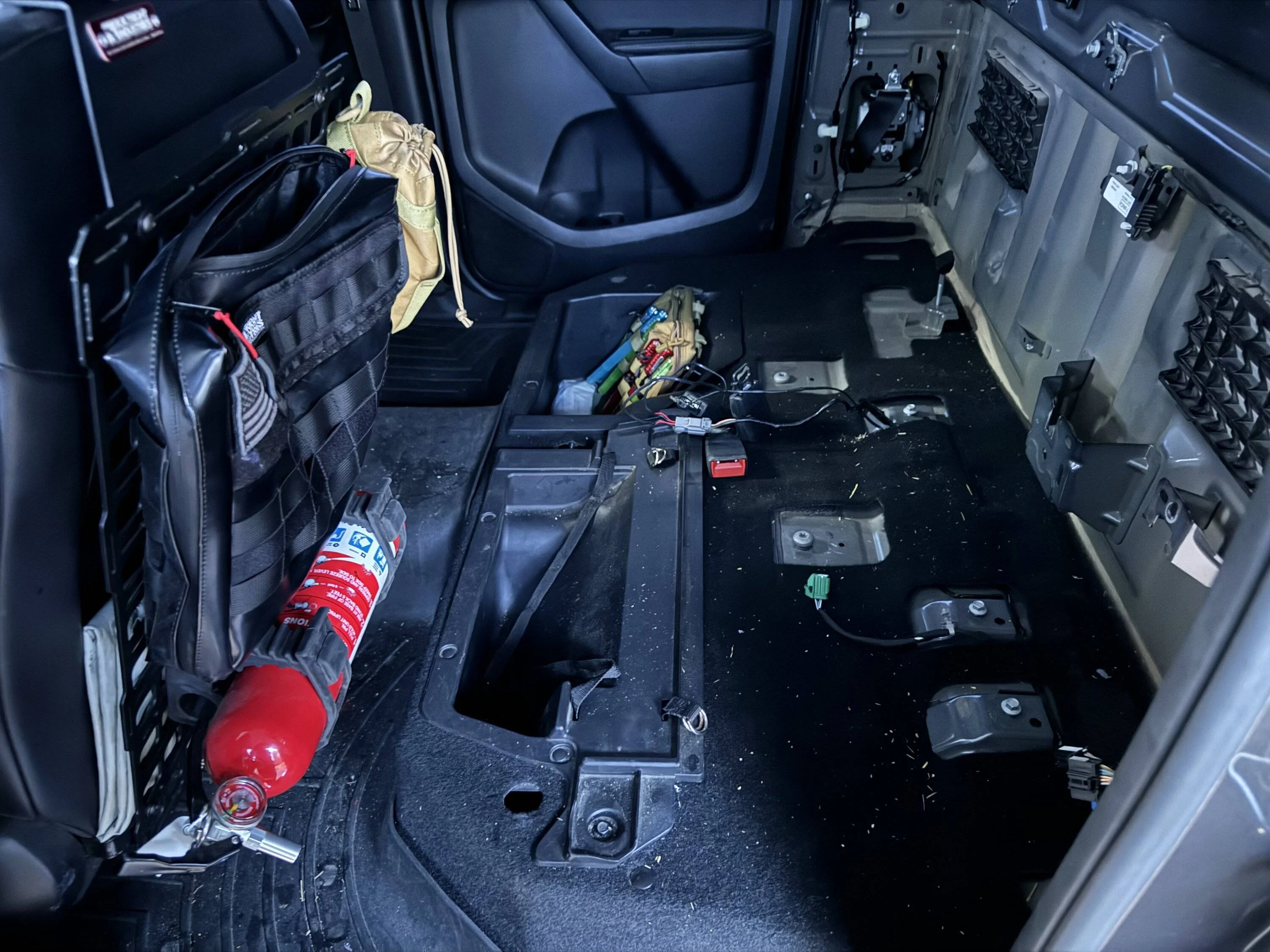

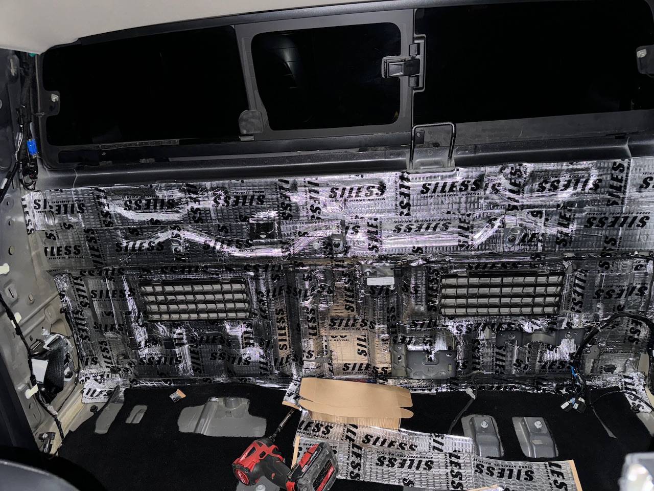

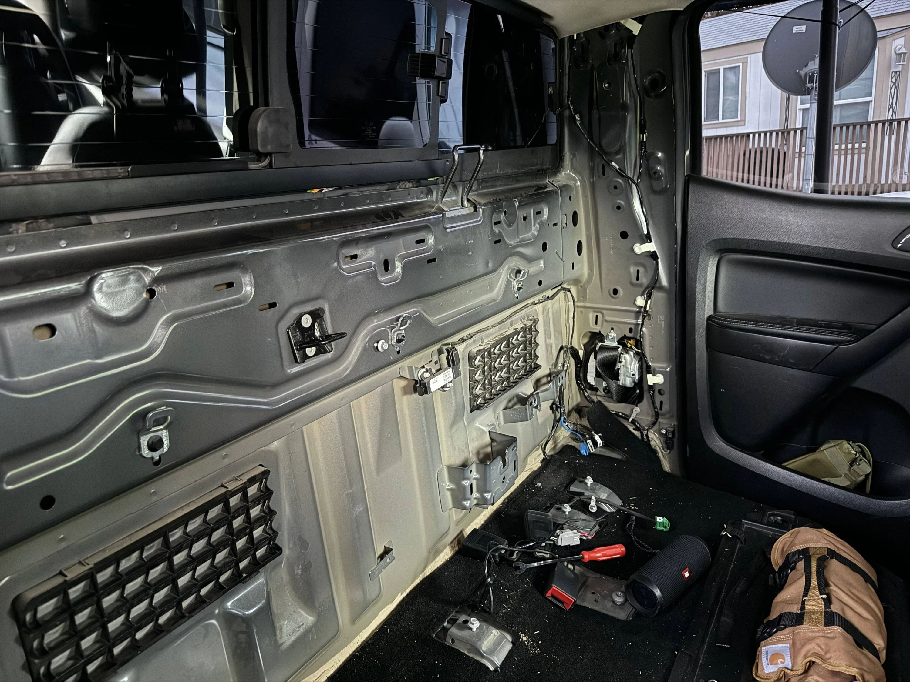

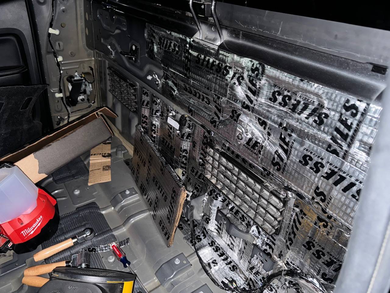

Started sound deadener to back seat area. I plan on doing all areas maybe not 100% coverage like the back. But I will do doors, floor and headliner area. I plan on using closed cell foam on top of this. Took a couple hours to take all the stuff out and a couple more hours to add material. Really time consuming but should be much quieter with back seat removal.

Made a huge difference on mine with the seat delete. I did under the cubbies and all that as well. Still have to do the doors but waiting till I get new speakers also. I also put the material on my bench I made
