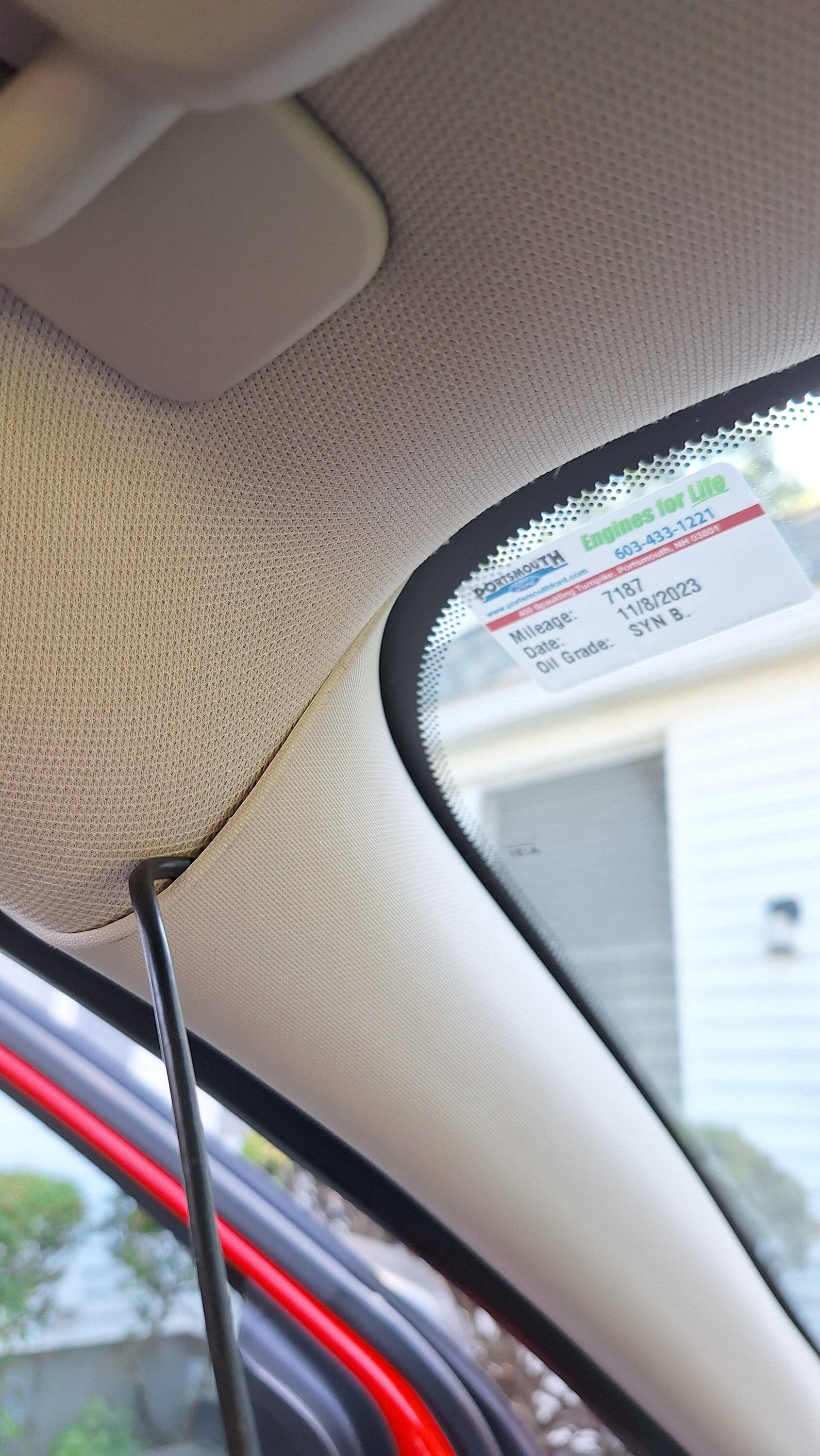

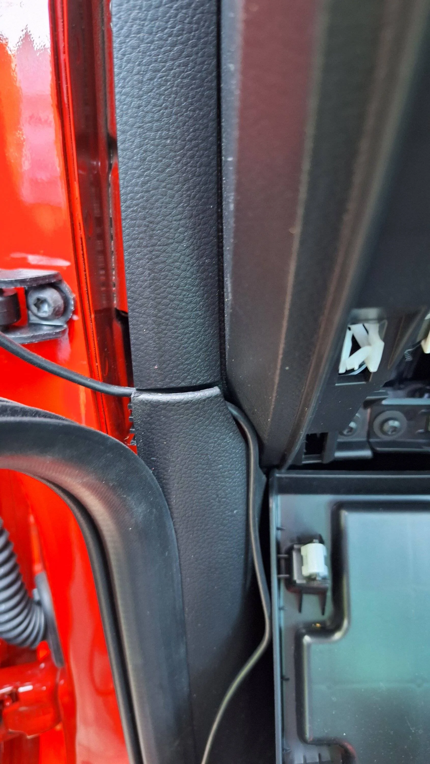

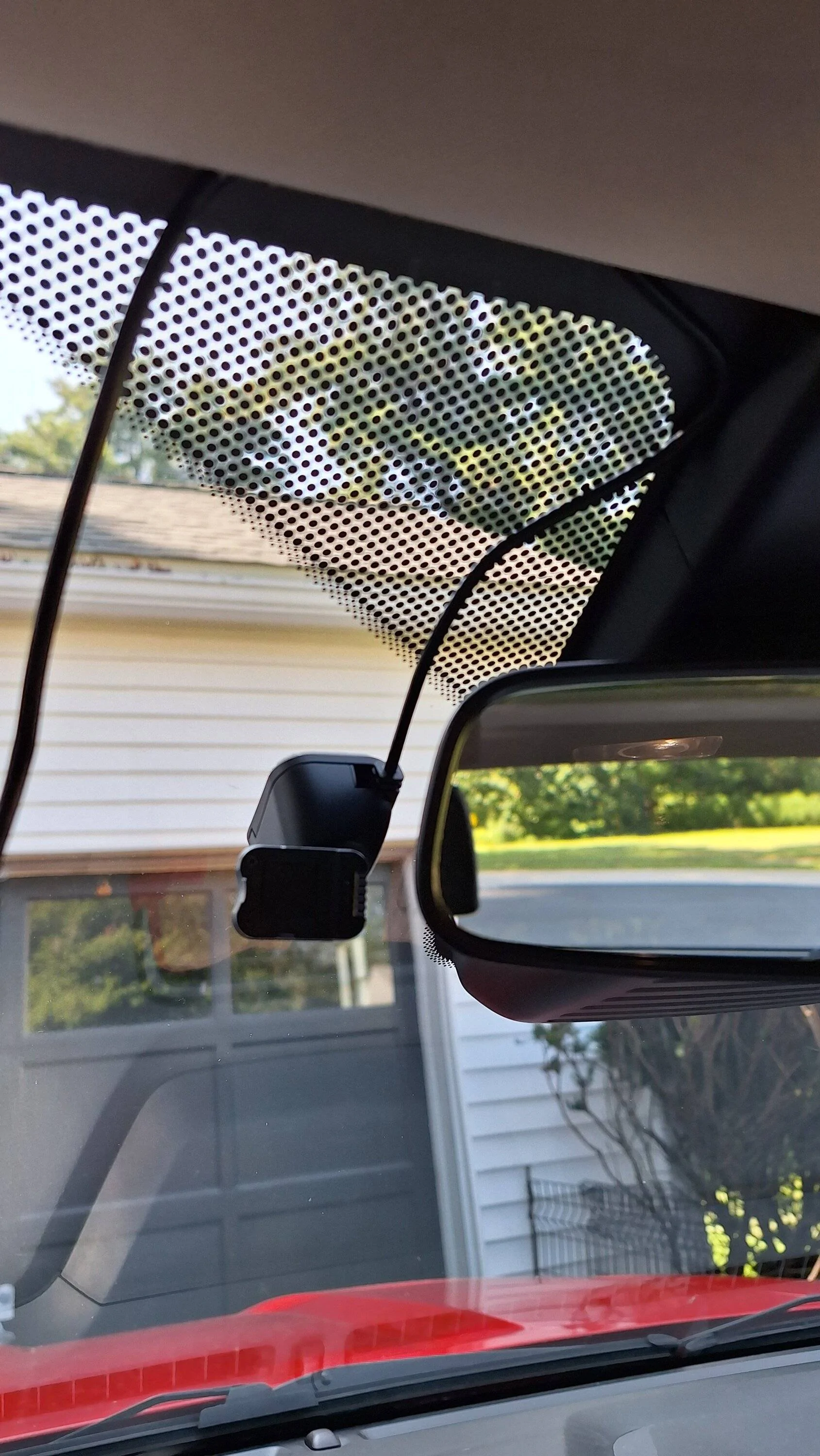

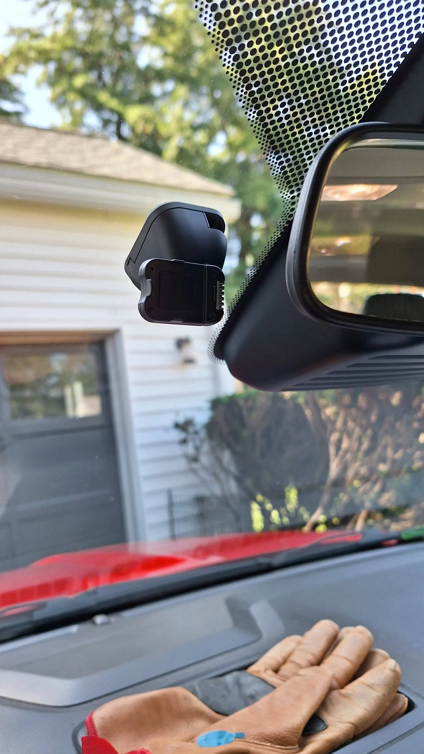

Installed a Nextbase 622GW front and rear dashcam. Hardwired it to an always-on fuse and it all went pretty smoothly.

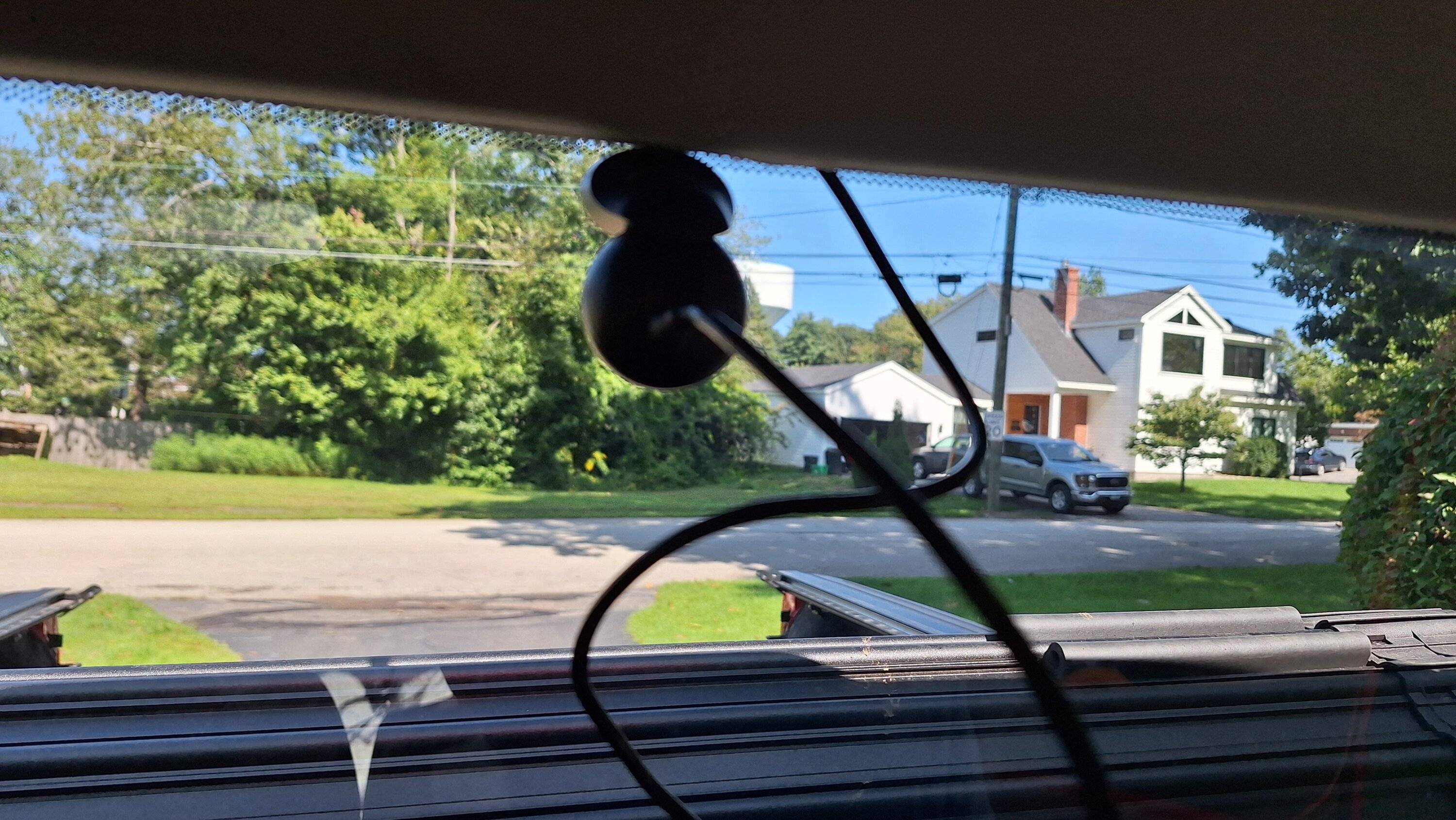

front mount

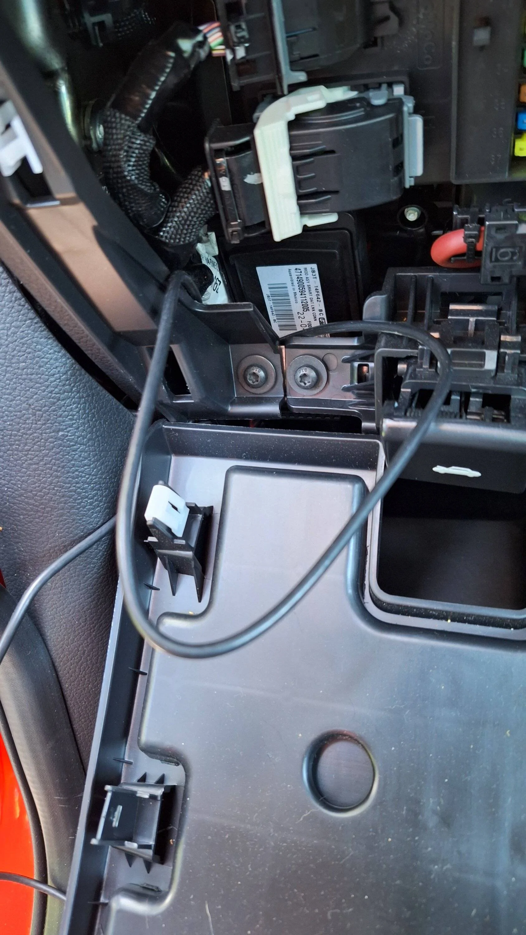

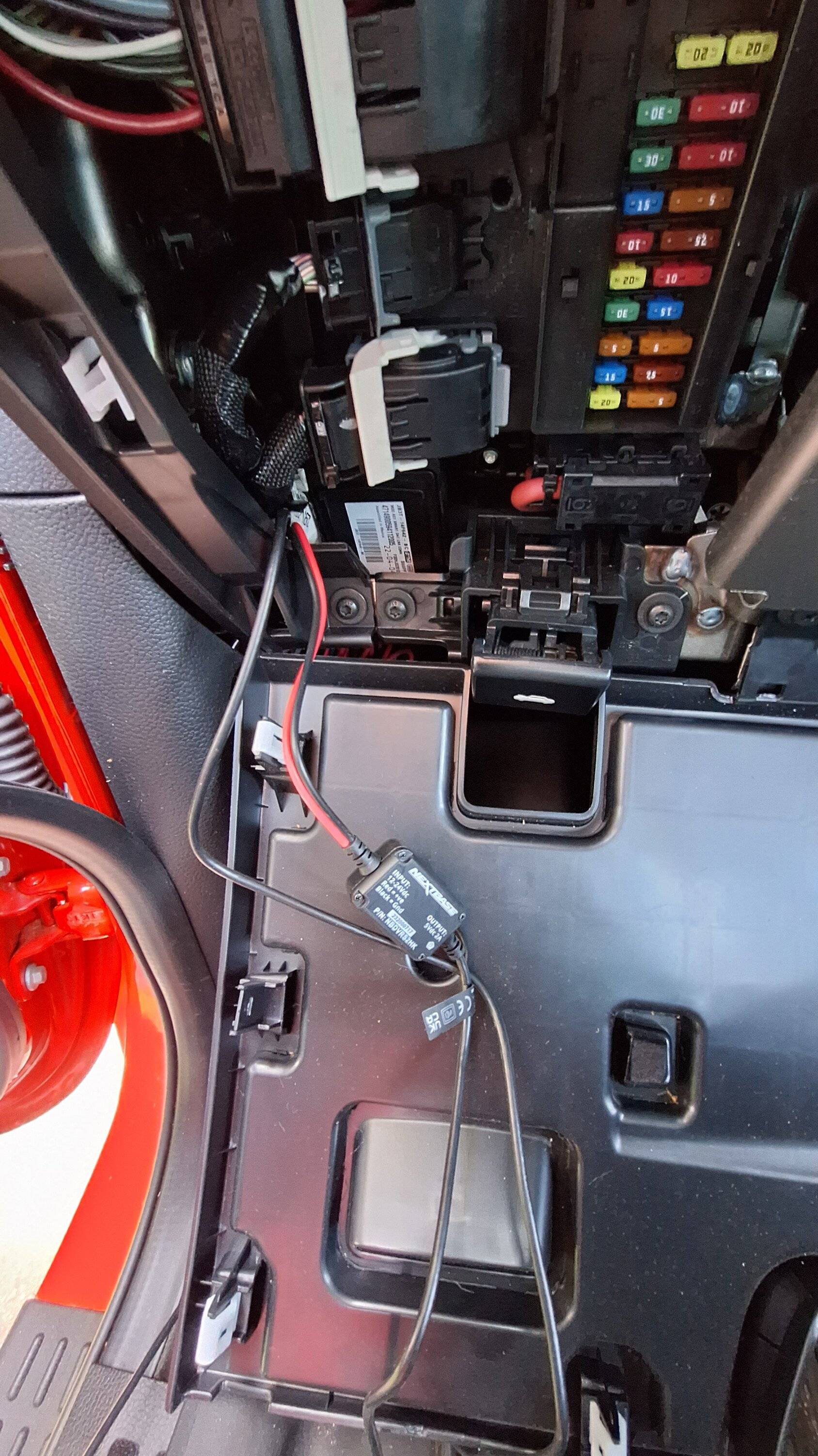

first time looking at fuses
start stringing front cam hardwire
easy to slip it in
did use the small trim tool that came with the cam

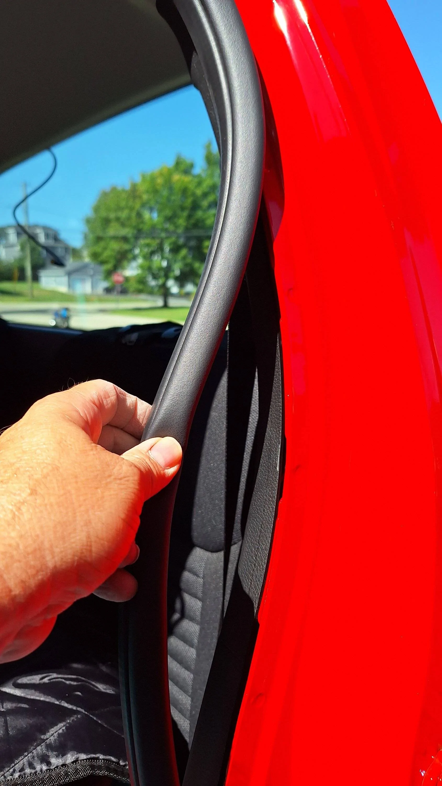

pulled out the weatherstripping, ran the wire between some trim
fished it up from under, lots of places to do this
pulling the tree miles of cabling through

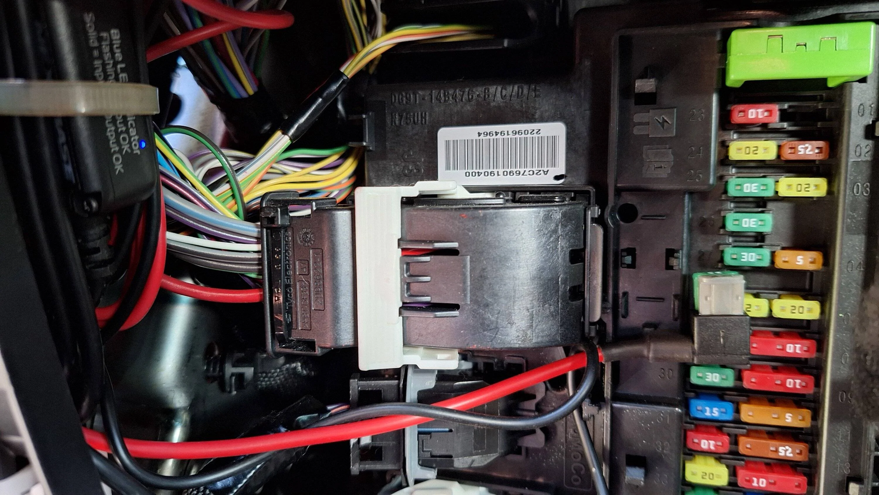

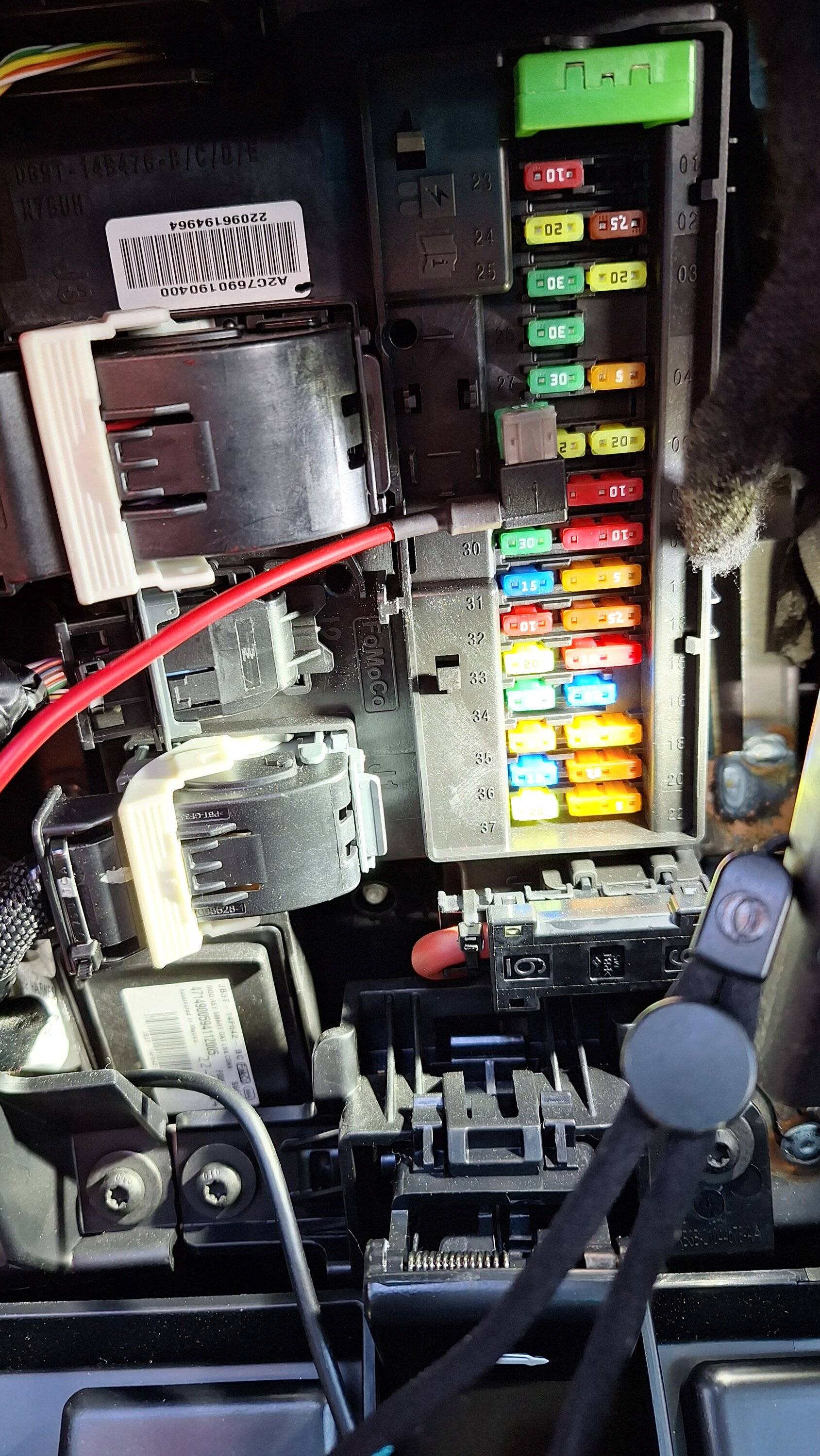

fuse 29 is always on and just what I need
included fuse tap seems to fit pretty well

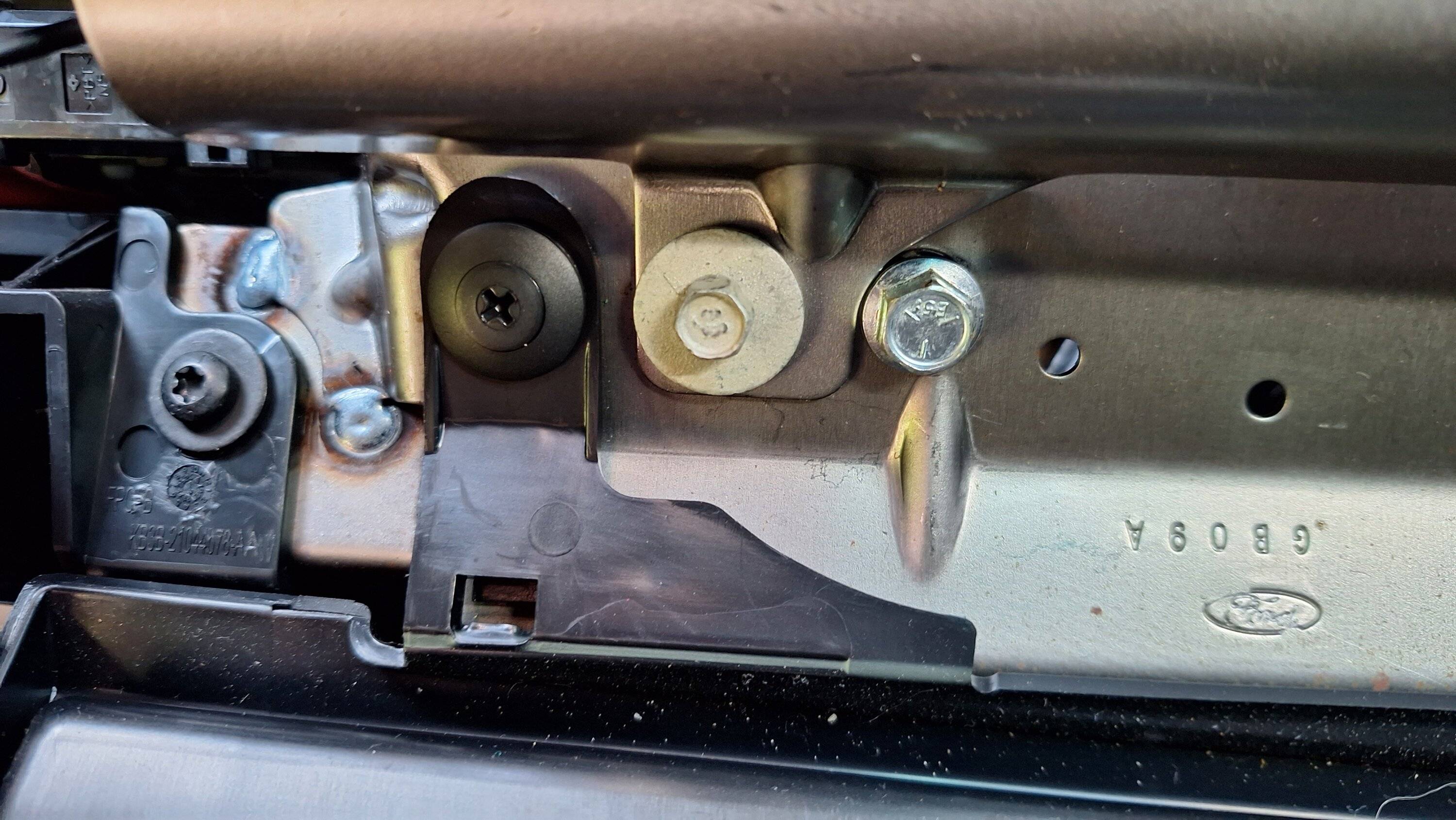

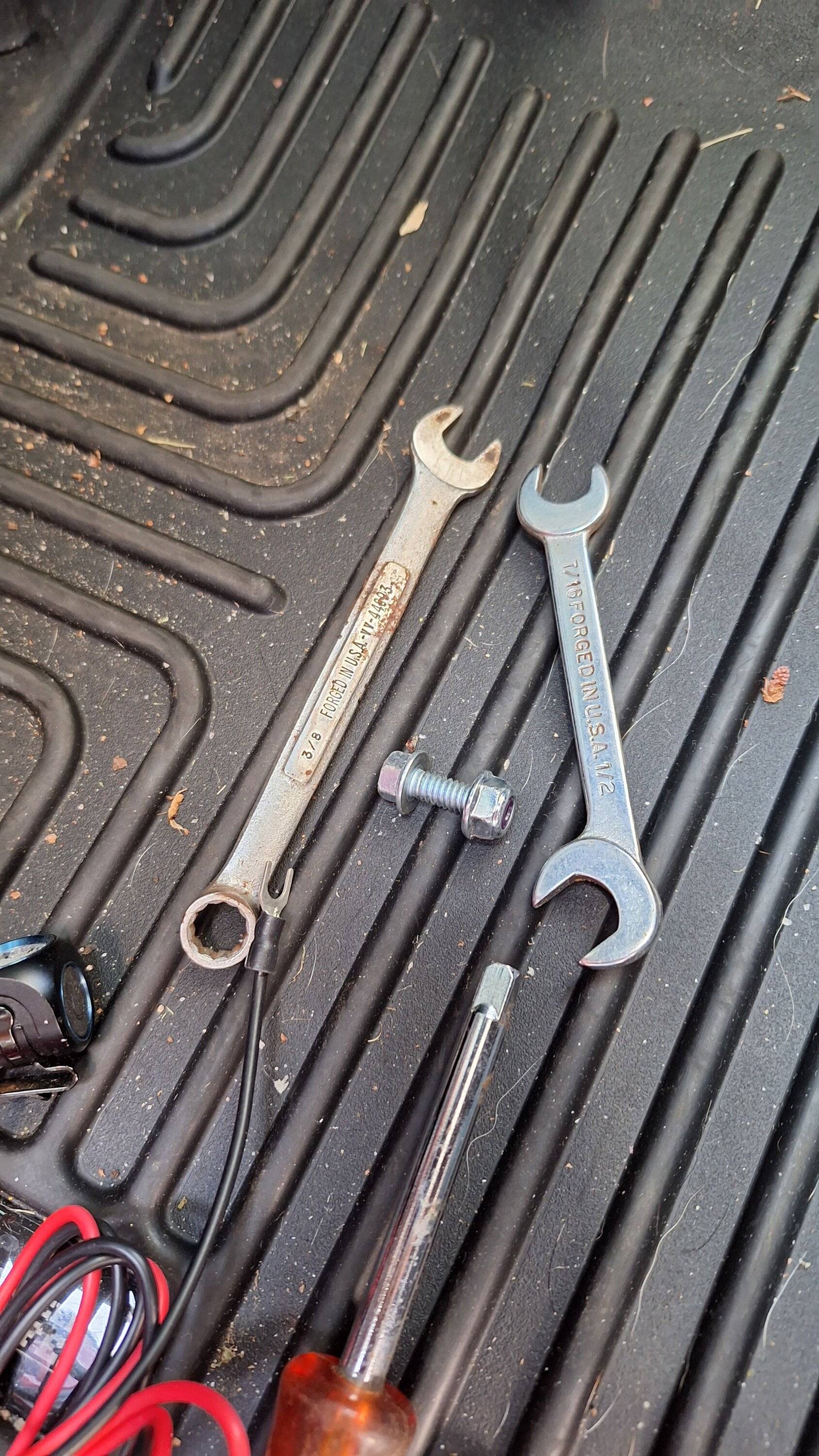

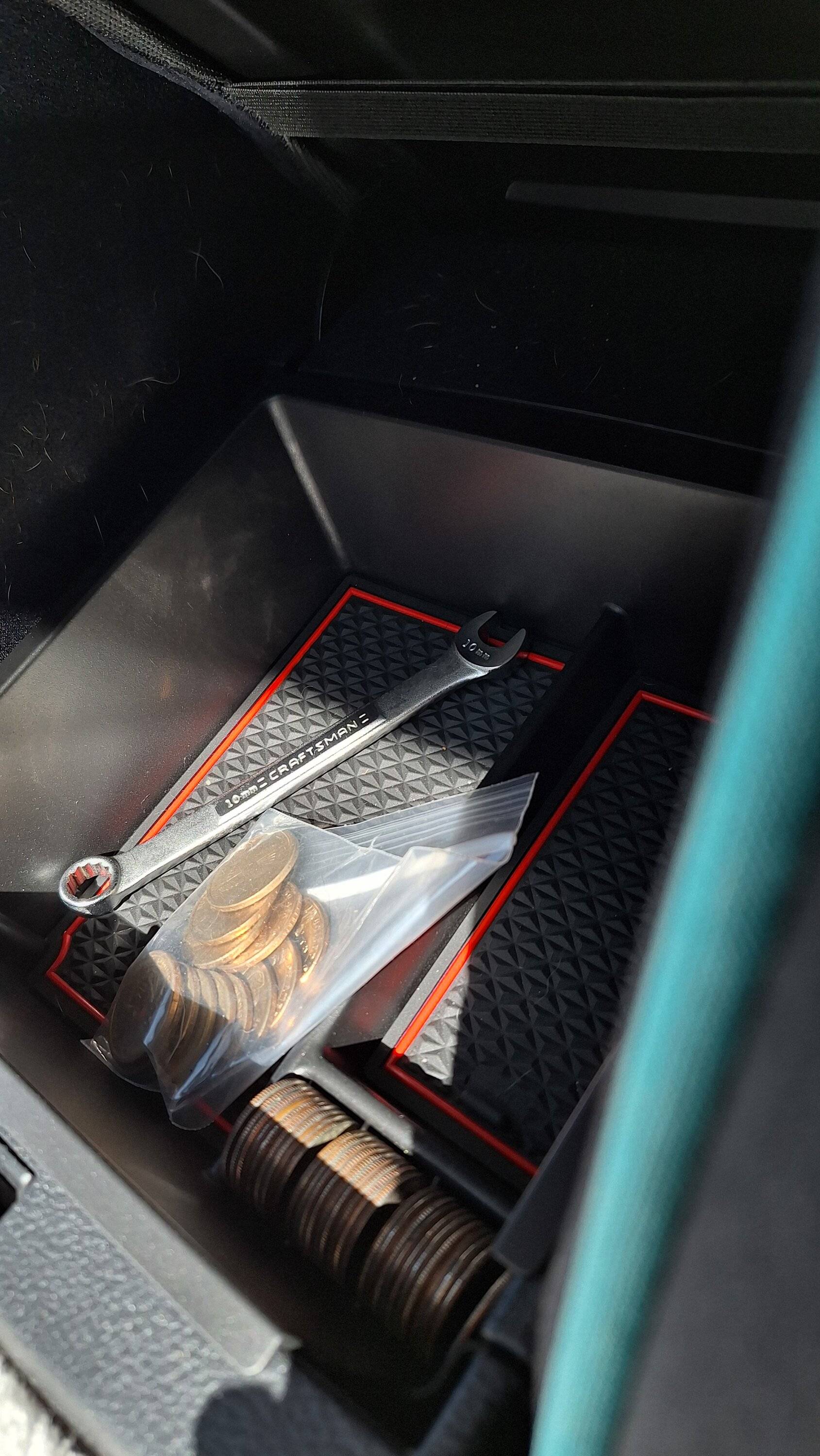

I spy a 10mm nut for a ground, hooray get to use my secret 10mm (3 wrenches and a socket in the truck, shhh) =D
darn it, the 10mm holds a plastic tab up. but hey, finally an SAE fitting on Soupie!
several holes in the metal to choose from, new bolt and nut with ground in place

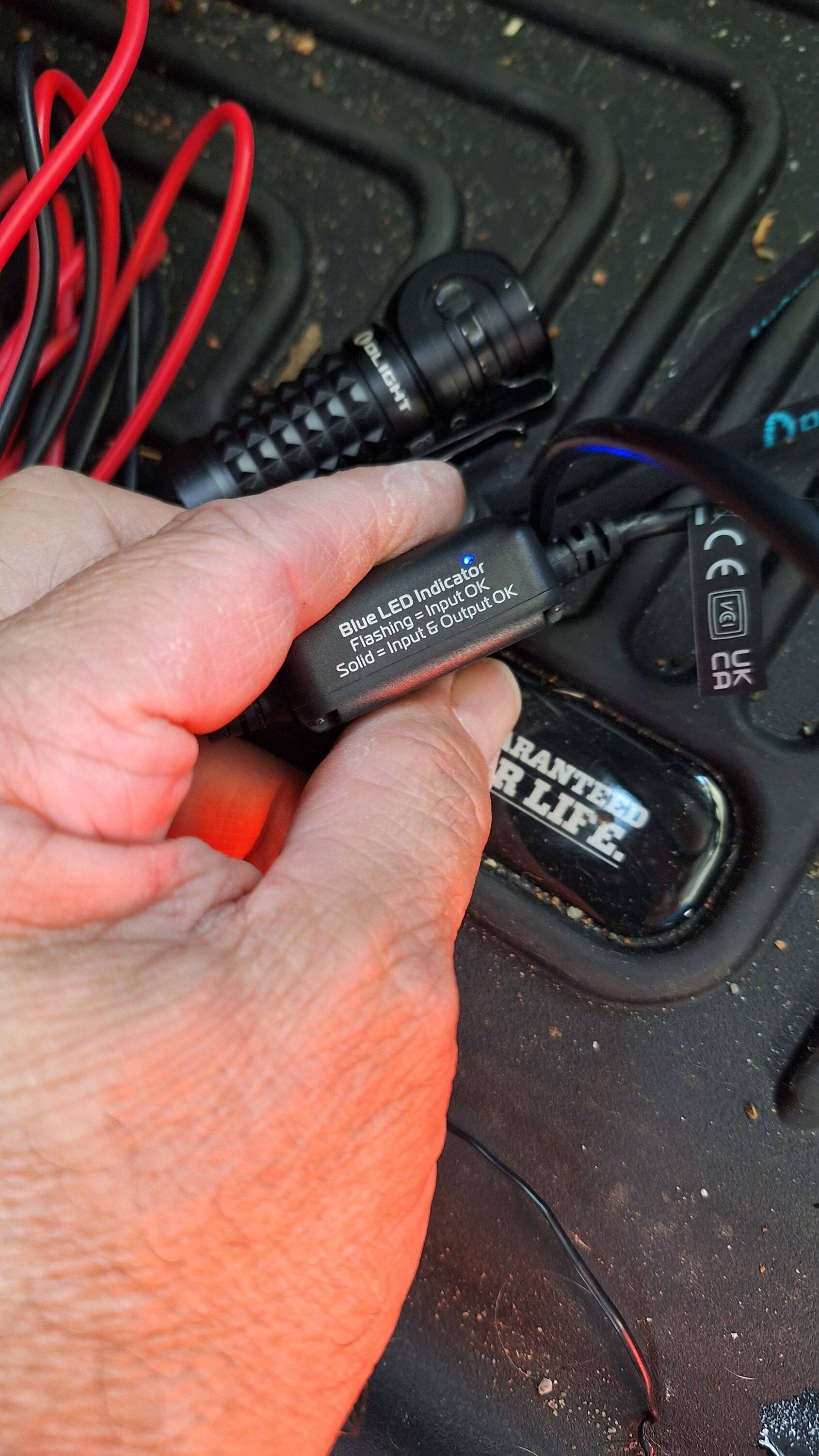

lookie here, it is a live circuit! little battery protection doohickey
just tucked the massive wad of wiring to the left in a perfect spot, can even see the power light

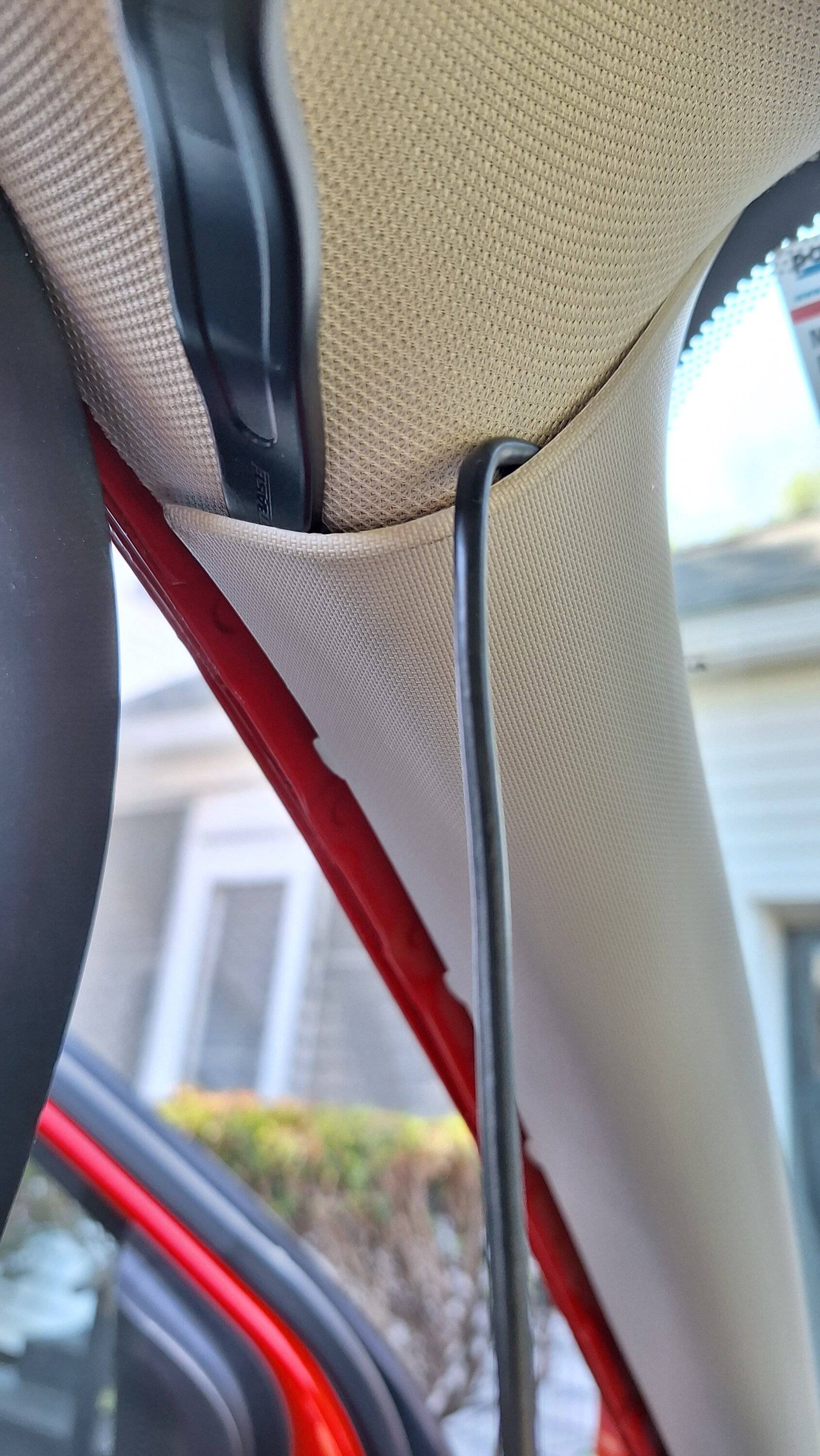

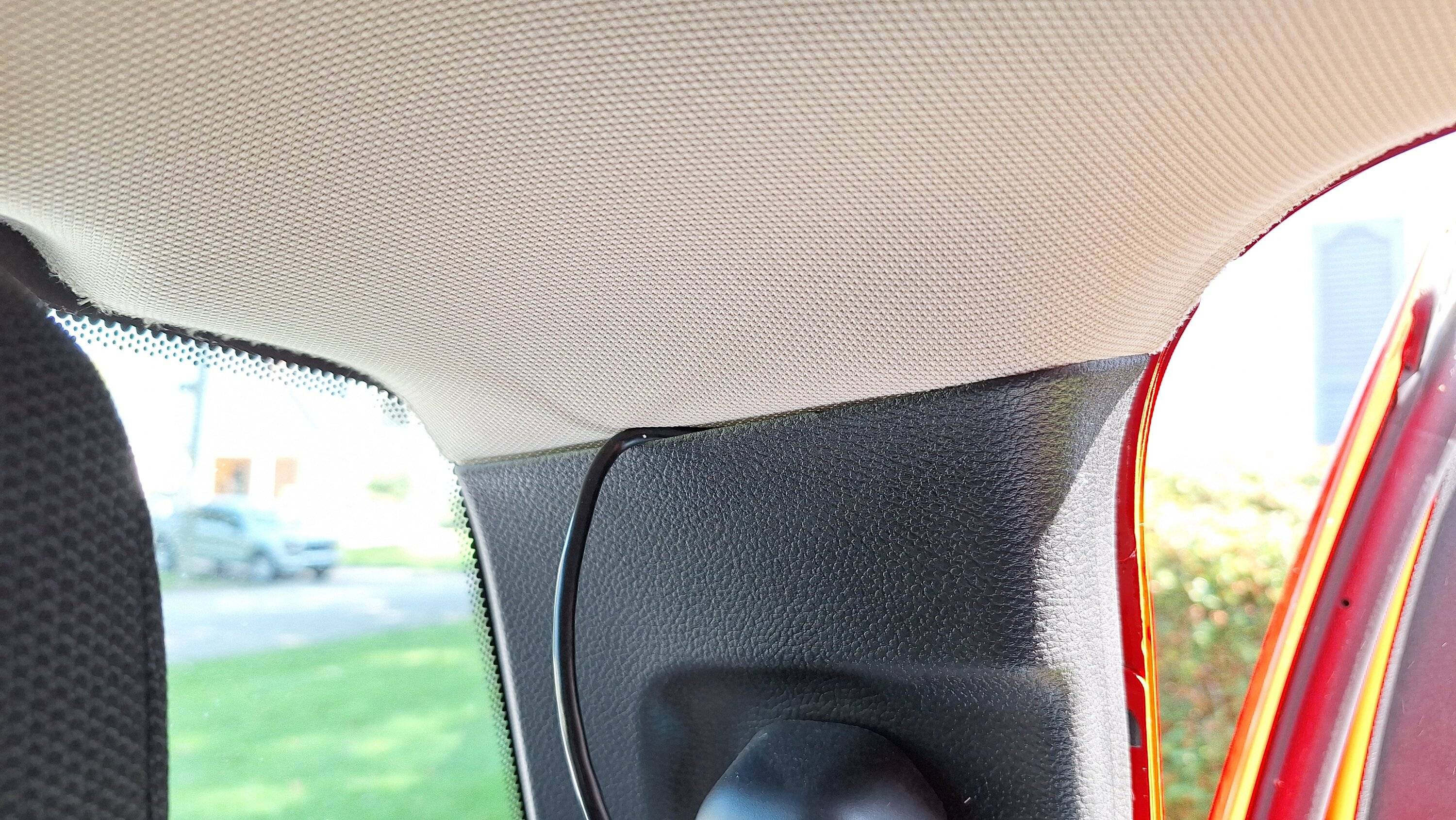

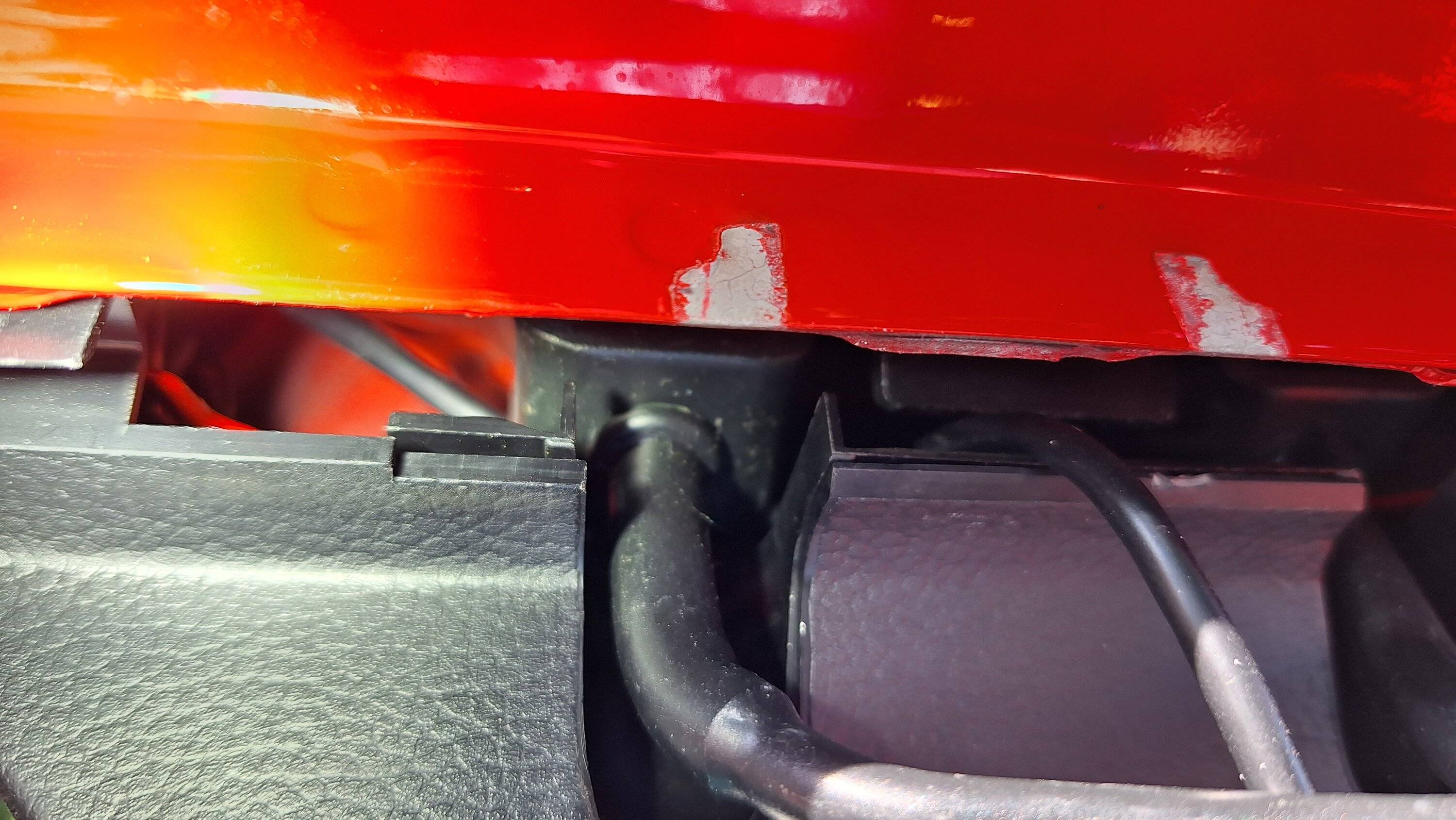

fast forward to placing the rear cam wire, it was easy along front of headliner, over top of the A pillar and in the headliner with weatherstripping rmoved. BUT ... this was the trickiest bit, getting it behind the supercab rear door latch, not hard, just a little extra pulling and pushing with the trim tool
finally, clear of the latch with only 5 miles of cable to hide (not kidding, 19.6 feet!!!)
dagnabbit! smashed my skull on the stoopid latch when stepping up on the side steps, talk about hurt! I kept the ice pack on during the rest of the install. thank God the latch wasn't bent! =)
wire easily went into whatever pillar this is (C?). a little pry tool love made it easy
I must have shoved 10 feet of cabling in the headliner. I should of just cut the dumb thing and spliced the connection back in
pushed the weatherstripping back in. note I removed one tilting headrest

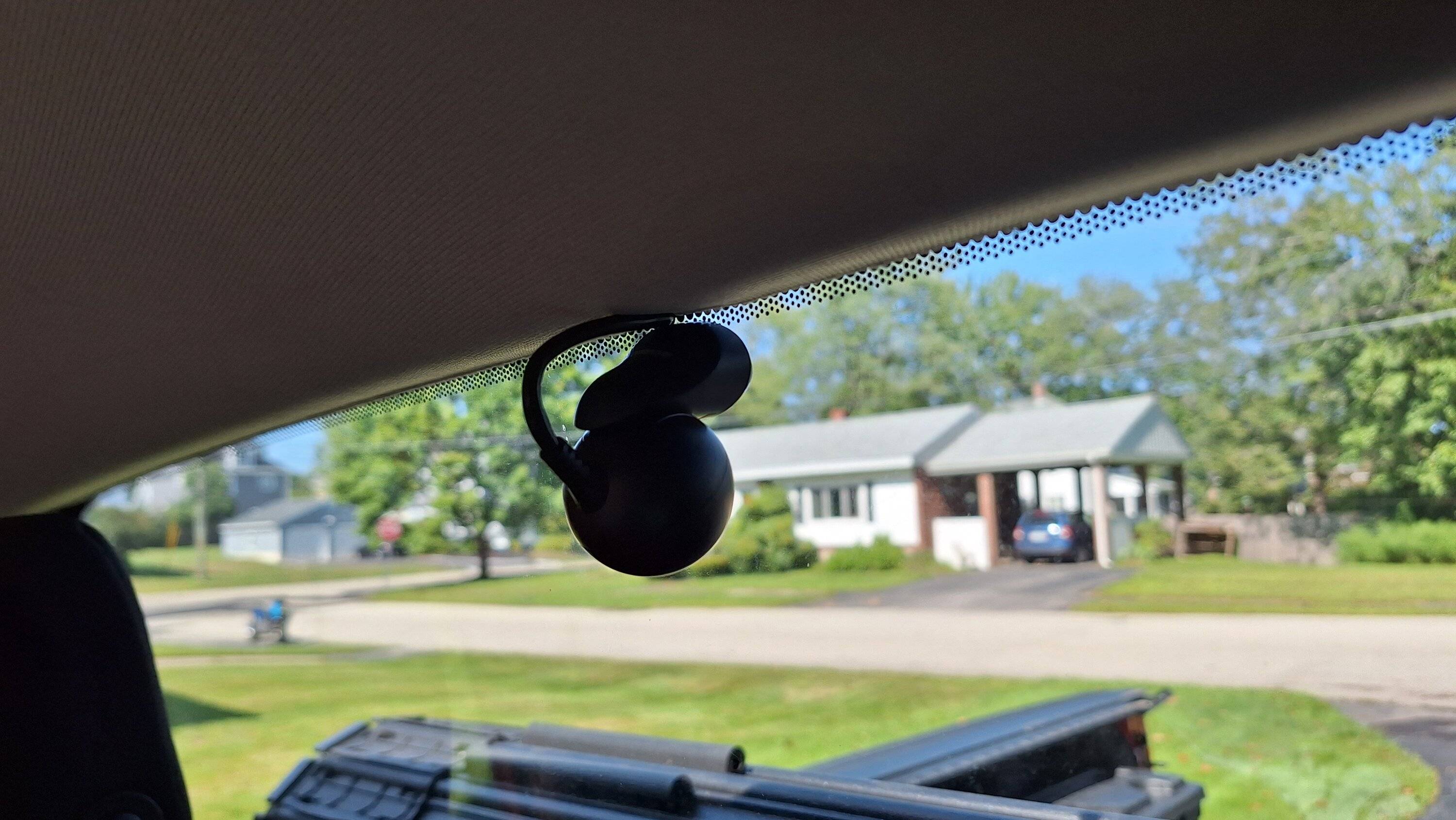

hi-tech Sharpie line on the outside for close-enough-to-the-center mark
pretty compact
i likes it =)

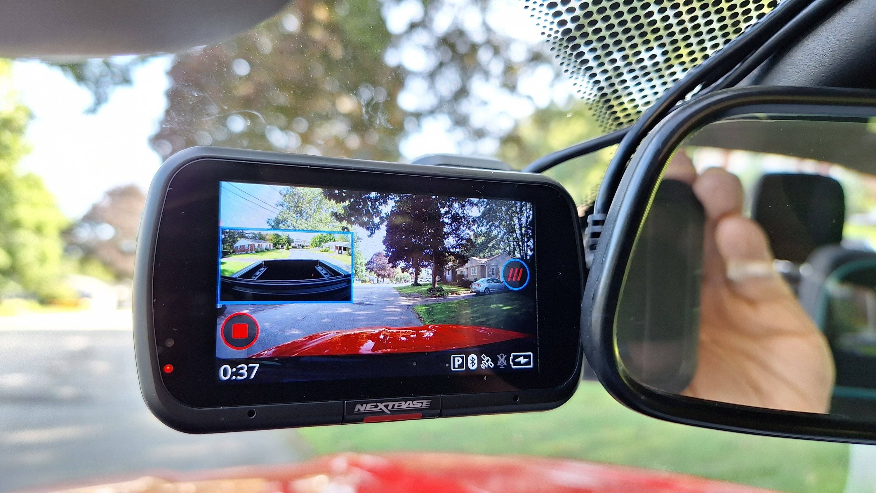

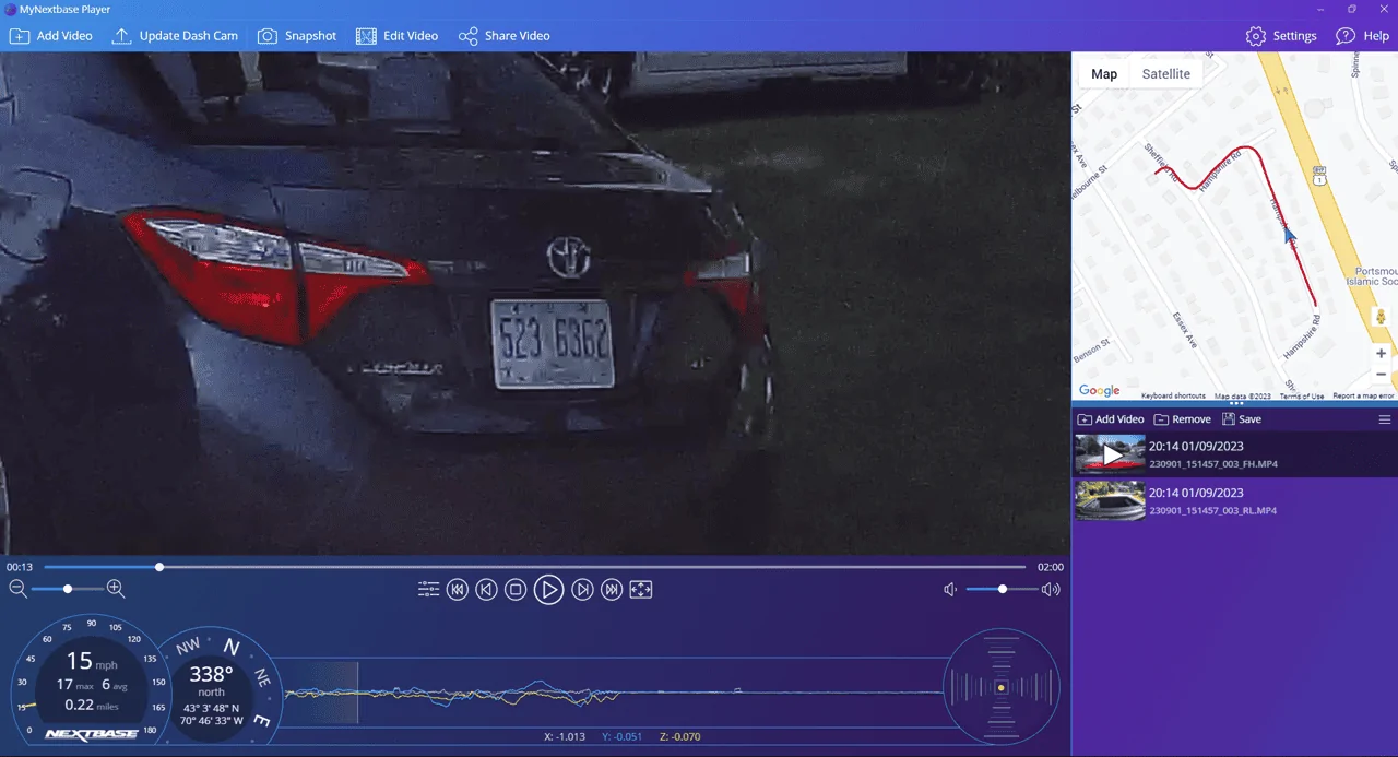

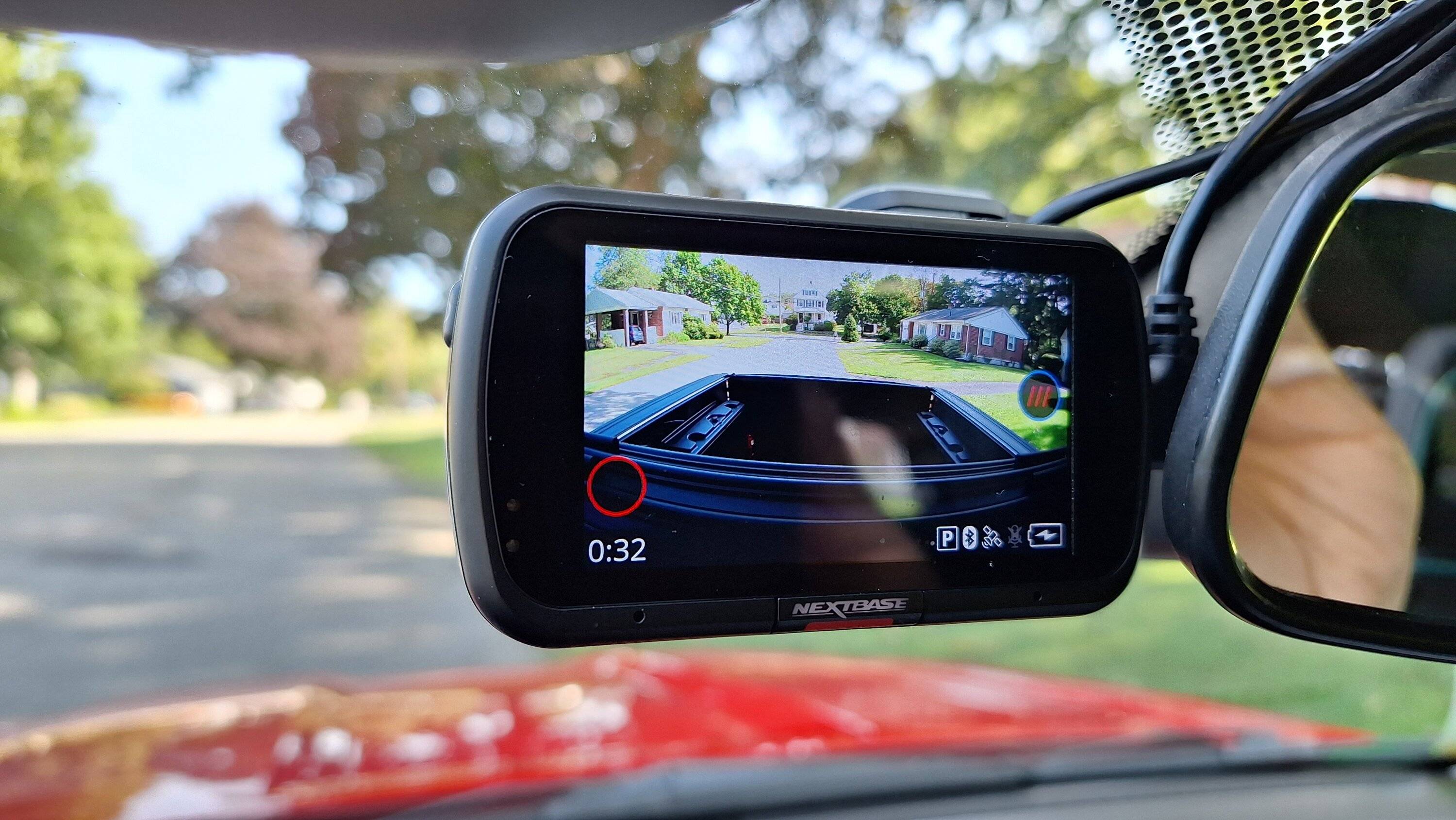

dam bed rake too high design flaw, can't see anything out the back. this has a "reversing" mode that flips the image to be like a mirror when the rear cam is selected
front view with rear cam picture-in-picture. the 3 red diagonals on the right are that What3words location system

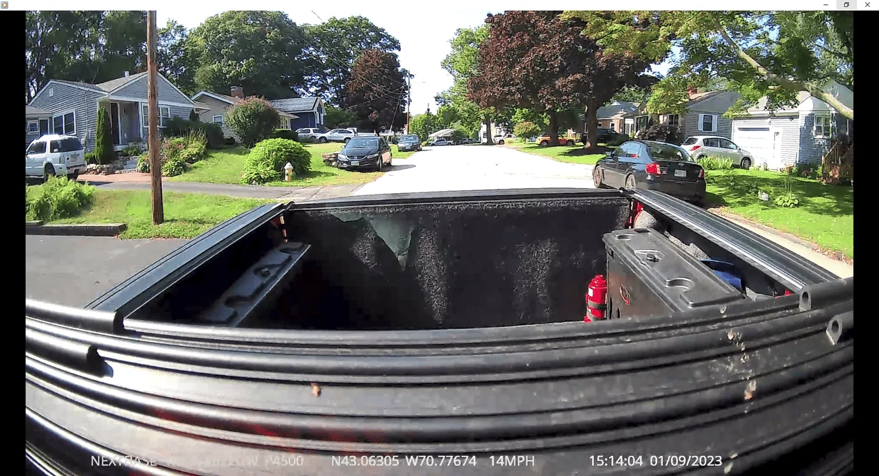

screenshot of rear footage, great for looking in that too-tall-of-a-bed that we have

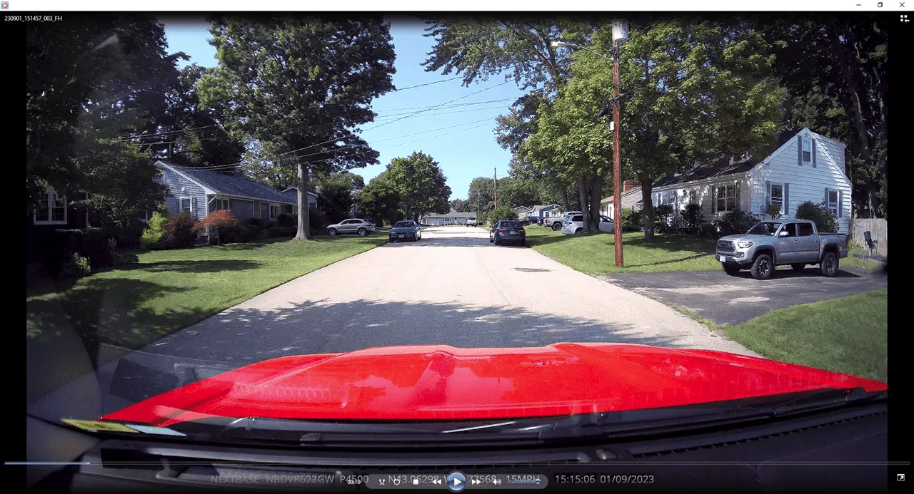

screenshot of front cam footage, it does have a polarizing lens, yuck, a Tacoma! =p
close up of a tag - 30fps at 4K
All in all, I like it for the first day and I need to test the parking mode and see how long it takes to wake up and set the sensitivity. It is a "collision" type of parking mode. I suppose I could always add battery backups and just leave it on at all times, but I rarely go anywhere and my biggest threats are the acorns that have dented Soupie. Bah on them nuts!
