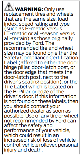

An LT-rated is different and may require different recommended air pressure. Whatever is on the door sticker is your correct tire. I would go to the dealer and politely demand that they put on whatever tire is on the door sticker and all four should match.

Agreed, it needs to be made right. While not a safety issue for day to day driving, it will potentially impact wear and load carrying ability, not to mention it's just right that OP gets what was supposed to be on the truck.
