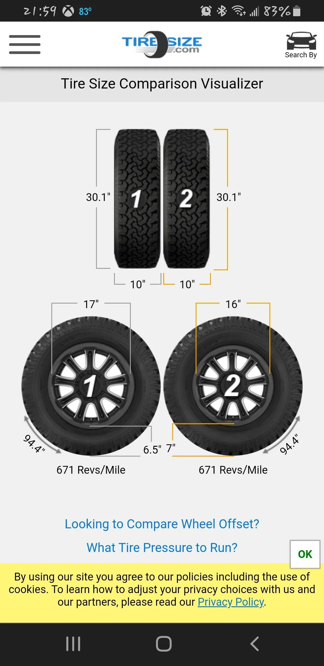

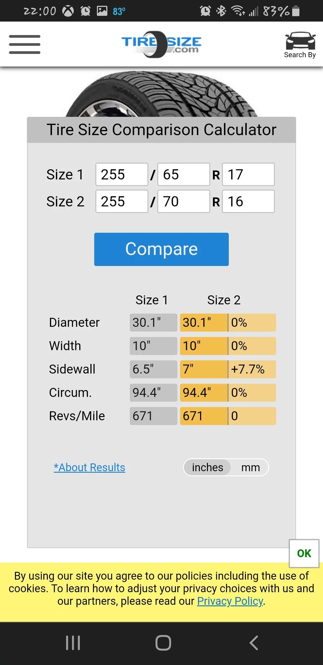

Mine came with 255/65-17's but the spare is a 255/70-16 on a steel wheel.
My 2020 xlt 4x2 is the same. But the spare and the other 4 tires are all the same height. And size so to speak.
So i am good with it. Same size as your tires too
