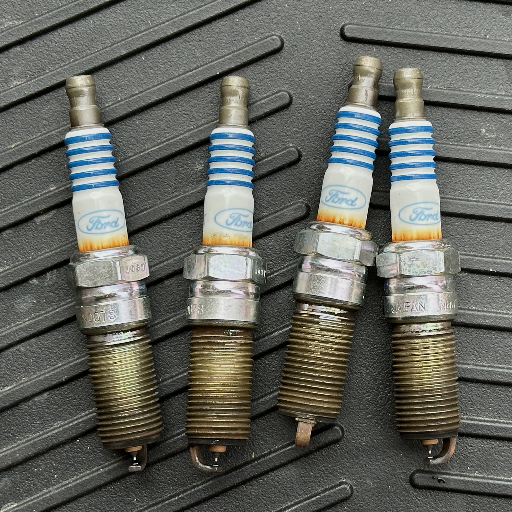

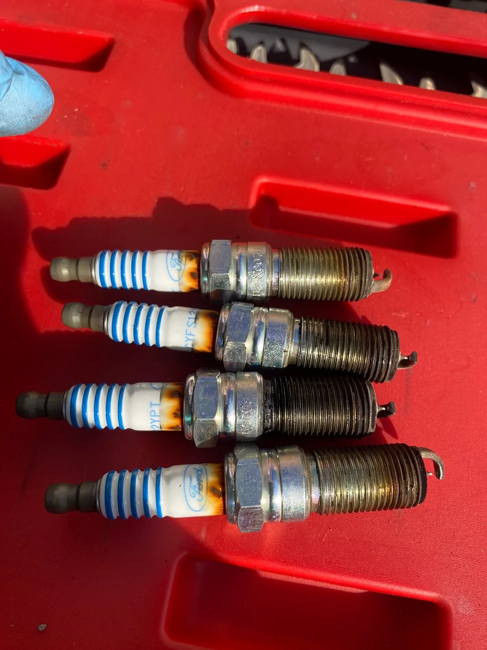

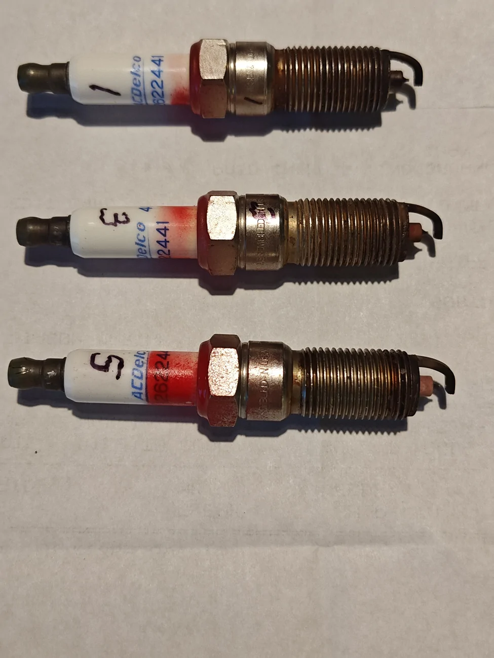

I changed the original plugs on my '20 yesterday. 48K miles, all stock except the addition of the topside engine cover early on.
Why at 48k? Anything unusual that made you decide to change?
Rp930
Nov 19, 2018
1,822
3,547
Denver
ā€˜19 Ford Ranger Lariat, ā€˜23 Macan,’21 Shelby GT500
I was having misfires and changed them at about 28k. Perfect now. Ford did change the recommended plug and I used the new plug.
