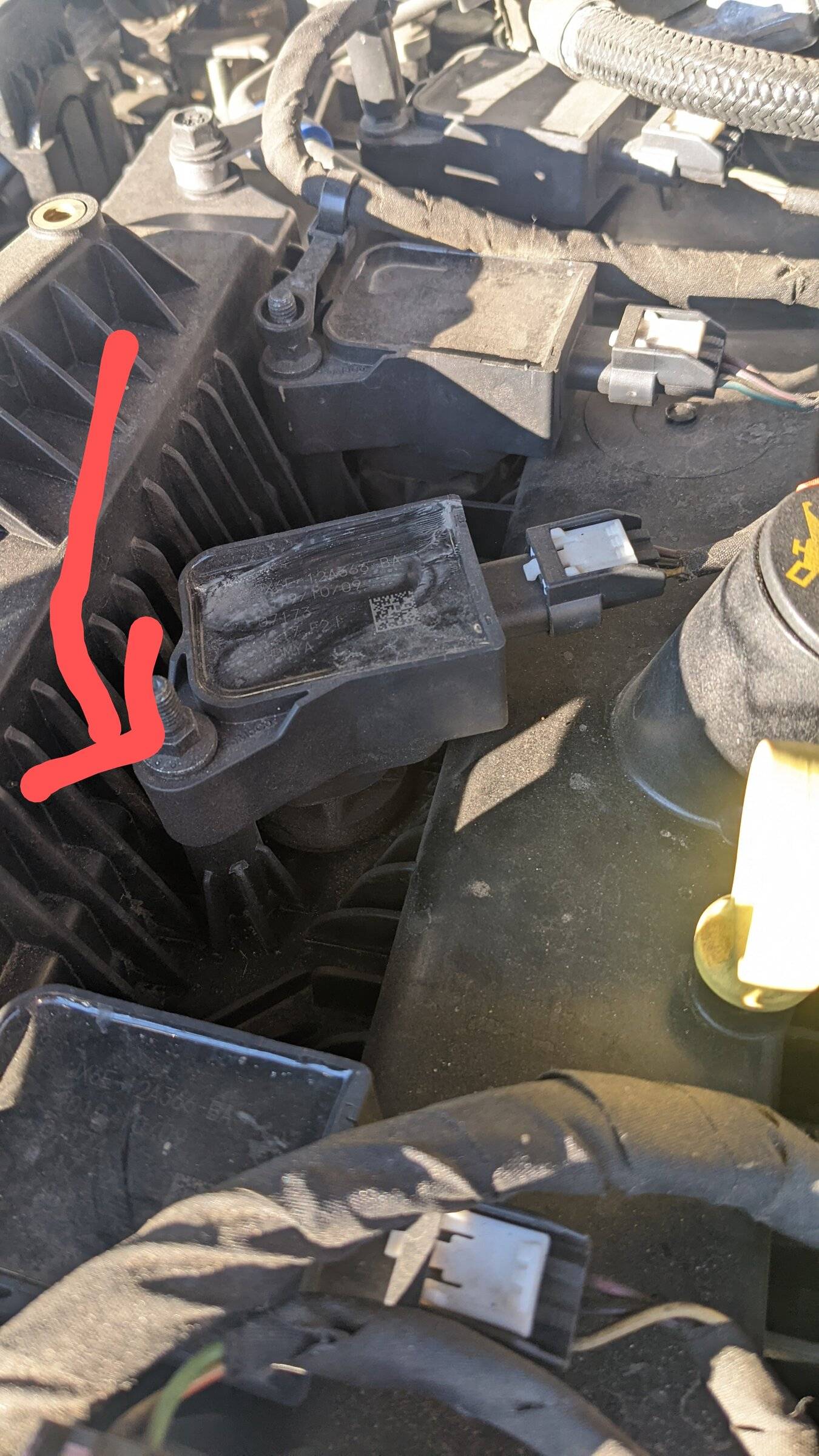

So do I loosen this nut on each one, then I'm able to move the assembly?
RangerPNW
Thomas
Nov 7, 2020
689
1,490
Santa Fe, NM
Project Manager
From what I remember on my Focus ST, yeah you undo that bolt and the coil pack pops right off

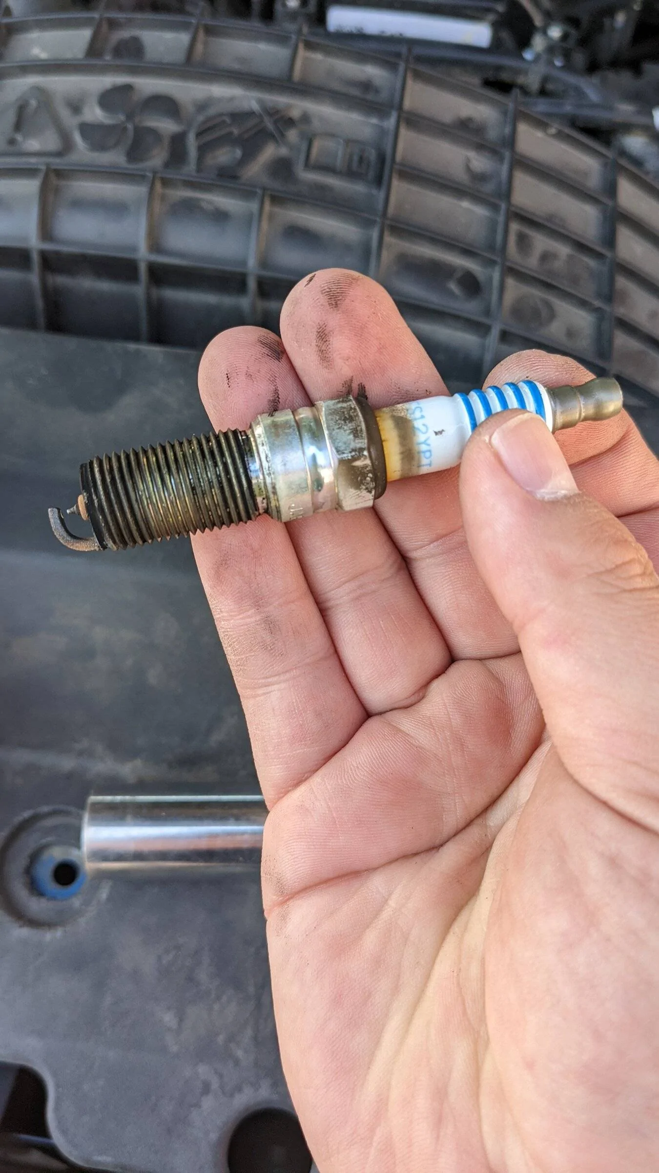

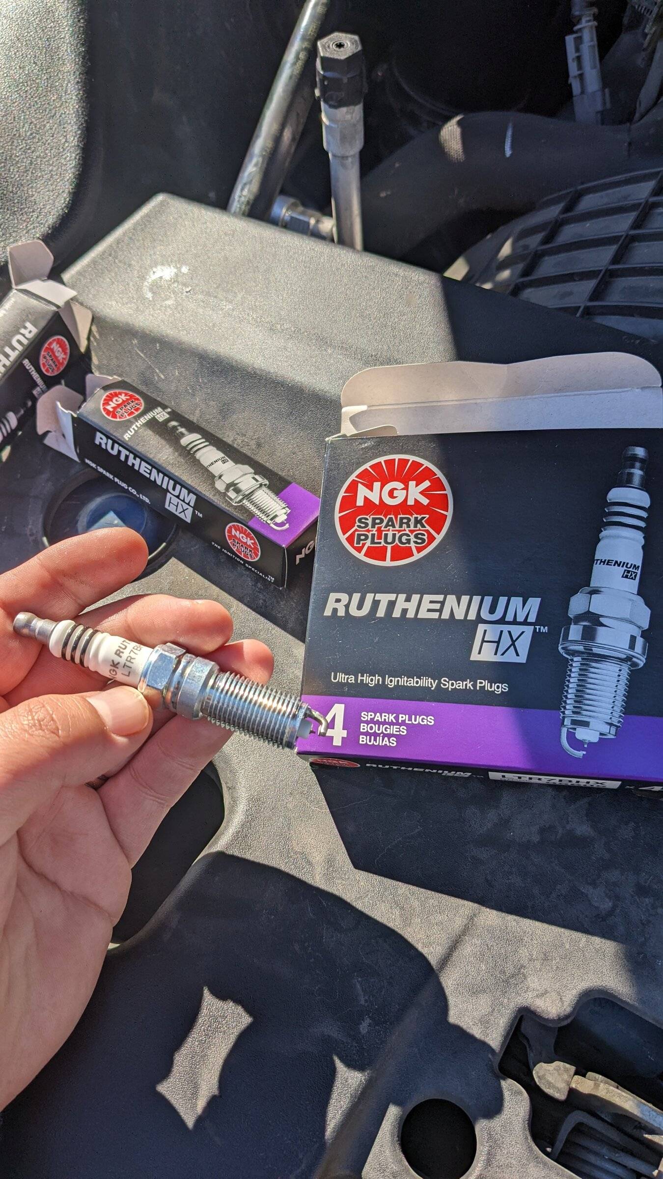

I'm not sure if this should be in the "Issues..." forum or here, but I found it interesting.
42,000+ miles on my '20 Ranger FX4 Lariat and the vast majority of it has been with an Eibach leveling kit, 265/70/18 Toyo Open Country AT3 tires, and Ford Performance tuner. Fuel mileage had been great but had dropped a little over the last 2 months,.... I was also driving short distances and less over the interstates like I do from March to October tho. I also felt that the truck just wasn't that fast and impressive like I'd remembered when I first bought it and especially like I remembered when I installed the Tuner.
I thought I'd try the colder NGK-95822 spark plugs, got them in finally, and we went to install them. What we found on the old spark plugs was that 2 of the 4 were definitely tightened past torque specs, and 2 of 4 had what I'd call a "flash over" where they looked burned via electricity on the porcelain portion like the boots possibly weren't tight. They weren't the 2 tight or 2 correctly torqued that I remember, so no correlation there, and the new spark plugs have antiseize and are torqued to ford's specs.
IMMEDIATELY upon leaving, the truck felt like I'd remembered when I first tuned it and my MPG's have been slowly climbing back up.
Guessing I'll see if I can get replacement boots for the coil packs and plan to replace them and these colder plugs around another 30k miles or so to be safe.
