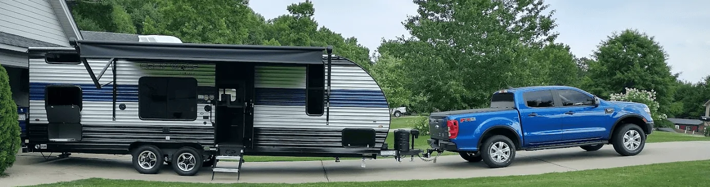

That Reese unit looks like an almost identical copy of the E2 Roundbar hitch that I use. The only caution they give is that you disconnect the bars before any steep transitions, IE Backing into a steep driveway.
I back mine into campsites all the time with no problems. I even back it into my driveway, which is pretty well-sloped. I'm sure it puts a little more stress on things, but I haven't noticed any problems thus far.
The bars aren't on there in this picture, but this is the slope of my driveway. I don't think I would leave them on if it were any steeper.
I agree with you on steep driveways. May driveway apron is about as mush dip as I would take with mine. The dips like you show are the hardest as the stress the bars more than normal. Humps actually take the load off the bars. Another reason to have the correct bars for your tongue weight and not too heavy.
