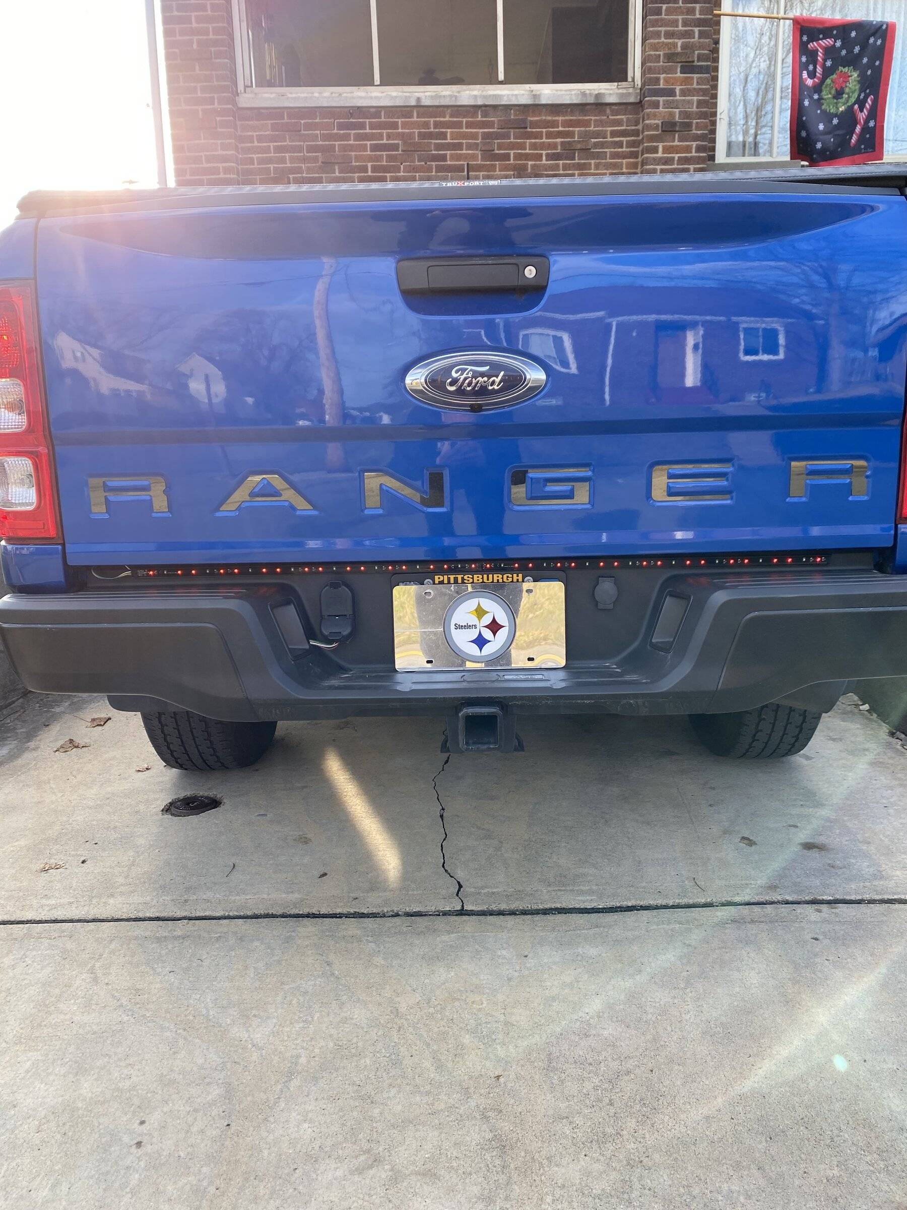

Maybe not the answer you're looking for, but I learned if you get a tailgate light bar plugged into the 4-pin trailer connecter it will disable the A.S.S. and no warning lights or anything.
Since it looks like you don't have BLIS, cross traffic or rear parking sensors you won't see any warnings, but your truck will still think a trailer is connected, since it looks like you have the tow package. Which is why it disables ASS, having a trailer connected. Those of us with those features will get warnings everytime we start the truck and those features will be disabled or affected. Lots of threads on hooking up tailgate bars.
