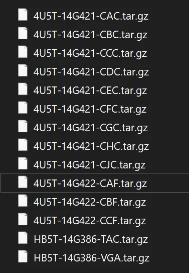

@UofMEngineer Which one is the Spanish pack?
Hard to know which one is Spanish voice pack. :).
Also, the first line of the autoinstall.lst says "[SYNCGen3.0_3.2312.18005_PRODUCT]", does this mean I got older version downloaded from Ford website?

No, this is fine. The voice packs are the 14G422's. So, CAF = English, CBF = Spanish, CCF = French. From memory they all load in the last section of the install. So, if the map is already there, you can try running only that section of the installer.

Tried installing just the English Voice Pack with this installer. It worked but was very slow in response and so I did a Master Reset and after that screen went blank on reboot. Tried reboot again with power + up seek button hold for 10+ seconds and screen is still blank. Turned off engine and opened and closed the door and restarted the engine and screen is still blank on power on.
:shock:
[SYNCGen3.0_ALL]
Item1 = 4U5T-14G422-CAF
Open1 = SyncMyRide\4U5T-14G422-CAF.tar.gz
Options = Delay, Include ,Transaction
