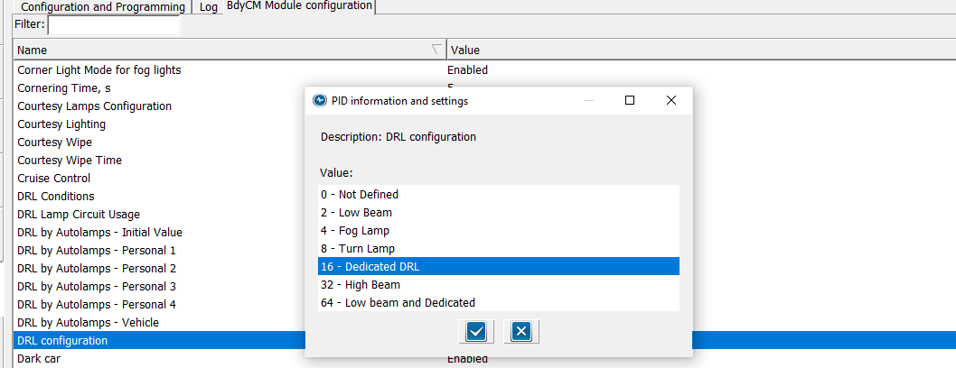

The various posts state an array of options on these setting but to get it to Factory LED (The LED Strip) as your DRL these are my findings
DRL Configuration to (Dedicated DRL)
Set this option to (16) Dedicated DRL - this will automatically set 2-Lines of Hex Code for you.
NOTE: the (16) is a Binary code that is converted to HEX (Inside of the As-Built) Files
Here are the 2-Lines of Codes it sets
BCM
726-26-02 - 0000-0001-0056 (Matches my Lariat compare search-As-Built)
726-50-01 - 108E (Matches my Lariat compare search - As-Built)
Now set Allowed DRL Options:
NOTE: The Paragraph at the top
If you have only (1) option for DRL, such as Factory LED Headlights, this will show due to the fact that it matches the (16) Binary code you set in DRL Configuration PLUS
This option ONLY modifies (In addition) (Plus) the standard factory DRL.
So, this normal - As I have not added any special (extra) DRL options to the configuration
So, with this selected, here is the last Hex Line of code that is changed (Automatically)
726-45-01 - 0A01-1000-008E (Matches my Lariat compare search-As-Built)
If you do not see this option (highlighted) then go into the As-Built File and manually change it, then when you go back to the (Module) Easy way, this will be shown
If you select (31) (+) Dedicated DRL here, you will see the As-Built Hex Line change to this
726-45-01 - 0A01-1F00-008E - ----This does not match factory settings
Others have posted that you need to set it to this, and it does work, as I have operational checked the Headlight's and DRL's using this one (1F00) and (1000)

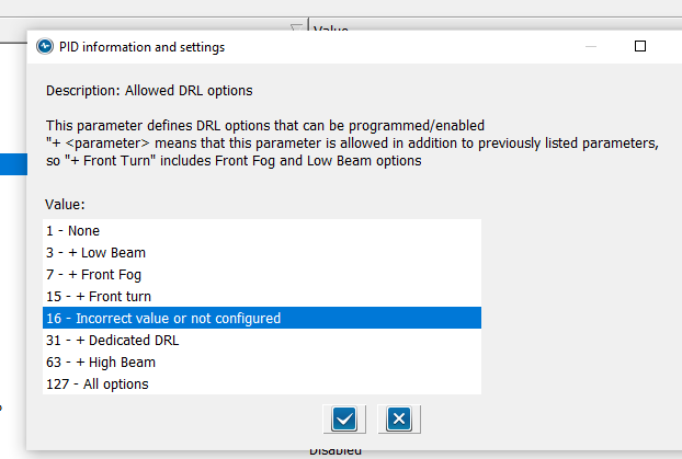

It's not in this thread but some have stated they had to (easy mode) set the Allowed DRL Options first then set the DRL Configuration, either way in the (Allowed DRL Options, you need to see
this:
I know it's an odd verbiage to see, but the Hex Code is what is important, and this line puts the hex code to match factory settings. This is the one that screws owners up, as this is (+) addition to factory DRL and they select (+) Dedicated DRL here, so with that selected here you are creating a BCM error code.
Plus, just a FYI, if you put truck in neutral (SET PARKING BRAKE) you can check full operation from your driveway. The DRL's operate in any gear except park and Auto Headlights are not activated by low light conditions - ***Unless you have Canada Version where DRL's are mandated to be on all the time.
and DRL Configuration needs set to this:
If this does not work, then set them manually to this:
BCM
This one should change Automatically with the above (2) changed as this is just a checksum code generated by the above (2) settings.
Hopefully this clears it up for you.

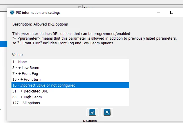

this:
BCM

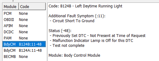

I have the Morimoto xB headlights in my 2022 cactus Gray lariat SCAB (seems like we are twins lol) I do not have forescan and I have never messed with it and I'm not good with that stuff, I am on my third warranty with Morimoto over these type of issues currently I am operating with no turn signals but the drls are bright as ever luckily I have the mirror turn signals but that is not optimal. Is there possibly a idiots guide type version explanation you could send my way? Or is the only way to fix this issue and get my truck back to normal as it is my family business work truck to get a forescan tool and get someone to step by step it for me? I am at my Wit's end honestly since as you know to change out the headlights on these trucks you have to pull off quite a bit of the front end and I have now done it twice technically three times because the first time I tried the GTR carbide lights and those were a fail on output.
